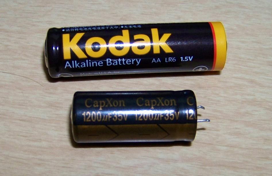

    So my TV decided to take a dirt nap and die apparently and the TV repair shop wanted 70 bucks JUST to look at it. So I did some Googling about and found that this TV has a problem with Capacitors blowing out after a few years. So I cracked open the PC and what do I find on the Powersupply board? Two burst Caps. I've already removed the burnt-out caps to get the info off of them, but I'd rather not replace them with the manufacturer's caps because they are using a Bad cap brand called "CapXon". I did however find a similar cap on Digikey by Nichicon. Can someone look at the info I have and tell me if the Cap on Digikey is a safe replacement for the one in my TV?
    ORIGINAL CAPACITORS
    1200uF 35v
    Radial (Through board) mounting type
    Temp Range: -55C to 105C
    Size: .5 inches x 1.5 Inches (12.5 mm x 38.1 mm) (this size Cap is not listed on the CapXon list for some reason tho.
    REPLACEMENT CAPACITOR
    http://search.digikey.com/scripts/Dk...me=493-1873-ND
    I'm fairly sure that they are safe replacements, but I'd like to make sure.

        So does that mean that the Capacitors linked are both appropriate for my needs? I'm mostly a Novice with Capacitors. physically they look about the same, and unless I'm missing a critical spec they should be the same on an electrical circuit except for size. I just wanted to make sure it'd be safe to use them.
        The CapXon Caps for the TV from the manufacturer cost 5-8 dollars each by comparison, which is why I want to make sure. These are less than a dollar fifty each.

          Capxon's are on the list of 'bad caps'. By the data sheet the original caps were rated for use in switching power supplies. Panasonic caps have an excellent reputation. The Panasonic FC series you specified is designed to be used in switching supplies. Use them! You aren't just saving money, you're also buying reliability.
          As far as the price difference, some manufacturers make a significant profit from the sale of replacement parts. Do a little research and see what the CapXon's would cost from a Capxon distributor. And it's not only the manufacturer. I was looking into the cost of a 92mm cooling fan recently. The manufacturer's suggested price for this fan is something like $55. One parts distributor has it available for $45. Another charges $78 for it. It's available on eBay (new) for under $40, and I've found it without the connector for $15.

                That cap is a custom ordered part and quite frankly iIt's an unusually high grade for that volts/uF combination.
                - Capxon LZ are comparable grade [ESR/Ripple] to Rubycon MBZ in 8mm and 10mm sizes but MBZ don't go over 16v or over 10mm.
                That's true of most higher grade Jap caps.
                [ You can cross reference between series by looking at the 8x20mm and 10x20mm caps in the applicable data sheets. Caps of same grade will have same ripple/ESR by the can size.]
                Extrapolating and estimating from other charts I would expect a 12.5mm x 38mm cap of that grade would have ESR ~ .010 and Ripple >3000.
                The -only- Japanese cap I know that goes to 35v with ESR/Ripple anywhere near that is Panasonic FM.
                EEUFM1V122L is a 12.5x30mm with ESR = .013 and Ripple = 3630.

                  I attached a picture of the Cap. There are actually two of them that are blown, but they are identical in every way. It came out of a Magnavox 32MF231D/37 LCD TV which is 3 years old by Manufacture date. I'd post a picture of the Power supply board where they came from, but I'm a klutz with soldering so It's with my Brother until I get the caps for him to solder back on.
                  Oh, and the opposite side of the Cap says:
                  LZ 105C
                  P616
                  VENT
