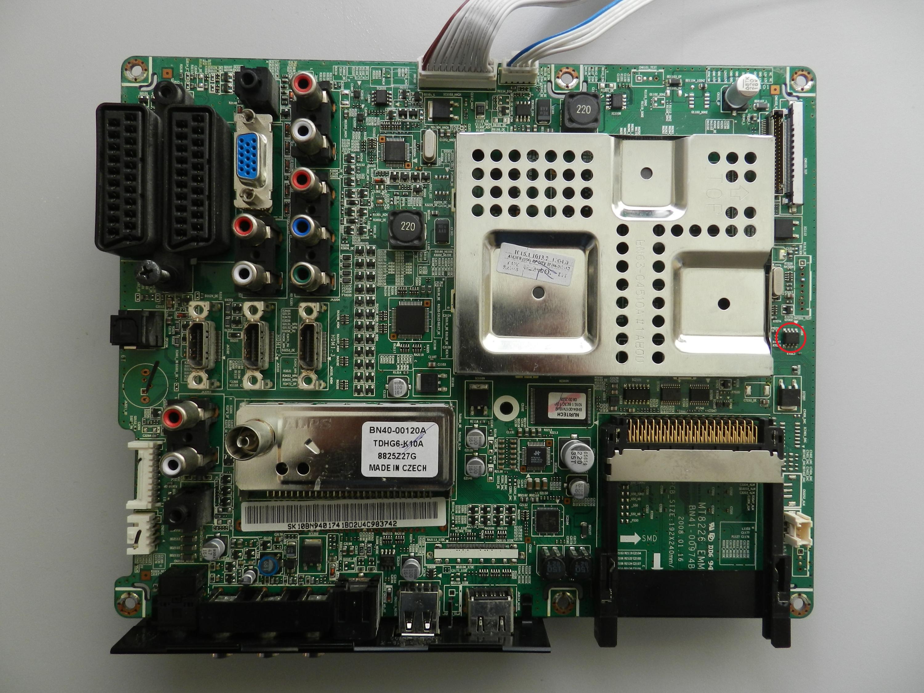

    I've bricked this set while updating it after it became unresponsive so I'm looking for the EEPROM bin file in order to reprogram the EEPROM.
    The set has a bad panel so I don't wish to spend money on it and consider this just an exercise.
    Mainboard MT8226 - EMMA, BN41-00974B
    Panel Samsung LTF400HC01
    EEPROM IC7004, S24C308AKH5-J508

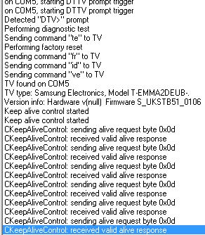

                            So I've successfully connected the set to my laptop via the TV's serial port and run the program SV2_V07 selecting the file T-PERLDEUC-1020.0.tvz when prompted.
                            There is initial communication but it then appears to be stuck in a continuous loop as can be seen in the screenshot attached.
                            Any idea's?

                                I don't remember well but one have to wait even some minutes until it starts to uploading...

                                    I did read in the forum i downloaded the file from that the lead had to be less than 1 meter? not sure why though also is the firmware/software in the file just for ota updates etc i wasnt sure.

                                      The cable less than 1m or even 1,5m with a ferrite ring.

                                        The cable is about 0.3 metres and the communication does appear to be OK.
                                        Using a USB to serial interface which I have used many times without any problems.
