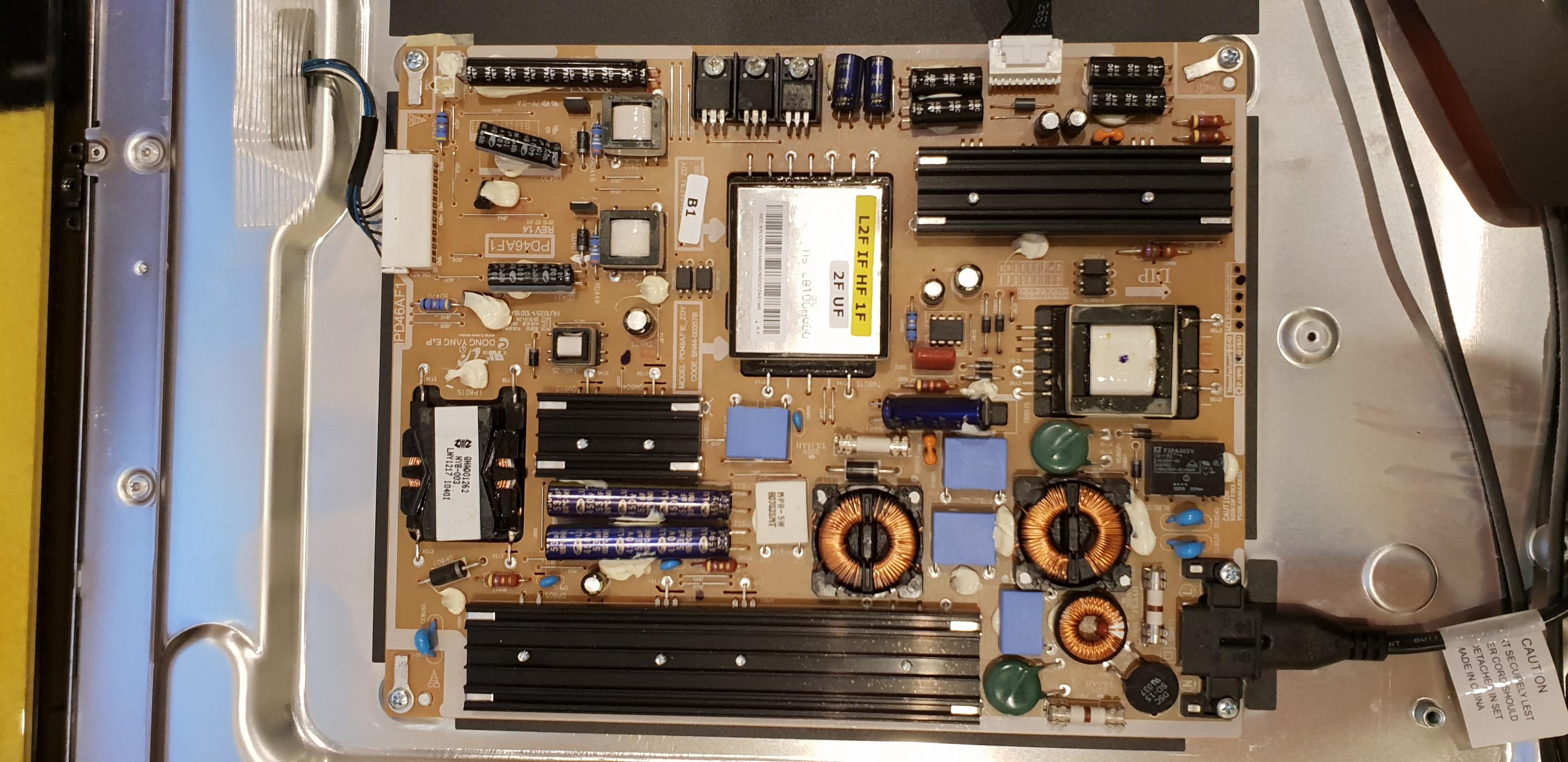

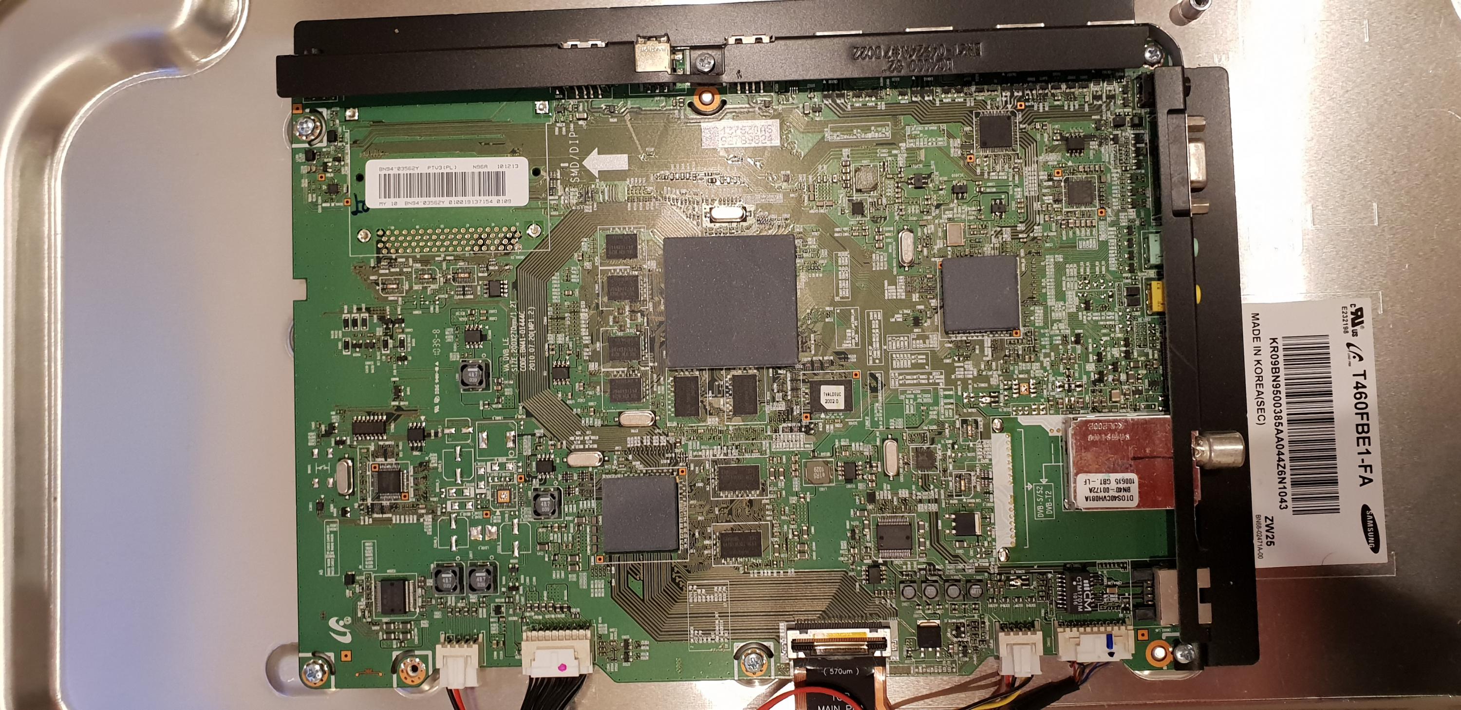

    I have a 46" Samsung UA46C6900 that continuously clicks on and off once I try and turn it on.
    I've read through https://www.badcaps.net/forum/showthread.php?t=48201 but i'm getting different results. I disconnected the PS pin from the main board end of the 18 pin cable and jumpered SB to PS to force the power on with the main board still connected. The tv turns on and stays on (clicking stops) but the screen just flashes on blue every few seconds and is off the rest of the time.
    I've looked over the power board and the caps look OK to me (no obvious bulging), so I was hoping someone could point me in the right direction

    Any photo's of the circuit boards.
    Disconnect the power supply from the mainboard. Switch on. Do you have backlights?

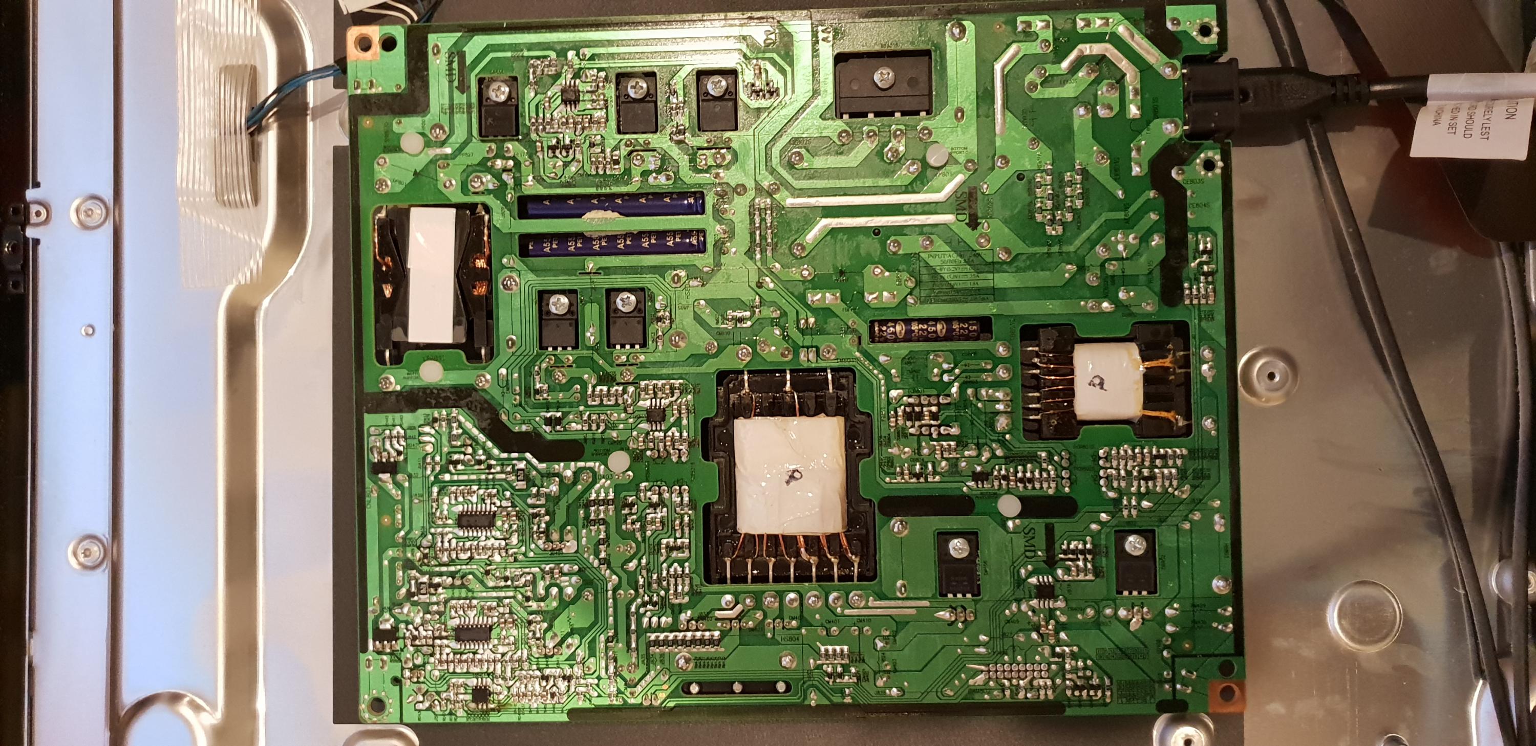

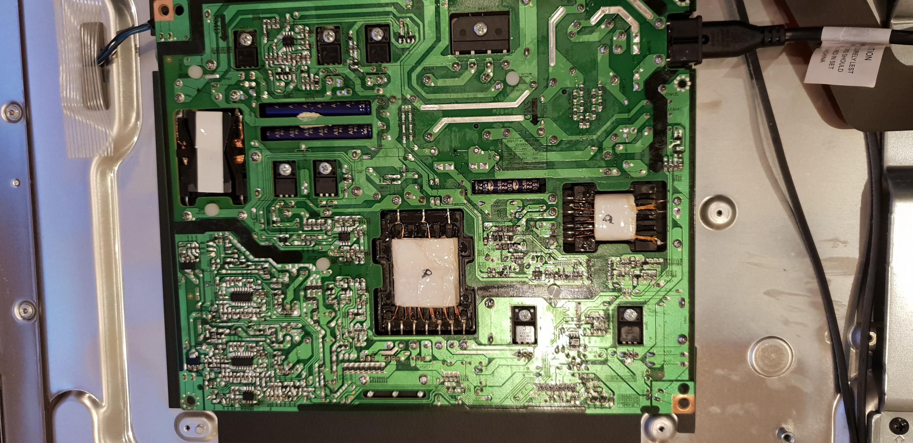

                    can you check the 2 main fuses for continuity.
                    we will need pictures of the bottom side of the ps as well.
                    if you only have 38v dc on the main filter caps, i would assume that you had no stby voltage.

                              so it looks like this ps has a pull up resister for the bl/on signal.
                              if you are getting 380v with jumpers in place, are the backlights working? and do you have all of your other voltages on the main wiring harness, if so, it looks like a main board issue.

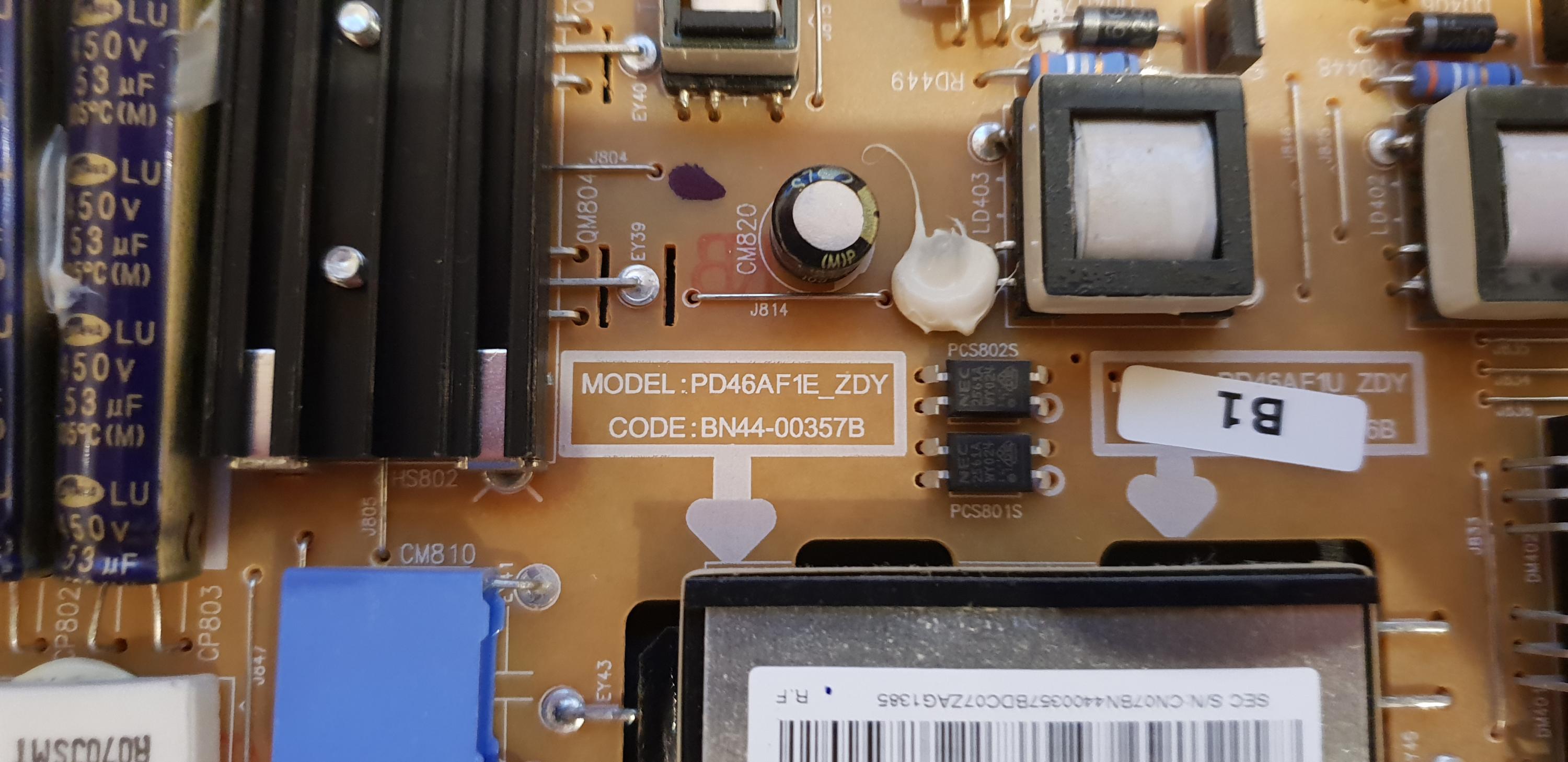

                                It takes 15 Minutes for the Voltage on the cap to reach 380VDC? That cannot be right.
                                At this point you must report the Voltage readings on the connector of the power supply that goes to the main board when TV is plugged in and when the power switch is activated.
                                BTW, I need good clear straight shot pictures of the whole top and bottom side of the power supply board, shopjimmy does not have them for me to look at.
