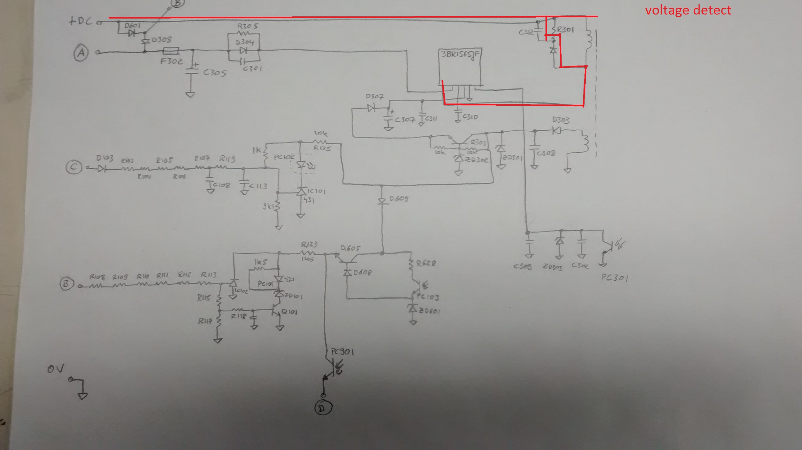

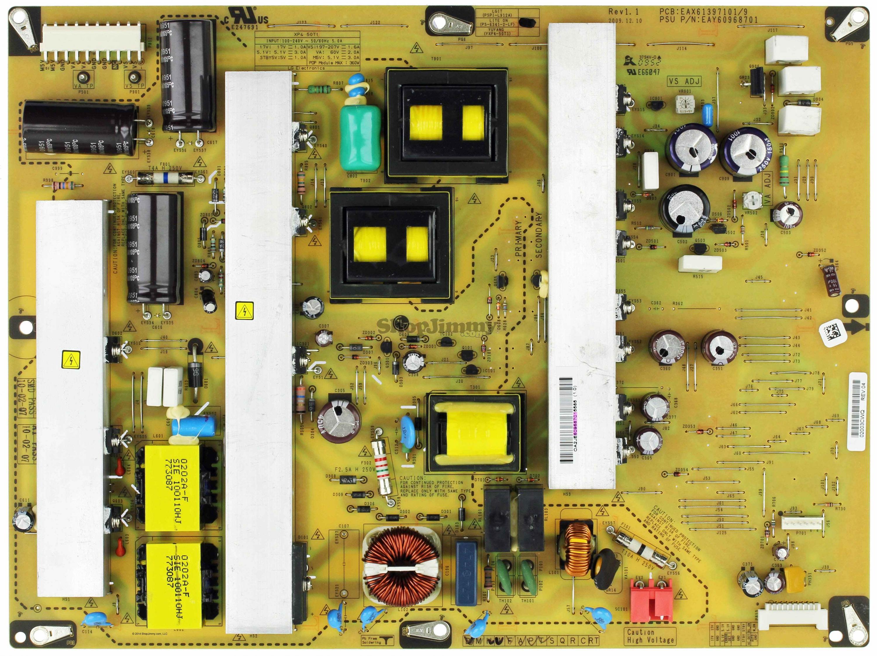

        1) In standby with TV just plugged into the out, the DCV on the top pin of the transformer in your picture should be about incoming ACV x 1.414, so if your AC is 230VAC then the DC V will be about 352V DC.
        2) The DCR of the transformer will be really low resistance, most of the time will <1 Ohm, you can only use Ohm meter for checking for open winding.
        3) Your drawing of the connection of PIN 2 does not look right, that is the CS which should be connected to the very low Ohm current sensing resistor and Ground. Look at the application circuit in the spec sheet to see how each pin of that SMPS IC is connected.
        4) c310 is connected to BA (pin 3), see page 17 about the cap connected to that BA pin.

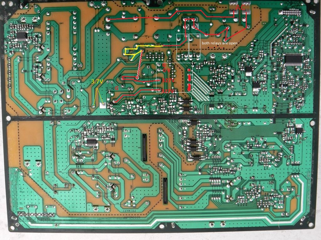

          Can you have a look at this picture.
          I dont know where need to start checking 5v fault.
          3br1565
          pin 1 drain - 327v
          pin2 cs - 0V
          pin3 BA - 0,1v
          pin 4 VCC - 0,5V
          pin6 fb - 0,1v
          p813 have 0v on 17v pin, 5v pin, stby pin, ac det pin
          error det 0,1v

            Power Supply Basic Operation AC Voltage is supplied to the SMPS Board at Connector SC101 from the AC Input assembly. Rectified by the Bridge rectifier D101 generates a primary B+. The Power factor circuit generates a Primary supply which can be read at Fuse F302 160V. This primary voltage is routed through T301 and routed to the Standby 5V supply. The STBY5V (standby) is B+ for the Controller chip on the back of the board (IC701) on the SMPS and output at P813 pins 13 and 14 then sent to the Main board for Microprocessor (IC1) operation (STBY 3.49V RUN 5.23V). When the Microprocessor (IC1) on the Main Board receives a “POWER ON“ Command from either the Power button or the Remote IR Signal, it outputs a high (2.43V) called RL_ON at Pin 15 of P813. This command causes the Relay Circuit to close both Relays RL101 and RL103 routing AC to the Bridge Rectifier D101 which then routes the primary voltage to the PFC circuit (Power Factor Controller) 390V which can be read measuring voltage at Fuses F302 (390V)
            I have 390 v with rl101 and rl103 off, why?

                            After t301 i have no voltage, betwen pins of c377 i have 0v, relay is mounted without black cover to see whats hapening, n the picture above, where I wrote the voltage of 3.7 v. this voltage starts at 1v and increases if there is more time connected. I do not have the ac voltage in d101 but on the output I find the tension I am talking about above
