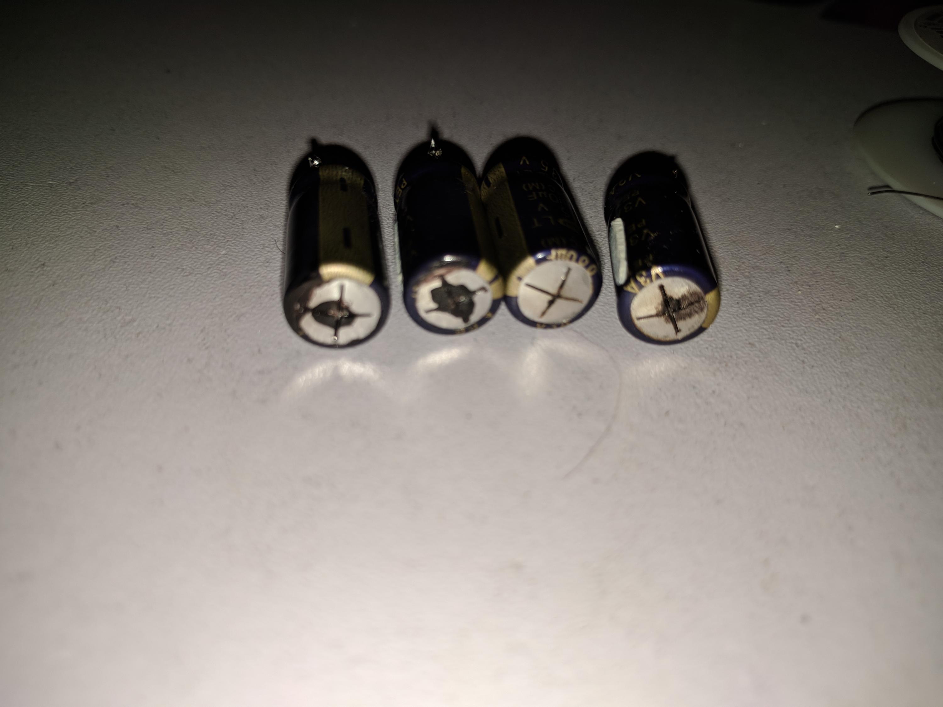

    Philips 47PFL7432D Dim screen
    Friend brought this tv over today. Says the screen is dim and kinda flickering like the backlights going in and out. I opened her up and looked at the Master and Slave Inverter boards. The 680uf 35v Caps were bulging and leaking. Nice. Hit my Caps bin. I have 3 @35v and 1@25v. I swap them all in including the 25v to test. Sure enough. TV comes back on. Screen is bright all over and no flickering. Ordered 11 more 35V 680uf caps. Easy 15m fix.
