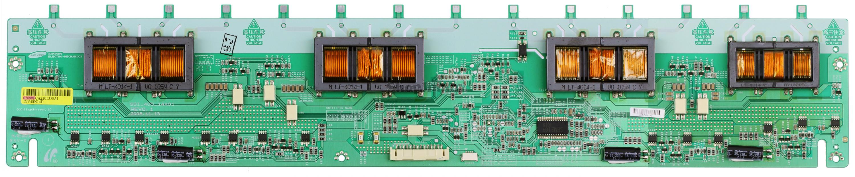

    Have a read through the following thread which may prove useful. The fact that you say with the last two tubes removed the remainder light up makes me think you have an error signal being produced around the last transformer stage that drive the last two tubes.
    You have already changed the transformer so it would be worth checking the mosfets that drive it.

      I was looking at your inverter picture and compaired it to shopjimmy's and I could not see the two resistors R312 and R314 on your board, are they there or is it just the lighting in the photo?

        It seems to have been a dry joint on one of the resistors around the smaller transformer. When i started soldering around there one of the resistors came loose as soon as i applied some heat. The inverter is working for now but only time will tell if this was the fix.
        In a few days time i will report back.
        Thanks for your assistance so far.
