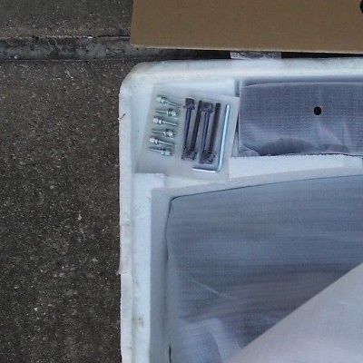

    Folks,
    Does anyone know what screw size is needed to attach the base to this TV? I know they're Hex "Long" screws according to the manual. I'm guessing roughly around 2.5 inches long.. but anyone know the pitch and other specs?
    Thank you!

    They could be M5 or M6 metric thread, the manual does'nt say what they are

      Thanks R J
      I went to the hardware store and grabbed a handful to try. These worked fine:
      M5-0.8 x 50 mm (though had I found a 60 mm I think it would have worked better)
      #10-32 x 2 1/4 also worked fine.
