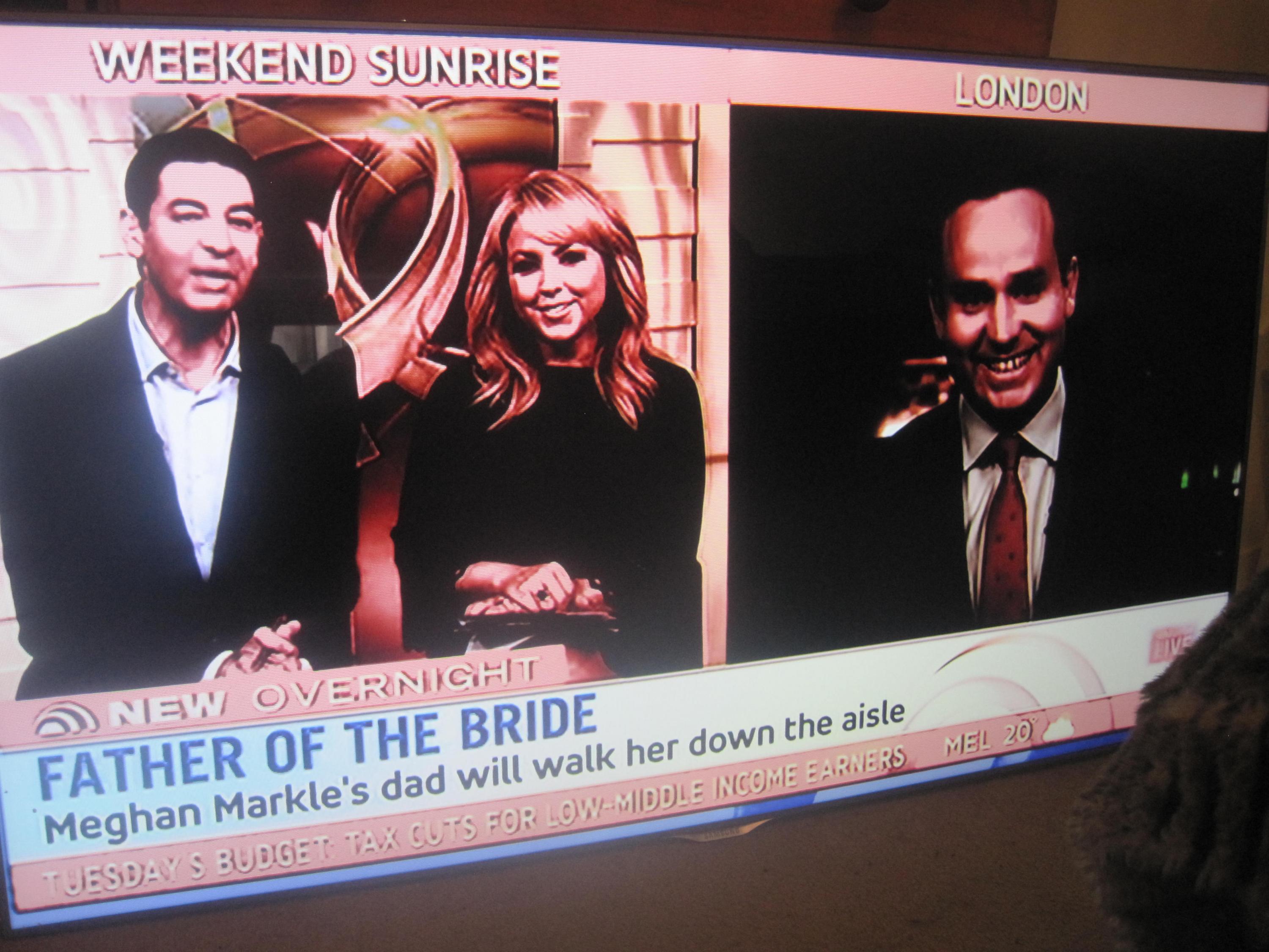

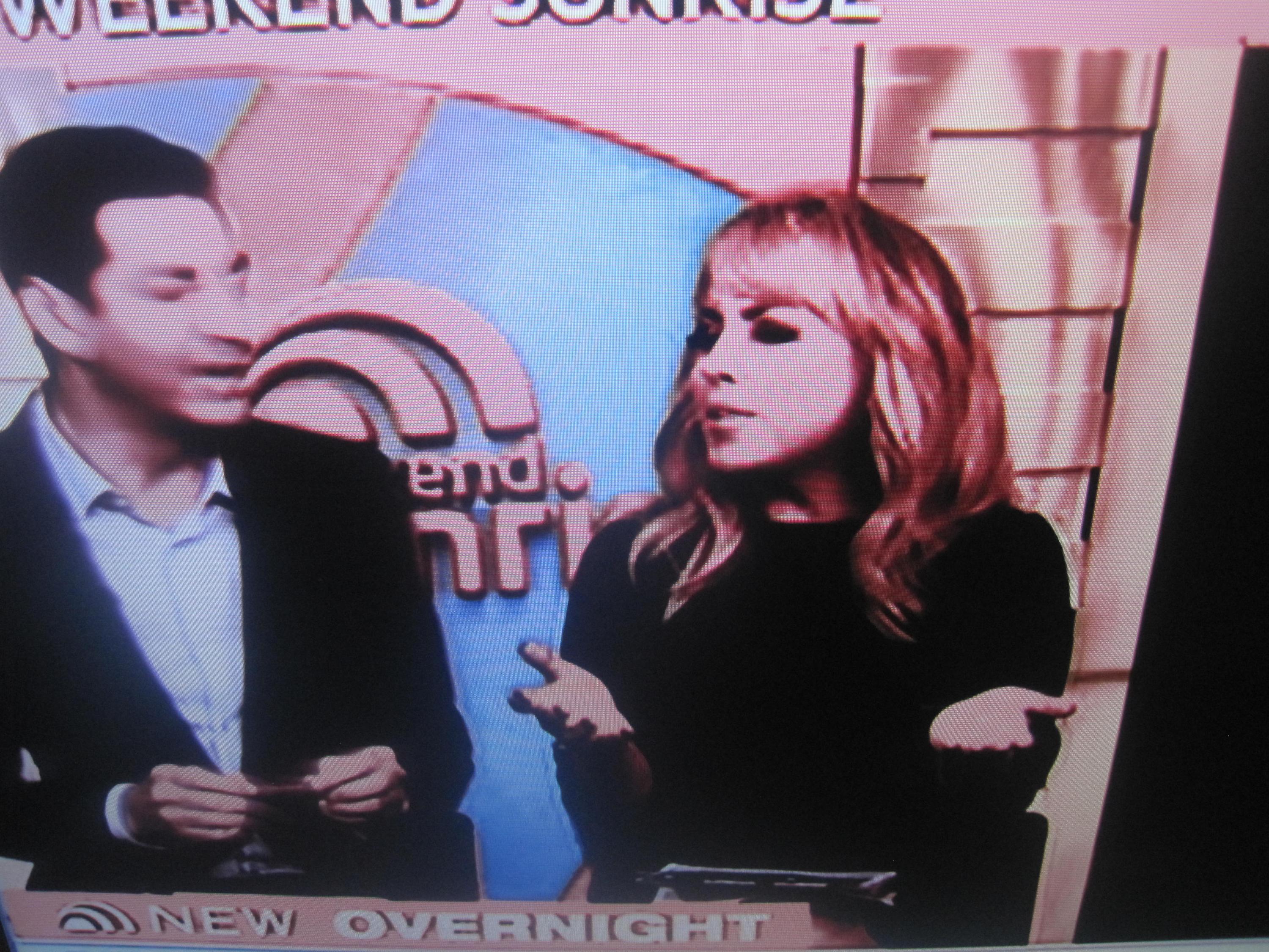

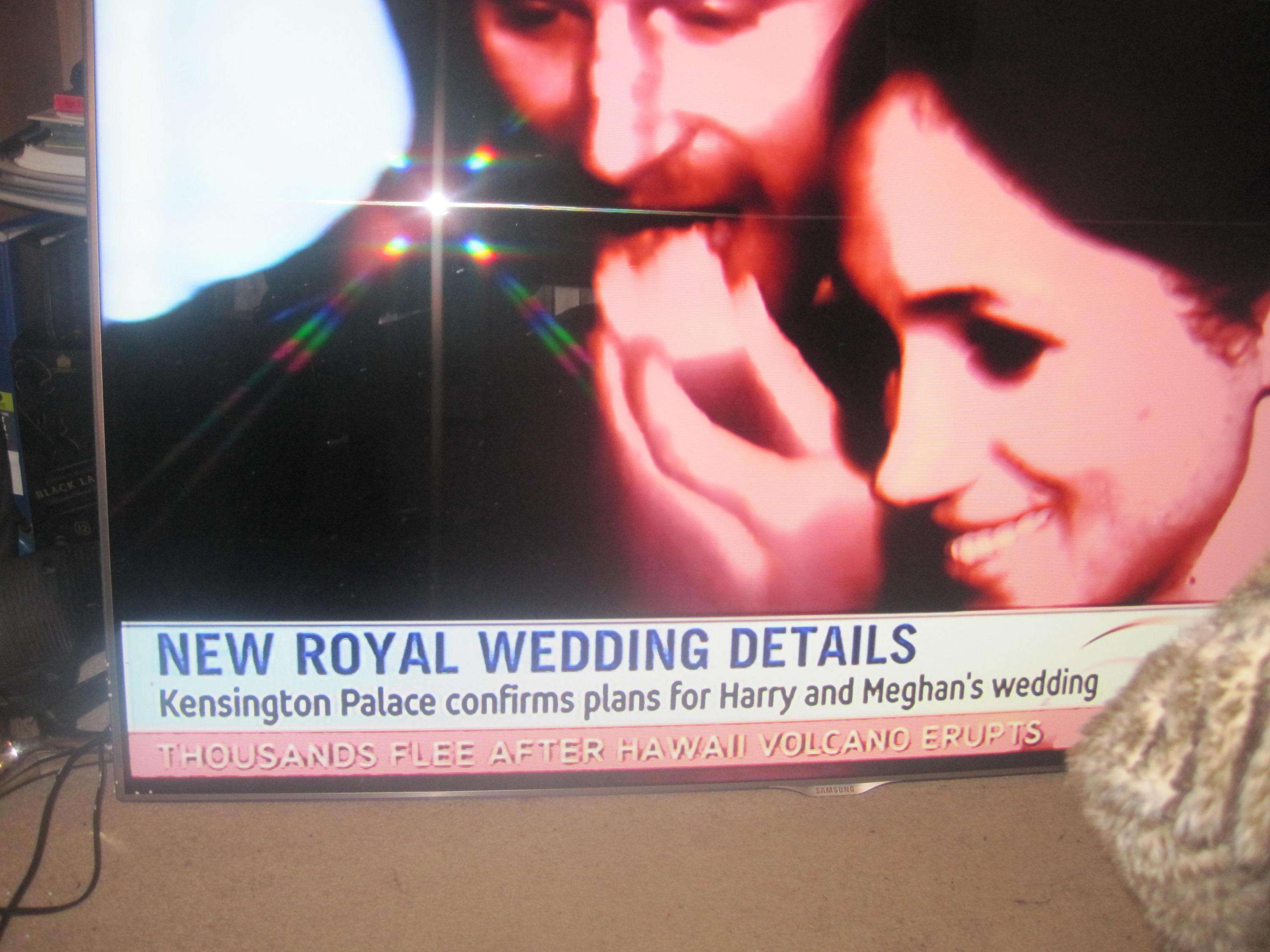

    Samsung UA55F7100 Screen fault
    Any suggestions as to this screen fault (color).
    Used to come good after approx 10 mins but....
    Gone through all avenues, update (current ver.). Default settings and completed picture test...Perfect.
    T-CON?
    Cheers

    Re: Samsung UA55F7100 Screen fault
    You'll have to measure the gamma points to see how the curve looks. Otherwise I would say main.

      • angelos
        • Dec 2012
        • 571
        • South Africa
        Can you elaborate more about the gamma curve. Is it those V1, V2, V3, V4 etc... test points?

          • mmartell
            • Oct 2013
            • 3189
            Yes it is. Search here for "gamma" you'll find all you need to know.
