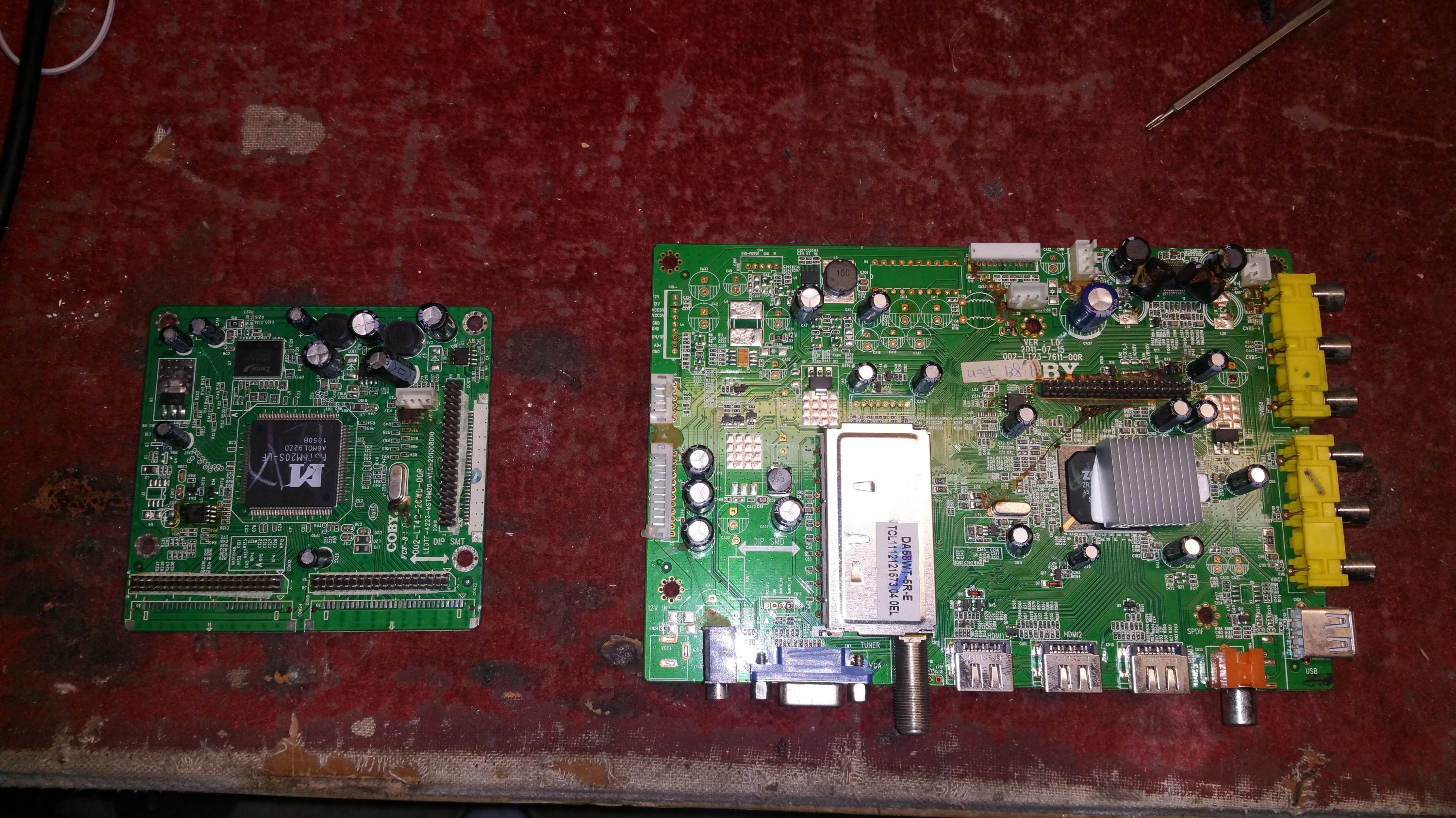

    Got this 55" COBY in. The problem was that when powered on, it wouldn't always come on. When it did, the display went wanky, like someone was pushing a bunch of the buttons (VOL, MENU, etc etc) and then would go off by itself, then come back on over and over..
    I was thinking a wanky MAIN board, but when I cracked it open, I noticed a weird "kludge"...

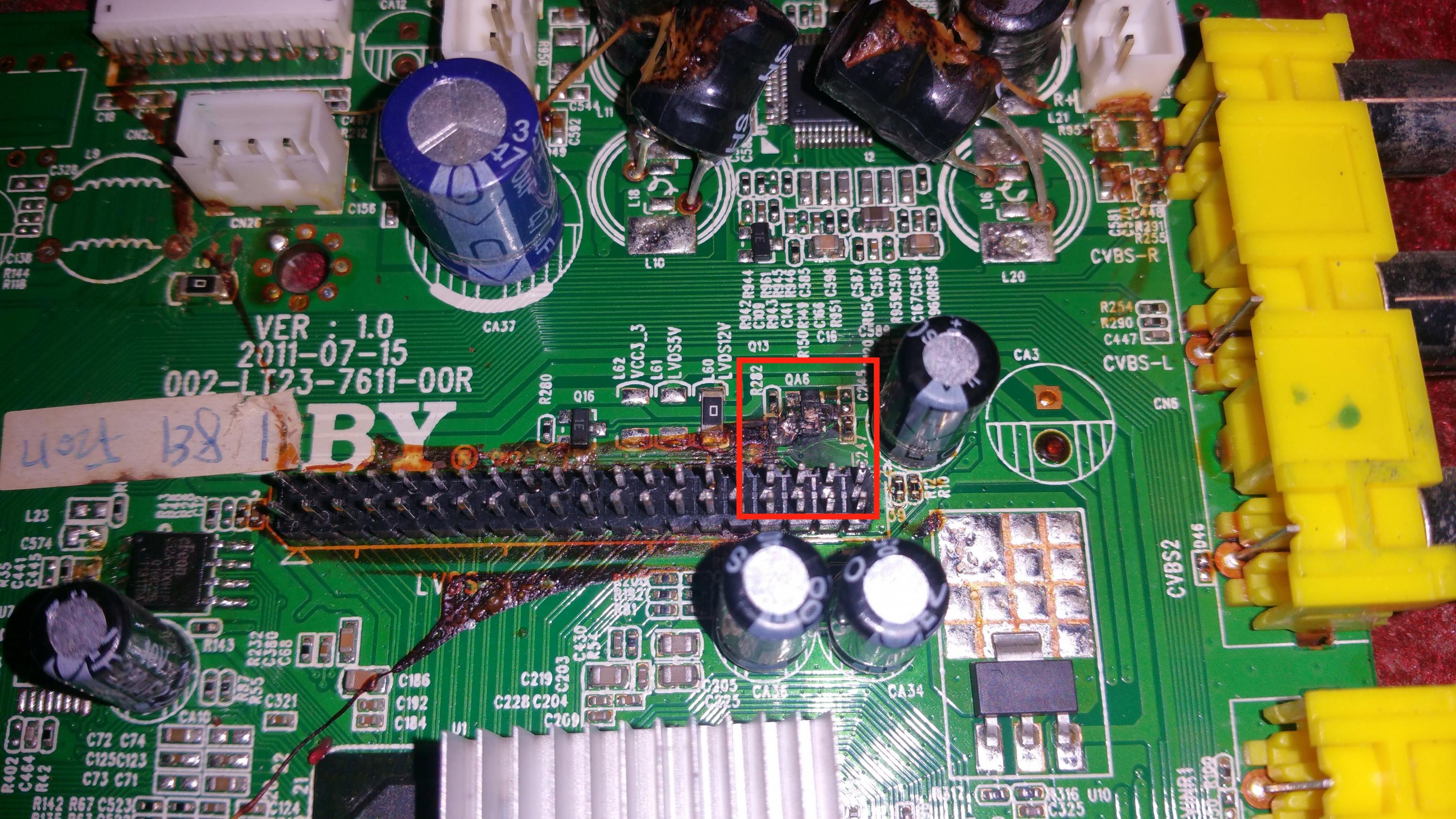

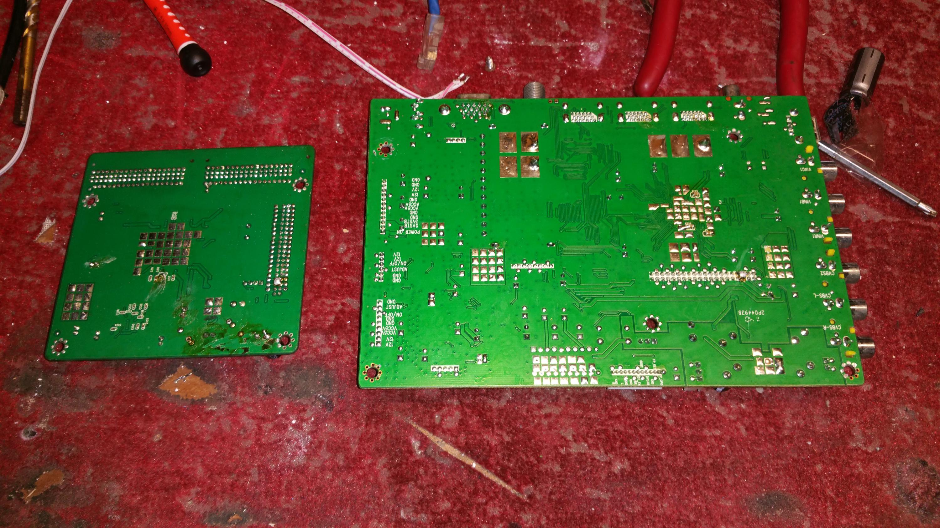

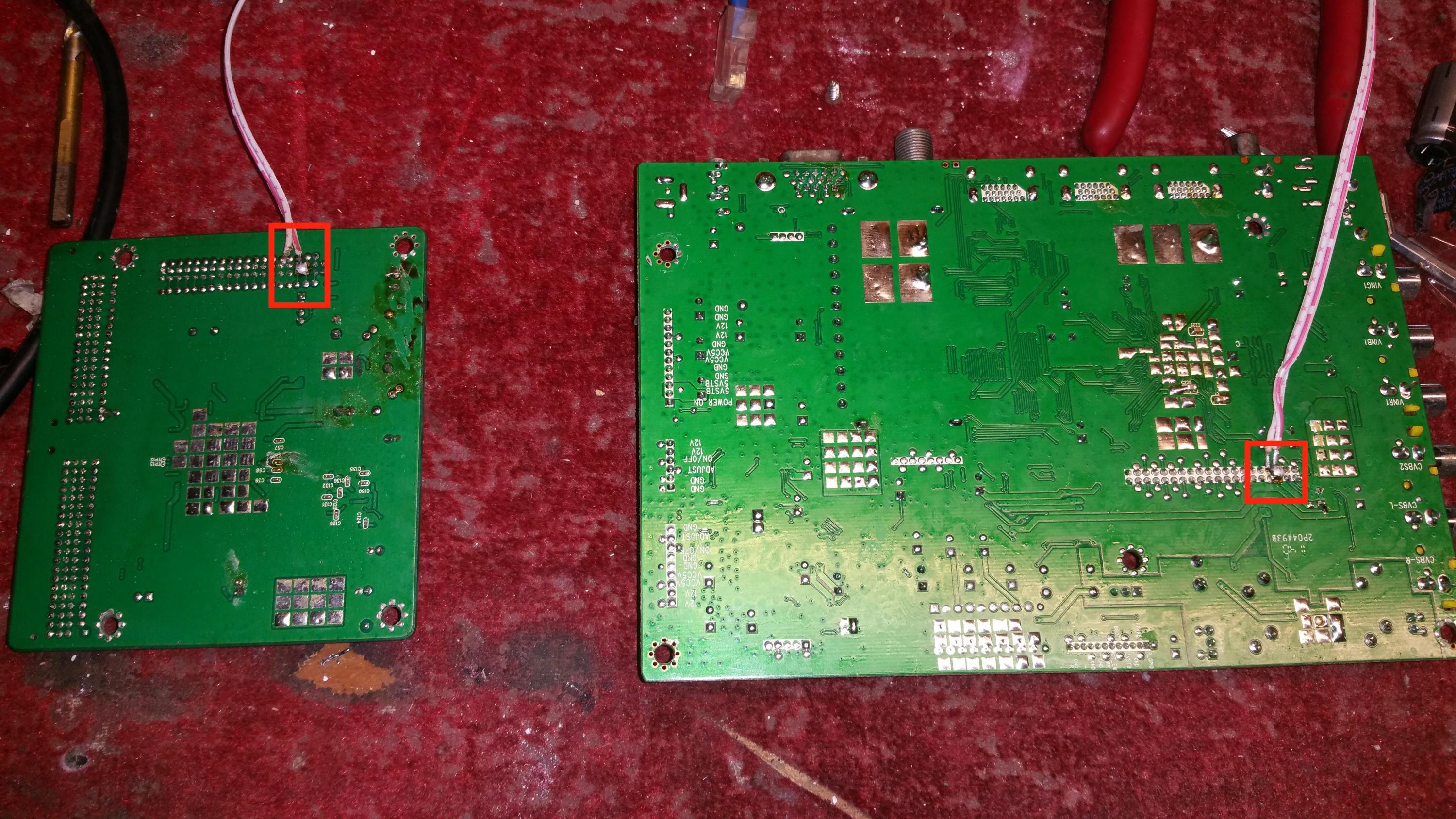

    As pictured, on the back of the MAIN board and smaller (Driver??) board, there was a 2 strand wire that went from 4 pins on the LVDS connector on the MAIN board to corresponding 4 pins on the LVDS Connector on the Driver?? board...

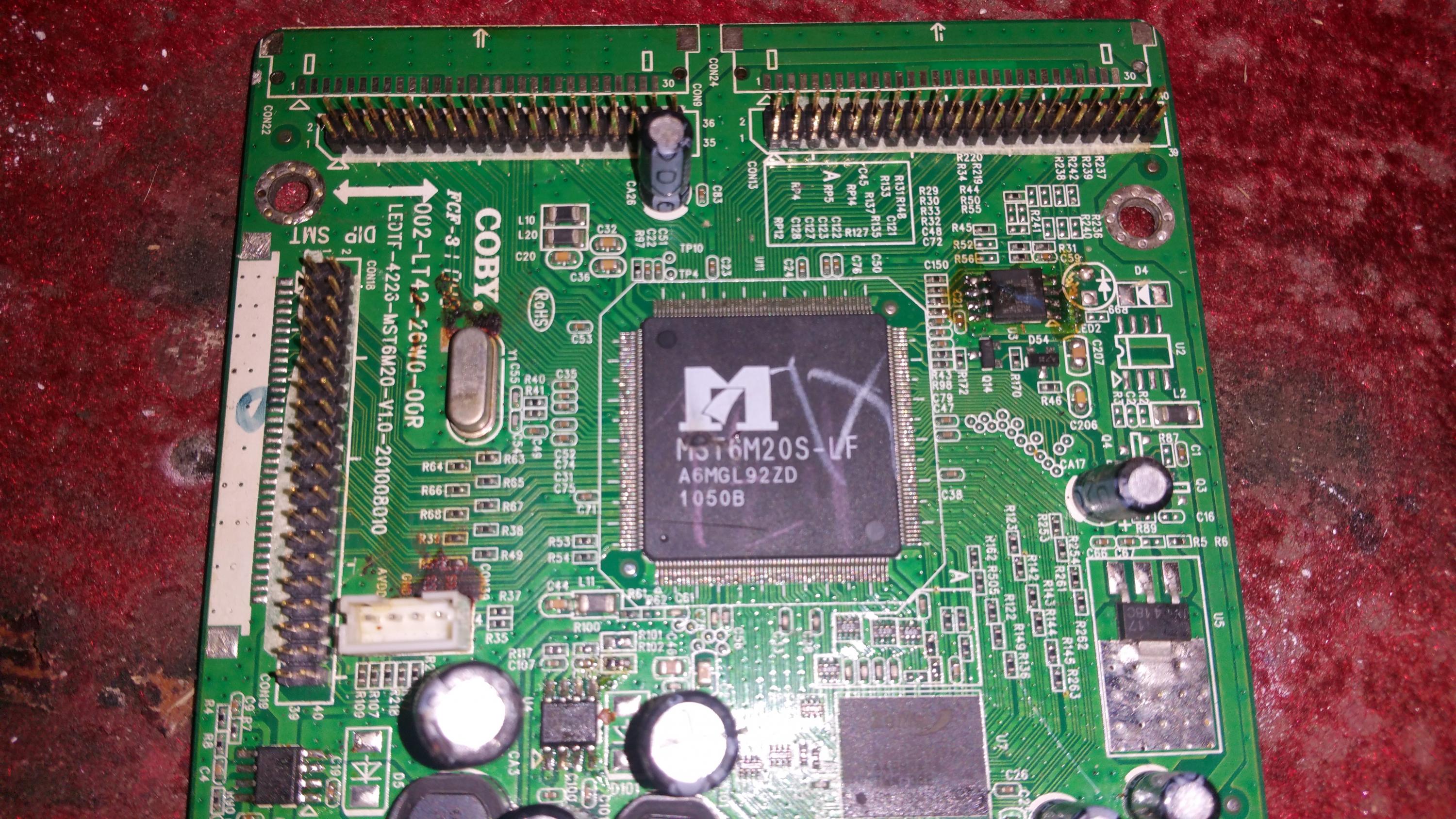

    Thinking that may have been the problem, I disconnected the wires and the main chip on the DRIVER?? board fried...
    I ordered a new DRIVER board, but am unsure if I should try it without the kludge or not..
    Any suggestions??

    I should also note that, on the replacement DRIVER?? board, that set of 4 pins are NOT jumper'ed together...

      The last pic shows the white cable and to me that does not look like a factory installed wire. It would appear to me that this TV was repaired before and some 'bypass' surgery was performed.

        Yep, that's my guess as well..
        I just don't know if removing it is what caused the big chip on the DRIVER board to fry or not..
        The board is cheap, so I spose I could try it.. I have a 50/50 chance Fry or NO Fry

          If it was working before with it there, I would leave it and give the new board a try. Is either it works or it doesn't.

              Hooked it all up and powered up.. Nothing. No LED, no nuttin..
              I was getting voltage on the MAIN board so I looked deeper..
              Looks like a component next to the LVDS connector on the MAIN board got fried as well..
              Ordering a new MAIN....
