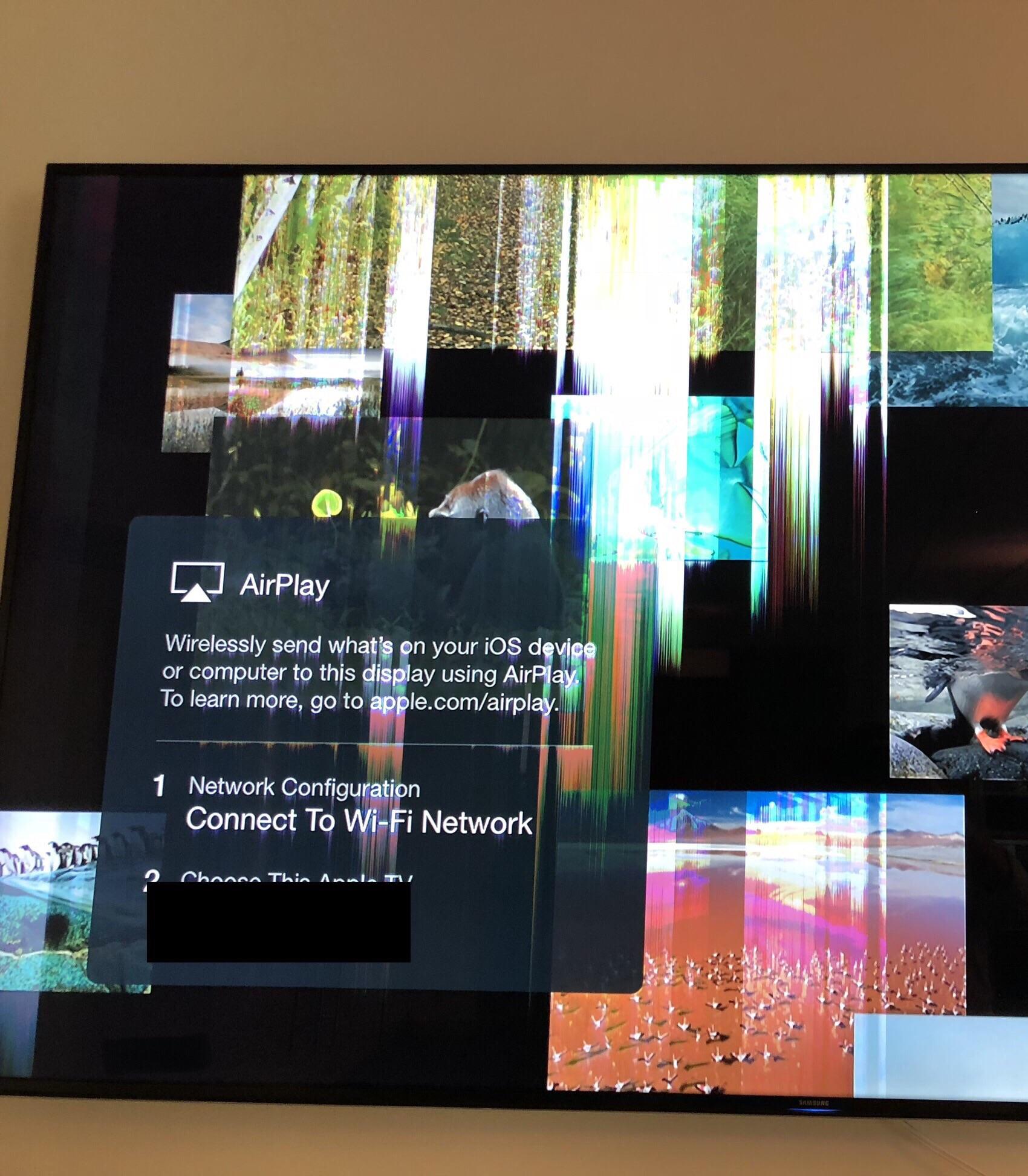

    Samsung UN75HU8550 vertical smearing
    I managed to score a free Samsung UN75HU8550! Unfortunately, the color is smearing vertically. The smears move with the picture and change related to other parts of the screen. It also smears on the settings menus, not just on input video.

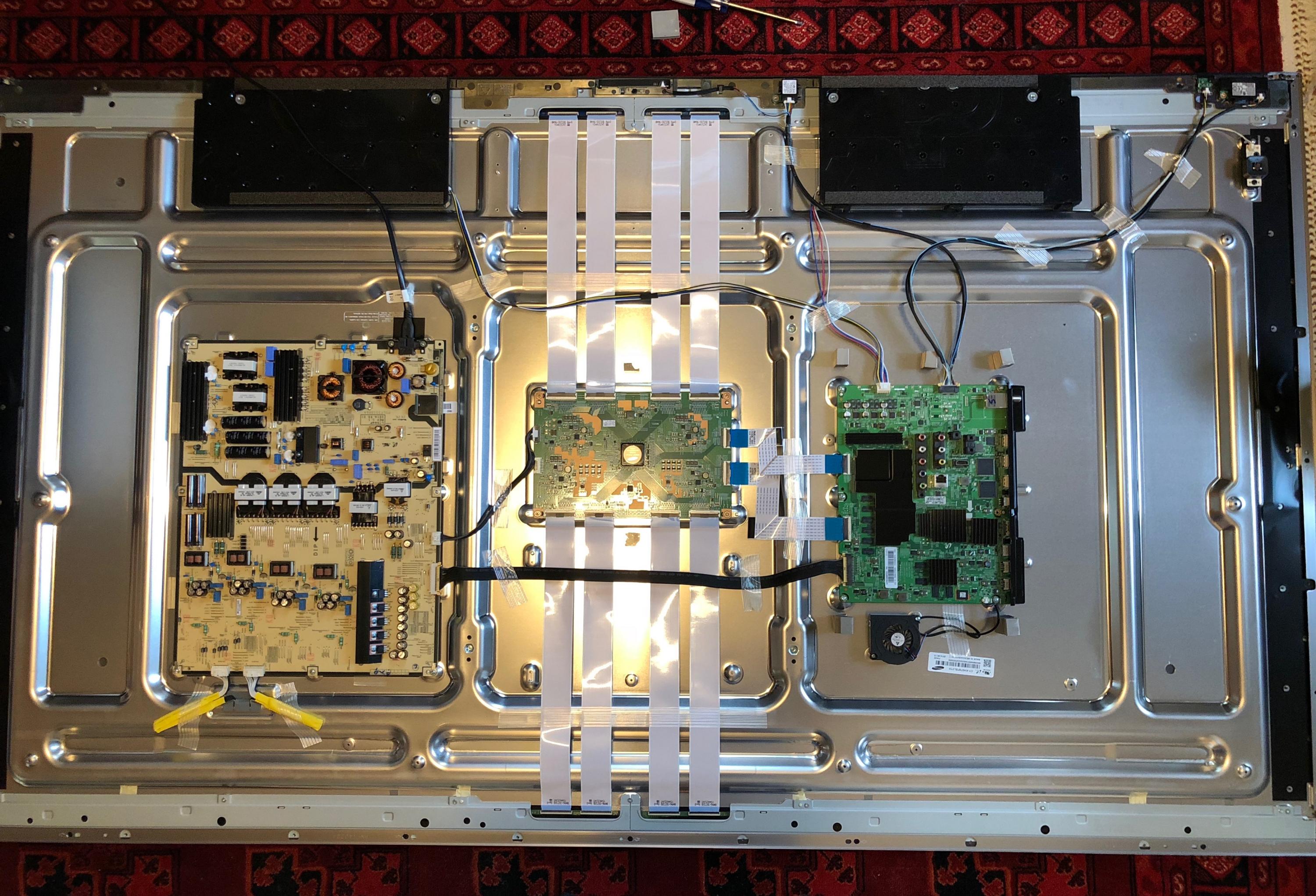

    So far I've gotten the main back panel off and did a visual inspection of the boards and reseated the cables connecting to the t-con and main board without any change.
    If I flex the panel it does make the smearing slightly longer or shorter vertically depending on which way I flex it.
    What should I try next? Based on the flex I'm thinking I need to get to where the cables connect from the t-con to the panel... or maybe the panel is just bad...

    I removed the rest of the back of the TV to expose where the ribbon cables from the t-con connect to the panel. I tried lightly pressing on the connectors, both on the panel and the t-con, and didn't see any change in the smearing on the screen.

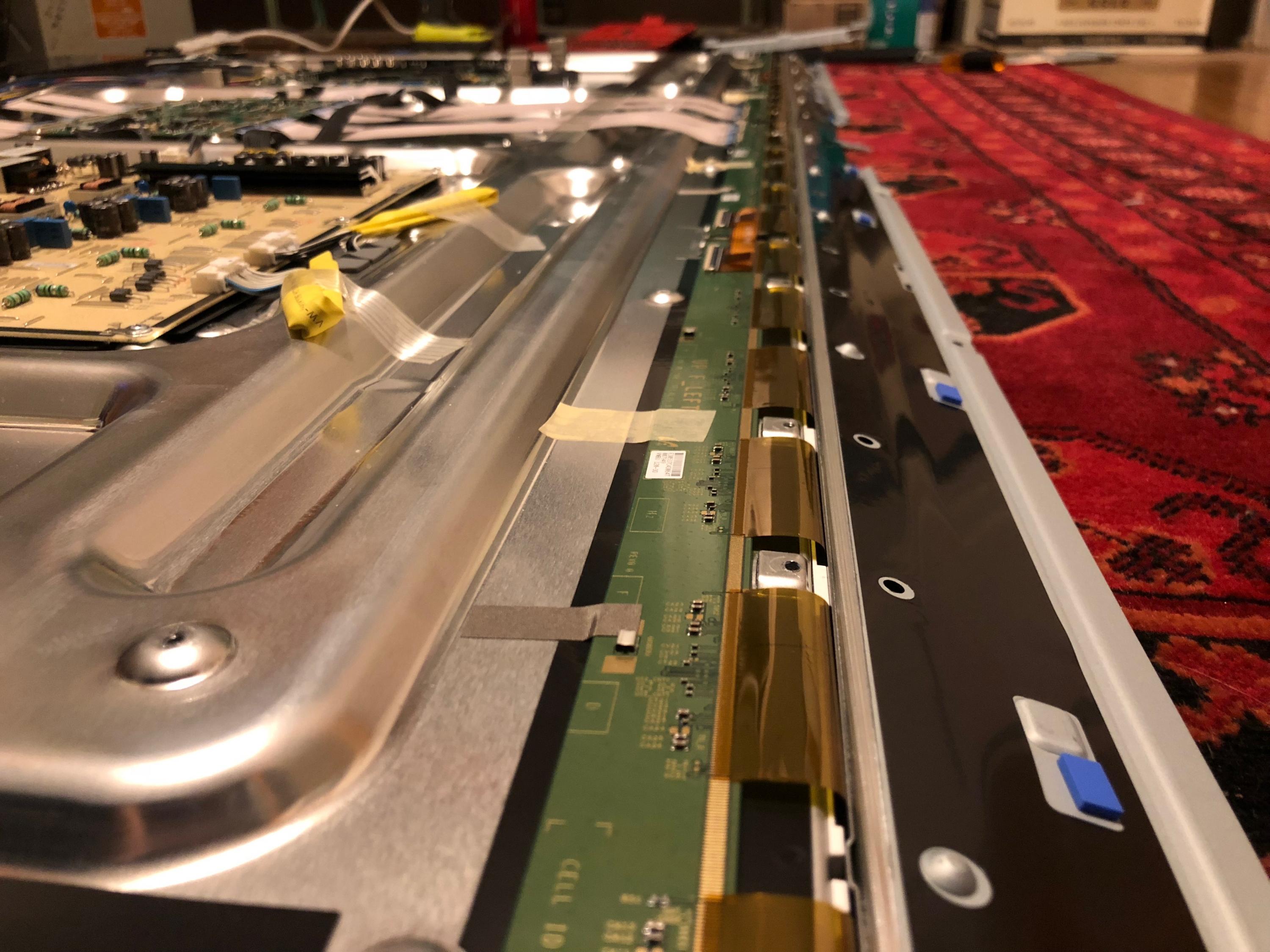

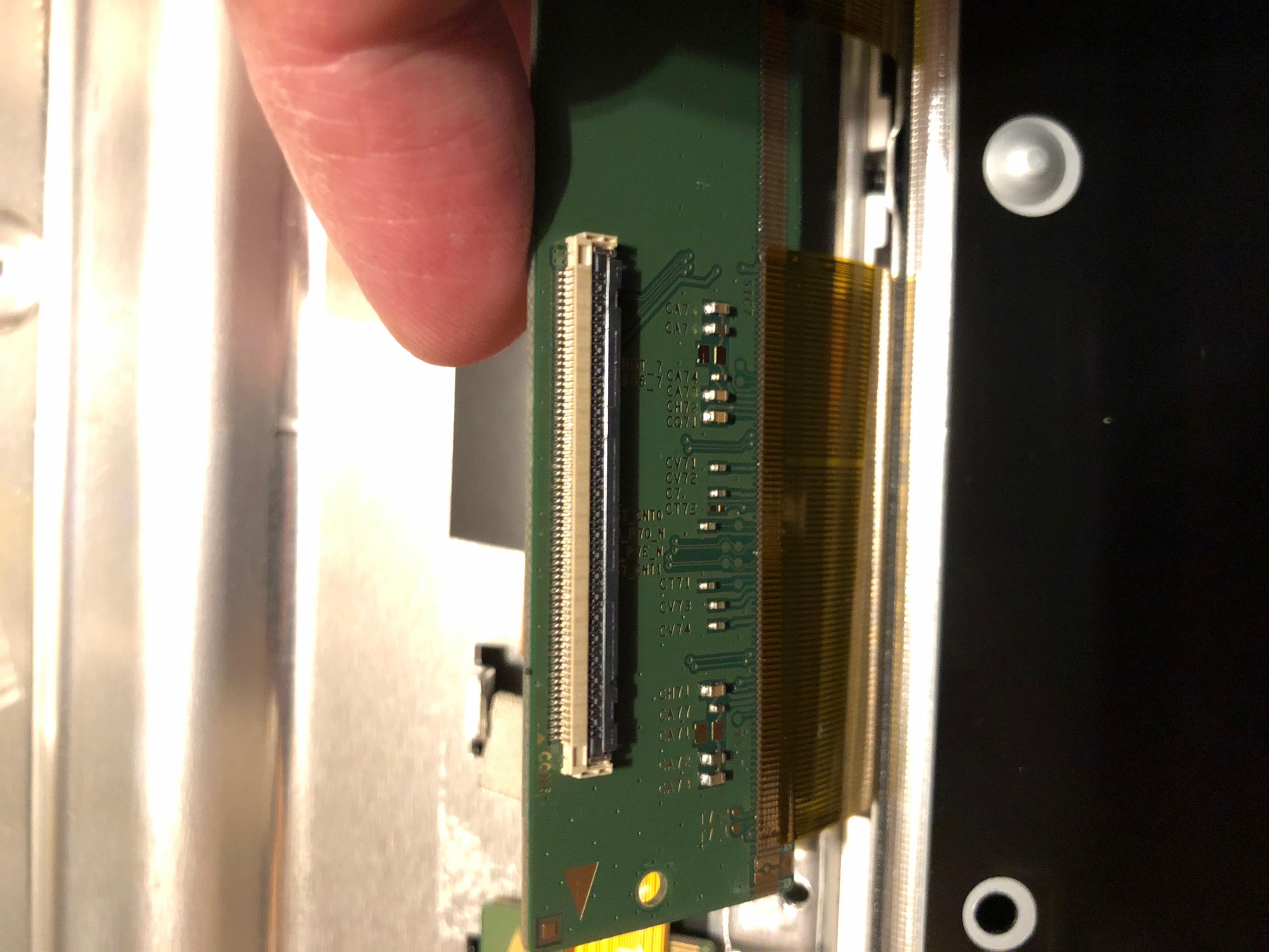

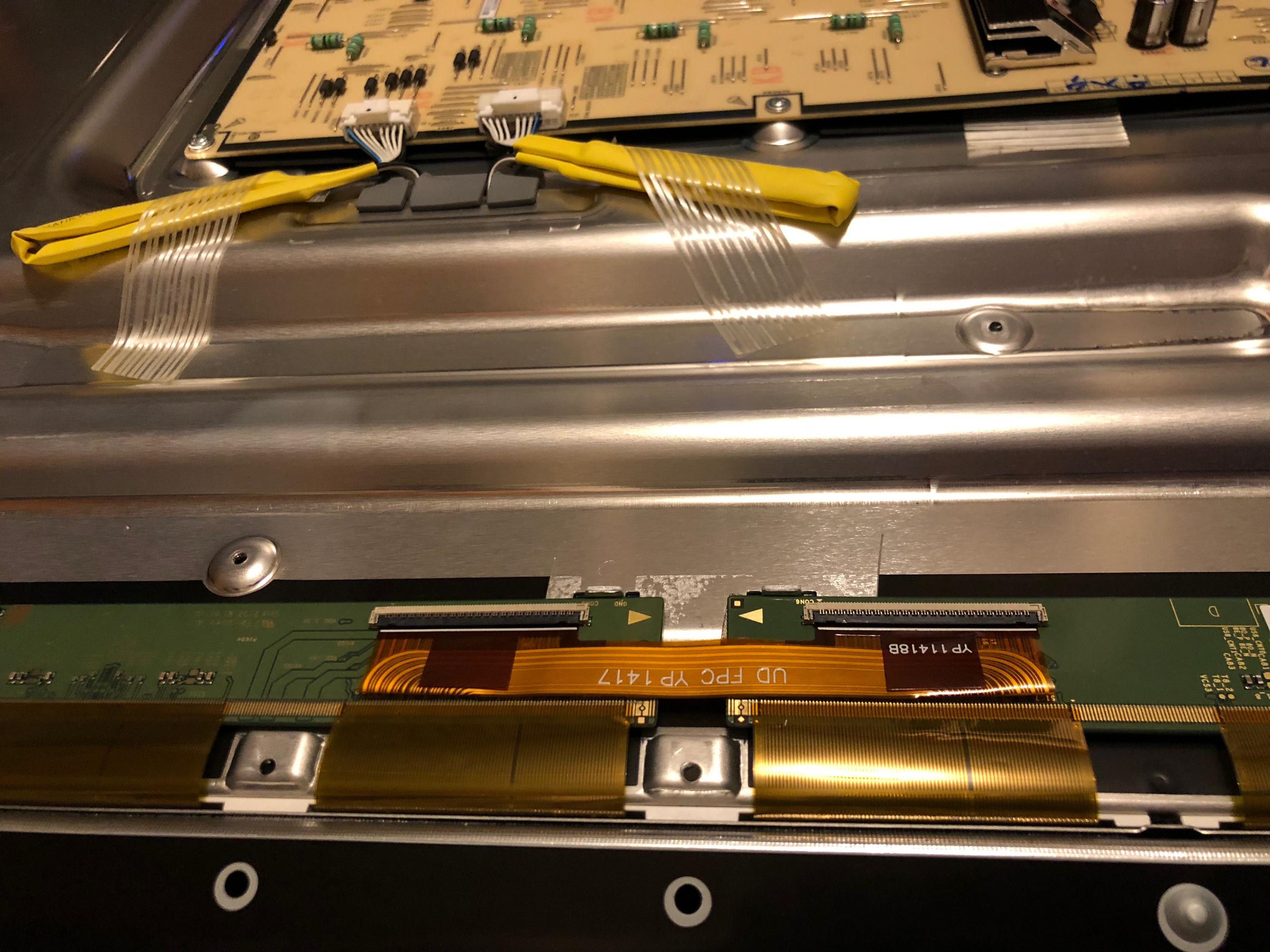

      Welp, forging ahead. (sorry for the solo forum blogging, this just seems like the place for folks with problems like this so I'm just having at it)
      I got the shielding off near the top of the tv that housed whatever boards bridge the cables from the t-con to the lcd panel (photo 1).
      Powering it back up... pressing on those boards, specifically the cables that join the boards on either side (photo 2 & 3) reduces the display corruption by like 50%! Hurray! Lets just clean those connectors and inspect the solder joints (photo 4) and power it back up with the boards free floating...
      ...and no change when pressing on the connectors independently from shifting the boards around. Pulling on the boards to put a little tension on the ribbon cables that go under the steel backing to the panel reduces the corruption around 75%... sigh. I guess we have to go deeper. The amount of disassembly required for the next step is a little concerning, but it is what it is I suppose.
      • nomoresonys
        • Jan 2013
        • 12330
        • U.S.
        Re: Samsung UN75HU8550 vertical smearing
        Looks like bad tab bonds, check youtube for shimming, works good sometimes if you can get the shims just right, can be a real pain getting them right tho.

              I got back to troubleshooting this TV again after taking a break for a bit. I took off the outer metal frame to expose the flex ribbon cables that connect the driver boards on the back to the front lip of the panel. Once that was off it was very obvious the source of the heat along the top of the TV were the long Chip on Flex chips. The chips over the parts of the panel with the smearing got extremely hot while the others were just fairly warm.
              By flexing the ribbon cable in different ways I was able to get the smudging to almost all go away, but not quite. Running a probe along the bonding between the panel and the ribbon didn't effect the display at all.
              Does this point to an issue with the chips/flex cable or just a side effect of a problem in the panel?

                Hi, it's reallly hard formeto understand all the posts without an internet translator, but i suspect the problem is in one or more chip on flat soldering, the problem is hard to outline to which one is the faulty tab and even if you find the one, are you able after to get the liquid glue remover and then do a reflow on it? The hot tabs are in the horizontal row or on the vertical part?

                  With the Chip On Film (COF) getting hot like that means the chip is on its way out and the only way to fix this is with a Tab Bonding Machine as the COF attaches on to the Panel. You could try tightly fitting heat removing foam between the metal frame and the chip surface as a temporary fix.
