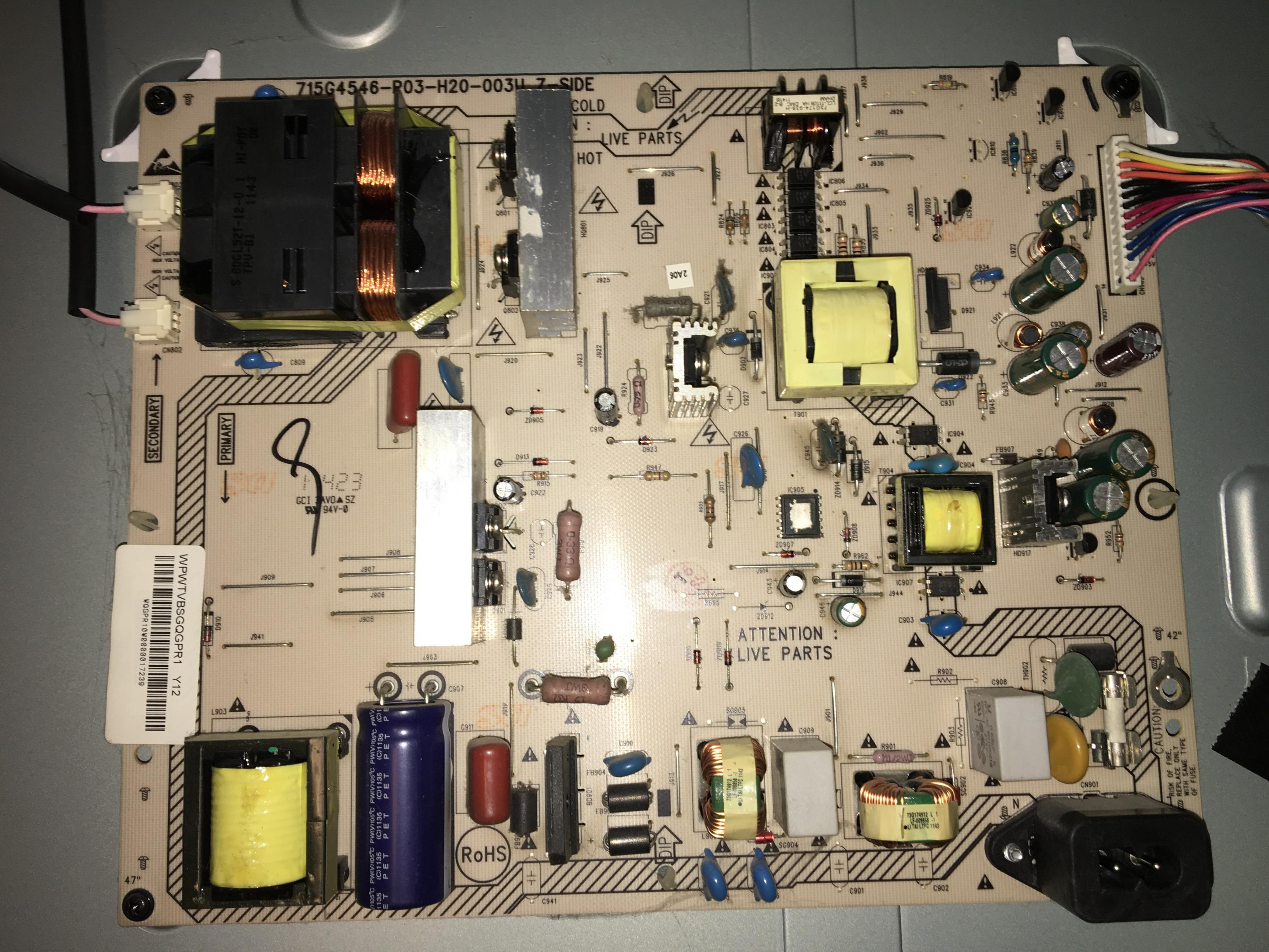

    hello everyone!
    I am new to this forum. I joined in order to search help for an issue i am facing with a personal TV. I am not new to electronic repairs, but i am not very familiar with tv stations. i do mostly smd rework and playstation repairs.
    This Tv I bought a few years ago, a philips 47PFL4606H/12. i purchased the TV as faulty, the antena receiver was not working properly, the image had noise because the antenna was broken and poorly repaired. i bought another motherboard quite cheap, which i used until today.
    The problem is that the backlight started to make strobo effect. Initially this happened when i started the TV, and dissapeared after it warmed up. then it started doing it most of the time. i took it apart thinking that the caps from the invertor board might be bad. but this tv has the invertor on the power supply board and all the caps looked fine. I put it back together and updated the system software. It worked great for about a month, then stated doing it again. Meanwhile i repaired the original mother board antenna receiver so i took it apart again today because i could not use it like that anymore and put the original motherboard back in while cleaning and inspecting the power supply again. now seems that its working again, but i did notice the flicker two times for 2-3 seconds.
    Sometimes the flicker appears when changing the input, but it does appear on all inputs i tried (2 hdmi and antenna).
    I am almost sure that the issue is backlight related, but i dont know what to do to fix it. since its not doing all the time, its hard to figure it out. i noticed that the more i keep it plugged in (turned on or off does not matter) the more often and longer the ficker occurs.
    here is a video with the same model of tv and same issue i found online
    another video, same problem, same model

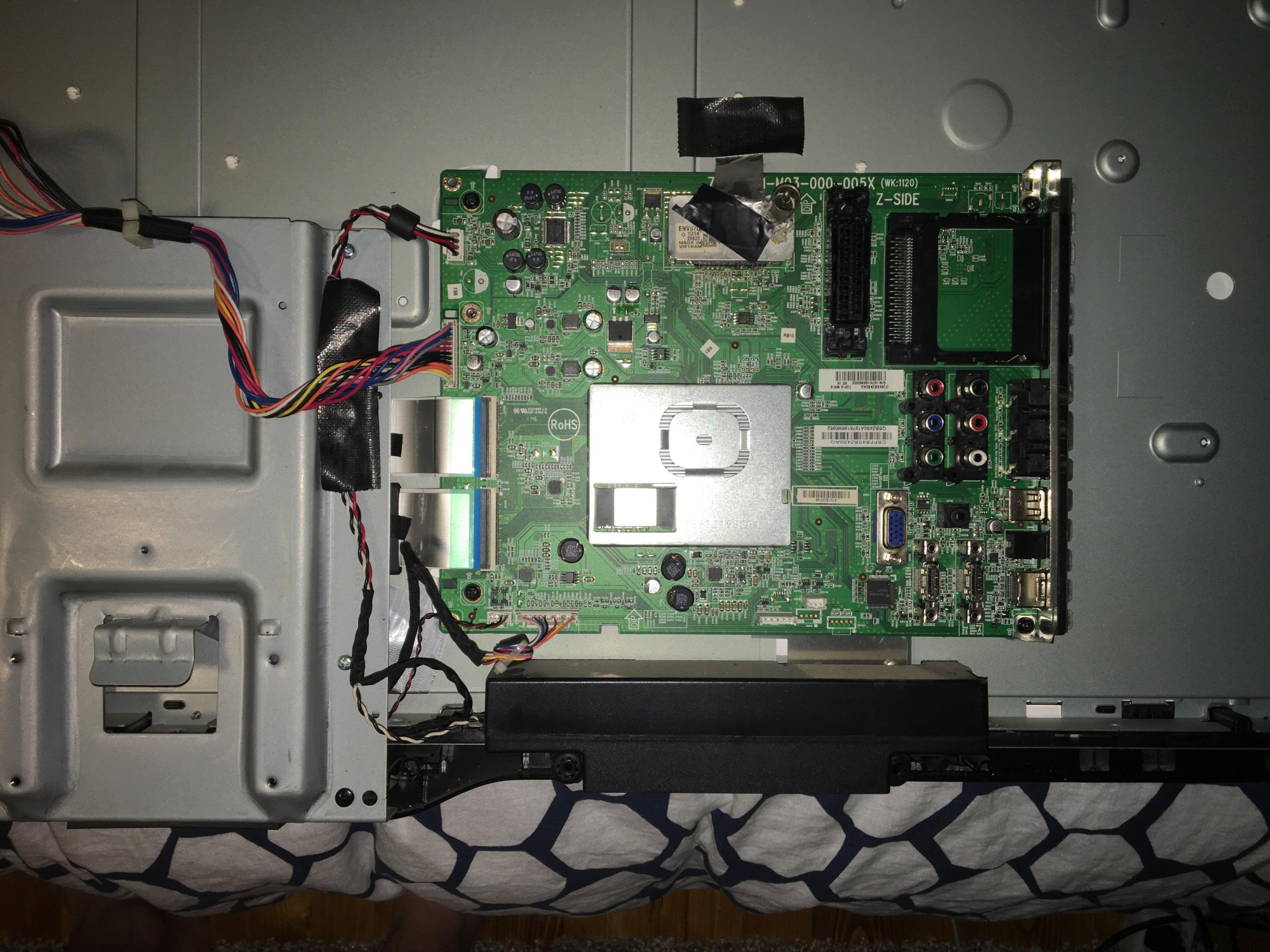

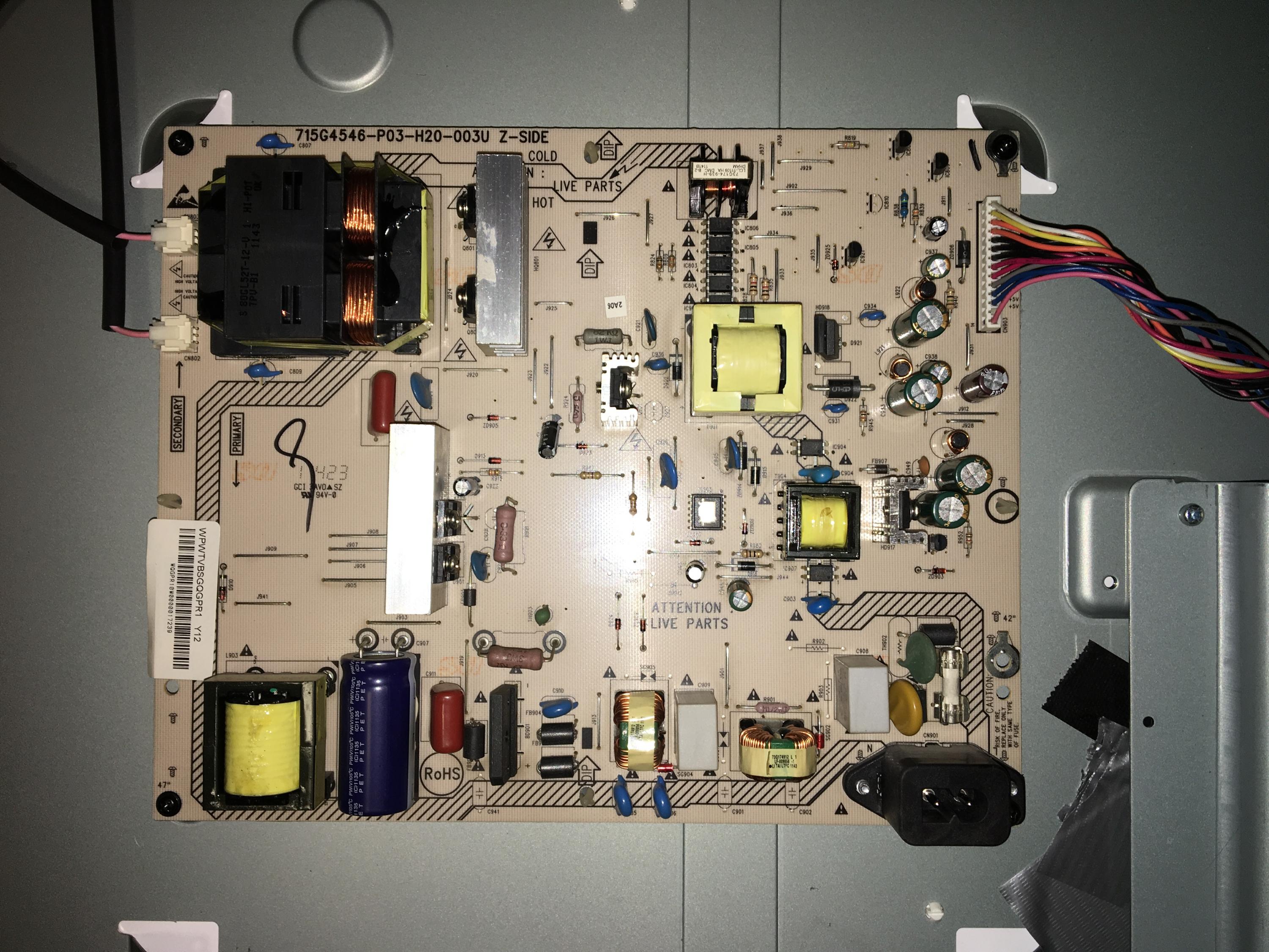

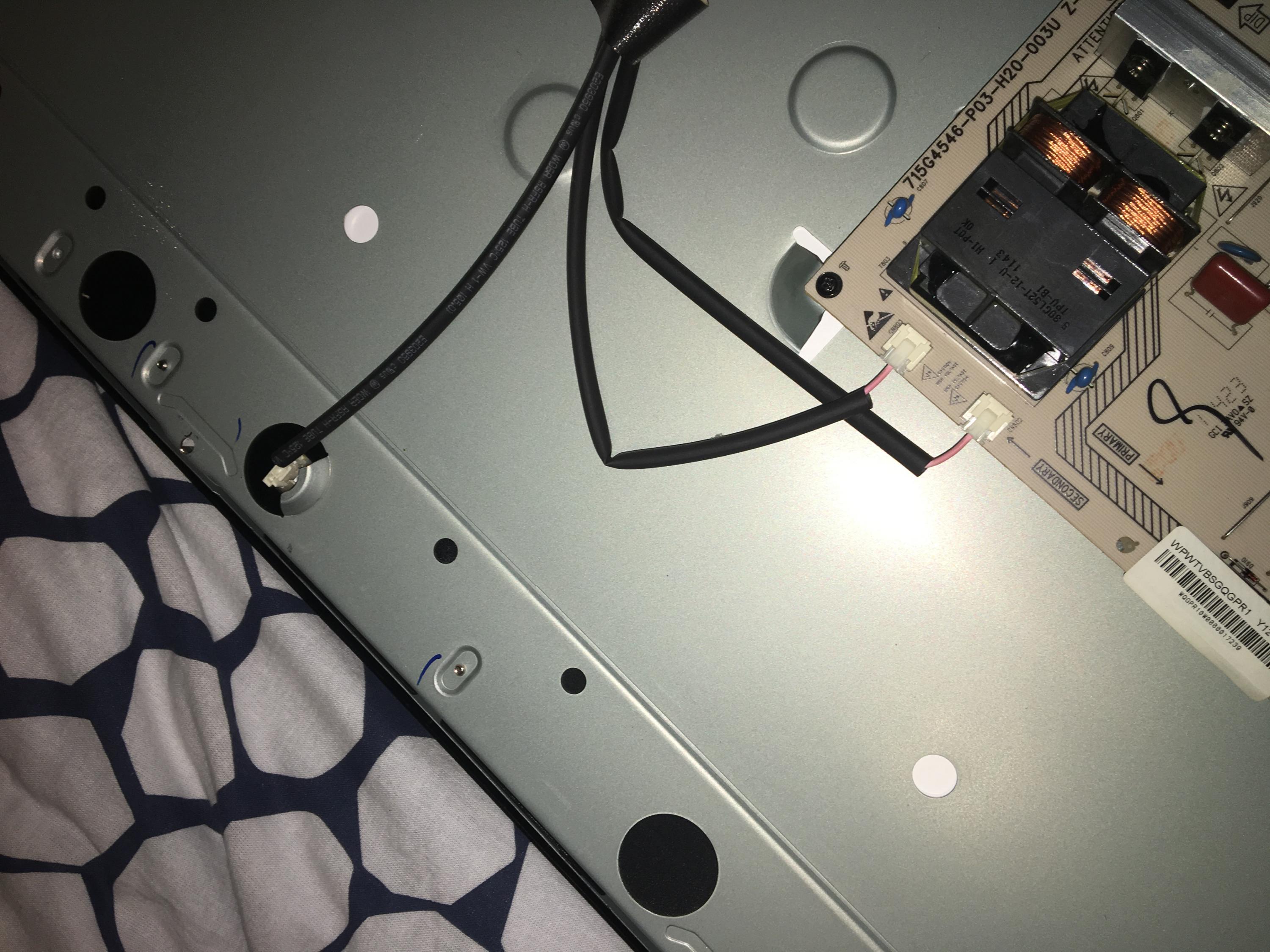

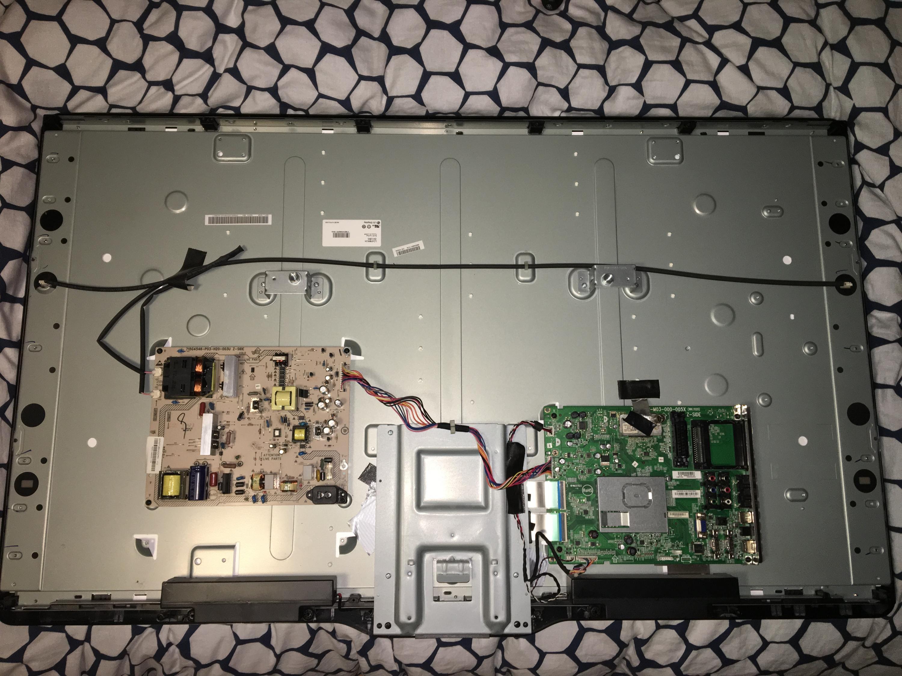

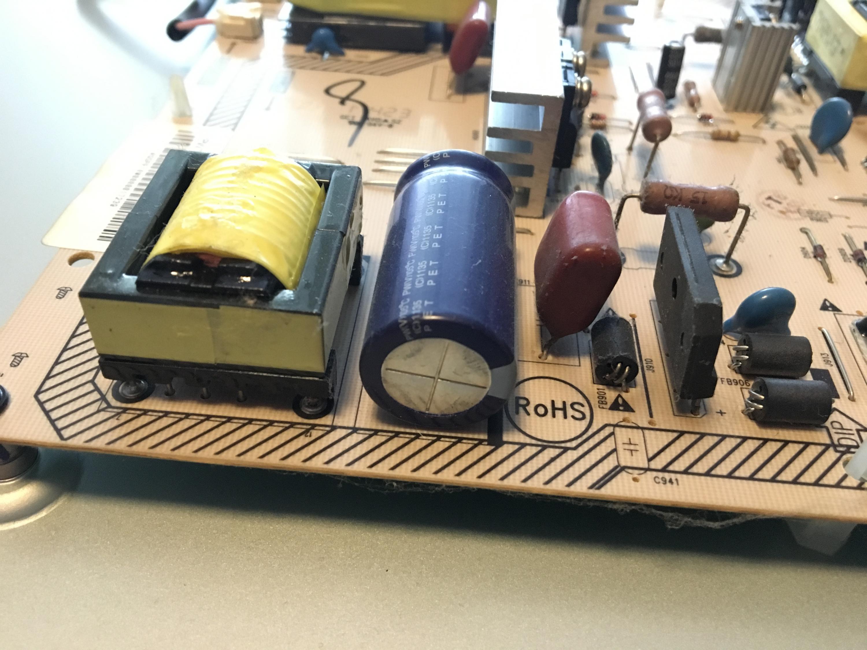

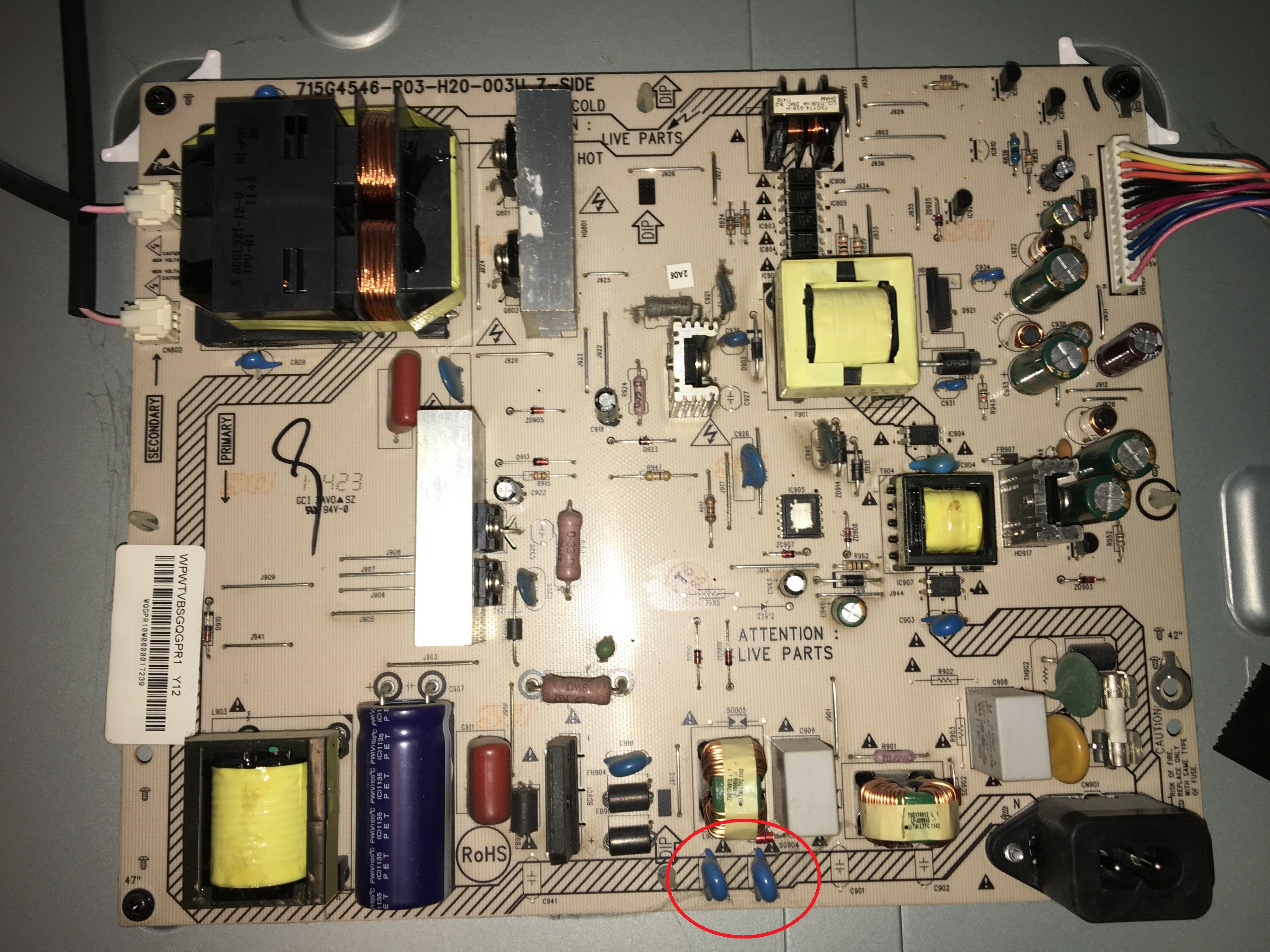

    I also attached some pictures of the power supply board. i would start by replacing the big capacitor 450v 120uF but again, i am not a tv techician. so please if you have any advice let me know.
    Also the power supply is making a buzz noise ever since i start the TV. It has been like this since i bought it. i am not sure if this is normall or not. You can only hear it if you are close to it or if it's silence in the room

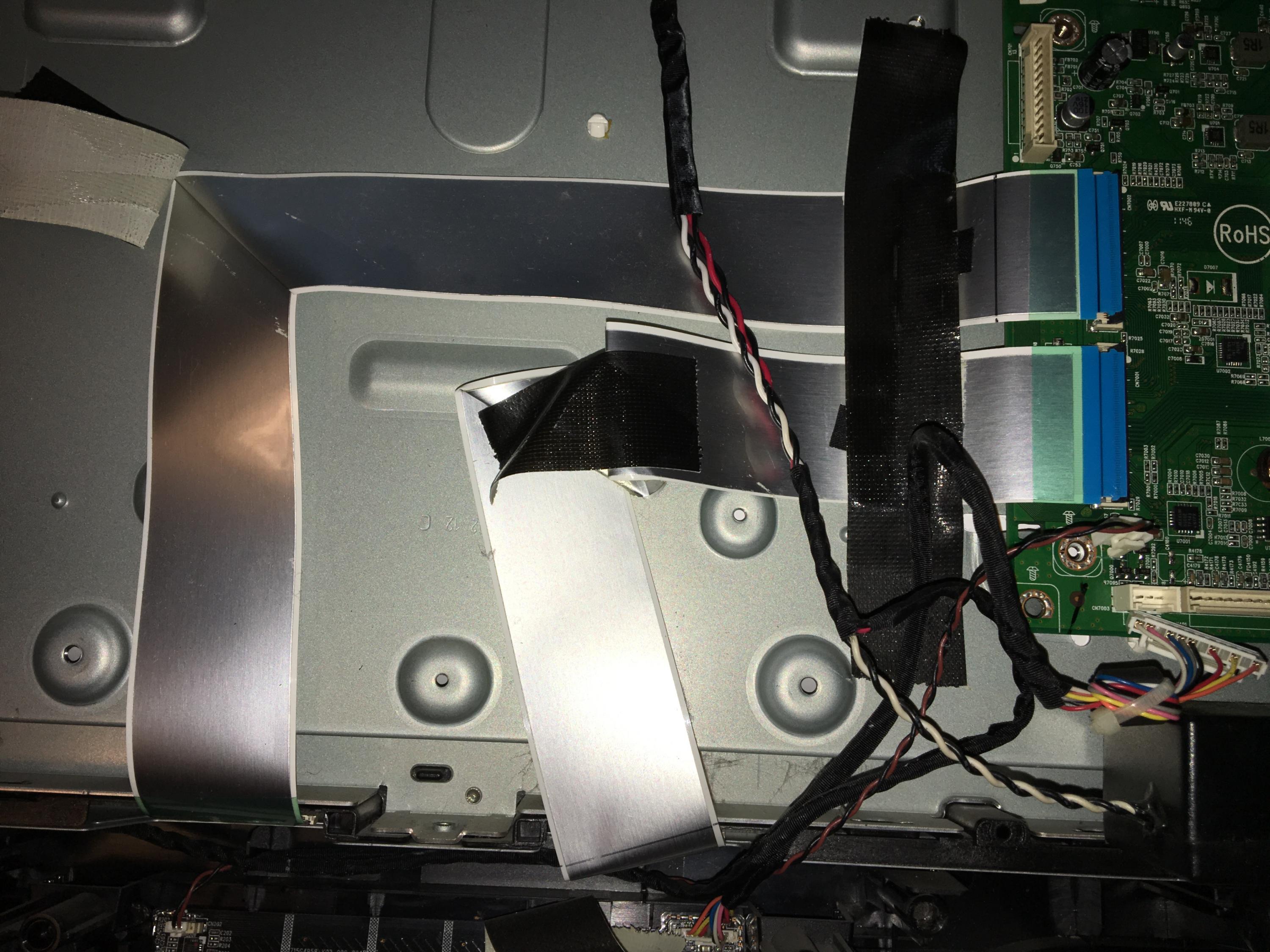

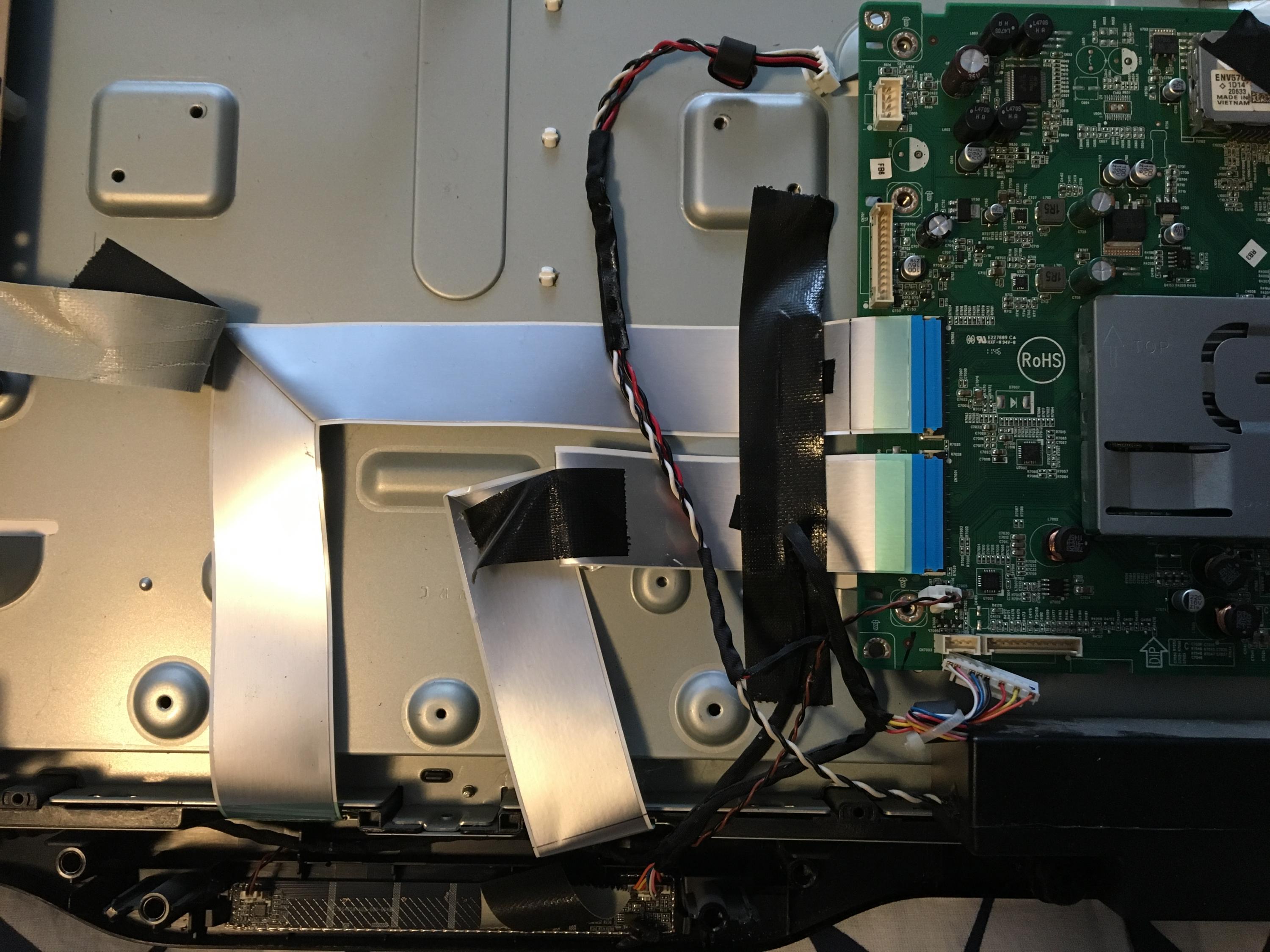

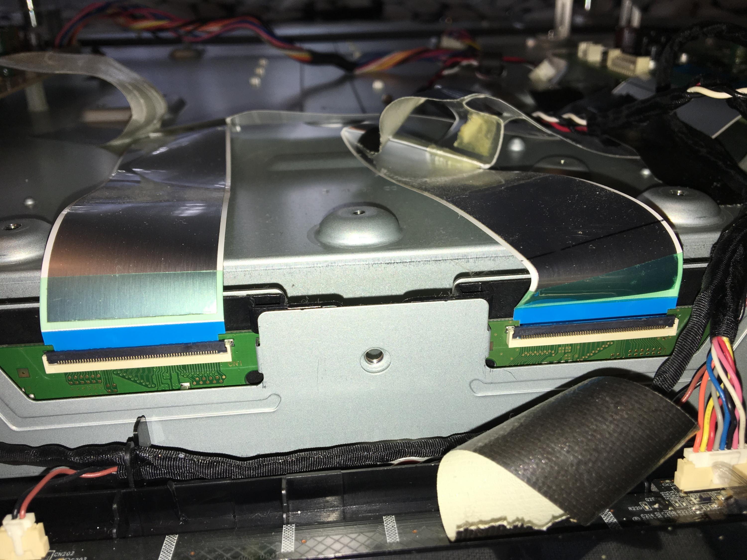

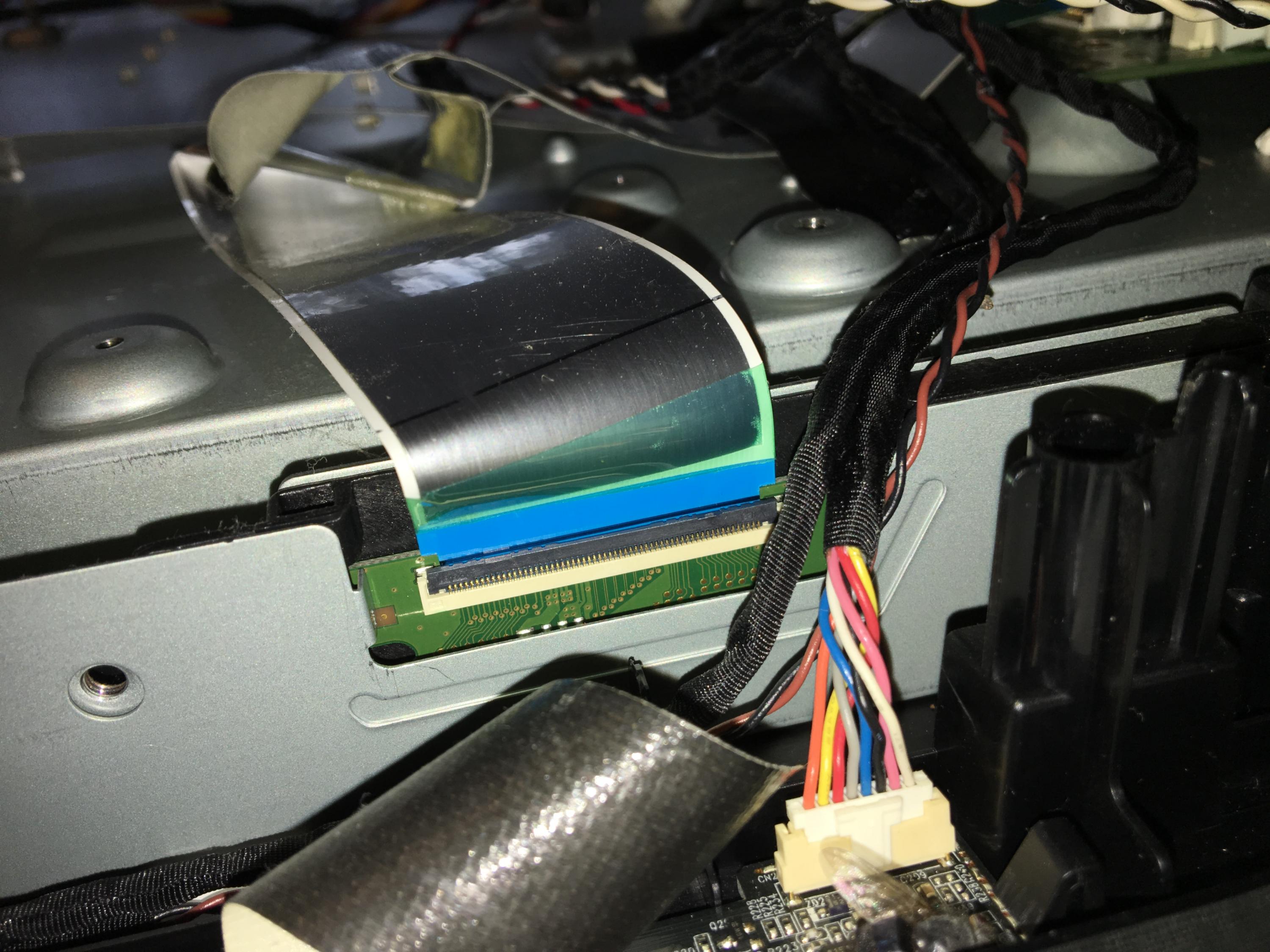

    EDIT: i found this video claiming that the problem was from the screen connectors if i understand right. they are not exposed and i do not speak russian. do you guys think i should take it appart and inspect the issue?

    You probably have failing backlight. ( CCFL tubes ).
    This is due to aging. The tubes are getting older and in the end its demanding more power from the supply which it cant deliver , thats why its flickering.
    You could try to check the powersupply and see if it needs resoldering on the transformer. Bad capacitors are not really a issue nowaways , it was with the older samsung lcd's.
    On the earlier ambilight models the blue ceramic caps near the trafo blew up stopping the tv from turning on. I think these 2 caps are there to prefent overcurrent because the ccfl tubes are demanding more power.
    I think you can remove them and it will probably "fix" your issue but i need a expert to confirm that....
    It is basically the same as the tubes you see in old sheds. They blink a few times before turning on or blink ocassionally and have black spots near the 2 ends.
    So besides checking the solder there is not much you can do unless you have acces to CCFL tubes.
    http://backlightweb.co.uk/index.php?..._image&pID=541 <- this is what you need.

      thank you for your reply. i was thinking as well that the ccfl tubes might be dying, but since the flicker is equal from both sides, i thought that it can not be such a big coincidence that both are dying in the same time. that is why i started thinking about the power supply. but what you are saying could make sense as well. i am not an expert either.
      if that is the case i would replace the tubes but i do not know where to buy them from. I really want to repair this tv. it might be an old tv, but i love the image quality on it.
      meantime, i opened it again to check the ribbons the russian guy showed in his video. mine did not have any holes in them so i think the problem is not from there. they were however not sitting straight at all (see pictures). I took them out, properly cleaned them with IPA, put them back on and taped them straight and nice.
      The tv is running for about 3 hours, no flicker until now... but last time i opened it there was no flicker for about 1 month, but once it starts then i have it eveytime i turn on the tv. i dont see any connection here...
      but i would replace the ccfl tubes anyway.
      edit: i just looked at some pictures online and saw that the ccfl tubes are positioned horizontaly and not vertically as i thought. its same as in Led tv's just that its ccfl tubes. and its more then 2 as i thought, so it looks like i need a whole kit.

            Did you check the powersupply for bad solder on the transformer? You could lower the backlight itself in the menu.
            If that does not work you need replacement CCFL. They sell it as "CCFL 1075 mm or 1077 mm".
            https://www.lcd-chip.com/ViewDetails12277.aspx
            If you cant find the replacement CCFL you can try to remove the blue caps as last option.

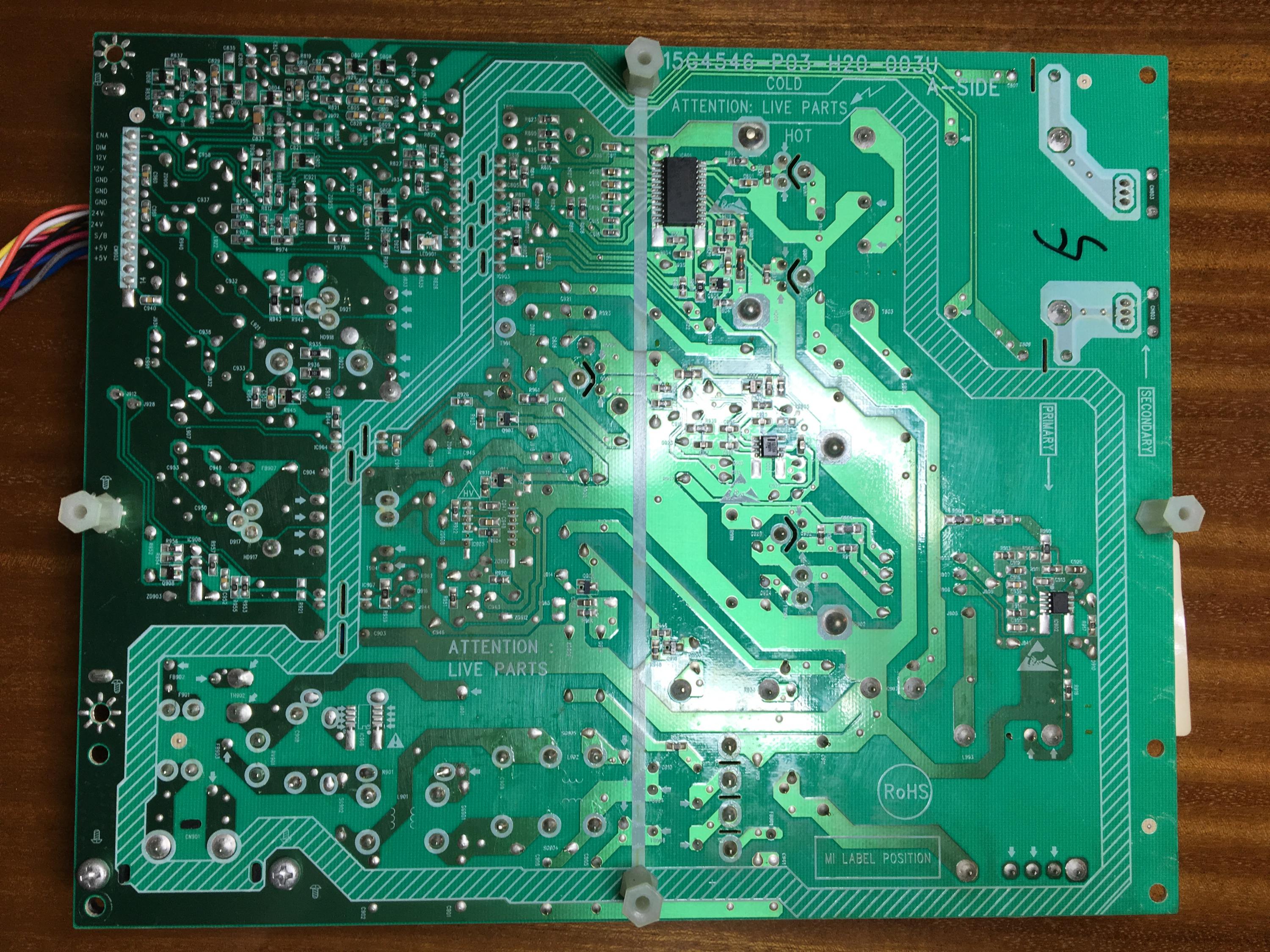

              service manual on page 59 there is a diagram of the invertor circuit. i can see there is an invertor controller ic there (i saw it on the power supply board as well). can these go bad?
              edit: the capacitors that you mentioned removing, are the ones in the picture below? C905 and C906, can be seen in the diagram on page 58

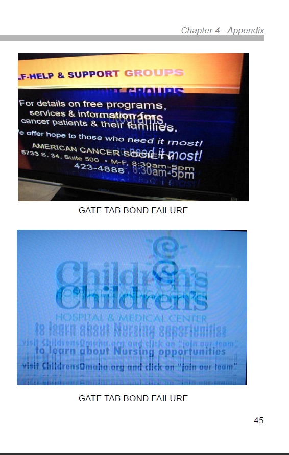

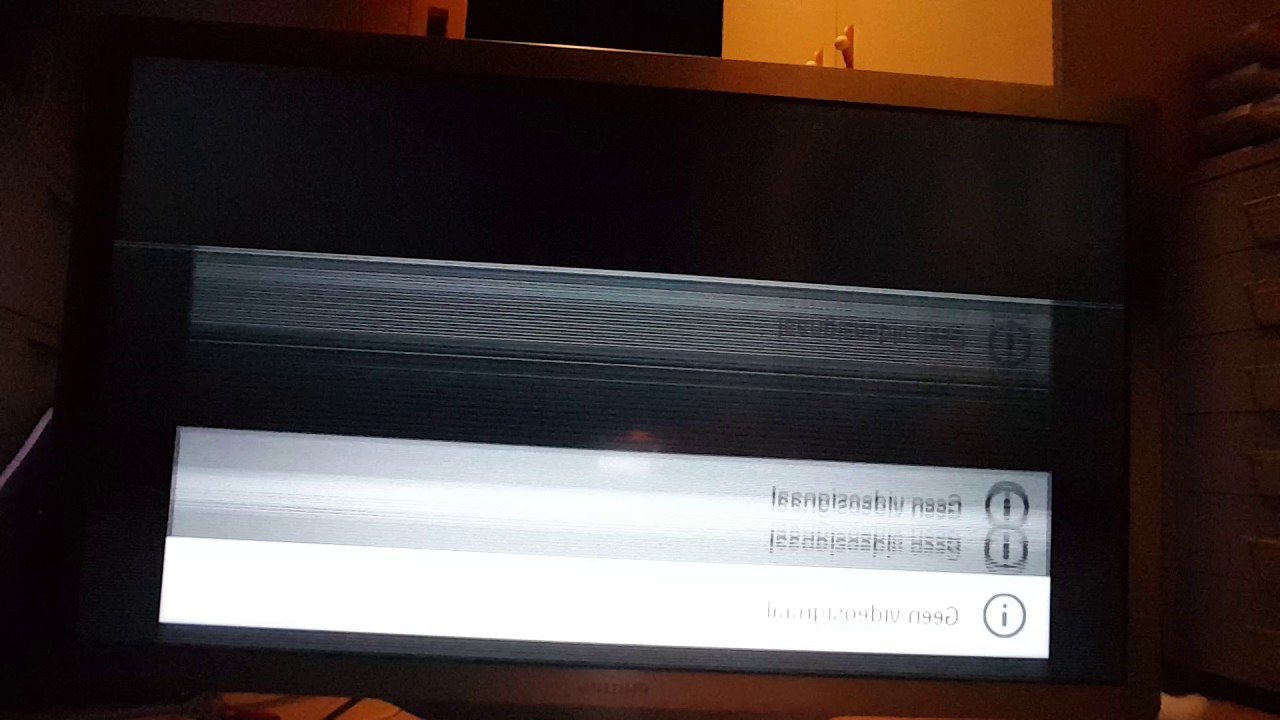

                Re: Philips 47PFL4606H/12 flickering issue/strobo effect
                Just curious, if look at the LCD panel on the back side holes, do see flickering lights?
                To me it looking like the video flickering not the backlights due to failing panel.
                https://www.badcaps.net/forum/attach...8&d=1528759630
                That is LCD panel problem, Gate tab bond failure.

                    looking at the manual you posted i think i had more like a GATE DRIVER FAILURE then gate tab bond failure. but this thing happened so rarely and lasted so little that i am not able to make a picture. i did not see this thing for months
                      You are getting multiple images.

                        that picture is from the internet. i just said i had something a little similar, but i did not get double image. my problem is not the panel, it is 100% something related to the backlight or power supply. i can see the backlight flickering in the back of the TV

                          What PFC boosted DC Voltage do you get by measuring right between the two legs of the 450VDC main filter cap? This flickering reminds me of the Samsung with flickering backlights due to low PFC Voltage.

                              i have 371 VDC between the legs of the 450VDC capacitor. Also i can 100% confirm that the backlight is flickering as i can see it when i take the cover off. also the constant sound i am hearing is coming direcly from the inverter.
                              is the voltage right? because i can not find anywhere the value it's supposed to have.

                                The Boosted Voltage typical value is between 380 ~ 400V DC. Your schematic shows 395V on page 59 (EN 59).
                                In Samsung, 360V and below will trip under Voltage shutdown, but I do not know if Philips has that protection circuit or not, so far it does not look like it has UV detection.
                                1130 Hours is very low for TV.
                                I sure hate to open the panel to find out that the lamps are OK.
                                Did you verify that all the board mounting screws are tight? They use that for GND connection to the chassis and between the boards.
                                You have power supply/inverter board combo, so is there another board that the two HIGH Voltage wires from the power supply go to?
                                May be you should up load the pictures of the whole back side of the TV showing all the board.

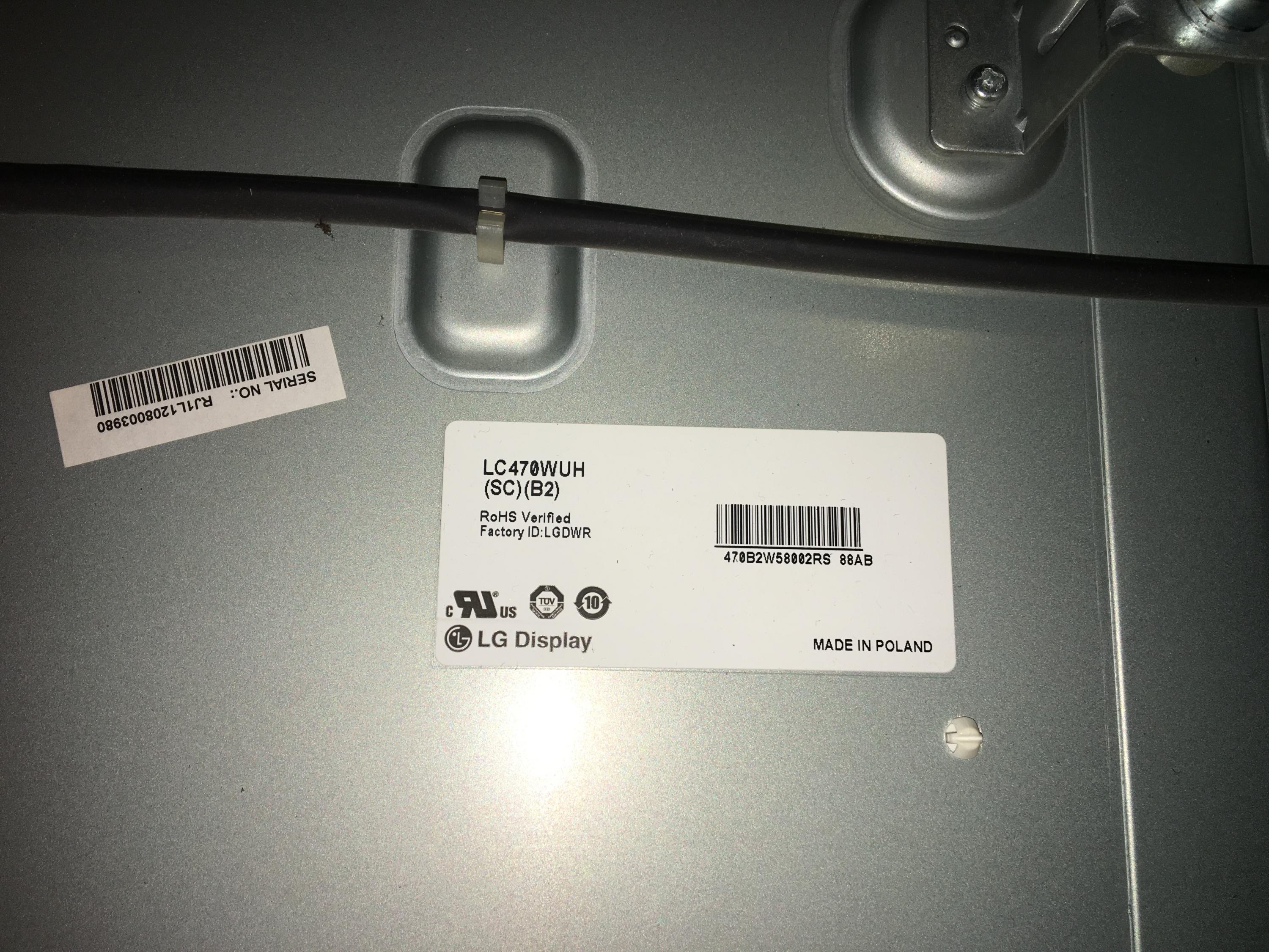

                                What is the LCD panel model number?

                                  the display is an LG LC470WUH

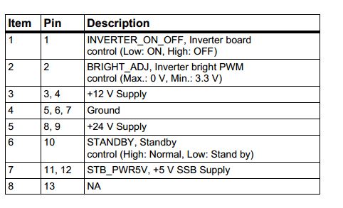

                                    The connector on that power supply board that goes to the main board, it has pin name for each pin but I cannot see them using your pictures.
                                    Can you please provide us the pin names for those pin?
                                    I wonder if the Dim control pin Voltage is not stable.
                                      you have a point there. just checked and remade the soldering on the PSU for pin 1 and 2. also on the motherboard connector pin 1 looked like it was not perfectly making contact. i took both pin 1 and 2 out of the plug and made sure that they are tight.
                                      on pin 1 i have 4.95V
                                      pin 2 has 2.63V
                                      no fluctuations... I put all back together hoping the issue was fixed, the buzzing from the invertor seemed more constant but then i still got some flicker again.
                                      i also tried messing with picture setting on the tv. power saving preset did not do much, the flicker seemed even stronger. only "picture" preset seemed to reduce the flicker. anyway changing between them seemed to stop the flicker for a while then start again in 1-2 seconds.
                                      EDIT: seems like the buzzing sound from the inverter is GONE! the buzzing sound i am hearing now (the constant one) is from the motherboard, from under the heat shield when the "no signal" is displayed on the screen. if i try switching the channels i have no sound at all.(i have no inputs connected at this time) this is definately a new one
                                      EDIT2: i turned off the tv and turned it back on and the buzzing in the inverter has come back and it's covering the one from the motherboard. also i tried turning on with only 1 high voltage cable connected to the inverter and the buzzing was even more louder, annoying actually. maybe the inverter is the problem? also the flicker was back, even stronger with only 1 high voltage cable connected. during this time, voltage on pin 1 and 2 were the same, constant, no fluctuations
                                        Pin 2 is the backlights level adjust that control how hard the lamps are driven, if that control Voltage fluctuates then you will see the backlights not on steady, but you indicated that it is steady.
                                        If you remove that wire to pin 2, the backlights will be on full.
