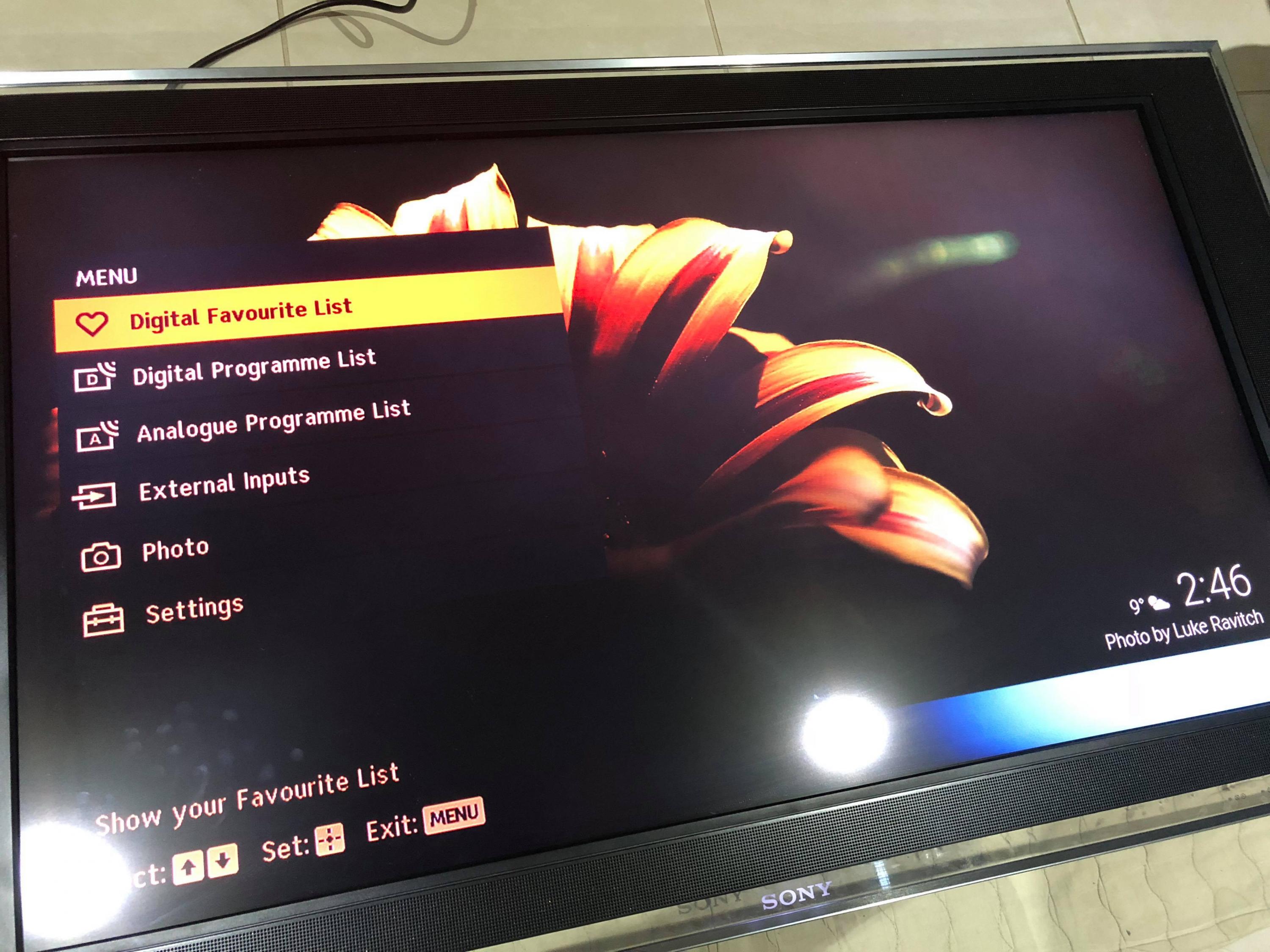

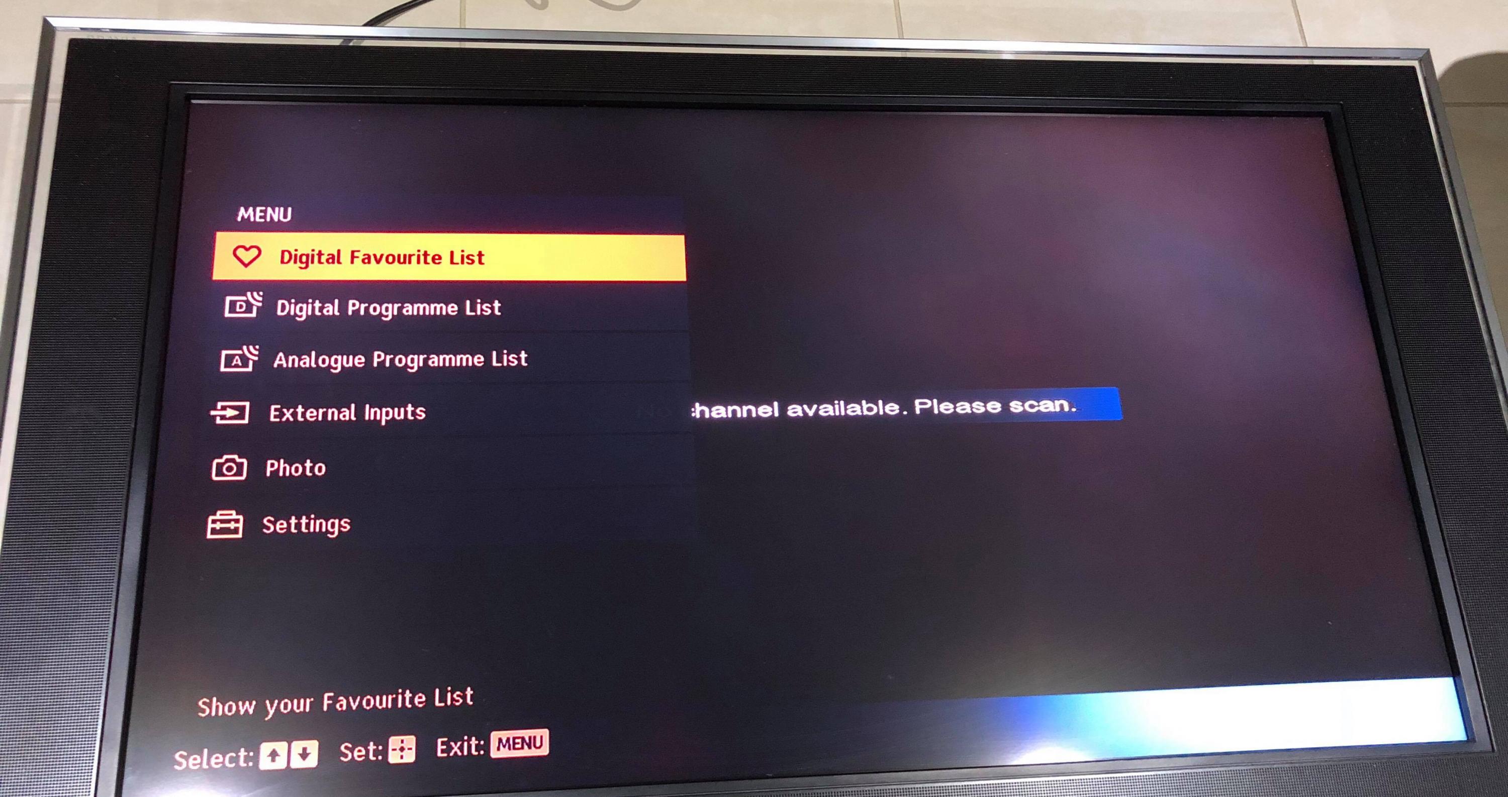

      Now that it has warmed up, the images aren't doubling up. Looks all fine and well. However, The left side is darker and redder than the right side??? Squeezing and tapping the panel made no difference at any stage when I tried earlier.
      EDIT: Attached some photos. One at cold start up, one at twenty minutes in when it's toasty warm. It's cold weather here in Australia (winter).

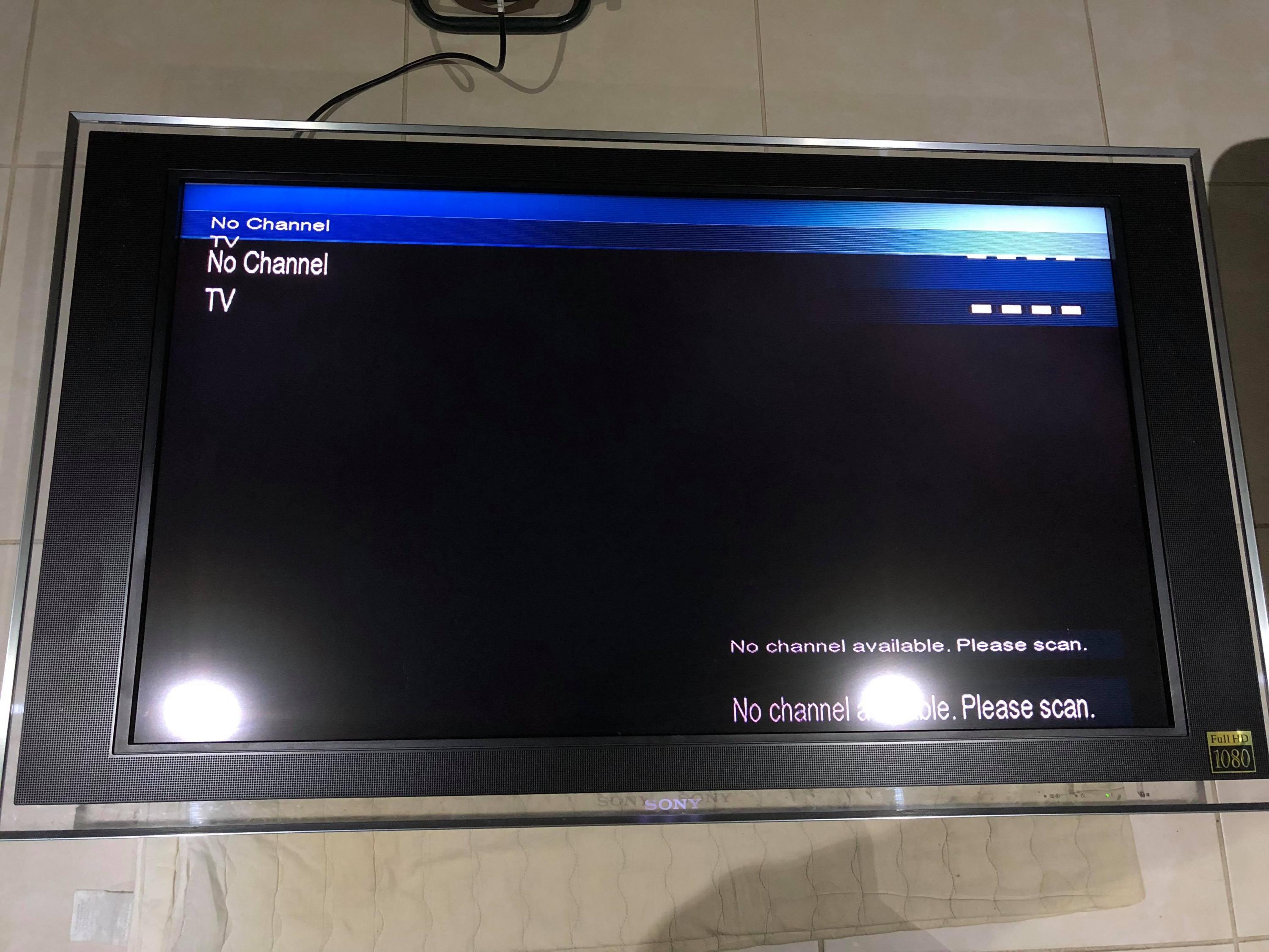

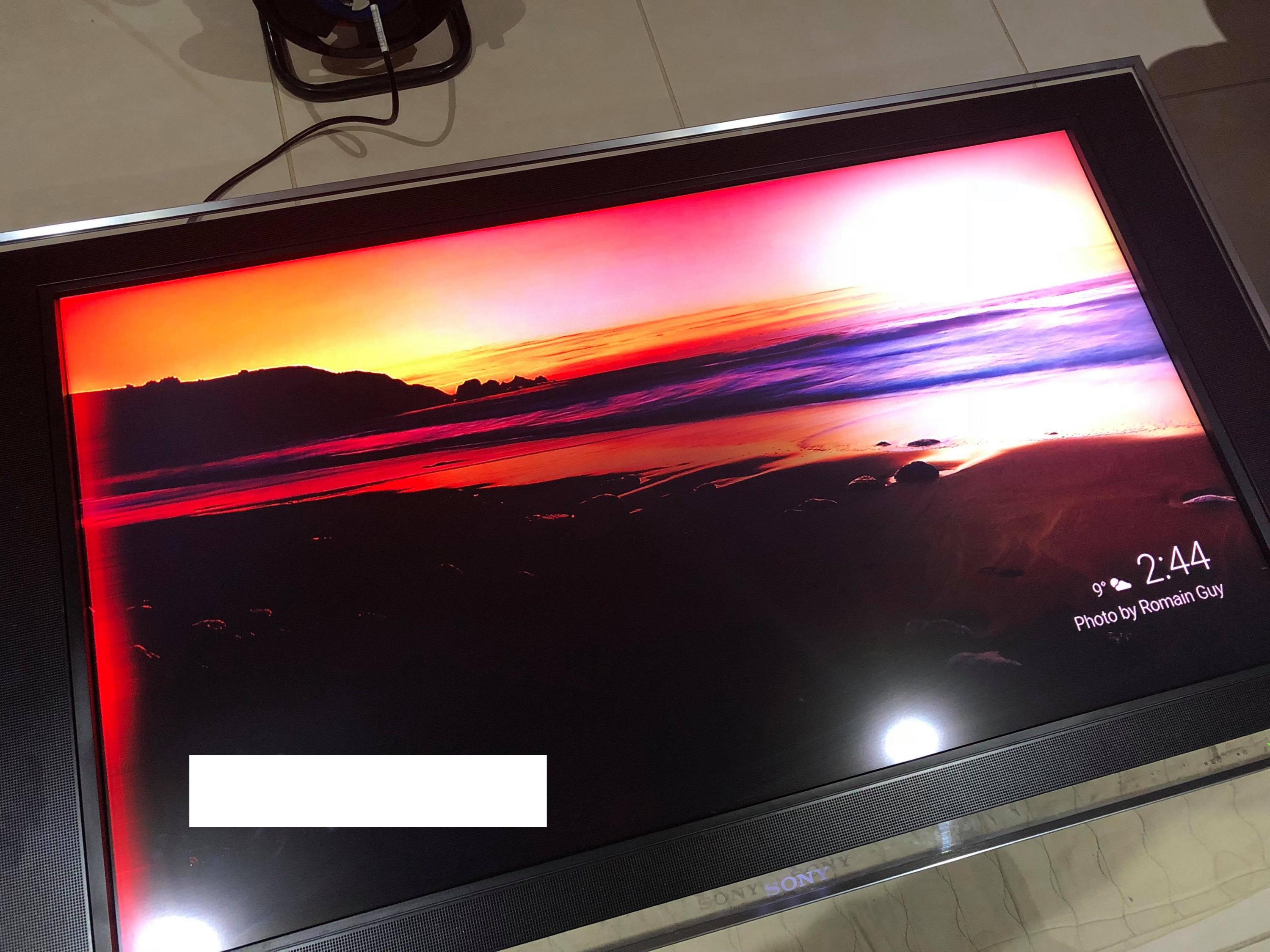

        Another few photos for reference. The bottom left corner is darker than the rest of the screen. It still works fine however just very dark and a reddish tint in that corner. You can see a reddish bleed thing in on the left of the panel and IT GOES AWAY when I go into the menu settings, despite still being a black background for that corner - otherwise it is there when video is sent through.
        (The white cropped box contained my name so that's why it's in photo 2)

          Now that I am wide awake, I can see the left side of the image is slower than the right hand side of the image?
          I also cracked it open to take a look inside and everything looks fine. Disconnected the four ribbon cables to the T-CON and reseated them and at first i got half a screen of fuzz and half normal. Reseated again and it did what it did before.
          Would I be able to confirm it’s a T-CON issue at this stage and maybe scrounge for parts?

            I'd go for a tcon, could test your GAMMA voltages and whatever else you can on tcon to help verify.

              I thought that if one half of the screen was darker and sluggish it came down to the panel tab drivers at fault.
              What do others think?
                Re: Saving a Sony Bravia KDL-46X3100 (HELP PLEASE)
                Dick is right. Bad panel. Maybe repairable with a shim but often temporary fix only. If you were going to keep it for a bedroom or something might be a reasonable thing to do. I would never sell one of these TVs with such a fix though. No guarantee of reliability whatsoever.
                  Ok, didn't know that symptom ruled out tcon, well now it's down to strip it down and try a shim, use for you or friends n family as suggested or try selling parts not whole tv. I'm using an old jvc as monitor right now that I shimmed 3 years ago, the picture quality is right on par with panny, sammy, sony and lg.
