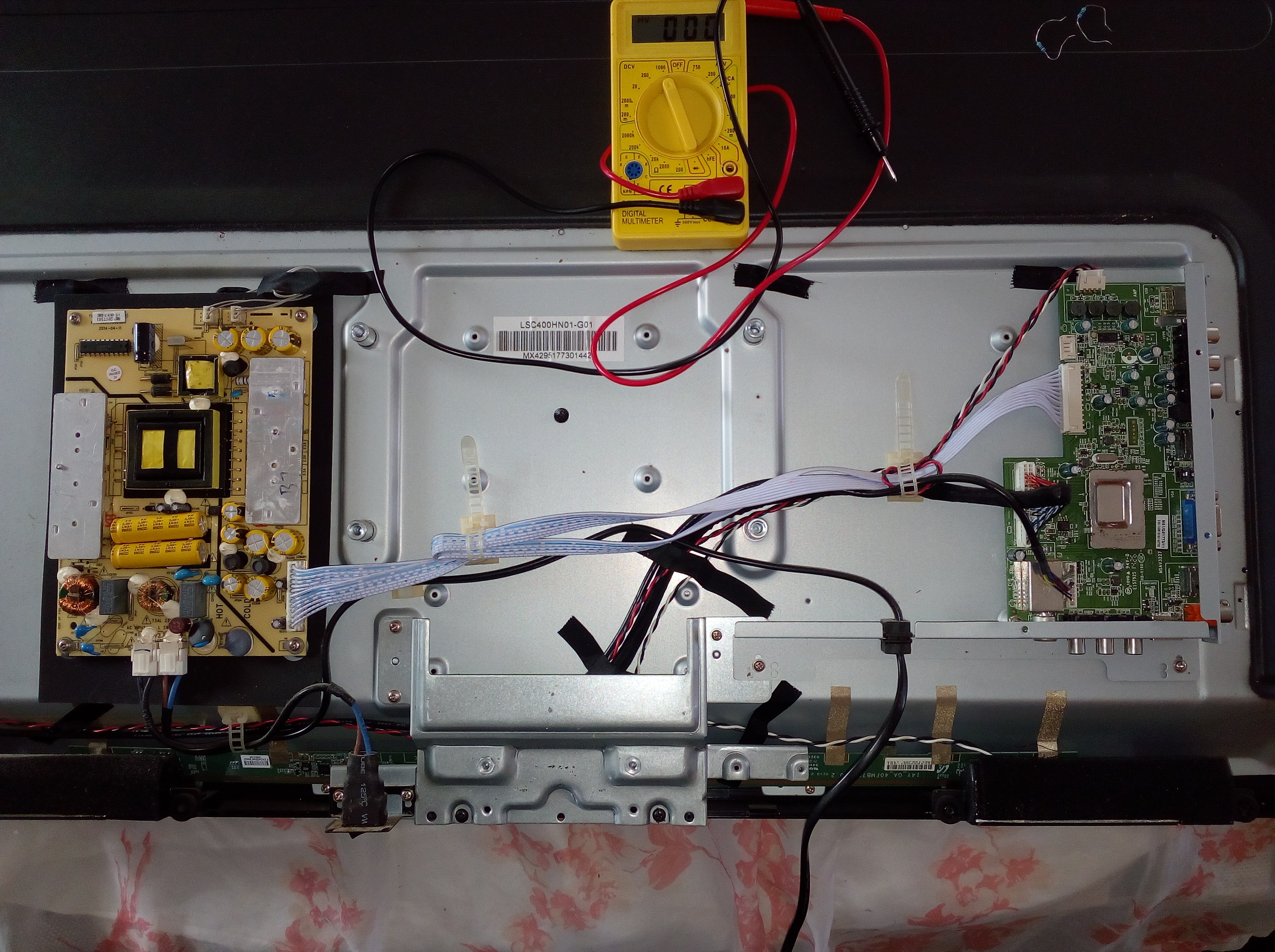

    This is one of the cheap sets given to me "sound OK but no picture". I immediately suspected tcon and sure enough this has bottom mounted bonded screen driver combined tcon. But in testing set something strange in that standby (which seems normal) the main caps read 368v and steady. At switch on their voltage starts fluctuating quickly anywhere between 180 - 330v however the 5v and 12v points are good and the leads to LEDs steady at first one 79v and 25v next one 79v and 0v. At no time does screen flicker or show signs of life. I'm not well up on the LED circuitry but the readings don't look right although they are steady whilst main caps fluctuating madly. What are your thoughts.

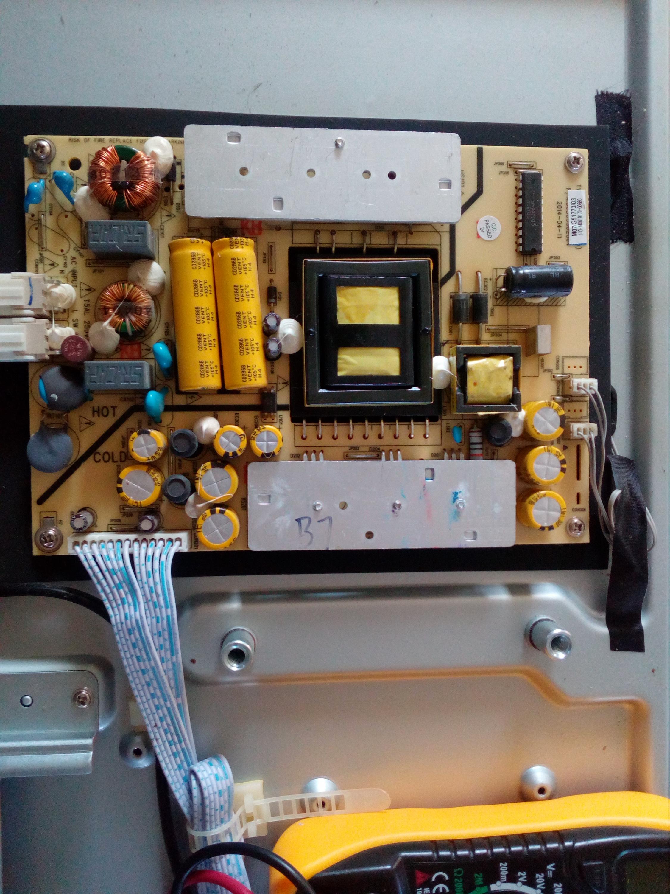

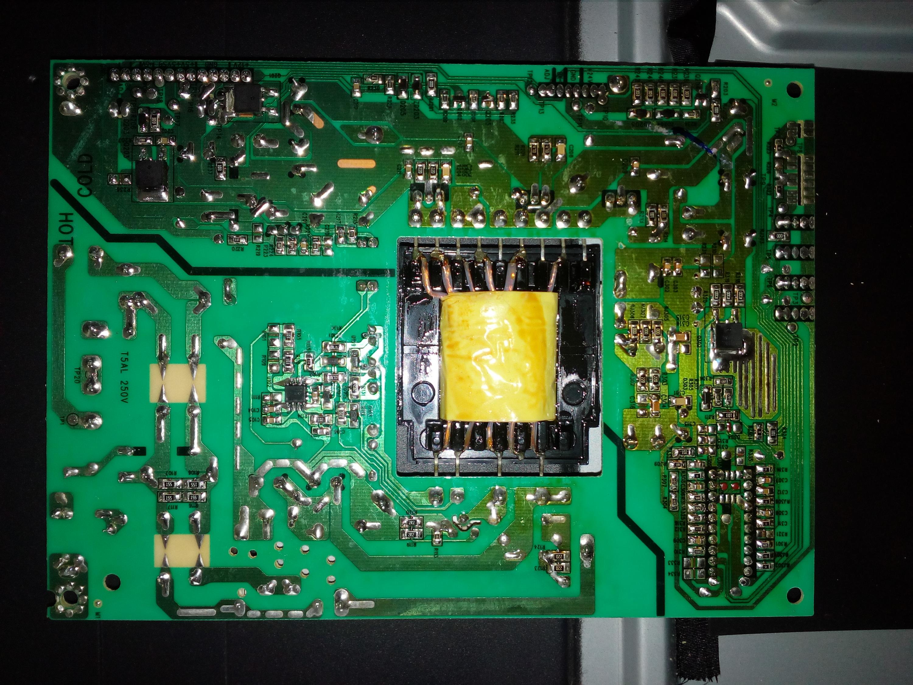

    Hmm, the power supply has no PFC Voltage booster (I do not see PFC Inductor) so I cannot see how the Voltage measured right between the two legs of the main filter caps can be as high as 368VDC unless your incoming AC; at 240VAC the Voltage on the cap should be around 240VAC x 1.414 =339VDC, so may be your incoming AC is much higher than 240V? 368VAC x 0.707 = 260VAC incoming.
    Can we see good clear straight shot pictures of the whole top and the bottom side of the power supply board?

        Pics

              What is the Voltage ratings for those 3 yellow caps by LED connectors?
              So far it looks like you have open circuit in one of the LED string, the one that read 0V on the LED connector.
              You can swap the two LED connectors to see if the 0V reading will follow or not.

                Anyway whilst awake and fresh this morning and for budm this is what I measured.....
                Set in standby, all connected, red led on.
                Main caps fluctuating wildly 0-340v, led connectors 60 & 17v. 60 & 0v all steady
                Set turned on, all connected, blue led on.
                Main caps slower fluctuation 0-33v, led connectors 78 & 34v. 78 & 1v all steady
                Main board disconnected, set powered up, no standby led.
                Main caps steady at 348v, led connectors 55 & 15v. 55 & 0v steady.
                When led connector leads were swapped the voltages stayed with their lead.
                The lone black cap near led connectors reads the same top voltage as on the connectors. Cant see its details as that side stuck down. The yellow caps are rated 80v 82uf so would seem to be part of that circuit although voltage rating is low in that case.

                  So with the Main Bd. disconnected from the PSU the backlights came On and stayed ON and all other supply voltages were good. If that is so then I would think the PSU is OK and the Main or T-CON Bds have a problem. If the T-CON Bd. is separate from the X-TAB Source Bd/s you could probably try disconnecting the T-CON Bd. to see if the set will power up.

                    That is not making any sense to me to have Voltage fluctuation of 0 ~ 340V on the main cap.

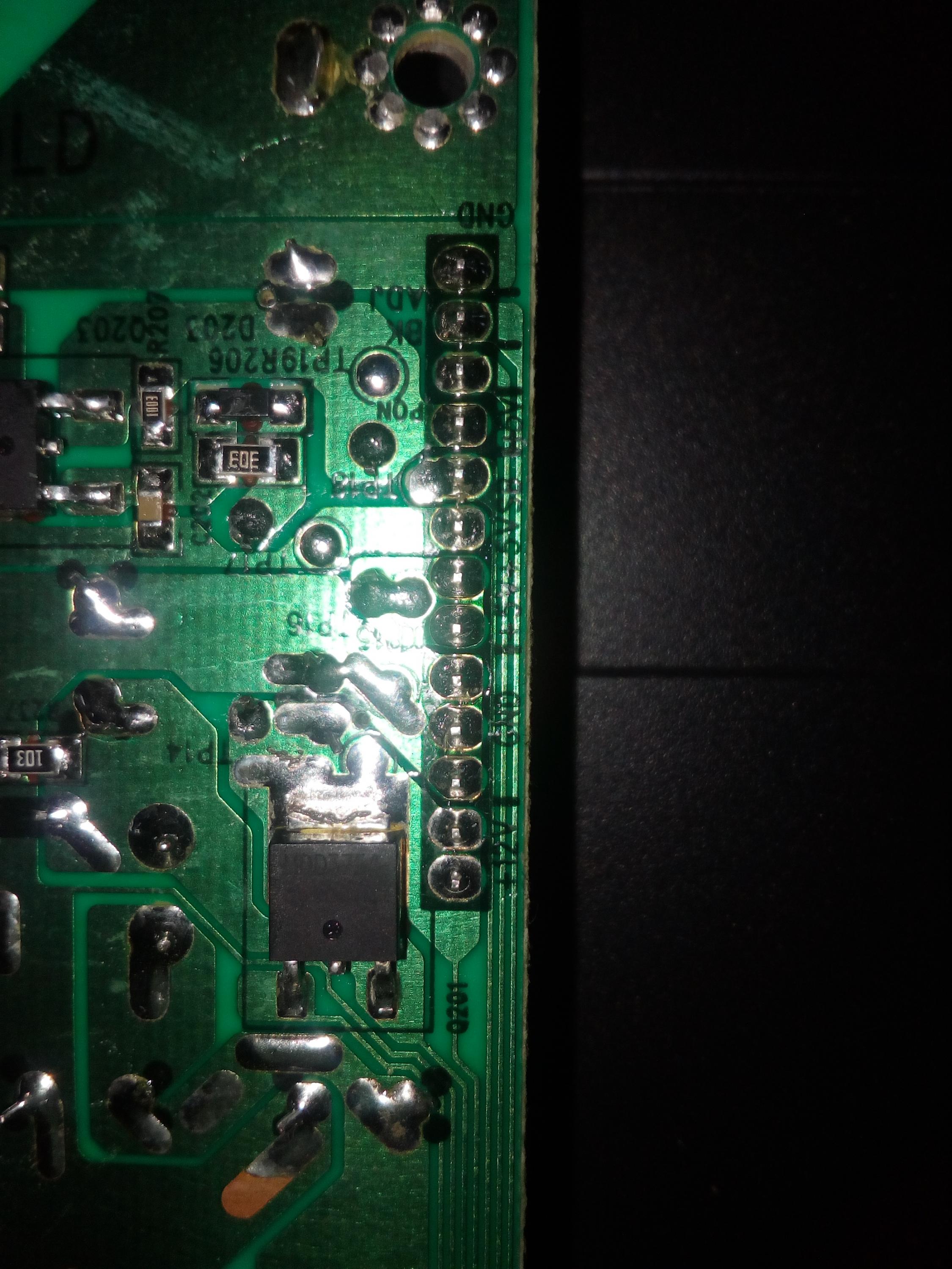

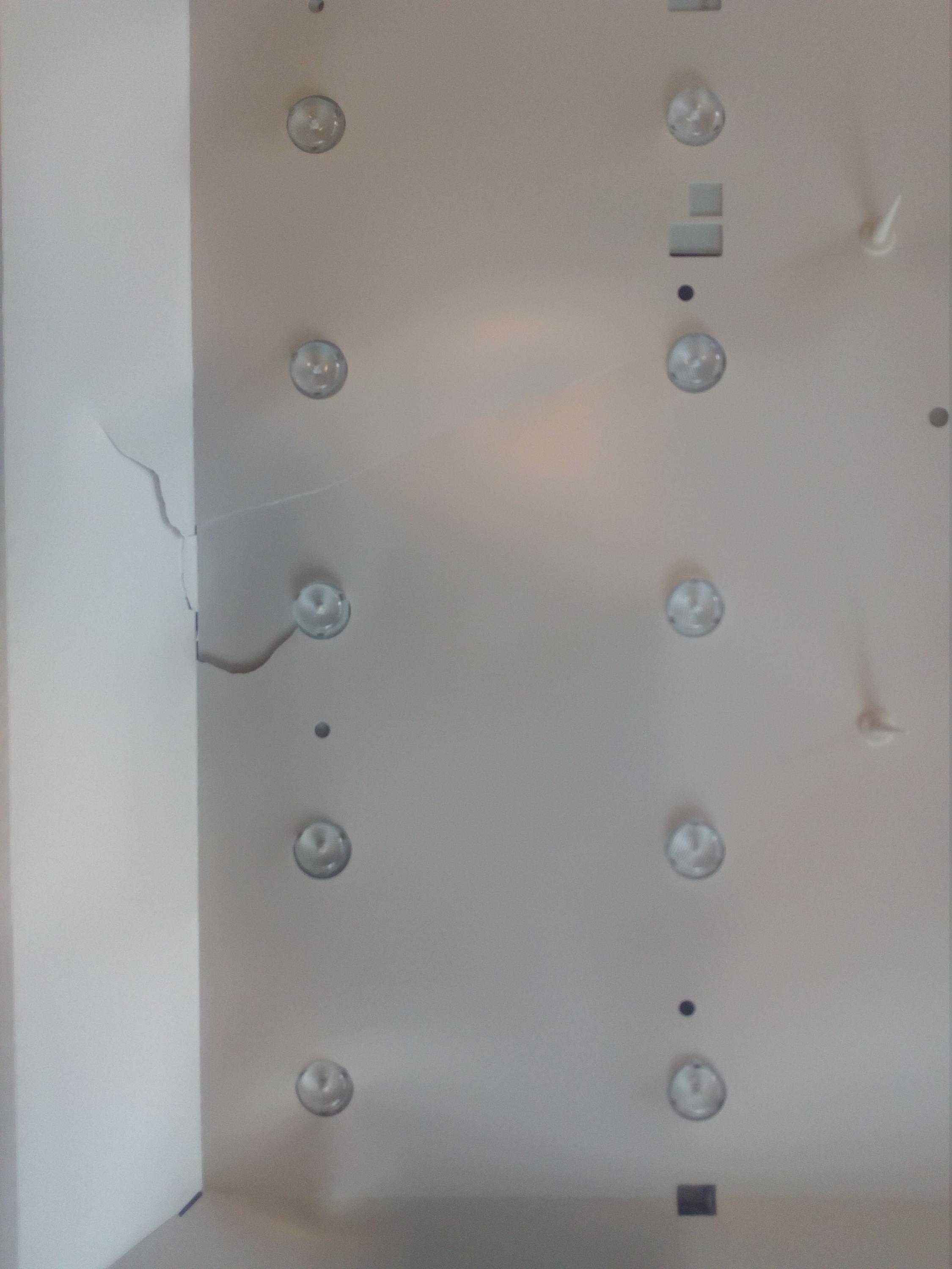

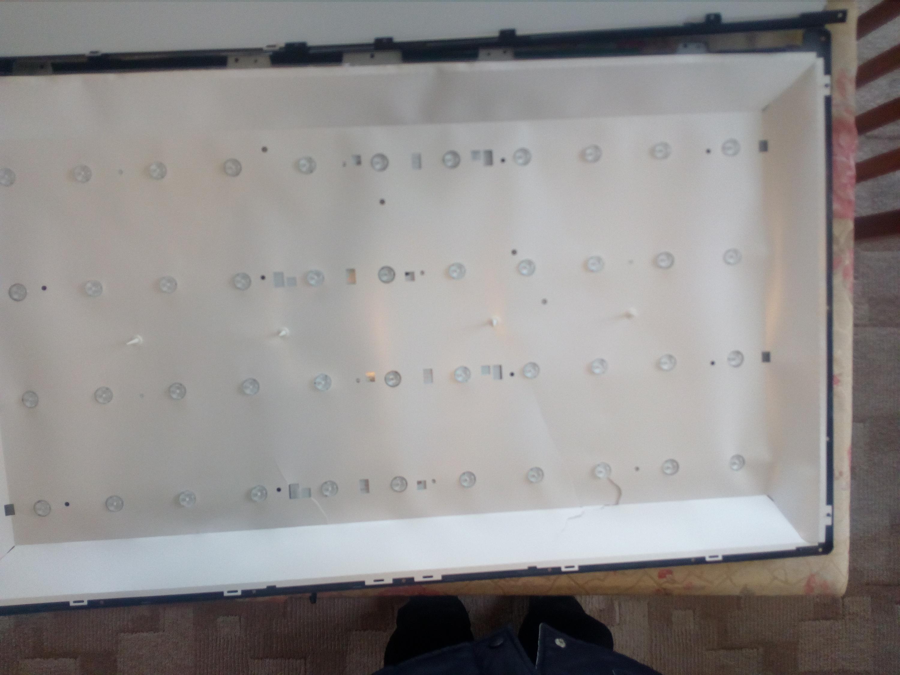

                        I finally pulled this screen off the set and got down to LEDs but the white reflective paper is well glued down in places and is brittle so it just started tearing when I gently tried its removal. However from what I could see there is no sign whatsoever of any LED or strip having a problem. This set is not worth much time or effort let alone funds. Am putting it back together and along the way will test with feed to screen tcon long board removed as suggested above (missed that earlier I'm sorry). Other than that then main must be the problem if those LEDs are as OK as they look.

                          By the way did you notice 11 LEDs x 4 strips and 2 feeds. Couldn't see the actual wiring but strips horizontal so each row 1 x 6 and 1 x 5 ???
