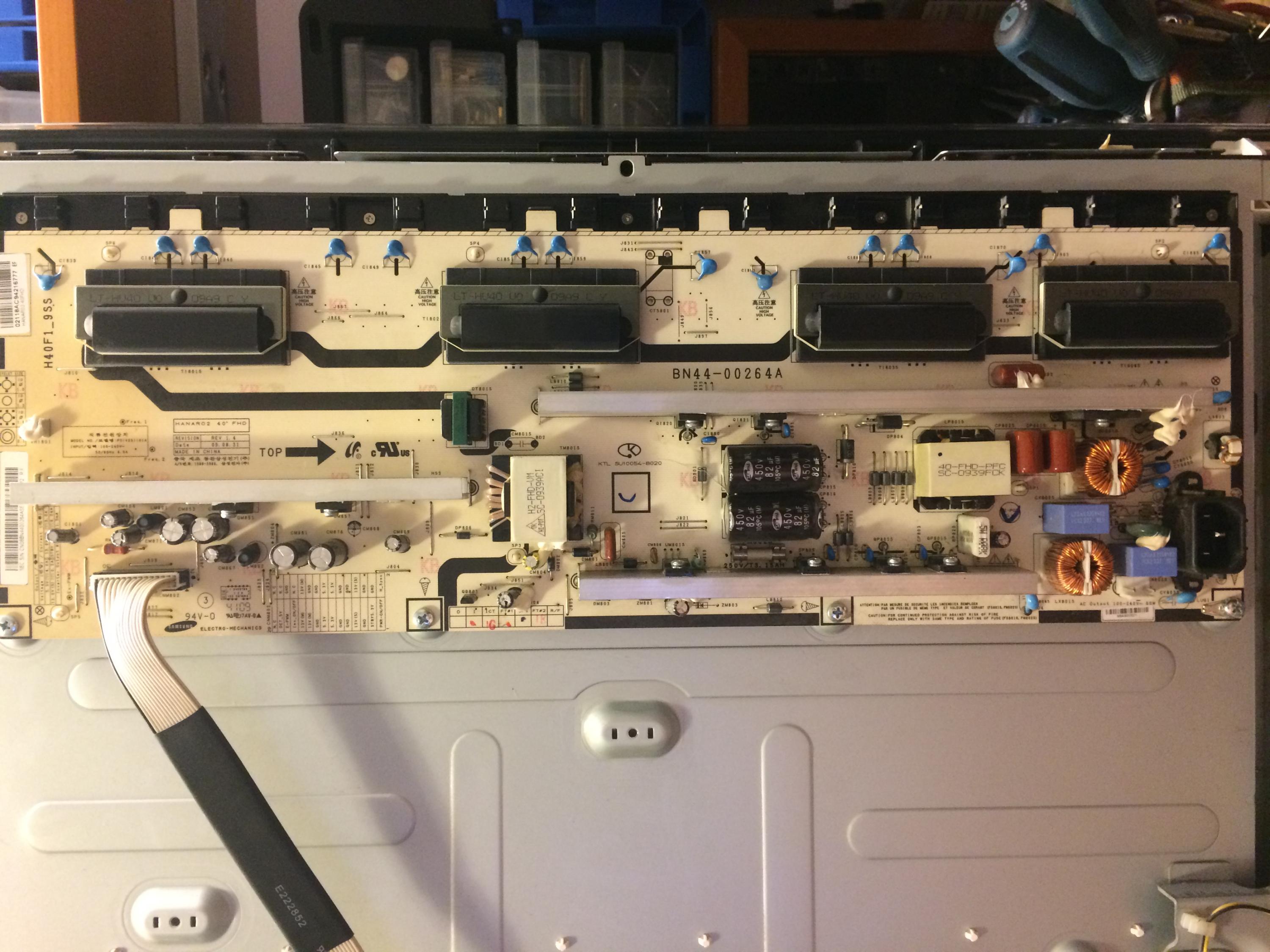

    Picked this TV up as a freebie today. The backlight is flickering quite badly immediately after powering on, and eventually dies completely after a minute or two. First thought is the obvious - caps.
    Stuck my scope on the two biggest caps in the TV (82uf 450v), and I'm getting around 150v of ripple on them! DC voltage is measuring around 389v across those caps, which are paralleled. I soldered a 120uf 450v cap across one of them, and it didn't help the flickering at all.
    Suggestions? Not hard to replace all the caps, but I'd have to order and wait for good caps or install the cheap general purpose caps available in local stores. I've also seen some threads on similar Samsung TV's involving shorting an optoisolator and changing resistor values or something, but I can't find that again.
    Power supply board is BN44-00264A rev 1.4, btw.

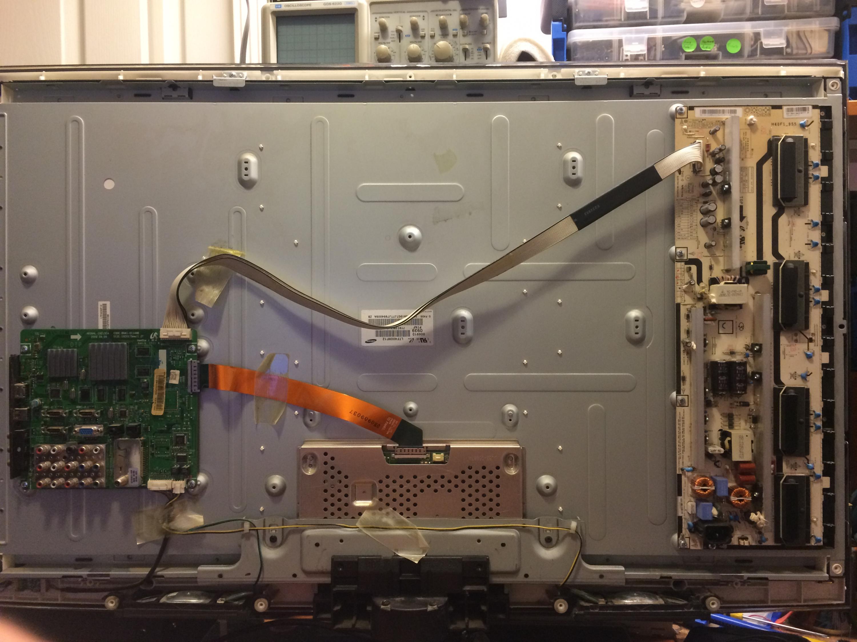

    We will need good clear pictures of the whole backside of the TV showing all the boards, and the straight shot pictures of the whole top and bottom side of the power supply board so we can read the printed texts on the board.
    It is hard to do long distant troubleshooting without seeing what we are dealing with.

        Re: Samsung LN40B610 flickering and dying
        Here's the pictures. I'll pull the board out tomorrow or sometime to get the bottom pic, but it's the same power supply as this one:
        http://www.shopjimmy.com/samsung-bn4...t-inverter.htm
        Don't think it's a panel issue, as the backlight is actually what's flickering/flashing - I can see the backlight from the back of the TV, and it's definitely what is flashing. Tapping/squeezing didn't do anything, fyi.
