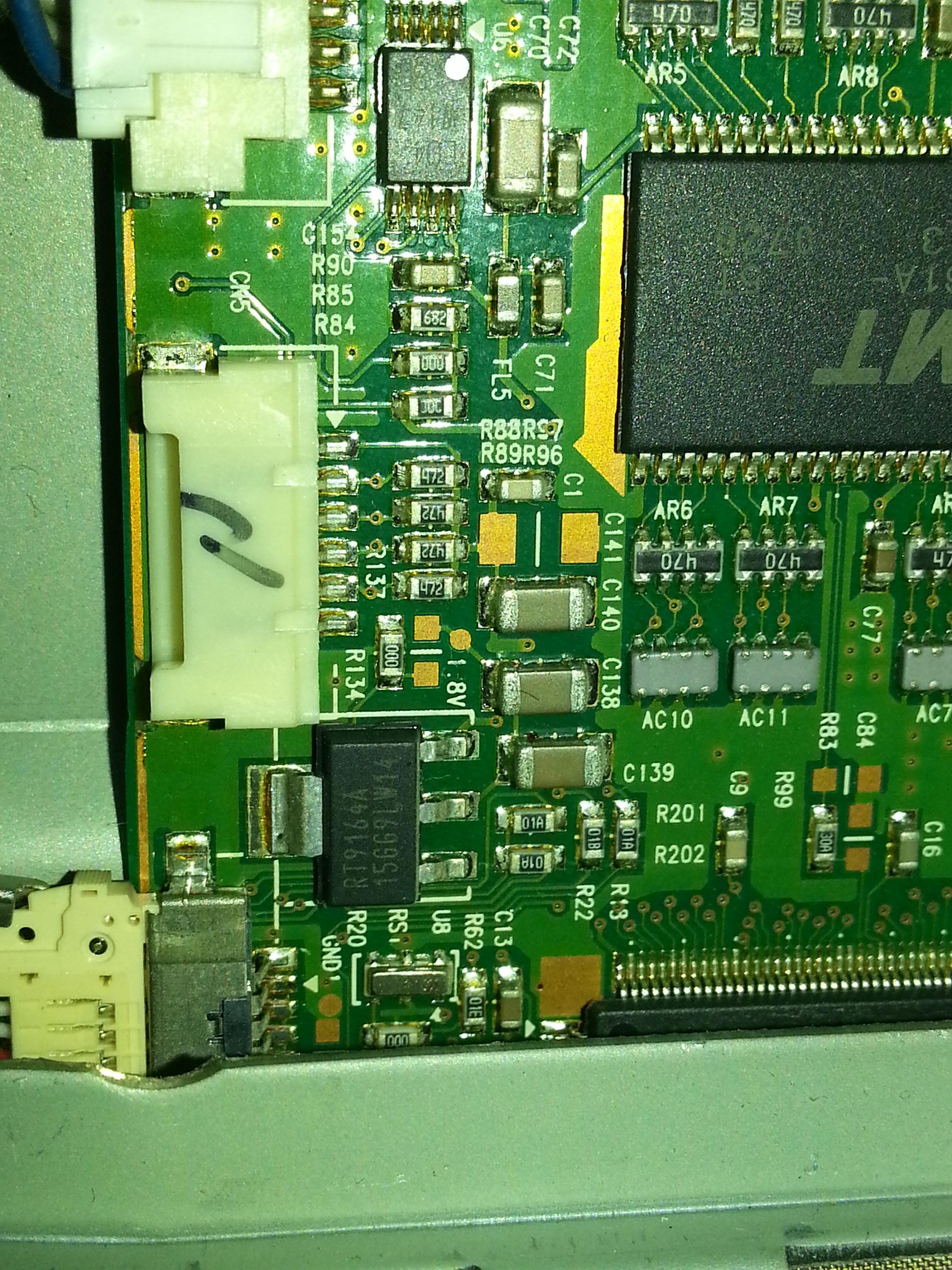

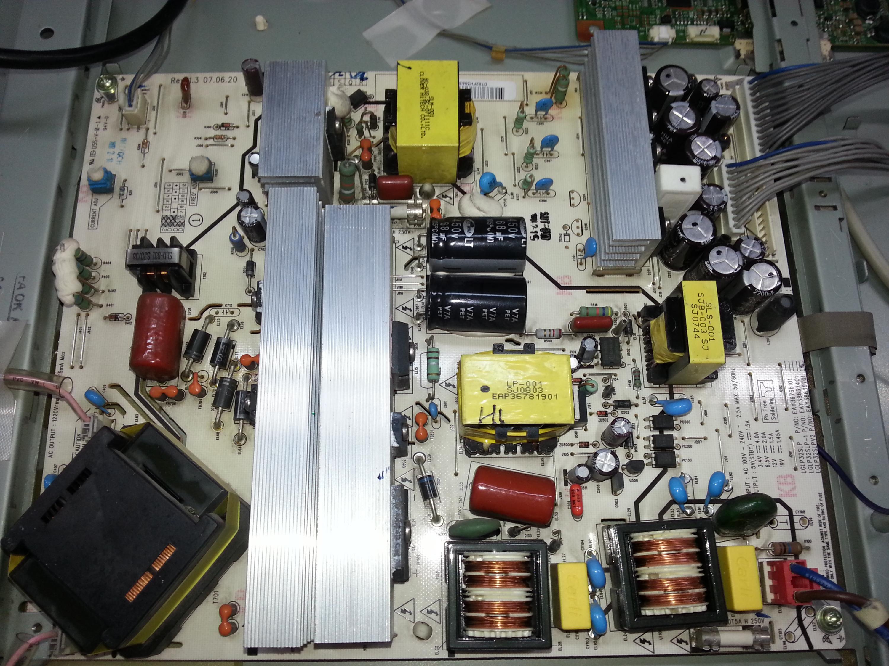

    Good day folks. I need a bit of help with this LG TV which may have multiple issues. When the chap first brought it in, I could see the backlight turning on and the TV appeared to be on, but there was nothing on screen. A while back, I managed to fix an older Samsung which had the same issue by replacing a dead regulator on the t-con board, so I hoped this one had the same issue. There was a slight change of plans however when the next day I plugged it in again and the green light just kept flashing - no other reaction. I took the cover off and immediately noticed a lot of bulging caps. Replaced them and of course, still nothing: it went back to that state where it powers up quickly, the green light stays solid, but there's nothing on screen.
    At this point I wasn't sure whether it's the T-con, the main board or the PSU itself which still had a problem, since all of them had something unconvincing about them, as follows:
    -the 3.4v rail on the PSU doesn't come on....after a bit of fiddling, I connected the 5Vsb rail to the 3.4v ON pin on the connector and now I got 3.4v where it should go, so let's assume the PSU is fine for now.
    -this bring us to why the main board is not sending that 3.4v ON signal by itself and required me to manually jump it
    -even with 3.4v now present, there was still no picture. I even applied 3.4v from an external supply and the same thing happened.

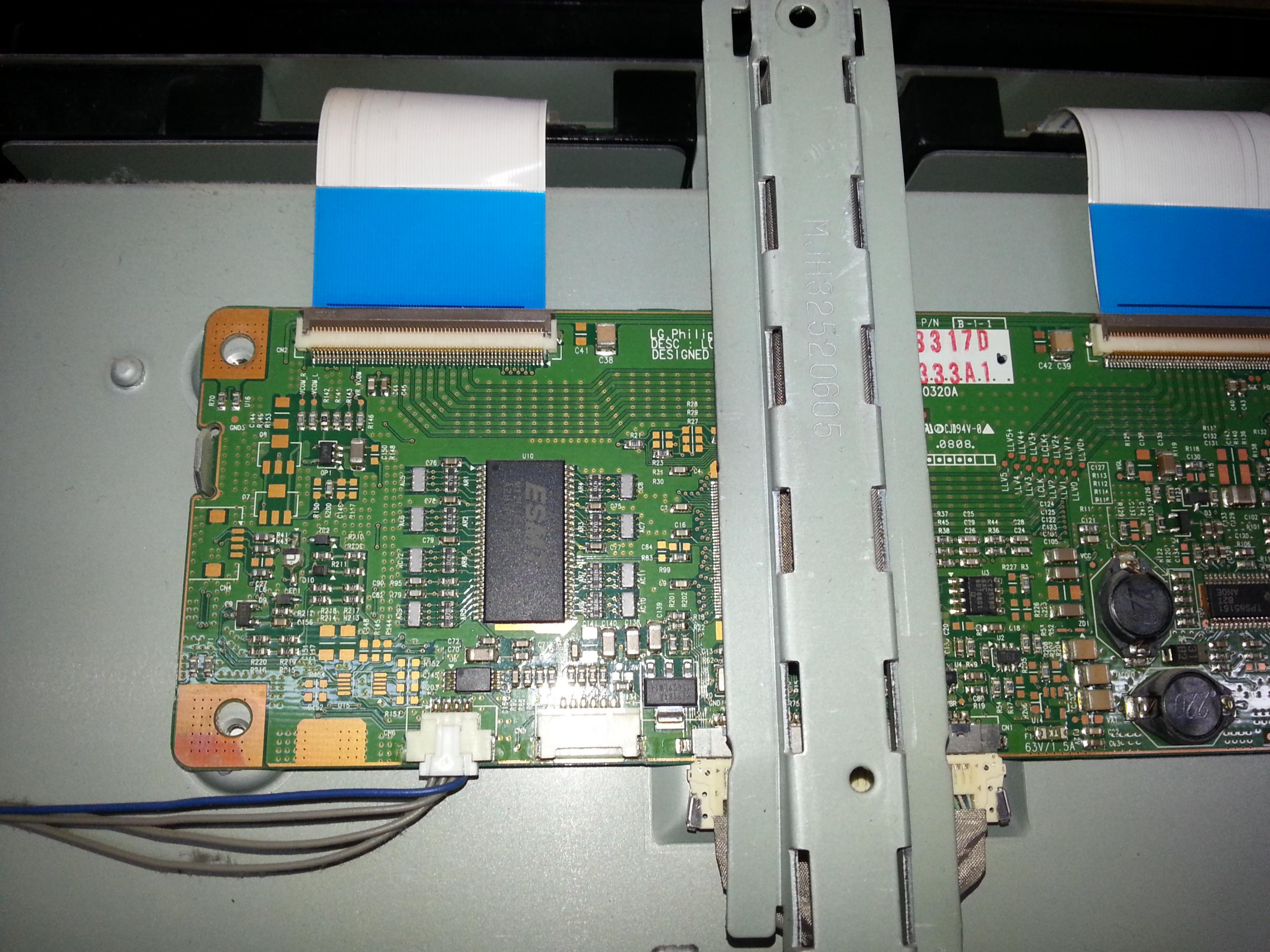

    -the T-con board seems fine, except for one thing I noticed: that 1.8v test point I pictured up close only reads 1.5v which upon closer inspection seems to be coming from the LDO directly next to it. The datasheet for it, confirms it's a 1.5v regulator, so that's most likely fine.

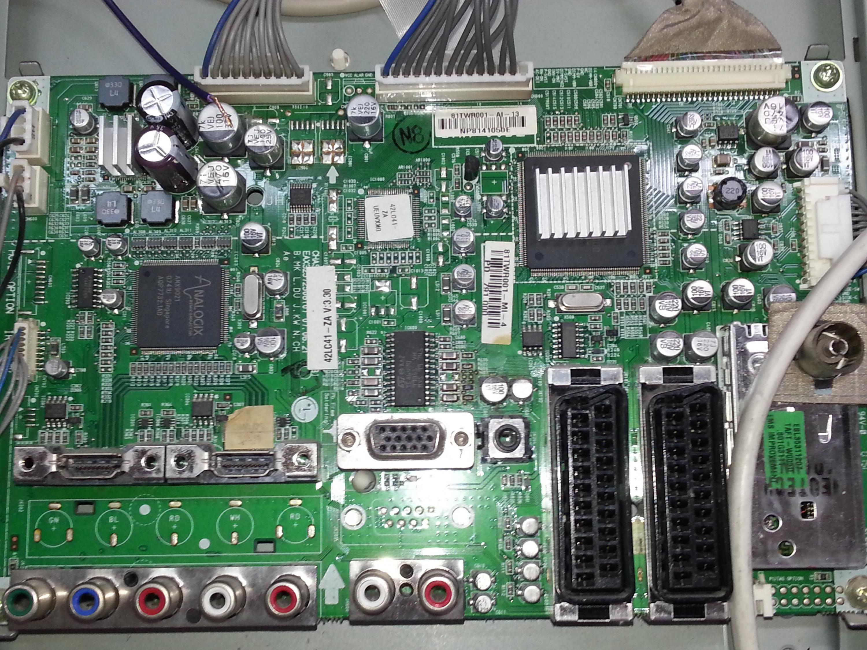

    All things considered, I'm leaning towards a faulty main board: it doesn't send any signal to the t-con board (no scope to check this sadly), but combined with the lack of 3.4v I ASSUME that is it. There is a green light coming on near the connector in the top-left (D800 on page 36 of the schematic I posted), but that's about it....it's an EAX32572506. Pictures are pretty piss-poor, I know. Cheers and thanks

    the caps you changed related to 12V or 19V ? in case the 19V then you need to determine the sound level IC. its Main board, PS ON Okay.i would check first soldering on MB as there was load before you replaced caps on PSU

      I reckon they weren't on the 19v bus. They were on 12 and 5v. Thing is, I tried following along with the schematic a bit closer in the "power" section towards the bottom and all the voltages seem to be within spec...

        on the last photo you posted of MB there are funny loos cable near the sound circuit !!!!

          I had one of these to repair in 2016. What I thought was a backlight problem turned out to be a T-CON Bd. problem. I spent some money and time converting this TV to LED backlights, only to finally discover a bad T-CON Bd. Since a replacement board was accessible I just replaced the T-CON Bd. and the TV worked. The owner did not want to pay for the LEDs and the T-CON and told me to keep the TV as he would buy anew one. Well I eventually sold the TV to recover my monies and so far as I know it is still working.

            Oh don't mind that - it's just a wire I soldered to the 3.4v terminal on the bottom of the PSU to apply external power. I removed it after discovering the PSU works.
            Don't have a replacement T-con on hand sadly, though I'll look one up on an auction site and might even get one if it's not terribly expensive - good to have around for testing purposes...yeah, come to think of it, just because the voltages are in spec doesn't mean the T-con operates properly. VGH and VGL appear OK too BTW.

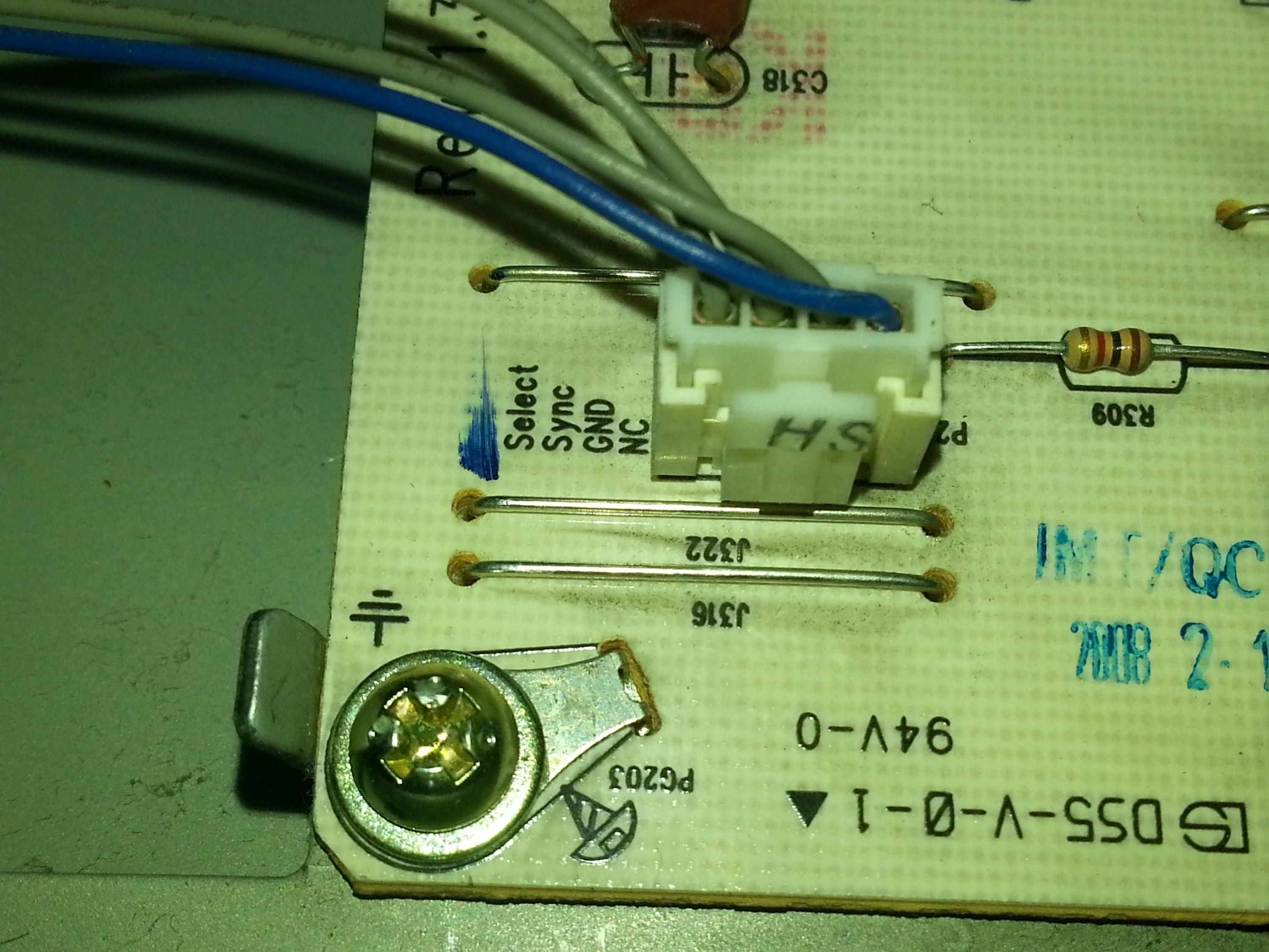

              I also noticed this connector going from the power board to the T-con....what do you supposed this is. Is the T-con controlling something on the power supply ? Select and Sync...what could those relate to ? I've never encountered them...

                I got myself a replacement T-con today...unfortunately no, it still doesn't work, so I hold my opinion that the MB is dead, despite the chap claiming it's got sound
