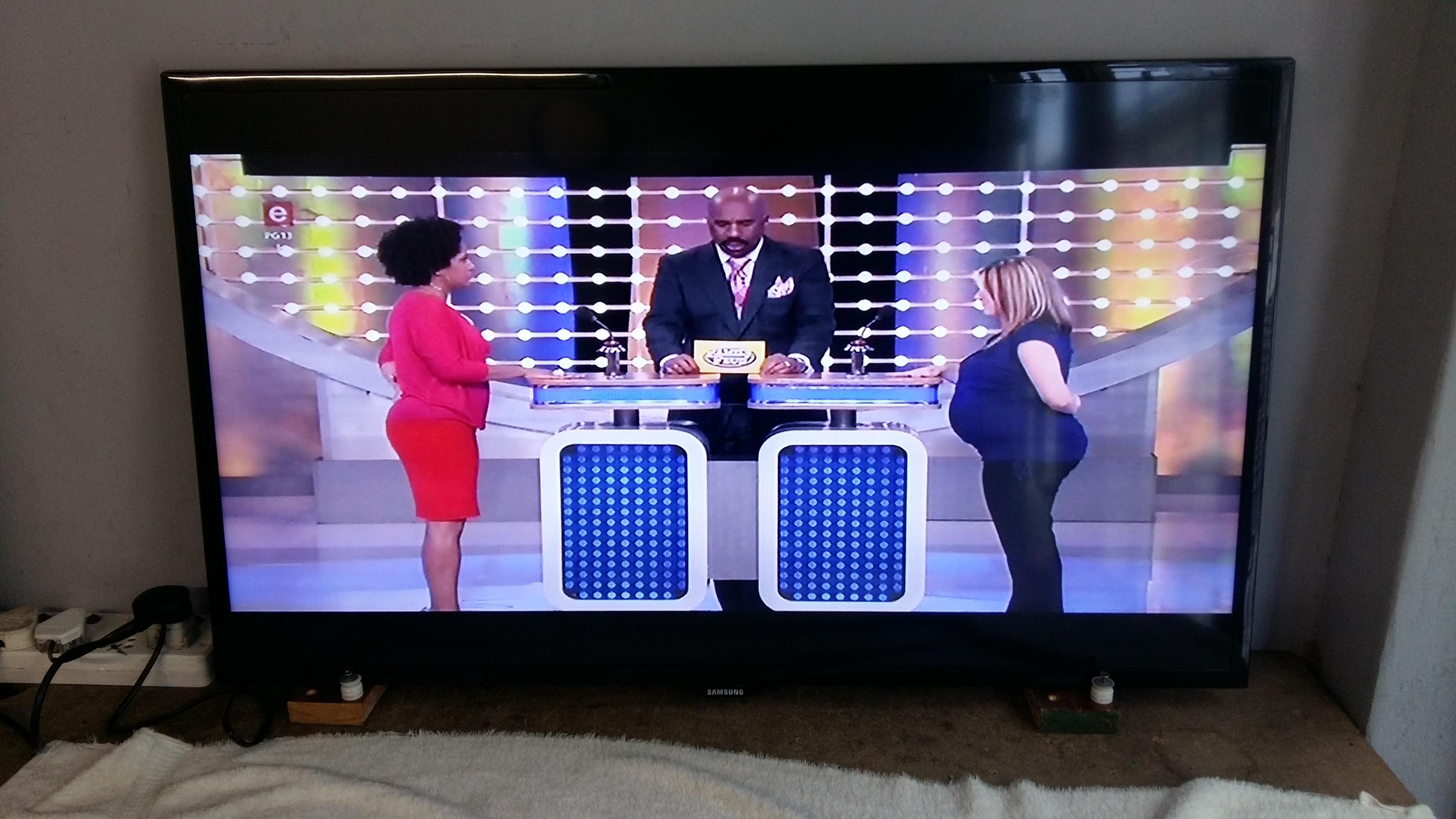

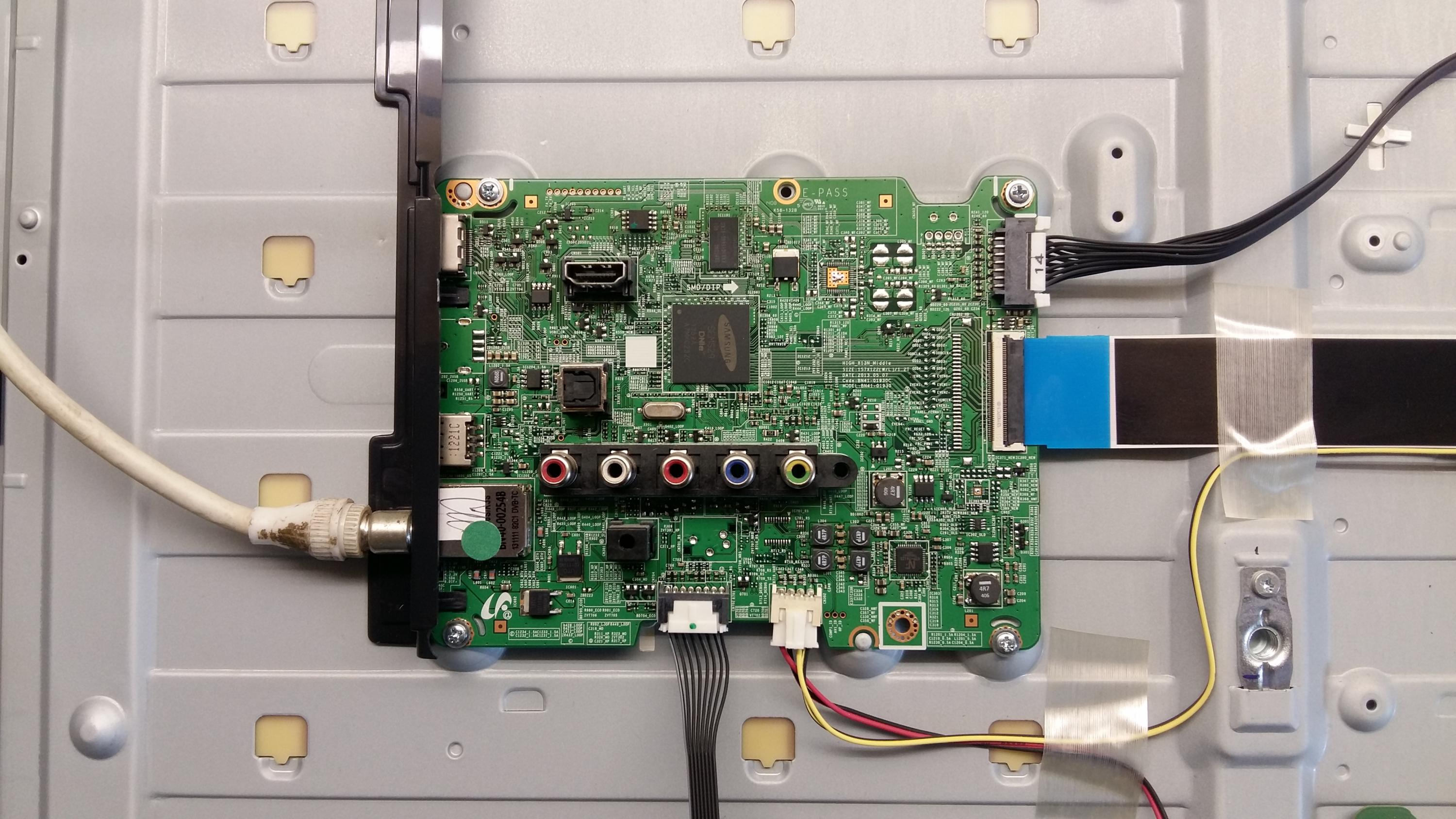

    Hi guys, I have problem that's not really a problem. More like a fudge or a Mcguyver.
    I have fitted a main board from a salvaged Samsung UA50F5000ARXXA into a Samsung UA40F5000ARXXA (Stop smiling like that!), and have a perfect picture but,..its upside down!? see photo.
    At first I didn't think the connectors/plugs would be the same, but when I checked they were identical, so I gave it a shot.
    I've tried going into the factory setting to see if there might be a function that would enable me to swing the picture around, but didn't see any thing obvious.
    Not wanting to screw up the good 50" board I just exited with out making any changes.
    Is there a solution other than upgrading the software? If there is could someone let me know how. I haven't yet done a software upgrade, so some direction would be welcome.

    Re: Samsung UA40F5000ARXXA Upside down picture
    sorry to say reload correct firmware for the UA40
        Do you have anything similar in the Service Menu?
        https://www.youtube.com/watch?v=rW2CMKi1bDA

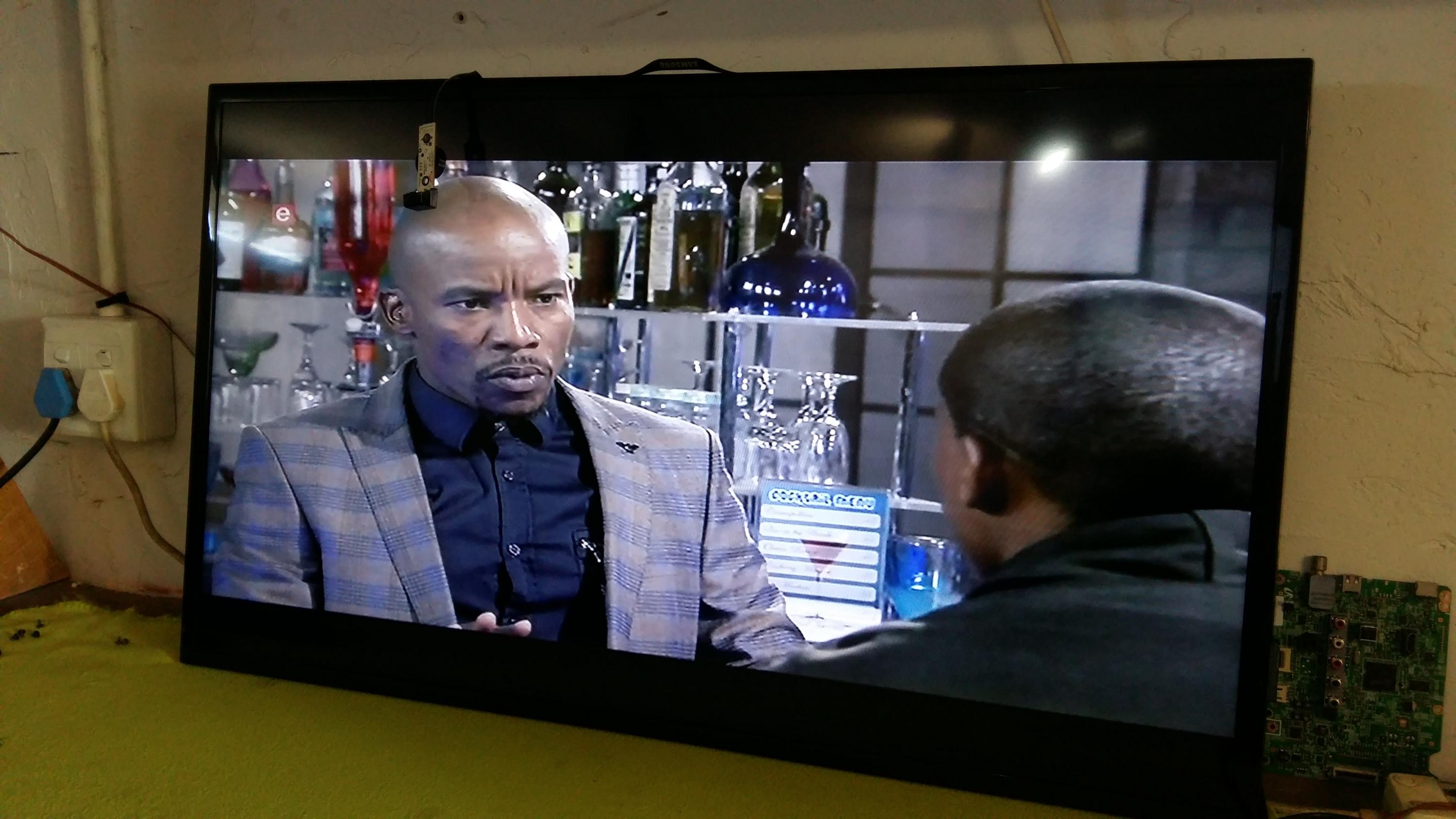

                  Hey Dick you need to upgrade to Professional tech!! I couldn't wait 'til tomorrow, so gave it a go & Hallelujah!!
                        Now remember boys and girls, screen flip, not tv overhaul, good thing you were online Dick, saved m from going down wrong path.
