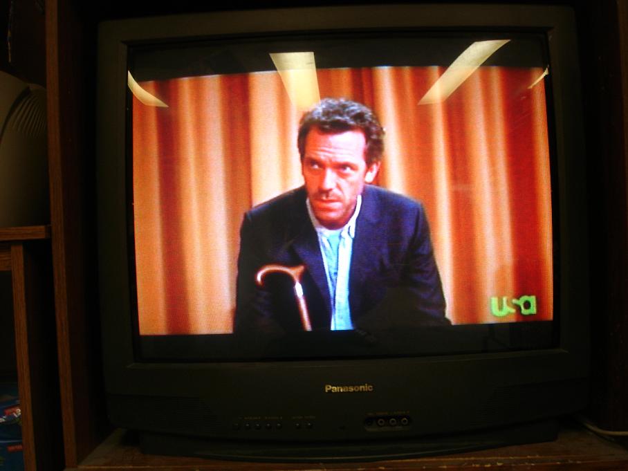

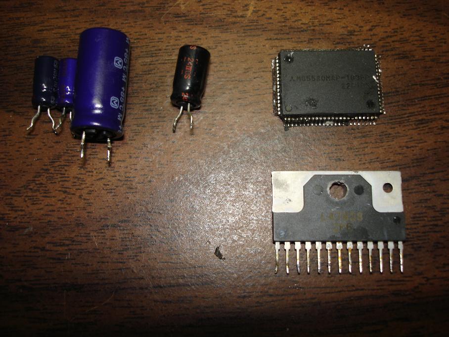

    Well I got the IC today I originally had another part on backorder that was holding the IC up it was in stock. I removed the hold on Wednesday because I got impatient.
    Anyhow I replaced it and success!!!
    The final body .... erm part count was the Chroma / Deflection / Microcontroller IC and the vertical IC and associated capacitors.
    Included in the cap replacement was the 100 uf pump up capacitor the 1000 uf yoke coupling capacitor and two more in the vertical section.
    The caps checked out fine but I had the vertical IC on hand and both it and the caps were cheap.
    So most likely the vertical cracked joint probably killed something in the old IC. That's the only anomaly that makes sense at this point.
    Thanks for all of the help on this. It was a real strange ordeal.

      Oh yeah and I made sure to apply gray RTV to the side of the IC that had it.
      I still don't know why it had it though?
      I remember hearing insulation but insulation from what arcing between pins?
      In any case I used Permatex Water Pump RTV since that is the gray stuff.
      I let it sit for an hour before firing the TV up it fully cures in 24 but it is no tack in 1 hour.
      That's how long I wait when I use RTV for gasketing anyways.

        On scope waveforms will be very apprent if vertical IC is iffy. And vertical IC is cheap and I simply replace it regardless if TV still acts funky after this resolder and *always* replace 100uF cap with good one too! If it is still funky, I replace the pump up diode as well. Uncovered few surprises on that diode. :p
