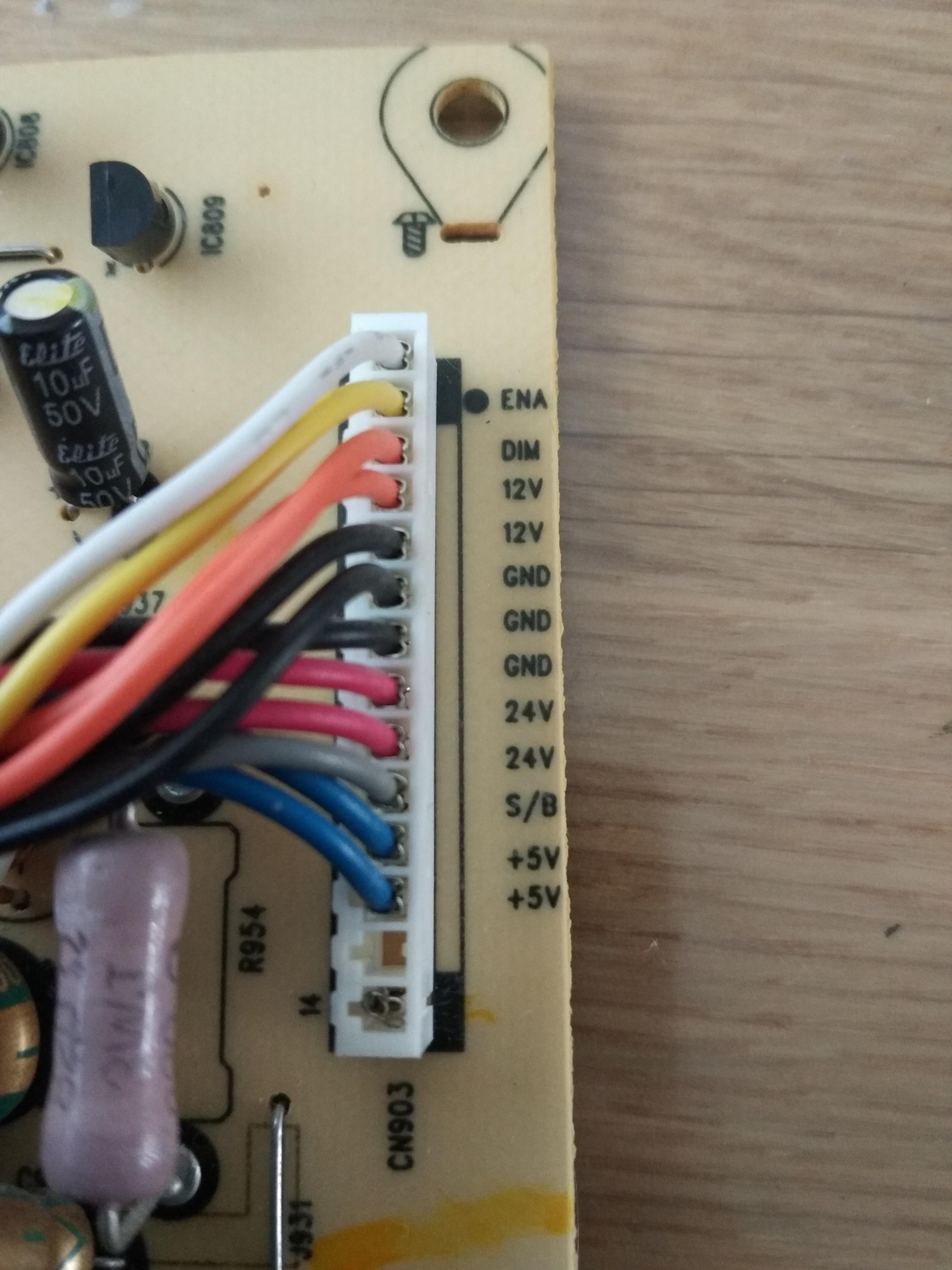

    If it is then disconnect the main board and connect the pin with 5V to CN903 Pin 10 (SB) then power up and measure the 12V and 24V voltages

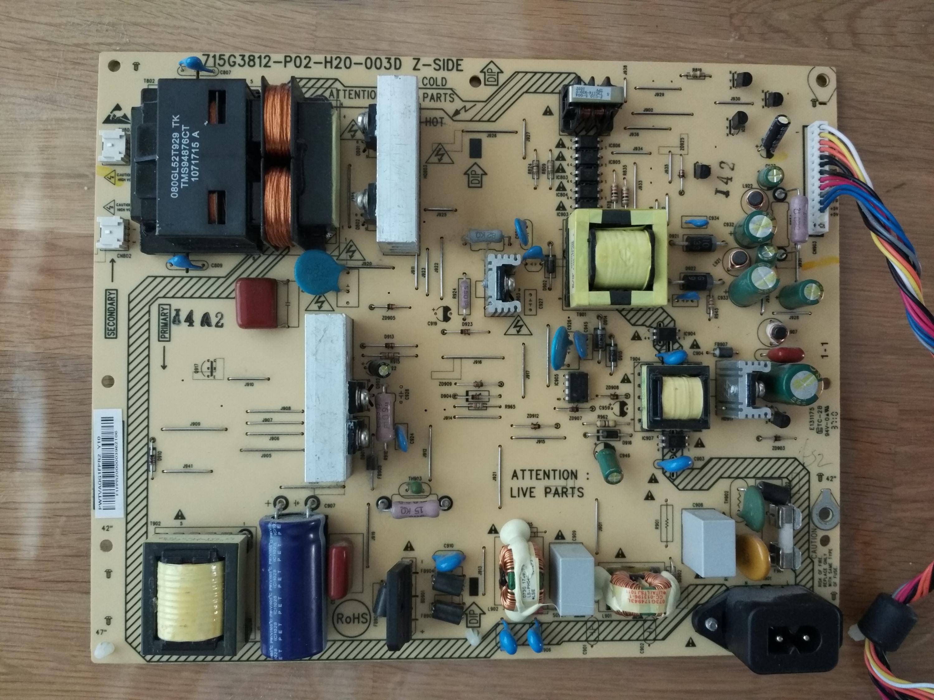

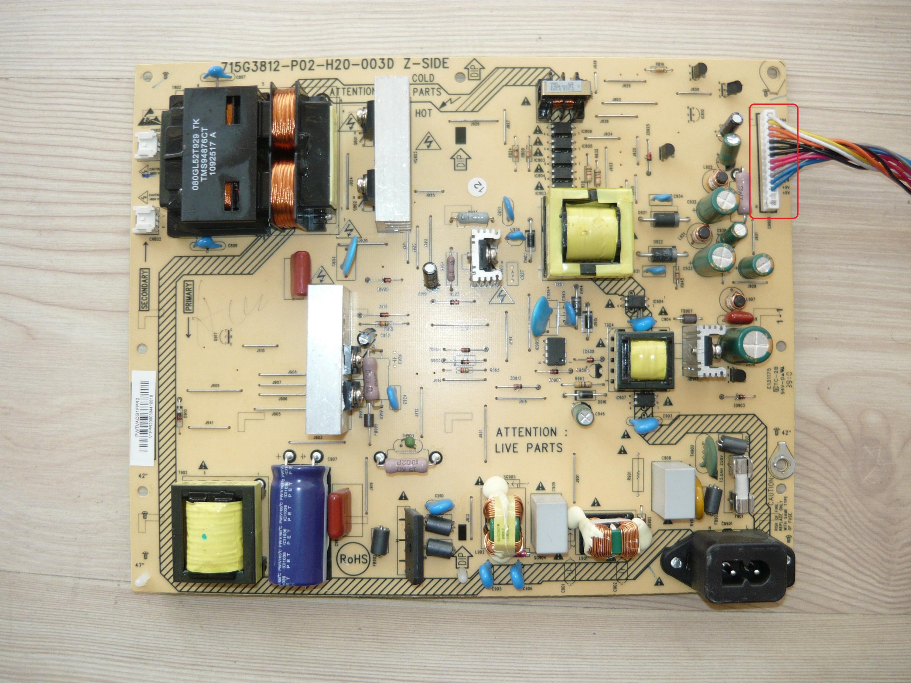

      Powerboard is a Z15G3812-P02-H20-003D but the connector CN903 is still the same as yours

        Can you post a clear sharp picture of your power supply board and also the legend alongside the connector.
          Ofcourse I can

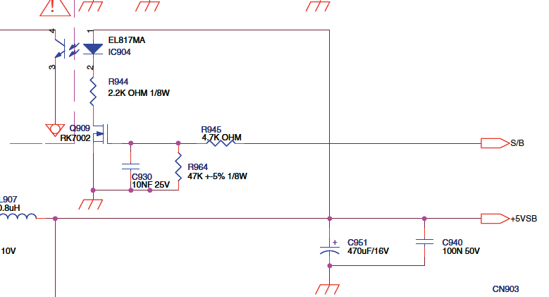

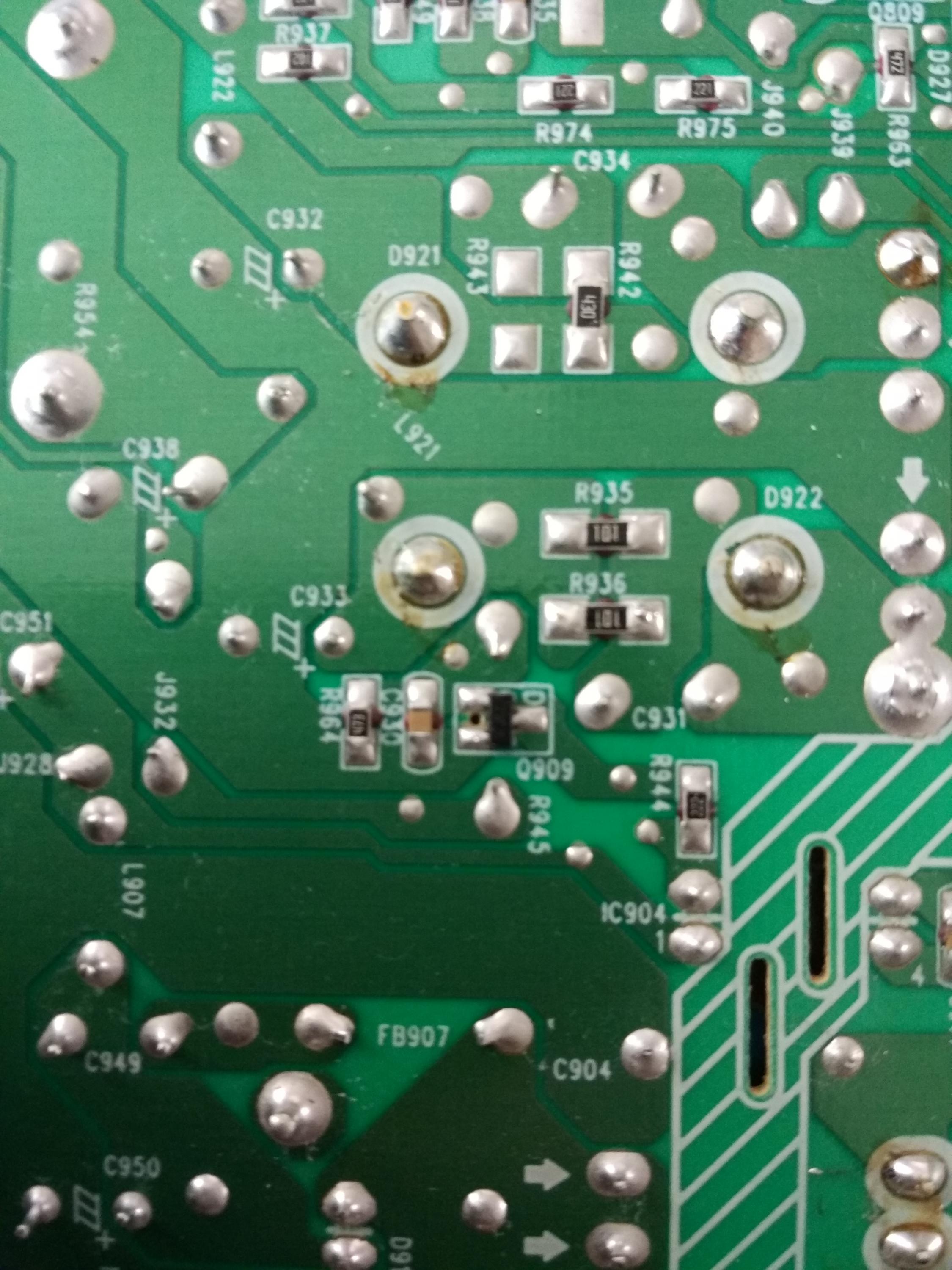

              I tried to trace back the voltage. I assume the SB gets the voltage from the 5v rail so on the back I trace the 5v line. It goes through IC904 (EL817 opto) and then R944 (2.2kOhm resistor). On the drain of q909 (rk7002 transistor) there is still 5v (sometimes somewhat lower) But it ends there. There is no voltage on gate or source.
              Shouldn't there be any voltage on gate and source? I could be a bad diode but I have my doubts,; but I could be wrong.

                I believe the SB pin to be the Standby pin and when the +5V is connected to it should bring up the 12V and 24V supplies. It's normal to use a 1K resistor to short the +5V to SB (for safety) to bring the set out of standby.
                So with the main board disconnected and the jumper resistor in place at the power supply connector, if you switch on the set the 12V and 24V supplies should be there.
                The SB receives the voltage normally from the main board and that switches on circuitry on the power supply to bring up the other voltages.
                It must be working since your first post suggests the voltages were there when connected to the mainboard but were lower than expected.
                Do you have the correct schematic for the power supply?

                    The connector CN903 does appear to match that shown in the pdf all except for Pin14 (POK) which looks as though your power supply doesn't have that wire connected.

                      But i just connected an 1k resistor from +5v to S/B. Except for the +5v and the S/B no voltages on the other pins.

                          If you have 1K resistor connected properly between 5V and SB pin then you should have Gate Voltage of around 3V, so are you getting that?
                          BTW, when you use the resistor, did you disconnect the cable from the Power supply board to the main board first? It has to be disconnected.
