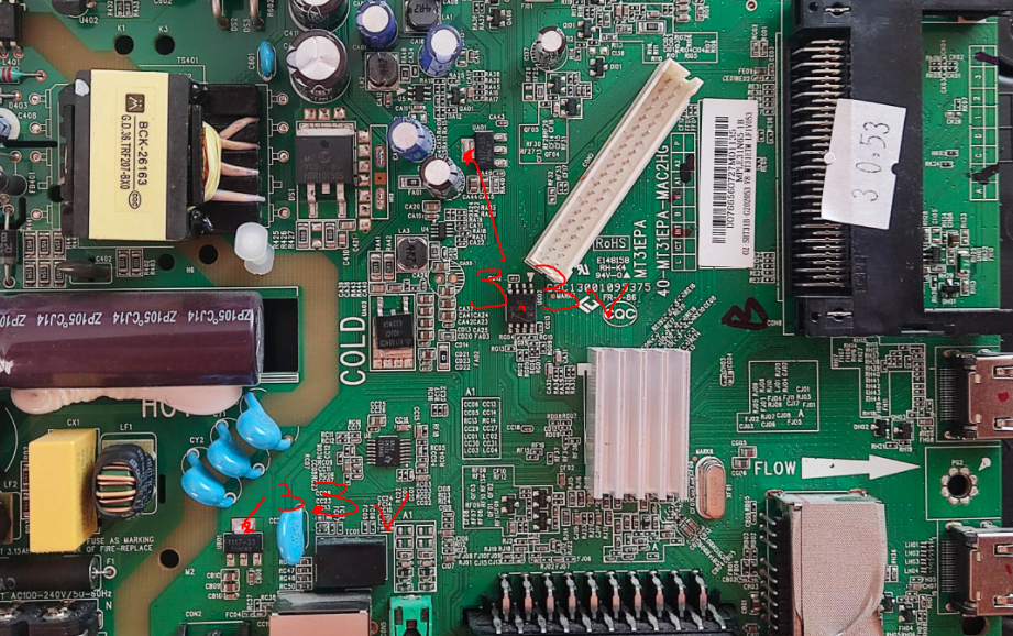

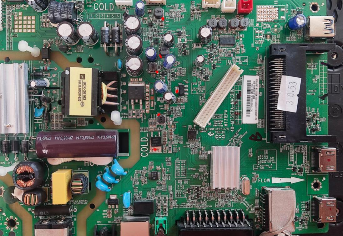

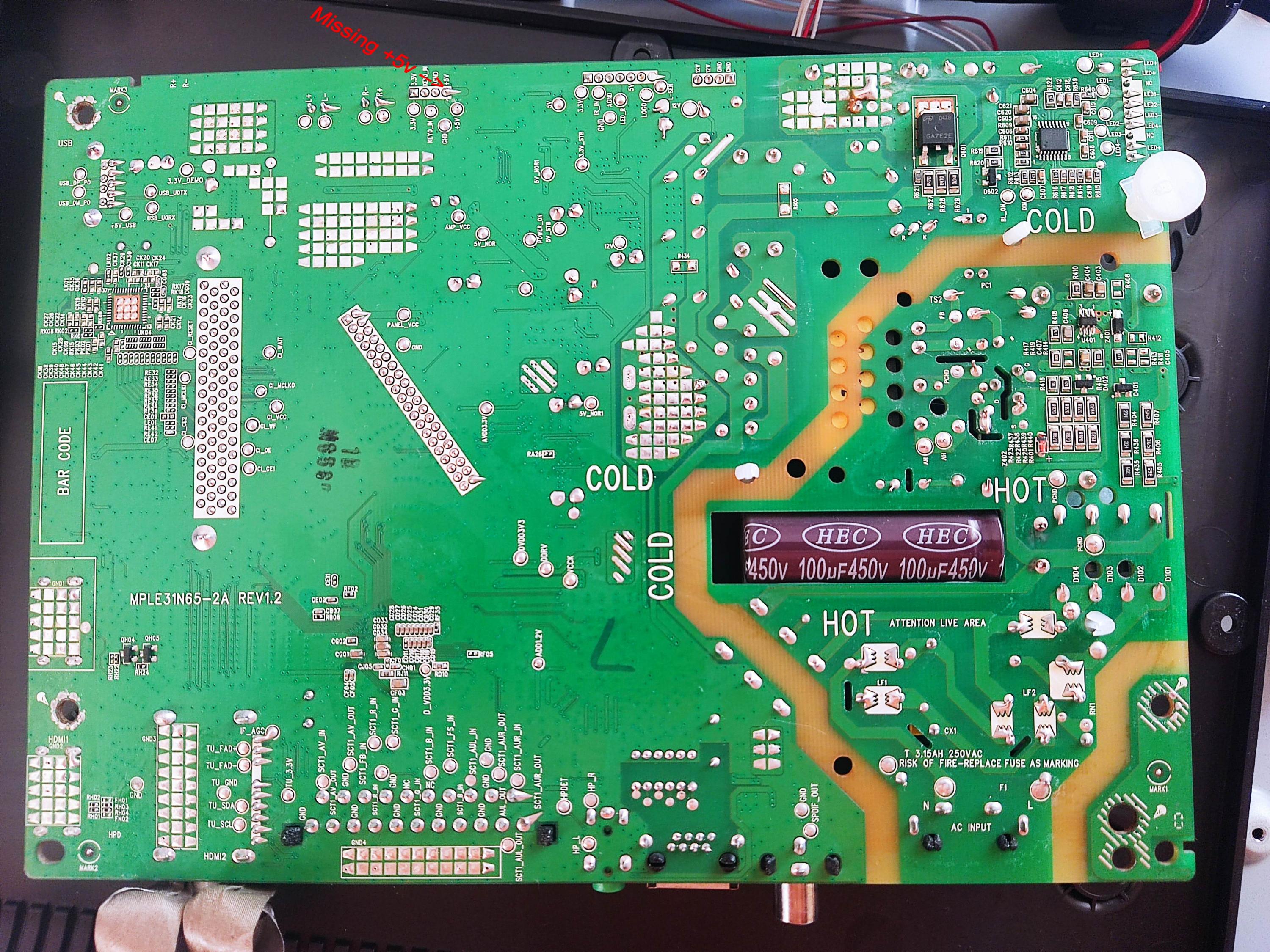

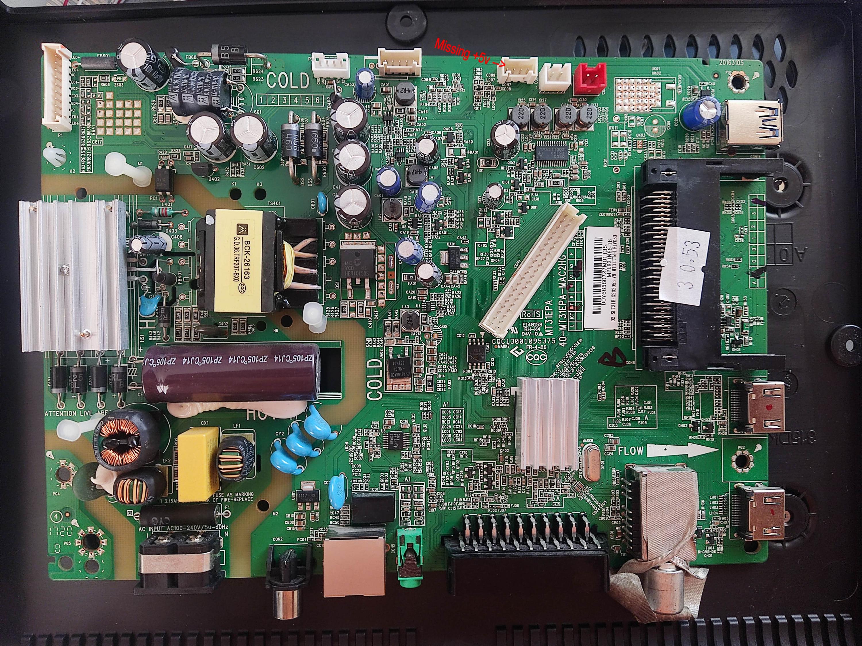

    Hi!
    I have this TV that won't light up the stby led, won't turn on, etc

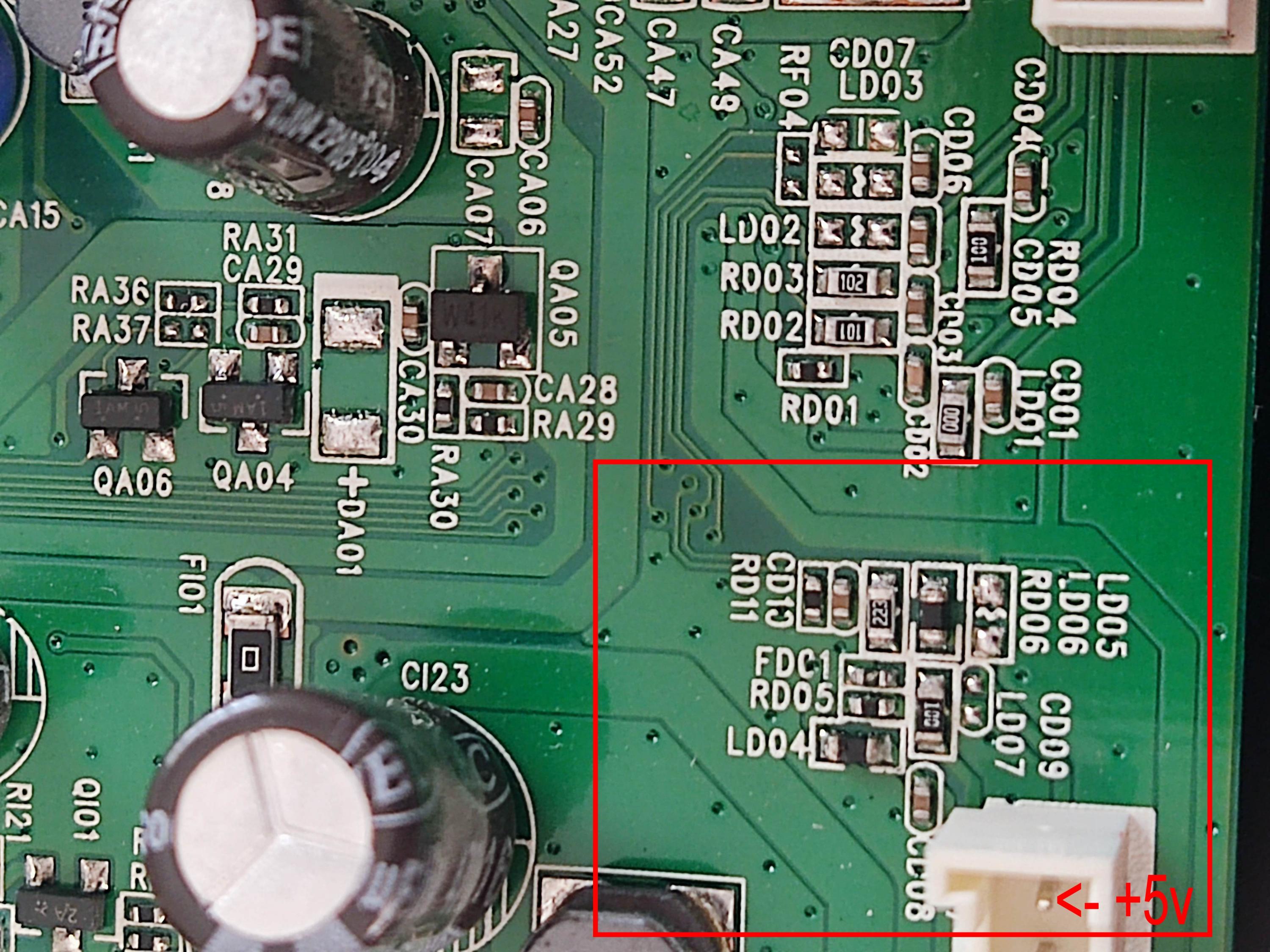

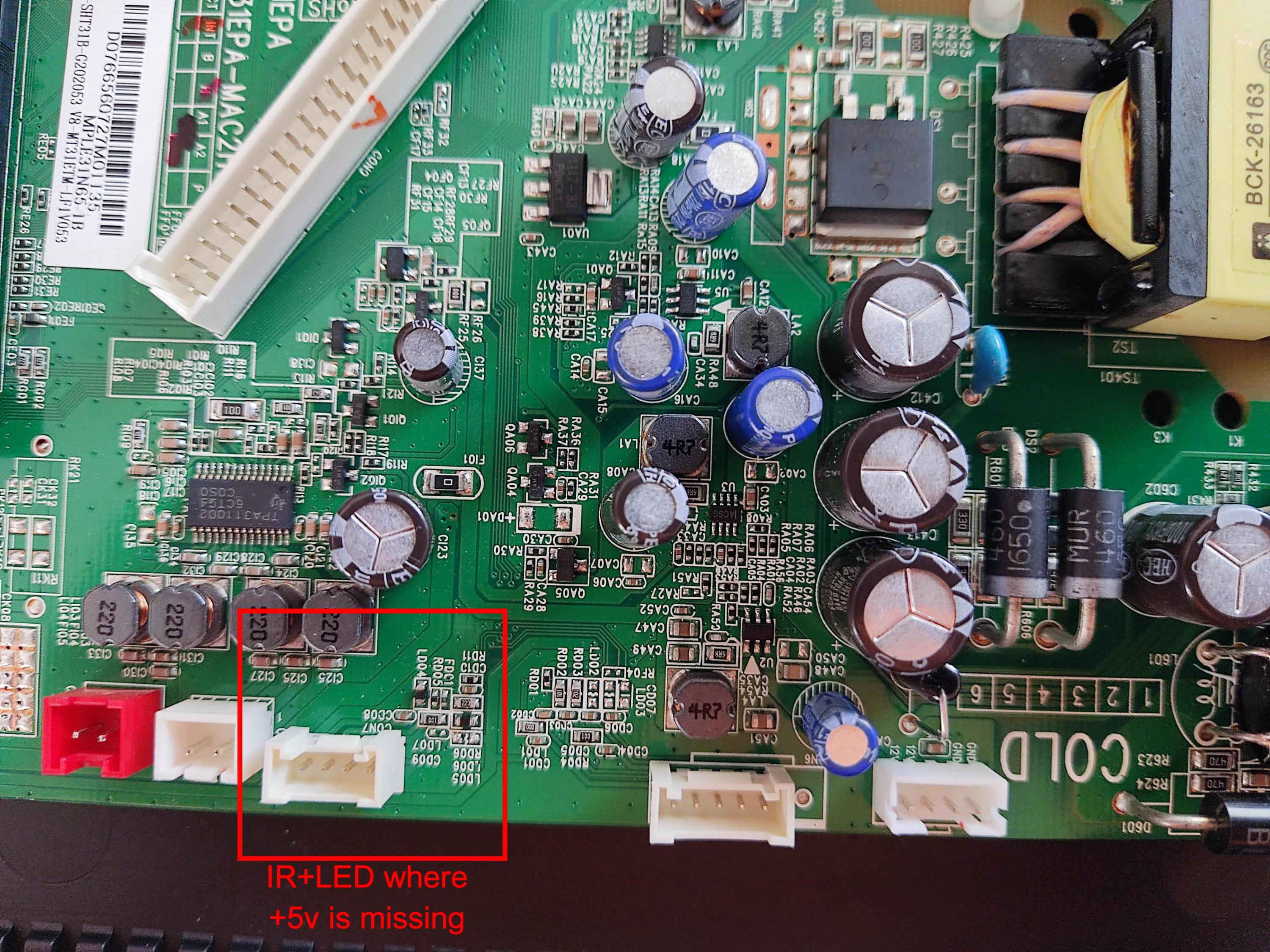

    Opened it and found all expected voltages in the backside test pads BUT one. There are a lot of +5V sources but one of them, the one that's driven to the backpanel keys module.
    There are lots of other +5v points working but this one specifically is dead.
    I took a close picture of the area where this voltage is generated
    There is a LD05 missing but this may be from factory? Should I short it?
    All the thru-board capacitors have a steady and valid voltage on them
    The small SMD caps by the faulty +5v source are not shorted
    What else can I try?
    Thanks!

    You could have lost the firmware, from power surges in the network, if you have a programmer, then try reprogramming this spi flash, I will provide you with a working firmware.

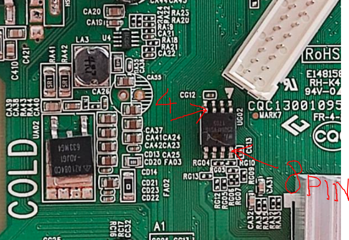

        On 8 pin. does spi flash have 3.3v?, besides 5v the board should have 1.1v, 1.8v or 2.5v and 3.3v do you have them?

          I have measured all those voltages at different test pads (specific for Vxx_yy) around the board, including some other +5vcc, but I don't know if specific 3.3v for SPI is present
          What do you mean with "on 8 pin"? A specific socket ? Or IC?

            spi flash has 8 pin (+3.3v), 4 pin (GND).

              Here on these inductors and converters there should be output voltages relative to the ground.

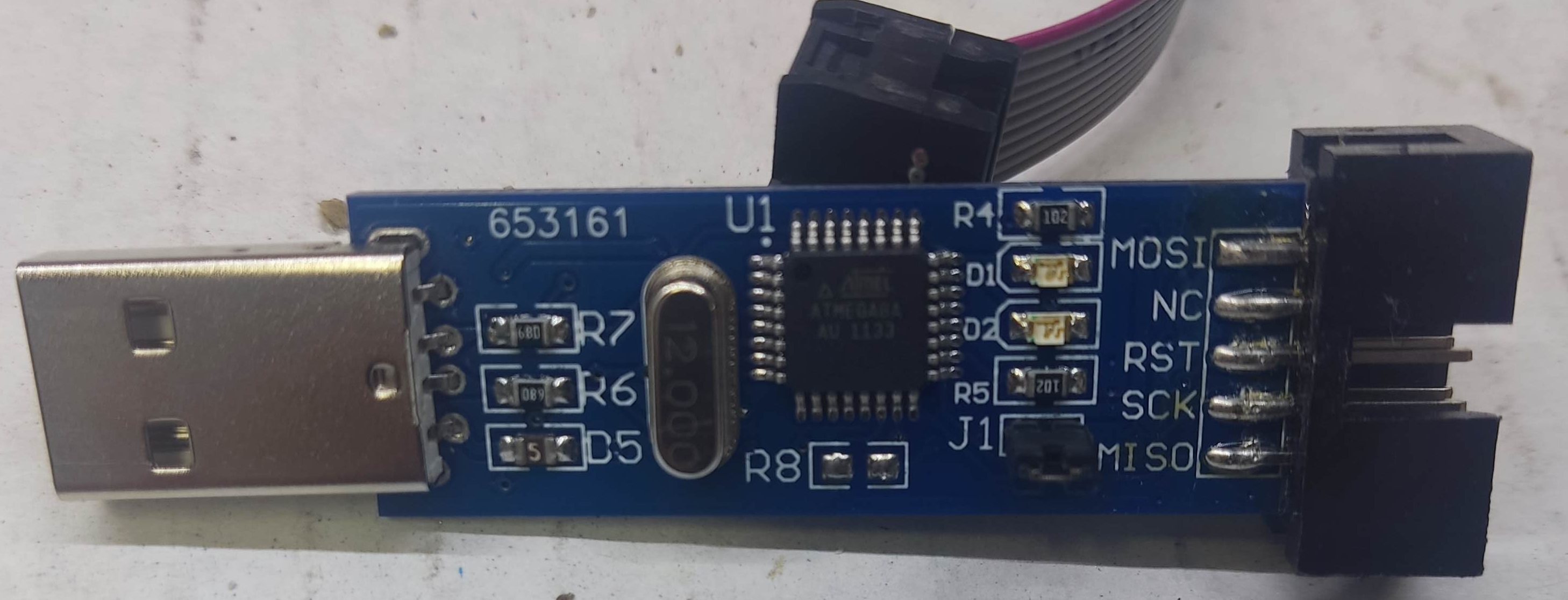

                  I will give this TV its last chance... Is this a valid programmer (see photo) to dump/write this flash IC? I just found it in some old boxes I had around...
                  I will check voltages first...

                      This programmer will not work, here you need at least the simplest, most accessible and cheapest one - CH341A and an adapter for it for your spi flash.

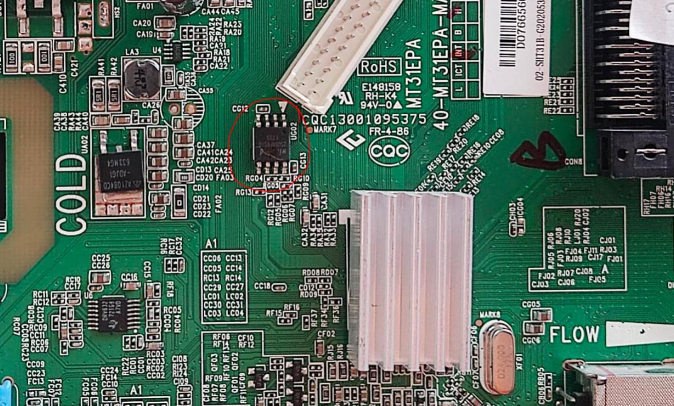

                        Ok I see. I just ordered a CH341A based programmer interface with the SMD clip
                        It will take 2 weeks to be delivered.
                        Where can I find the correct firmware to upload? This IC is Winbond 25Q64FVSIG
                        Thanks!

                            The programmer arrived and I was able to read the current content from the flash IC
                            BIN files is attached. I can't find any other reference bin file online.
                            Can you check if this file is ok and if not, share a working bin file with me?
                            Thanks a lot!

                              Try.

                                Ok, it took me a while and had to try 2 different programs, as one of them wasn't actually erasing the flash before programming, and when the new file was correctly programmed and verified, I tried to power up the TV with the new firmware but unfortunately there was no change
                                So I guess there is no firmware issue, there has to be something in hardware, but Im a bit lost on what to try first....

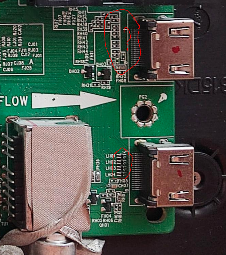

                                  Check the resistance of the input lines of the HDMI ports relative to ground, if there is low or short on these lines, then the processor has suffered.

                                    Tested. No, those small smd components you pointed show no resistance to ground, nothing at all, infinite.
                                    I checked the actual HDMI pins and 5 of them show GND, which is what the specs for HDMI pinout specify (5 GND pins)
