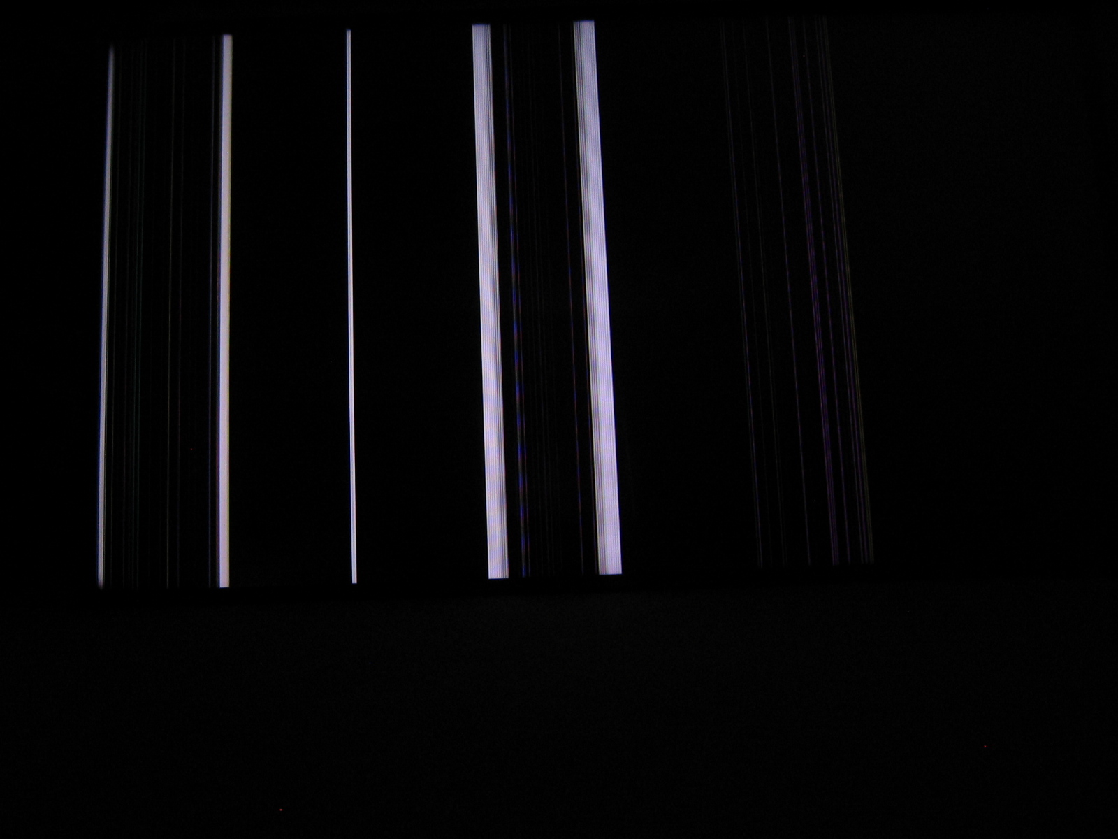

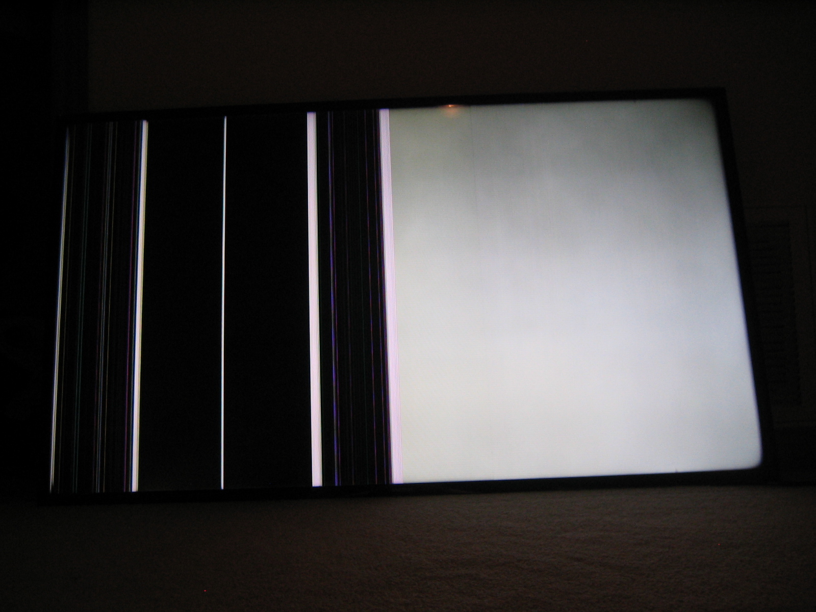

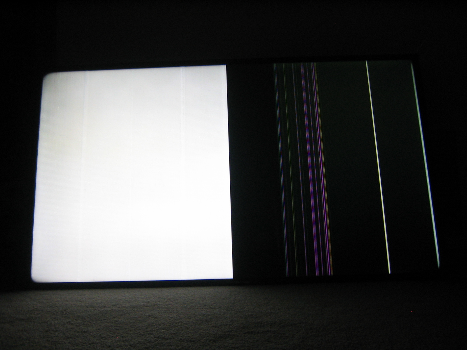

                          Here are the screen photos:

                            Re: Samsung UN48J5000: Backlight Strip Burn
                            Here are two more screen photos after disconnecting first one TCON to driver connector, then hooking it back up and disconnecting the other.
                            Please advise as I'm not sure what this test indicates. TIA.

                              #34
                              Try reseating those connectors. Concentrate on one side at a time.
