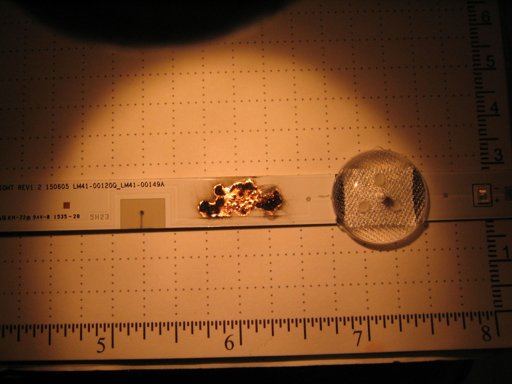

    New to me free. First time to work on one. PSB is a BN44-00852A. No joy on both SM or schematic despite extensive searching. First power up resulted in one Hz/sec buzzing/arcing and smell of electricity.

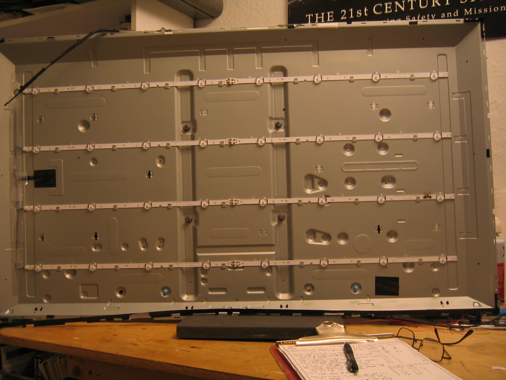

    Removed front pieces to expose backlight LED strips (2015 SVS48 FCOM FHD DOE A RIGHT REV1.2 150605 LM41-00120Q_LM4100149A) and noticed bad burn mark on one LED strip! Right between two LEDs.
    I tested all LEDs using a bench supply with current limiting. All 32 were fine. Von ~ 2.75Vdc. I made a wire bridge over the burned area by soldering on both sides, but it didn't work and burned out the end LED to the right. So I cut the strip to remove the burned area and shorted it to complete the series ckt. Then reinstalled it in the backlight panel and powered on the set using a VARIAC to limit the voltage to about 85 V. Slowly raised it to 100V, then off, then back on to restart. Only upper two rows of LEDs light. They still pulse on off on off. Heard & smelt more arcing and have now lost another LED due to burning. Quickly turned off the power.
    Began PCB tracing on backside of PSB. Though four pairs of wires connect the PSB to the backlight, it's all one series ckt, with a single driver, a D9N40 MOSFET. Tested in ckt. it's not shorted. Something is wrong though. It appears the LED driver ckt voltage is way too high to cause such a burned out area. The PSB indicates "130V @750mA". I initially meas. over 200Vdc on a single pin and zero on the others.
    Anyone here seen such a fault before? We're a long way from the boot chime & welcome screen.

      Re: Samsung UN48J5000: Backlight Strip Burn
      No, they were not connected. I disconnected the backlight plug to prevent further damage.
      No LEDs have been replaced. They're very, very tiny on these strips. Barely over 1mm square. Far smaller than I've ever seen on any repair video.
        So you have a bunch of blown LED's on the strip and you didn't replace any LED's? Since LED's are current driven, the PSU will try to always send an X value amount of it unless it goes out of x amount of spec and turns off. So if a diode fails, more power is getting sent to other LED's in that string. They don't like that and are going to fail. By the sounds of things, first see if you can find replacement back light strips.
          I've only seen one LED drive circuit that used a fix voltage for driving the LED string (small, low end no name TV). In that one example, a single shorted LED would indeed increase the current to the remaining as the voltage was regulated.
          However, in these Samsungs it's the current that's tightly regulated. As individual LEDs short, the current is maintained but the voltage *across the string* will change to maintain string current while the voltage drop across each individual LED remains the same.

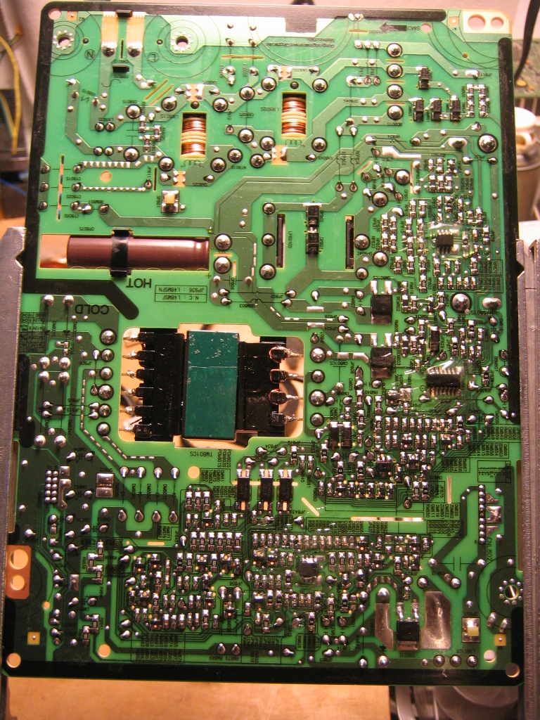

                    As promised, here are PSB photos.
                    Q on R9842 (9 Ohms), will increasing it or decreasing it lower backlight current? The LED driver MOSFET (D940) appears OK. At least it's not shorted D to S. However I may have to pull it for a more thorough test.
                    I'm not sure just how common a LED backlight driver ckt is between manufacturers or within the same brand. I've looked at several Samsung PS schematics with much lower AN44-00xxx numbers and noted more than a single driver. Perhaps Samsung is departing this 5000 series to save $$$?
                    A few more items from my notes:
                    1. With BL unplugged, 227Vdc was meas on pin 1+. All others were 0V. So this must be the max V available with an open ckt.
                    2. Using a Kill-A-Watt, I meas. set current at 90mA (6W) with BL unplugged and 1A (43W) with BL plugged in. Line Vac = 121V.
                    3. Top row of 8 LEDs draws 97mA with 22Vdc from a bench supply. All 8 very bright.
                    4. Second from top row: 103mA with 22V. All very bright.
                    5. Third from top: 1.9mA at 22V. All very dim. Obviously something wrong with this one. High resistance impeding current flow. This meas. was taken with the burned area shown in the photo still in place. It's since been cut out and the ends shorted (removing one LED) to complete the ckt. New meas: 440mA @ 22V! Holy Cow! That's Nuts! Small wonder the PSB board doesn't like that load! Losing a single 3V LED couldn't do that. There are these tiny (3.2 T x 2.8mm W) blocks between each LED with two side terminals marked + and - that I used to apply voltage to each LED to test it. The two silver pads on top are not connected to the sides. One of these was also removed when cutting out the bad burned section. Perhaps they also serve another function?
                    6. Bottom row: 127mA @ 22V. All very bright.
                    7. Obviously something's still FUBAR about strip #3. With the burned section present, the end LED and the 'tiny block', it was only drawing 1.9mA @ 22V. Now with these removed and the traces shorted together where I cut out the bad section, it's drawing 440mA at the same V? What's up with that? The 'block's are not resistors. Clearly I don't understand how these LED strips are wired.
                    That needs figuring out before I power up the BL though. Ideas?

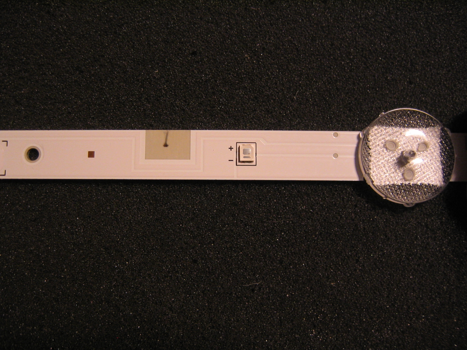

                        https://www.badcaps.net/forum/attach...5&d=1525221835
                        What do you get when using meter in Ohm mode to read the resistance of the component with the (+) and (-) in both directions?
                        What do you get when using meter in Diode mode to check the component with the (+) and (-) in both directions?
                        It looks to be protection Diode.
                          In Ohm mode, - to -, + to +, I read OL and LED barely lights, with polarity swapped, I read OL and LED doesn't light.
                          In diode mode, matching polarity as in above, I read OL and LED barely lights, opposite polarity, I read a diode drop of .78V and no beep.
                          When repeated on the short section with the burn mark, the open LED, the meter reads OL in all orientations and both Ohms & diode modes.
                            OK, so it is protection diode (5V ZENER is typical for 3V LED) connected in anti parallel with the LED.
                            So did you test each one of those diode on all the strips?
                            So are you going to replace the BAD LEDs strip?
                            BTW, I am not so sure about 750mA of LED current, if it is then it is over 2W for the LED and I never seen 2 ~ 3W LED in that small form factor.

                                  I'm not so sure about a 5V zener. 5V would seem too high for any protection. Whatever it is, it didn't do much of a job of protecting that strip from over-voltage serious enough to cause arcing. I've spent a few hrs reading other posts in the PS Forum (didn't know it was there) and found TV PS's discussed as well. Also discussed were burning LED backlight strips w/ photos! Far more serious than my case. LG was mentioned often. Very alarming no protections were in place to prevent such damage long before it got to that point. Electric arcs burn very hot! Very illuminating and educational to say the least given my very recent introduction to what's going on 'behind the screen' in these modern sets.
                                  I used those "test points" to verify the individual LEDs worked by applying 2.75V. That and the recent meas. you requested were all of the testing I did on them as I wasn't sure just why they were there. All of the repair videos I've watched are for much older sets that didn't include these.
                                      Example of LED with built-in protection Zener diode.
