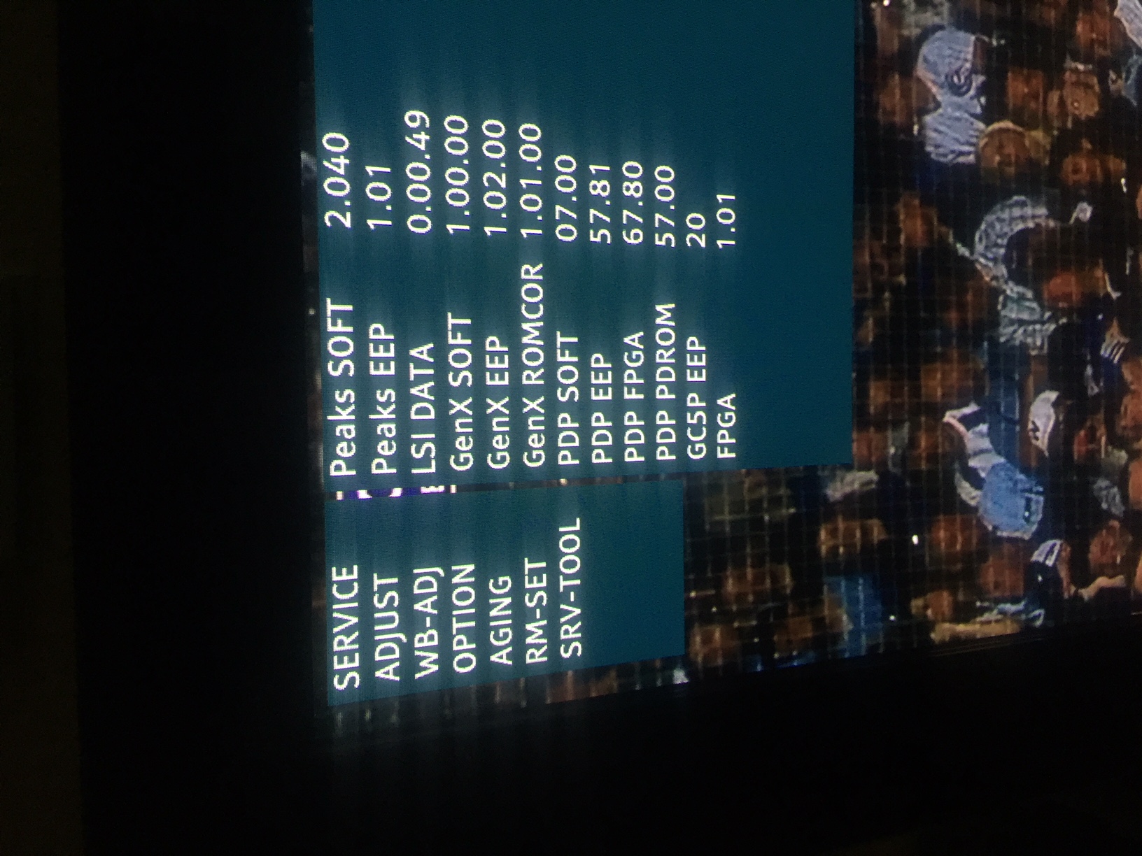

    Hello all ~
    Just got a Panasonic 50" plasma that has a yellowish discharge that only shows up when the screen is white or a light tan. Hockey games, commercials with primarily white backgrounds, etc ...
    The Model # is TH-50PZ700U
    It is HIGHLY noticeable. Needs fixing. So, I researched it, and found that I should be able to adjust the VSUS from Low to High in this Panny's service menu.
    I got in there successfully, but the VSUS adjustment option is missing from the master list. I watched two videos on YouTube just now. One guy had the VSUS option in his list and the other did not.
    If you look down the left-hand side of the service menu picture (see below) the term VSUS should appear in the list between OPTION and AGING (according to the video I viewed), ... but for some reason is missing.
    Question, then, is .... Is there a way I can easily access this VSUS option in my service menu even though it is not initially appearing in the list?
    I'm attaching a pic I took of the list itself as it appeared on my screen. Also attaching one that shows the # of hours on the set (a bit over 15,000).

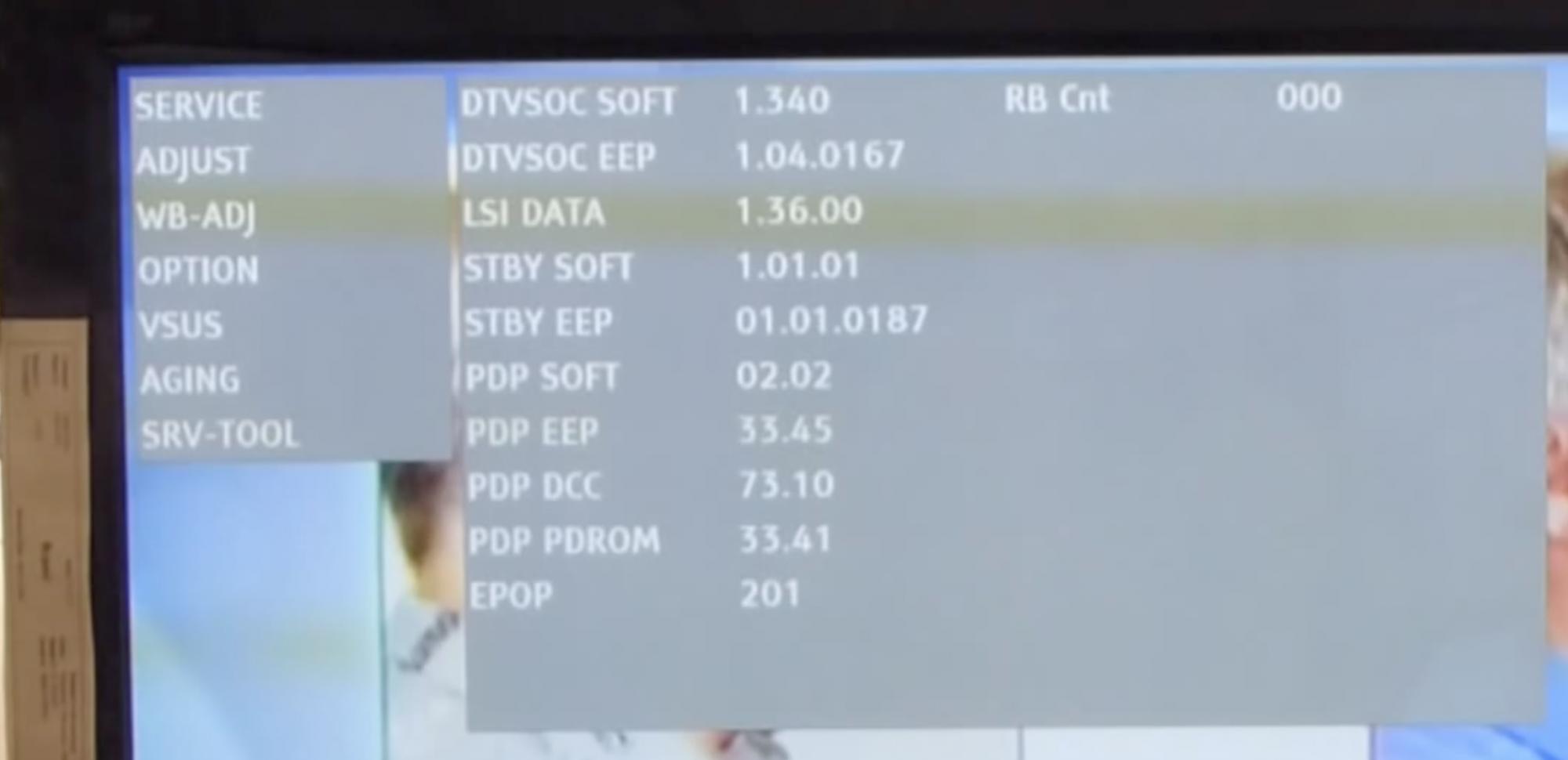

    Now, here is a screenshot of the video I was referring to in Post #1.
    You can clearly see the VSUS term placed right there between OPTION and AGING.
    NOTE: I know I can probably make this adjustment manually if I take off the back cover to the set. And, I will do that if necessary. But I want to first simply change it from LOW to HIGH in the service menu and see what sort of change that causes. I've read where several folks had immediate success in getting rid of all or most of this yellow discharge / discoloration that is now plaguing the picture.

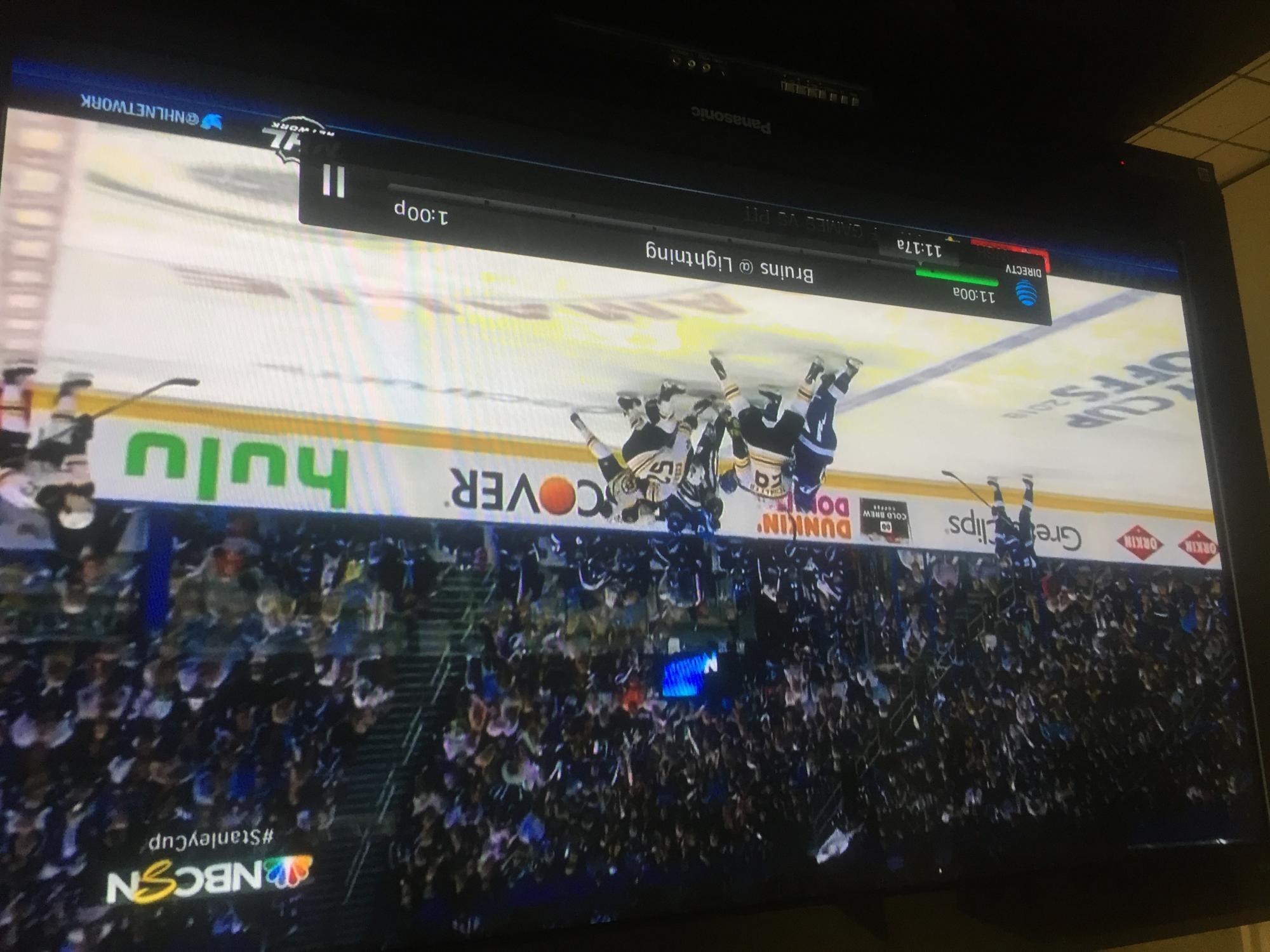

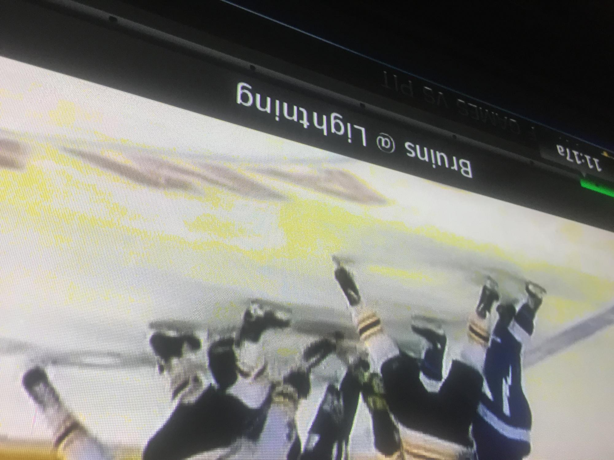

      A couple of pics from a hockey game that clearly illustrate the “yellow patching” problem. The yellow diffusion tends to follow the skaters around, but not always and not uniformly.
      Does anyone know if Panasonic discontinued the VSUS adjust on the service menu at some point in time?
