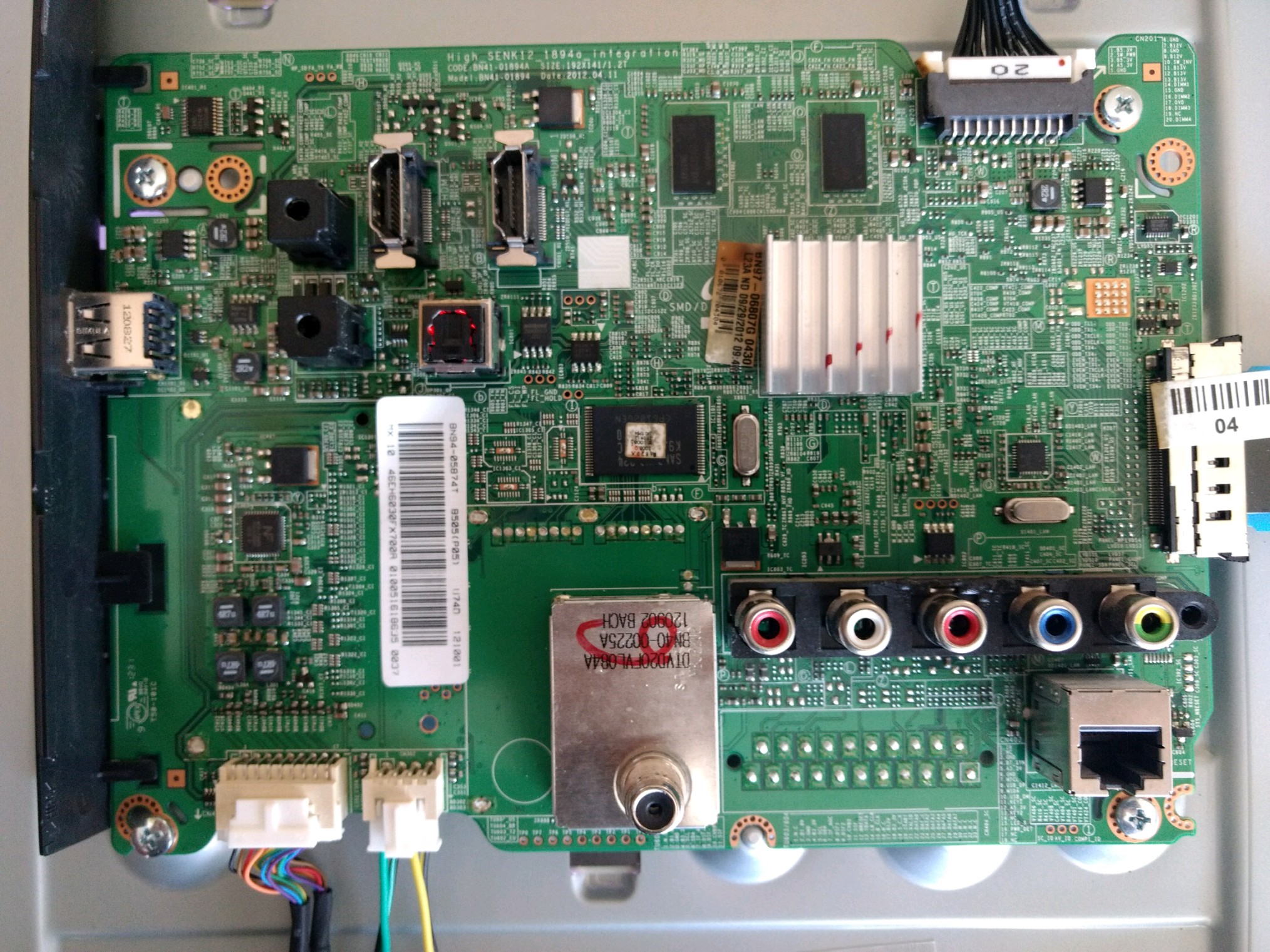

    Hello everyone. So for once I hope to contribute instead of take.
    The other day I bought a Samsung un46eh6030fxza. The standby light came on then flashed continuously about once per second as soon as the power button was pressed. When it was pressed again the standby light continued to flash and the off command wasn't recognized. PS_on also flashed from 3 to zero volts with the standby light

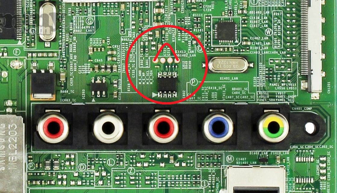

    I narrowed the problem down to the main board and suspected a corrupt eeprom. I tried to reset it but was unsuccessful.
    This evening I was watching a video about a corrupt eeprom on a 32" Visio, in that the person said they could heat the eeprom sometimes and get it to work enough to copy the data to another one. I wondered if that may work to get the Sammy to boot.
    So I heated the eeprom up.....then lo and behold the TV booted but the input button and remote had no effect so I powered it back down, jumpered GND and SDA on the EEPROM and powered it back up. 20 seconds later the set turned off, I removed the jumper and its now working!

      I found the info here....
      https://wiki.samygo.tv/index.php/UnB...y_EEPROM_Reset

        Is that a flash like Atmel or Winbond ? I'd be afraid the same failure may reoccur without replacing the IC.

            If possible I would remove and read the EEPROM then program a replacement. You could be confidence that it is unlikely to corrupt again very soon and you would have a copy of the EEPROM contents.

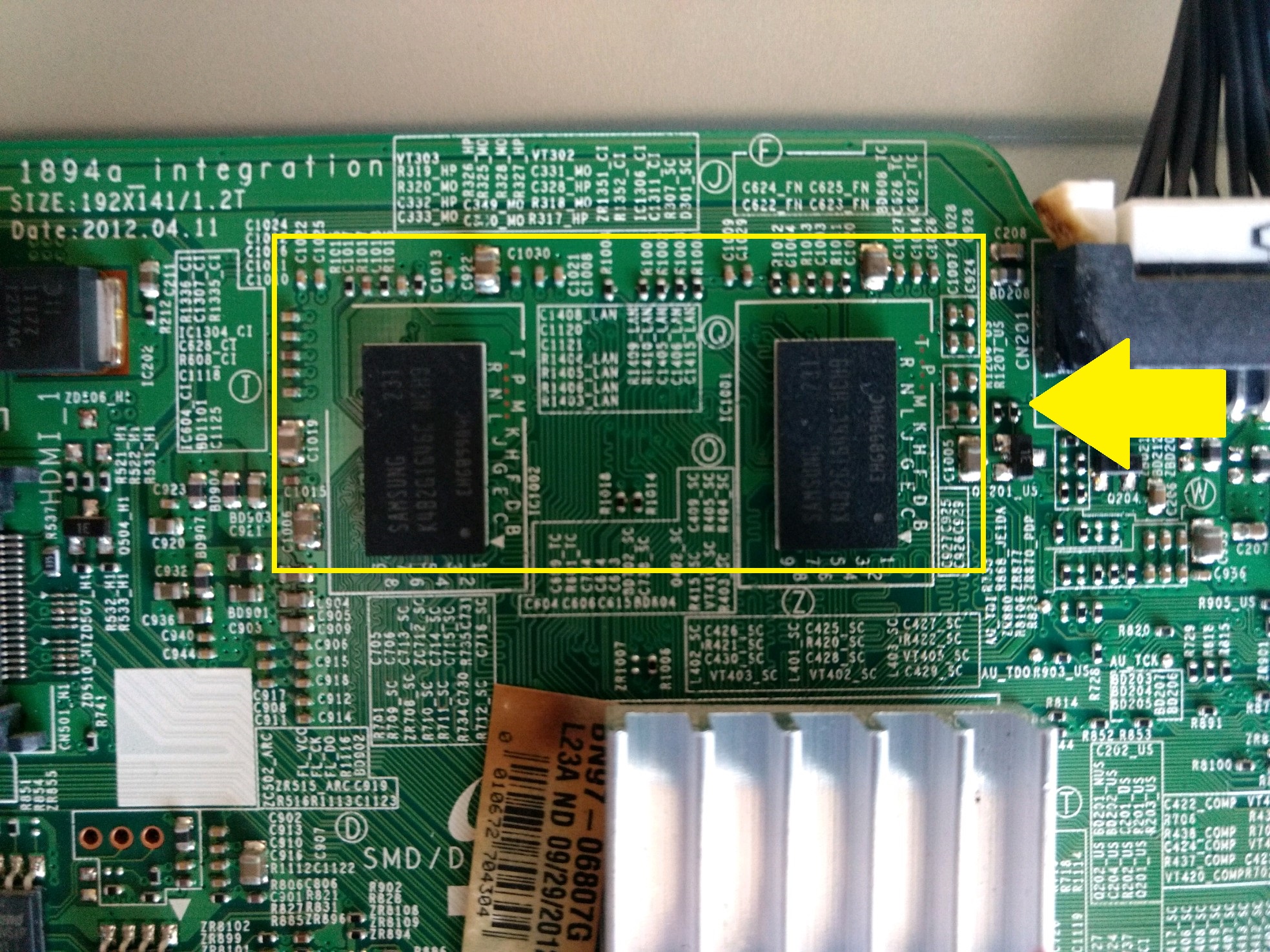

                            So I broke this TV back out to order parts. I decided to re-check the diagnosis.
                            I isolated and heated the EEPROM....and the TV would not power on
                            After an hour of isolating heat in different areas of the board I can reliably get the TV to turn on when I heat the left RAM chip above the processor for just 3 seconds, not even enough to even think of burning my finger.
                            After heating it the TV will turn on reliably with the remote and power button on the TV but will not power off at any time with the power button on the TV, only the remote. I'm not sure if this is related to this problem but I think it is.
                            So I guess I'm wondering if such minimal heating is enough to revive a bad RAM chip, or am I looking at loused up solder balls, or something else?

                                  Actually I did that with the nearby caps, wondering if one of them was causing the problem. I also made an aluminum foil reducer for the heat gun the size of the chip, put it right on it for 3 seconds and it popped on. At this point I'm 100% sure the problem lies with this one RAM chip, be it a bad BGA job or a bad chip itself.
                                  I do have an opinion that these RAMs don't go bad all that often.
                                  So what do you think? Bad chip or a problem with the BGA solder?
