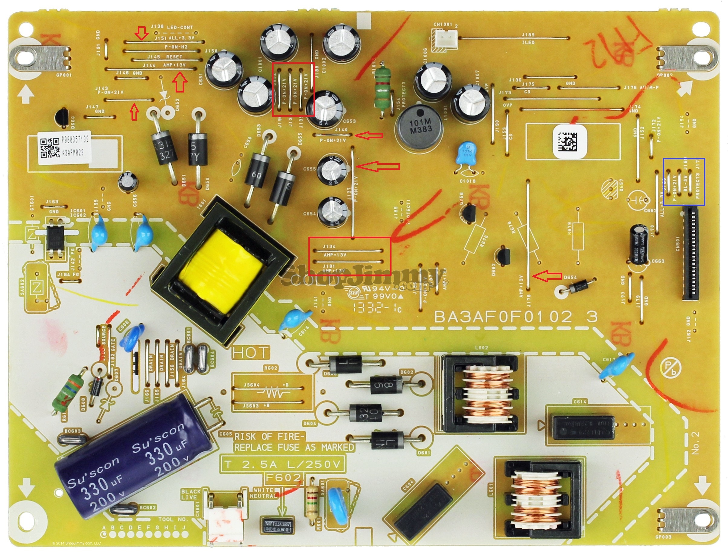

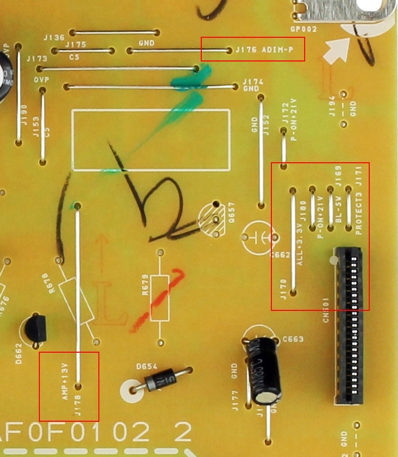

    Hello all,
    Working on a Funai LF320FX4F S/N starts with ME1
    When plugged in the standby light blinks 4 times and then is lit solid red.
    Pressing the power button on the TV or remote does nothing.
    There are no screen flashes or any thing displayed on the screen.
    I've measured volts all around the board including diodes D651 and D650 both are 20.9v and D653 and D655 are 12.8v.
    All the spots marked 3.3v, 13v, and 21v are withing spec at 3.3v, 12.8v and 20.9v.
    I've read in other threads where it is suggested to unplug the PSU to mainboard connector (CN501) and try to power on. When I tried this there was no standby light at all and the power button did nothing.
    The only ones that are not within spec are the ones on the right side of the PSU and near the PSU to mainboard connector.
    The locations are marked in one of the attached pics (Pic borrowed from another thread uploaded by budm.)
    P-ON +21V= 0v
    ALL 3.3V = 3.3v
    BL-SW = 0v
    PROTECT3 = .6v
    AMP+13V = 12.8v
    ADIM P = 0v
    No voltages changed when pressing the power button.
    https://www.badcaps.net/forum/showth...=32ME303V%2FF7
    This is a thread about a similar TV (also where I borrowed the picture from) with the same problem, but the thread seems to have died with no fix revealed.
    From reading the thread linked above since there is 0v for P-ON and 0v for BL-SW it seems that the mainboard is bad and not sending the power on signal to the PSU..is my understanding right?
    Is there a specific component on the mainboard I should test and or replace or is it best to just replace the whole board?

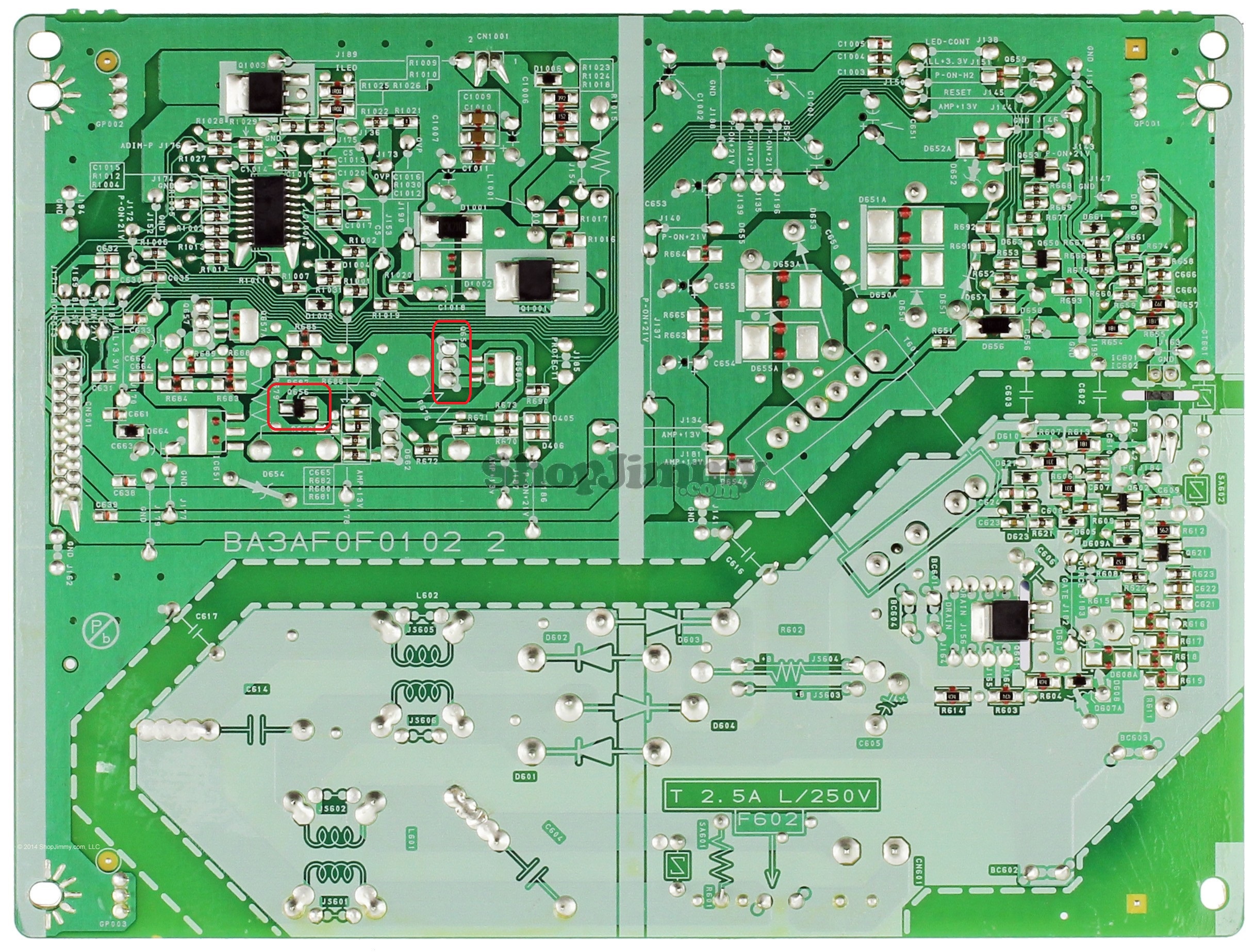

        What voltage do you have on Q653, it should have .6 volts on the base to turn it on, If you have more than 0 volts on the collector, the transistor is not turned on and the power supply is likely only in standby state.
        Q653 is located in the upper right corner of the picture

          In your first post you say you
          But further down you say P_ON+21 = 0 however D651 voltage of 20.9V feeds P_ON+21 so I'm puzzled as to what supplies are missing
          I suspect it's only the BL-SW voltage (backlight on) which probably comes from the mainboard which is missing.

            Re: Funai LF320FX4F Wont Power On
            dick is correct, maybe recheck the voltages right at the plug, the schematic shows what they should be,
            1,2 (0V)
            3-8 (3.3V)
            9-14 (gnd)
            15-18 (13V)
            19 (gnd)
            20-23 (21v)
              Sorry for the confusion.
              On the board there are several pins with voltages for P-ON+21v, AMP+13v, All+3.3v and all of those have the correct voltages (locations marked in pic). it's only the pins over by the CN501 connector that are not right (marked with blue square).
              I measured Q653 and the side with the single leg measured 3v and the other side with 2 legs both showed 0v.
              I was going to try to check voltages at the connector, but it got to dark and I was afraid I would short something out.
              It looks like it would be easier to flip the board over and test it but the pins are side by side instead of inline up and down so I'm not sure how to go about testing it.
              thanks

                          So so we have BL-SW signal?
                          You will have to leave the meter probe on it while turning the TV ON to see if it jumps up for seconds, or stay up >2VDC.

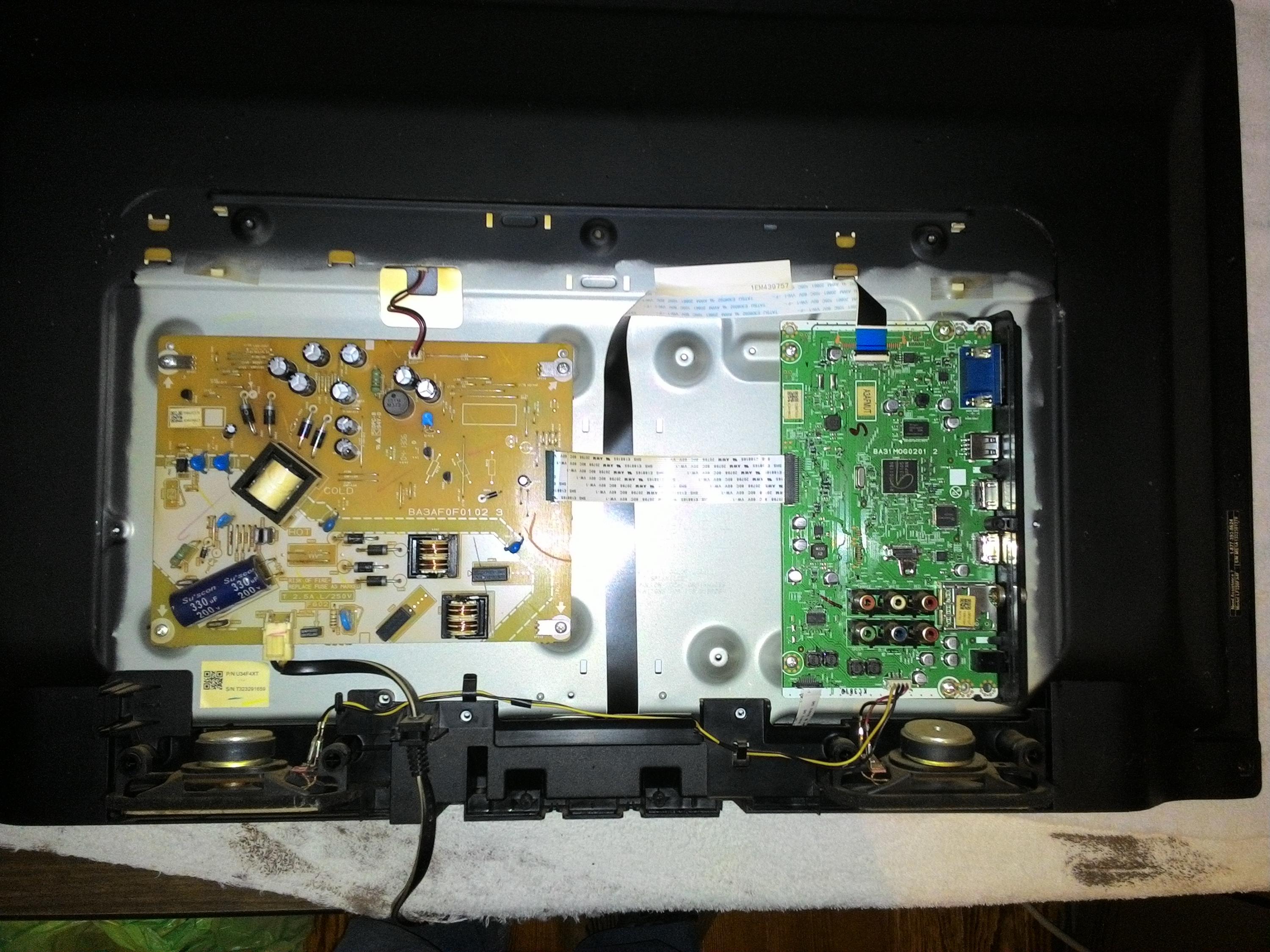

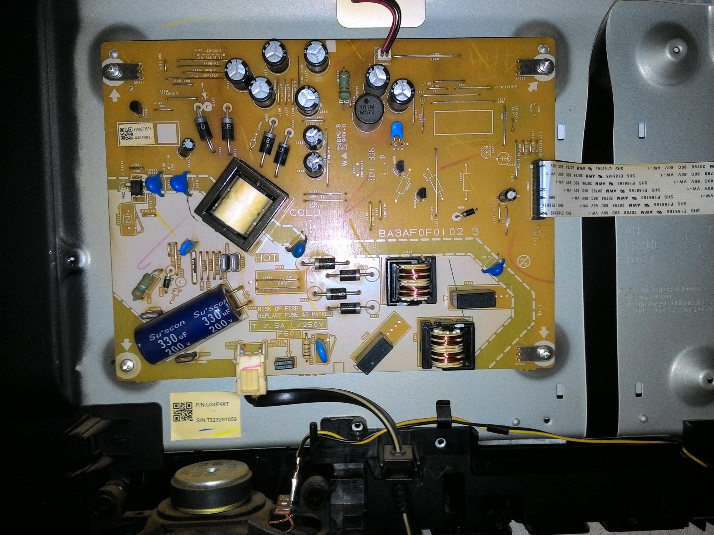

                            I went ahead and took the panel off to test the LED strip just to be sure they all worked. It has a single strip with 16 LEDs. Using 5 9v batteries I briefly connected it to the + and - on the strip and all 16 LEDs lit up.

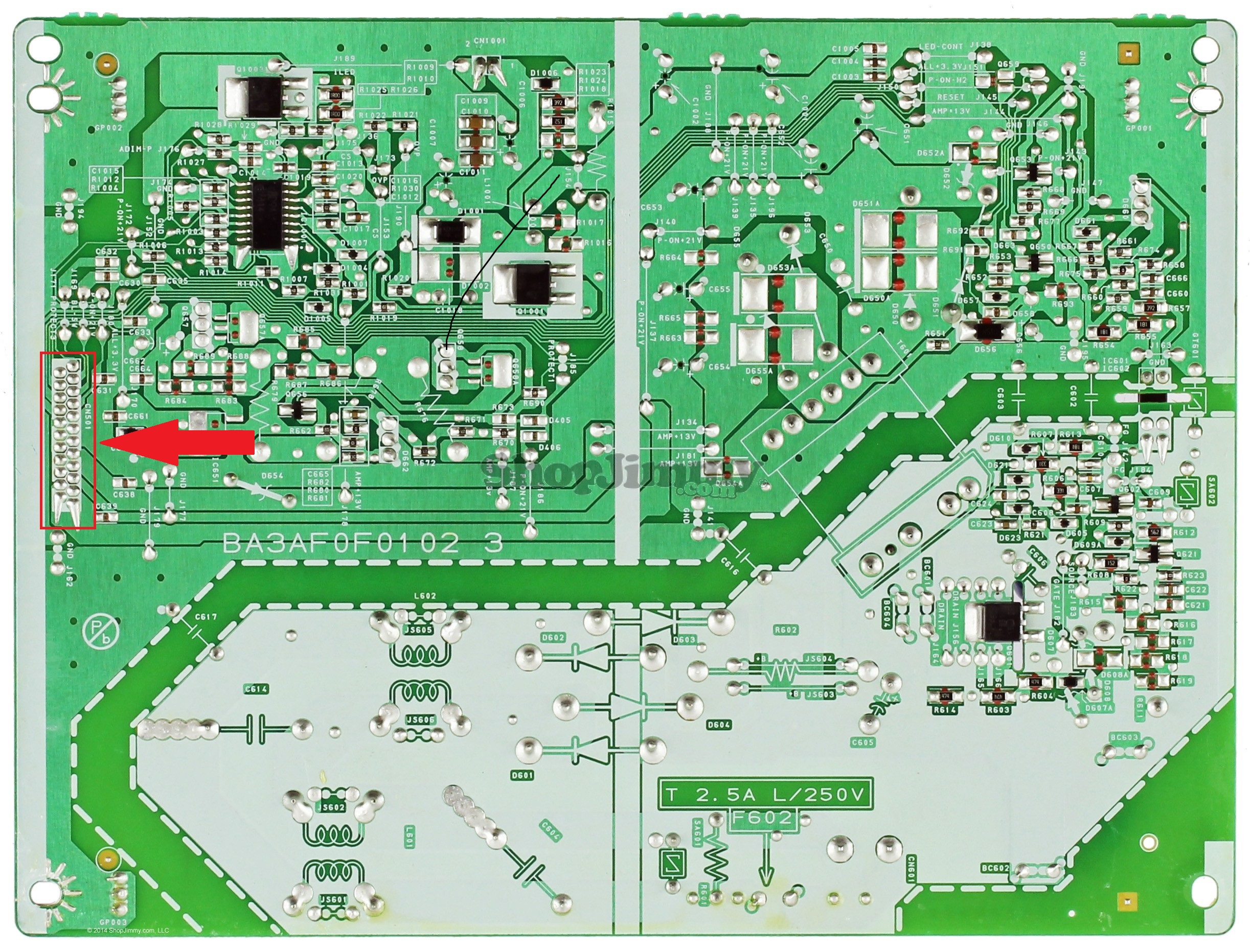

                            J169 BL-SW shows 0v when plugged in (standby) and doesn't change after pressing the power button, still 0v.
                            R_J: With my skill level (lack of) and the tiny pins I don't know if I could run wires to the pins as you suggested. I'd be afraid I'd short something out.
                            Instead could I unplug the main board and run a wire from J170 ALL+3.3v to J169 BL-SW?

                              If the backlights all work then I suspect the fault is either with the power supply or the mainboard, You should be able to connect the wires on the back of the power supply board, on the connector pins, if the backlights com on then the fault would be with the main board

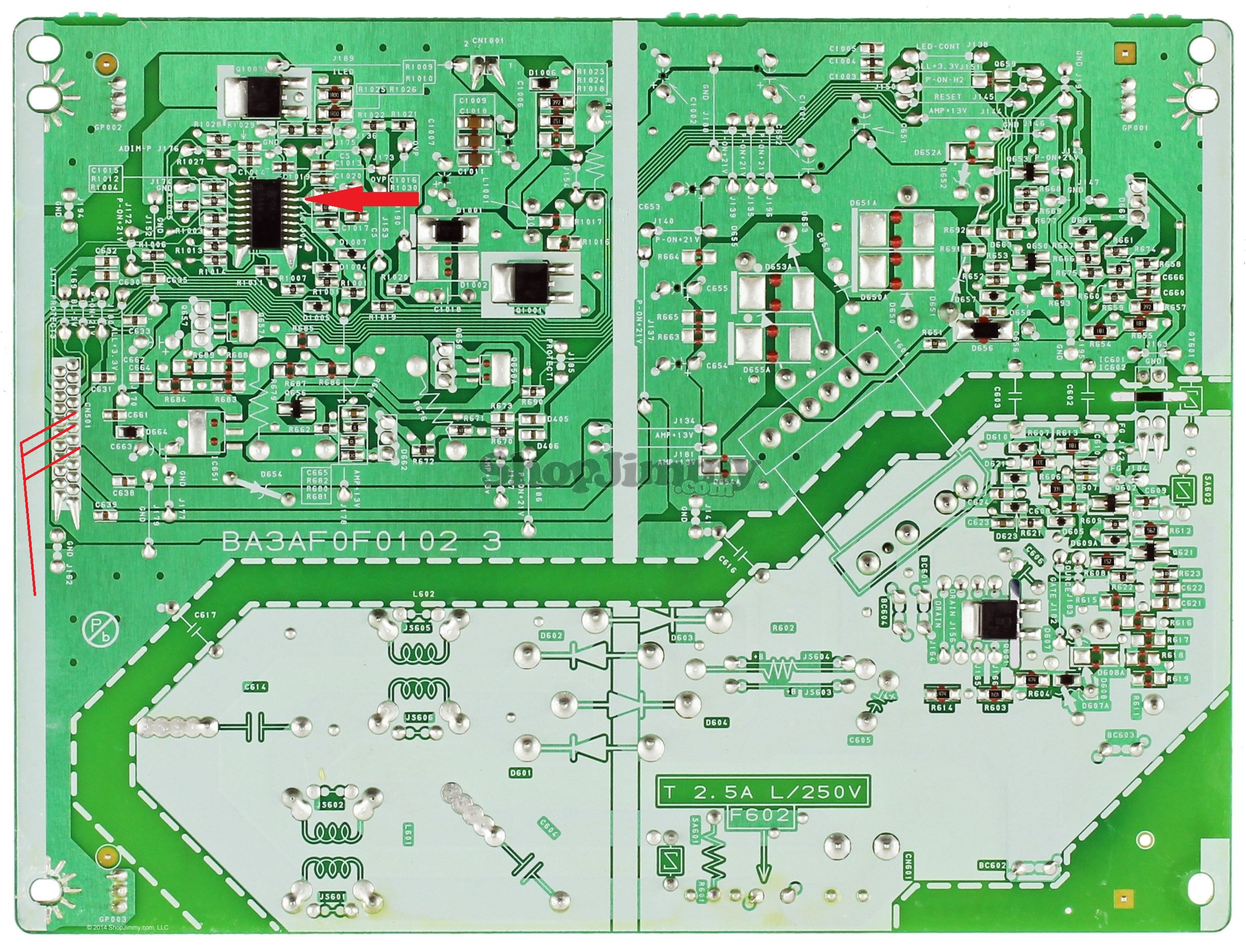

                                DMM set to 200 ohm scale R1015 constantly fluctuates..was as high as 160s and as low as 30s..Tested in circuit. Should it be tested out of circuit?
                                Would pin 14 of IC1001 be the one I have marked in the pic (red arrow)?

                                To connect to the pins on the back of the PSU would I bridge the gaps diagonally by soldering wires to therm? (Like I have marked in the pic)

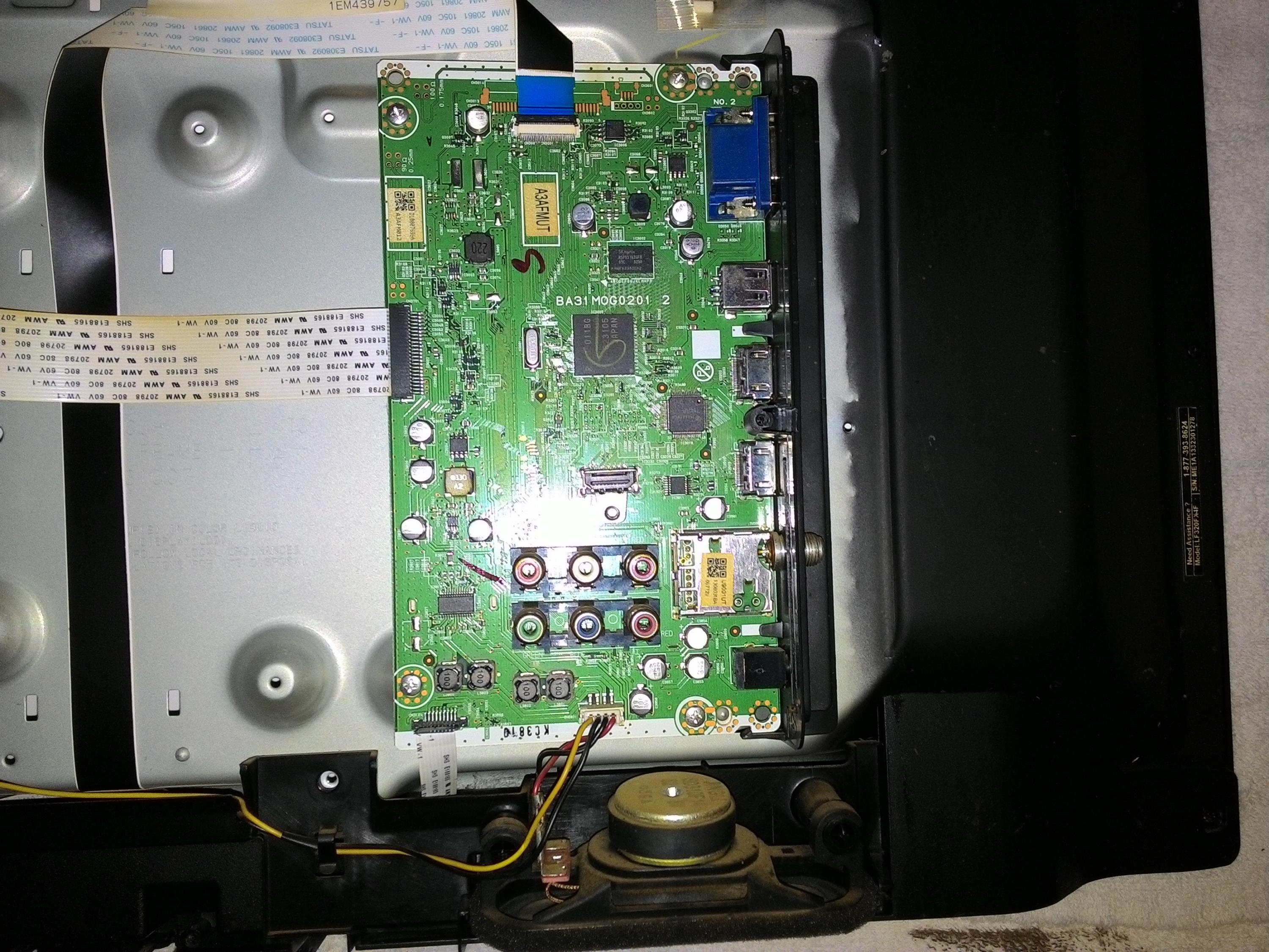

                                    It's fixed.
                                    I connected the pins as R_J suggested in post#11 and the backlights came on, so that only left the main board as the culprit.
                                    I found 1 on ebay for a DS1 model TV (shopjimmy lists it as an alternate for a ME1) and after I installed it the TV fired right up. woohoo!
                                    What component on the main board is likely the bad part? The eprom?
                                    thanks everyone
