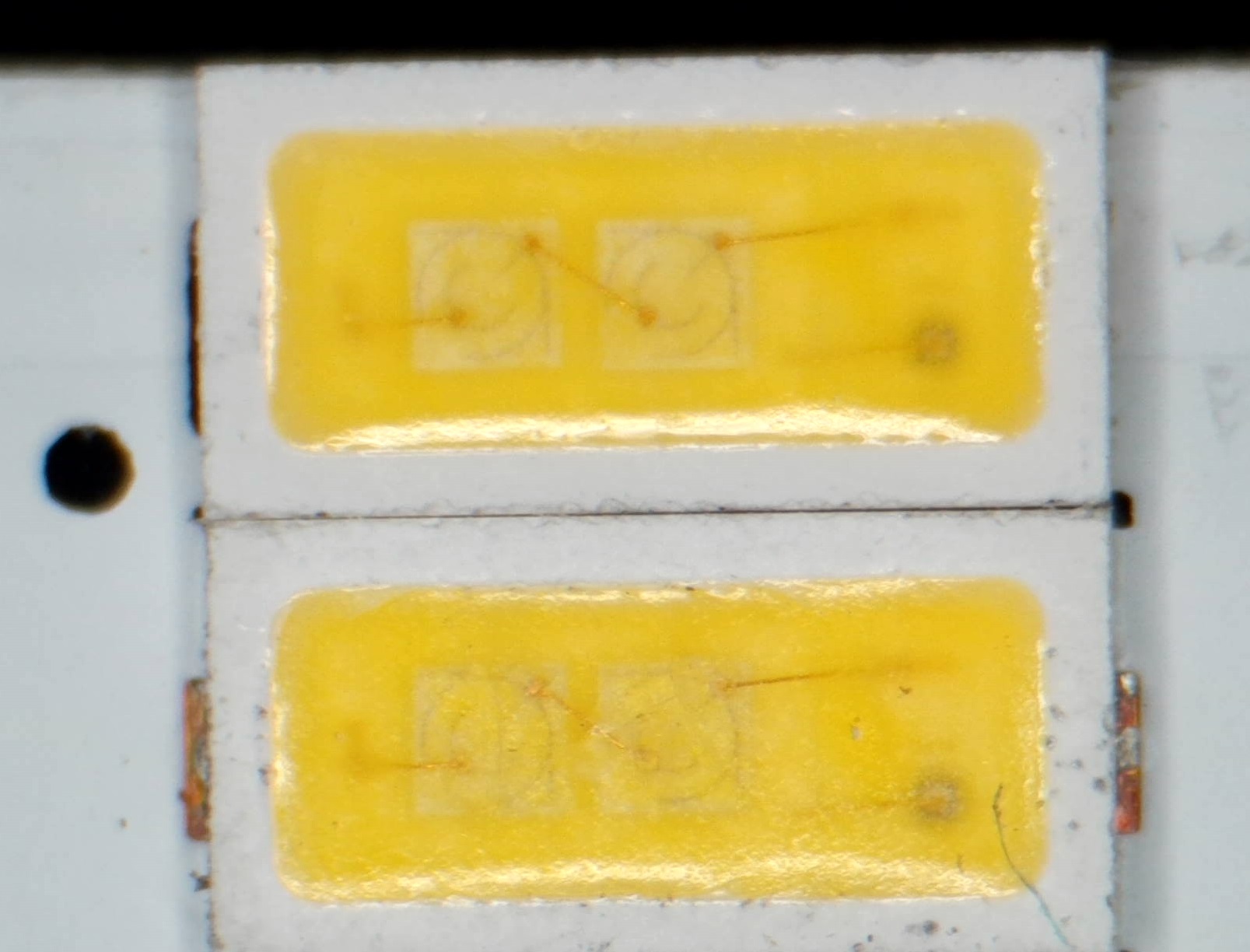

                  Re: Panasonic TX-47AS650E Blinks 1 time , Replacement LED?
                  If it's edge lit, I believe it's one of these LEDs ?
