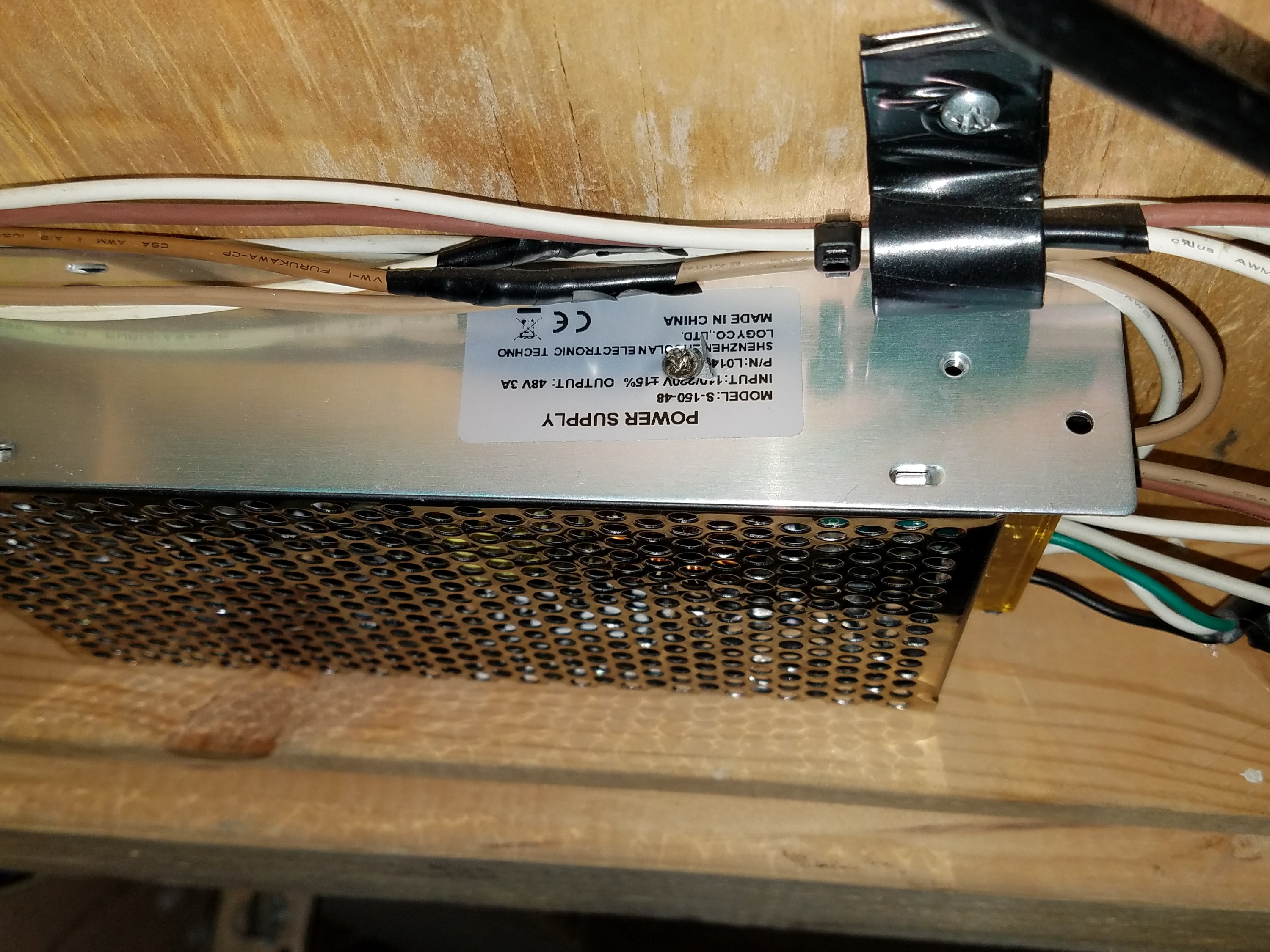

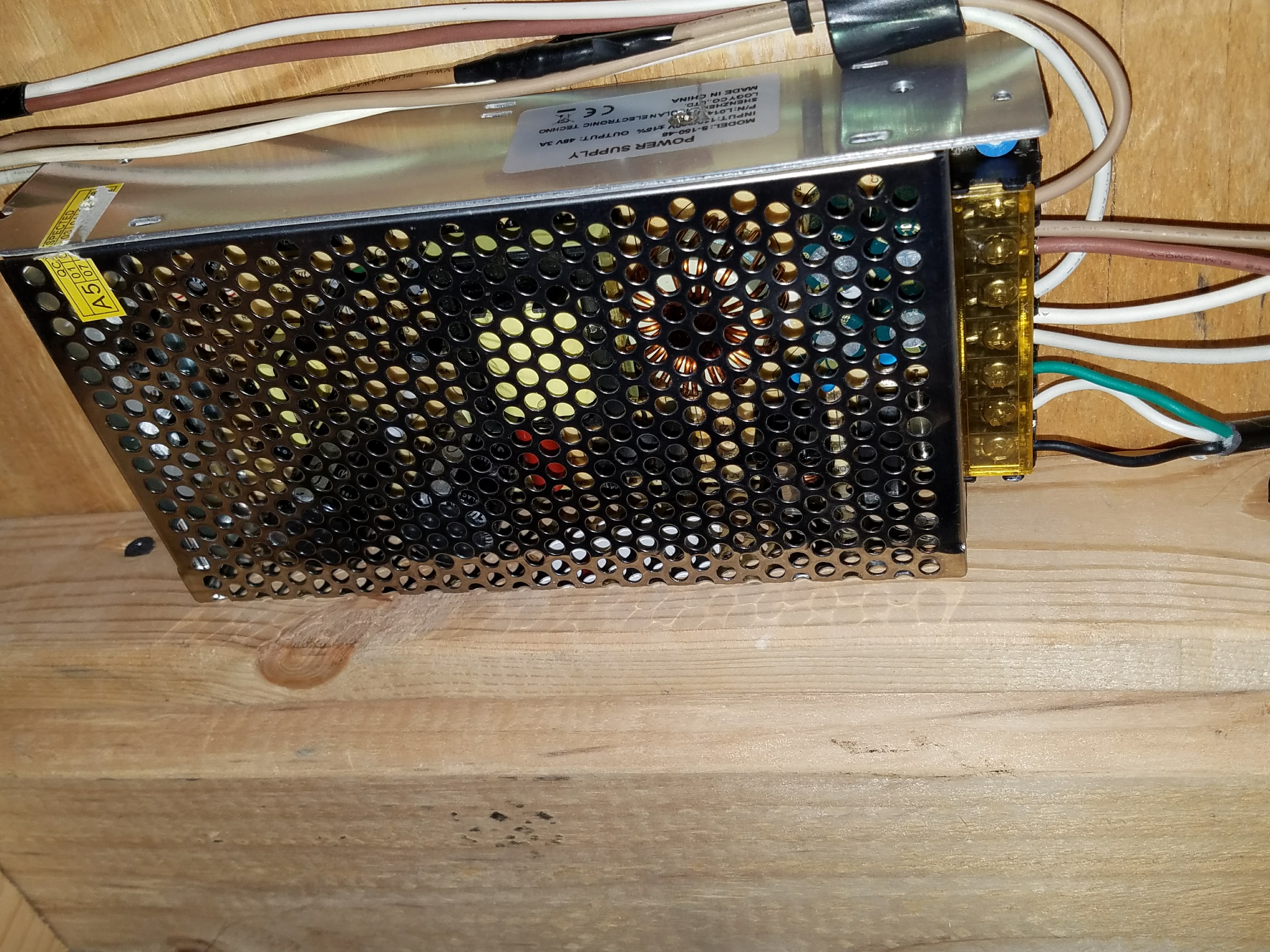

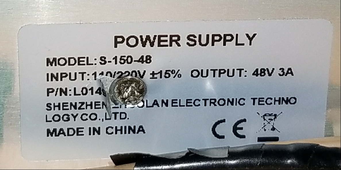

              You could rewire the strips in parallel. I have an LED light box for photography. I used 25 strips of 5 LEDs. I replaced all the LEDs to get the correct color temp, but you wouldn't have to. I used a cheap 48v, 150 watt SMPS from China, and modified it so it output 31 volts. Figure out what voltage 1 strip requires, and if you have an ammeter, put it in series with your LED tester to find the current drawn. From there, we can figure out the required wattage for a power supply. The model number is S-150-48. I think it was under $15.

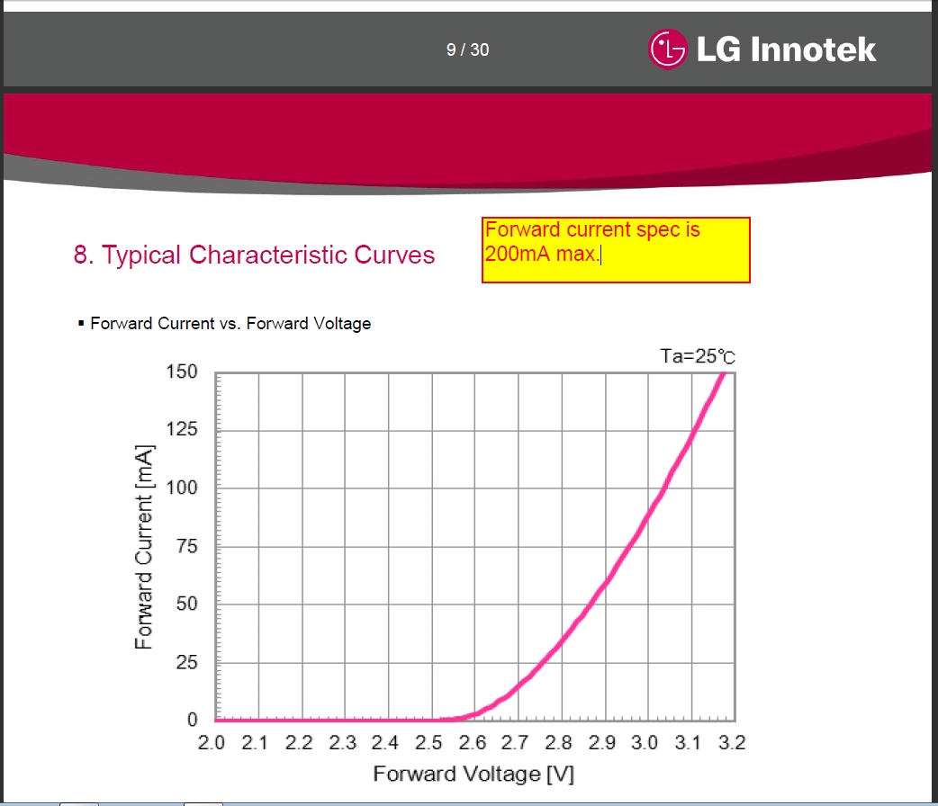

                That typical LED tester can only put out maybe 30mA at most.
                What you have to watch out is the amount of current being force through the LED, here is the sample graph of Vf vs If.
                LED is the current device.

                          So, if they were rewired in parallel, it would be 25.8v, still 300ma. Maybe find a 24v supply rated for a half amp. And that output could be adjusted to 25.8 if necessary.
