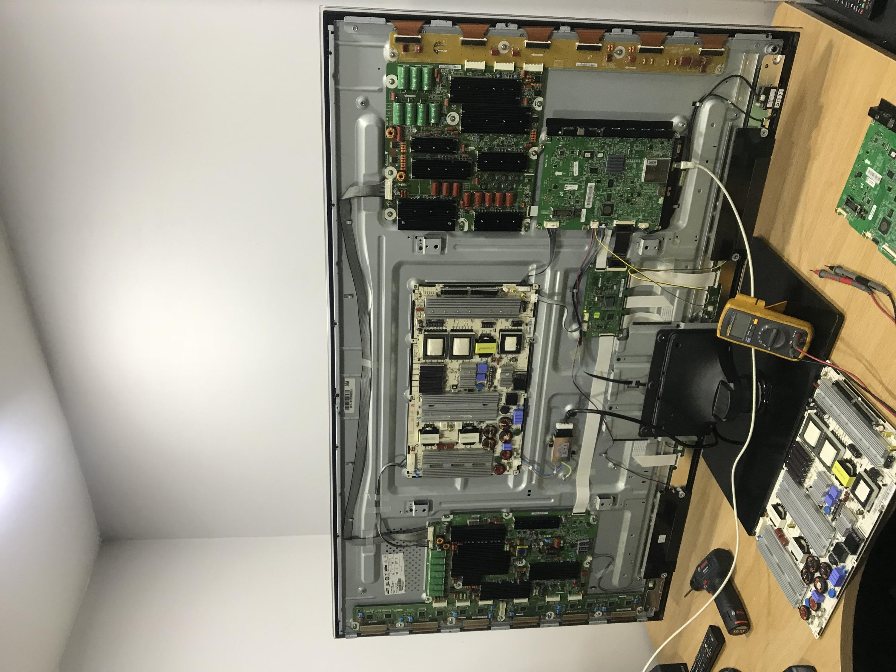

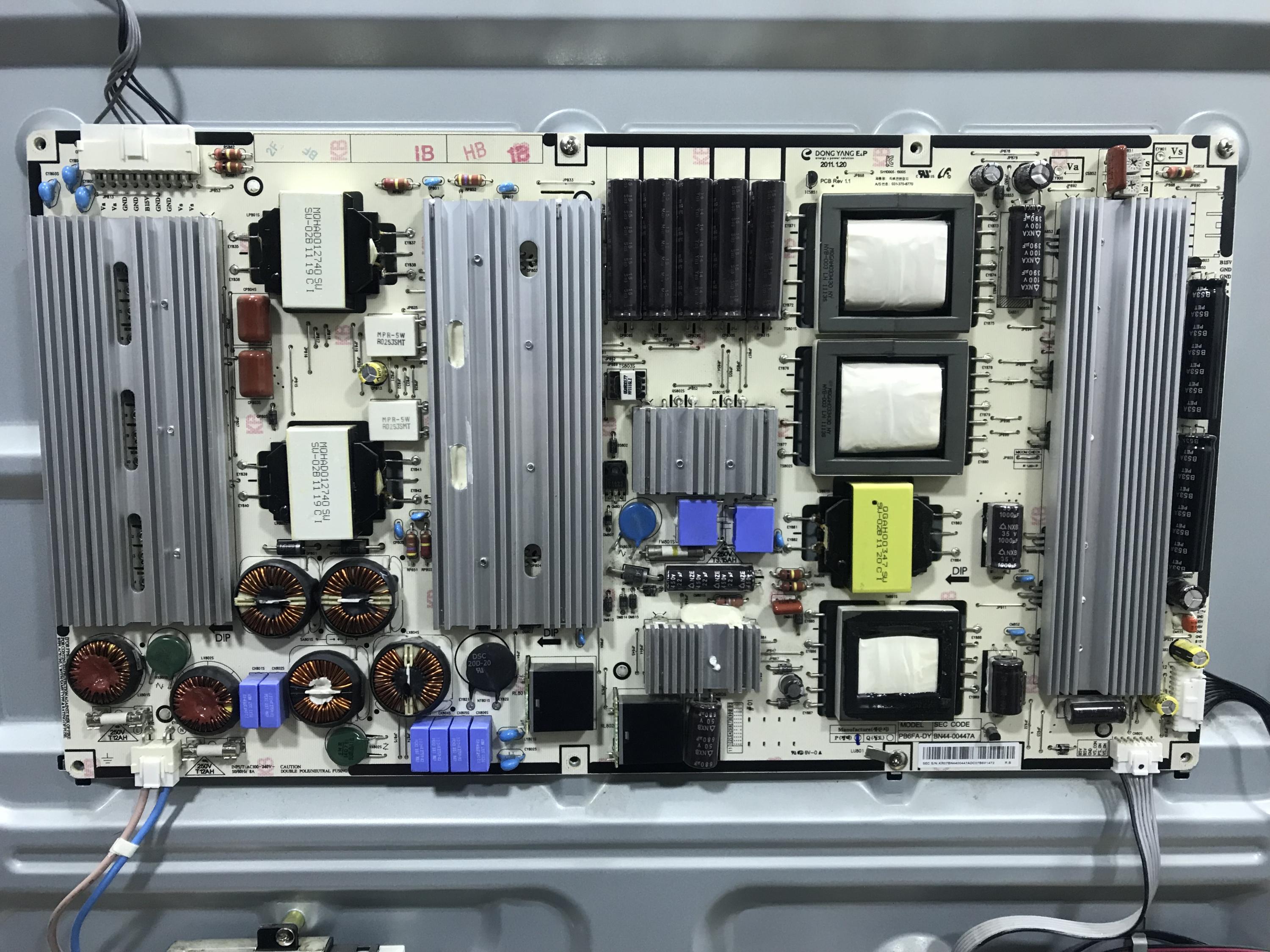

    hope someone can help with this as i have no idea where to start , the tv came to me working but restarted every 15 seconds (picture and sound were perfect) i assumed it was the mainboard but tried unplugging bits one at a time to see if it stayed on or not, when plugging the xsus back in (tv unplugged) i got a little spark at the connector and the picture didnt come back on after that, everything else seems fine but no picture, i bought a complete tv the same with a faulty psu and fitted the mainboard so tv stays on now but still no picture, on the ysus connector from psu i get.....

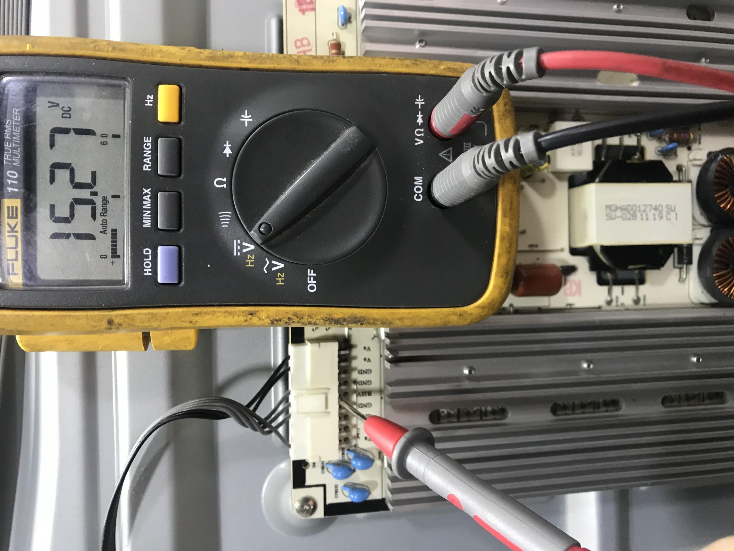

    VS = 0.378V
    VA = 0.01
    B15V = 15.27V
    i can add more pics if needed,
    any help would be really appreciated

        Remove the power supply board and check the solder connections on the transformers.
        If you get lucky, the arc may have just shut the power supply down, But you may have either damaged something on the power supply board or the Ysus board, check the resistance across the pins Vs and Ground WITH POWER OFF

          Right that was my next comment I forgot to add. Also check the soldering underneath the mosfets and diodes that are attached to the aluminum rails. it would not hurt to re solder them anyways along with the transformer contacts

            thank you all for your replies, i did have the tv powered off while disconnecting/connecting things but even after reading toms plasma troubleshooting guide i kind of skipped the wait 15 mins bit :-( and only waited a couple of minutes (which felt like 15 mins when stood waiting) il check the power supply when i get home tonight and try resoldering, i have all the boards from the donor tv so i can use the ysus and xsus from that if needed, as far as im aware it was only the power supply blown on the donor tv, i did try plugging the donor tv psu in and it blew the thermister, mains plug fuse and tripped the house electrics. (it wasnt connected to any other boards when i plugged it in) hopefully if its just one or 2 components damaged on my psu i can salvage them from this donor psu. thank you again for your help
