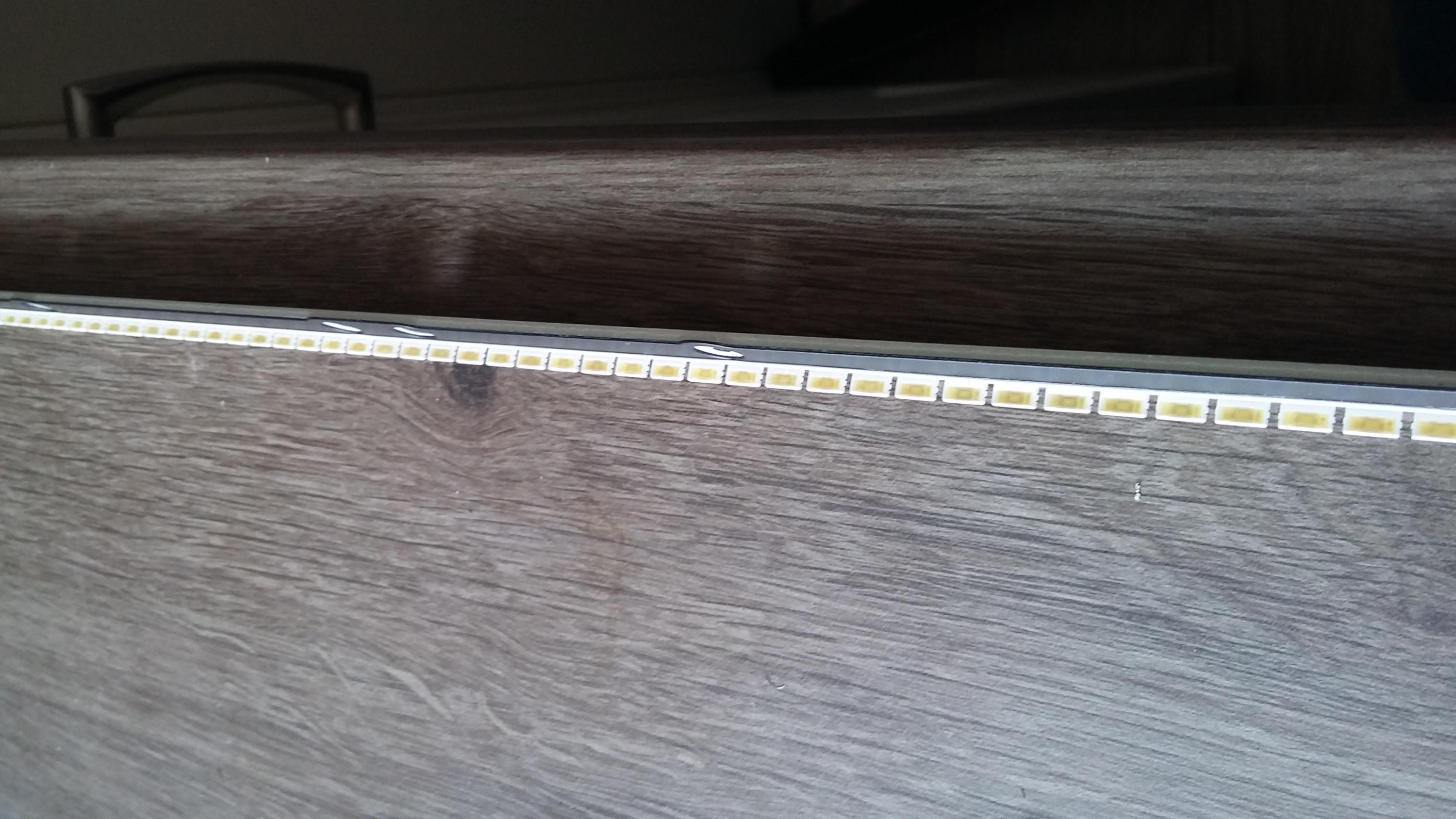

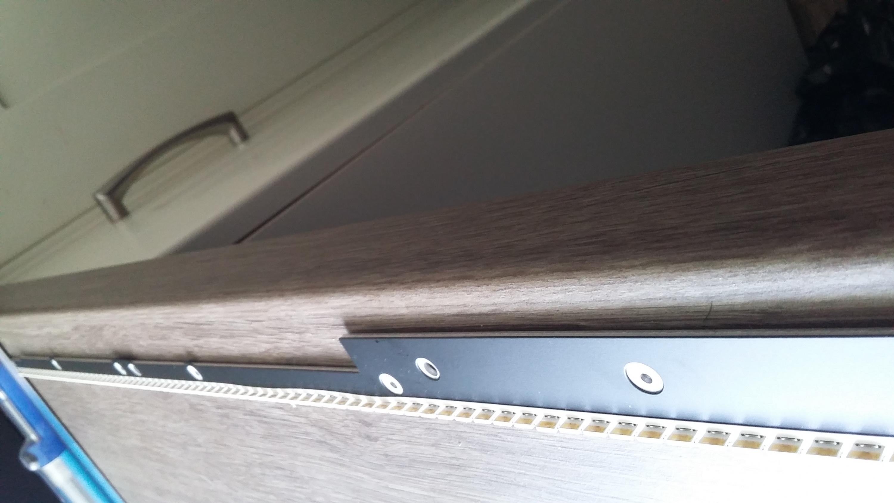

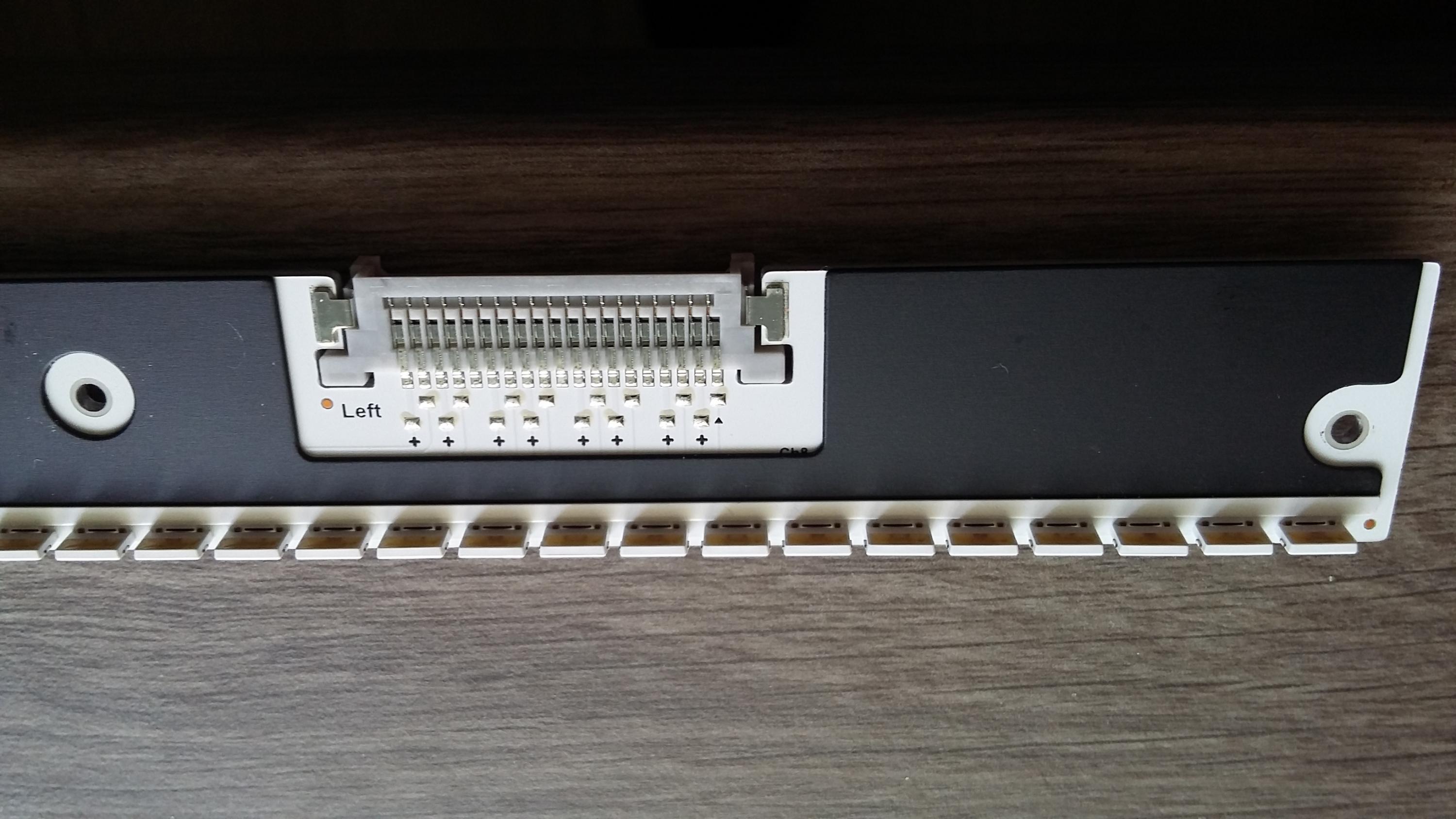

                  One thing i did notice is that when it cycles on the samsung smart tv logo appears and from looking at the screen I can see the leds light but tye bottom third of the screen looks darker. It makes me wonder if the bottom leds are working. I have popped the covers and seen that there are 2 led strips. One at either side. I notice one led was loose and broken bottom right although they are absolutely tiny. I have spare 0.5w leds the same style. What would you guys do here or how could i test these. They didnt make it easy lol

                      If you got it all the way down to the LED strips you should't give up, a hotplate, some tweezers and a magnifying glass can work wonders with these. You can get replacement LEDs on aliexpress, our members here can help you in getting the right ones, assuming you're willing to wait a month for them.

                        I know what you mean I have spent a good amount of time on it so far. There doesn't seem to be a way to test the other leds too they are all on a bar in series. I have attached a picture to show what I mean.

                          Edge lit.

                            Yes. Was gutted when i seen that. Near impossible to replace the led. Couldnt even see any spares online. If I could have got the full bar I would have bought it lol for an easy life

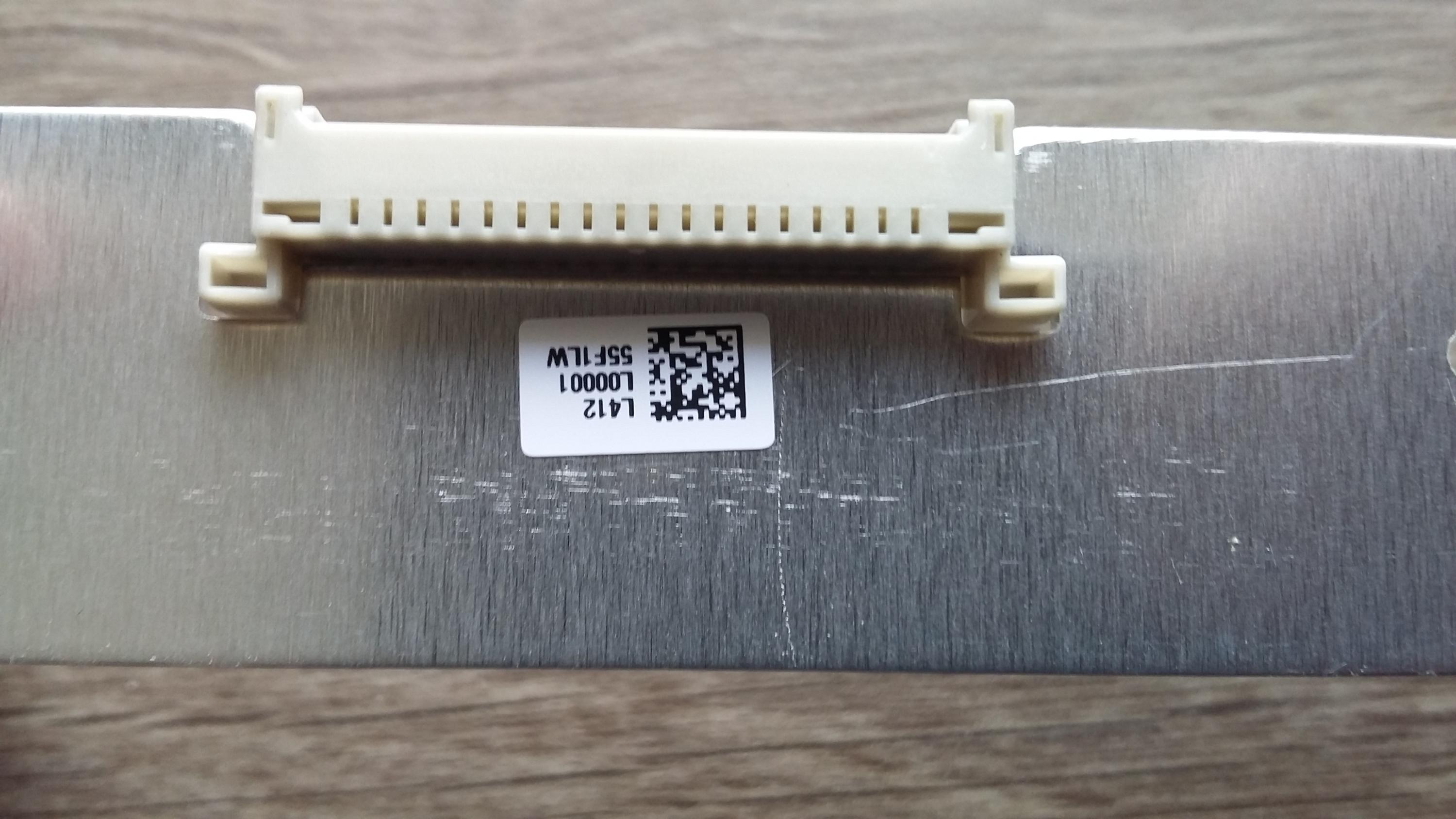

                              Can you get a number off of it, we'll see if we can hunt one down.
