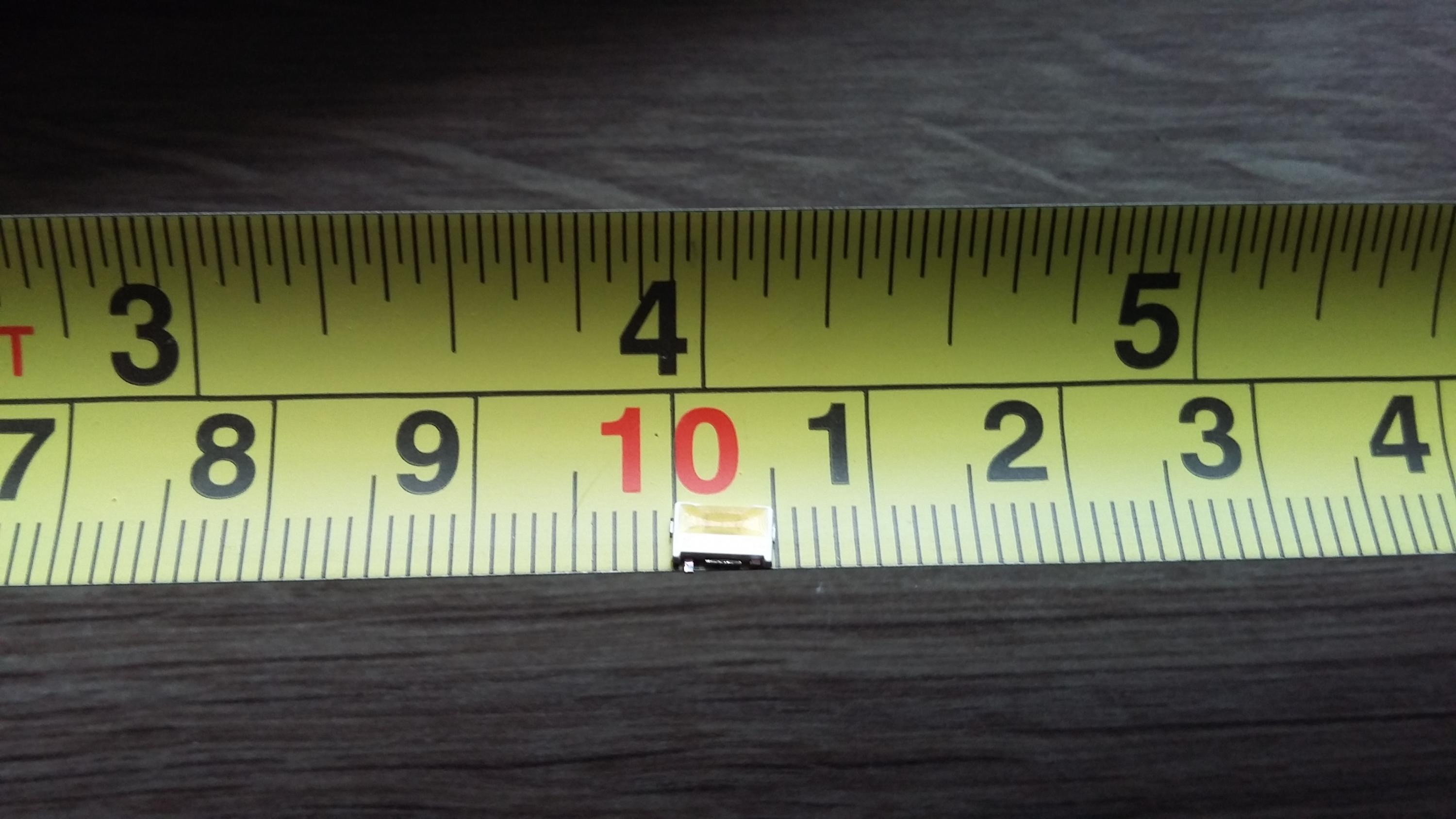

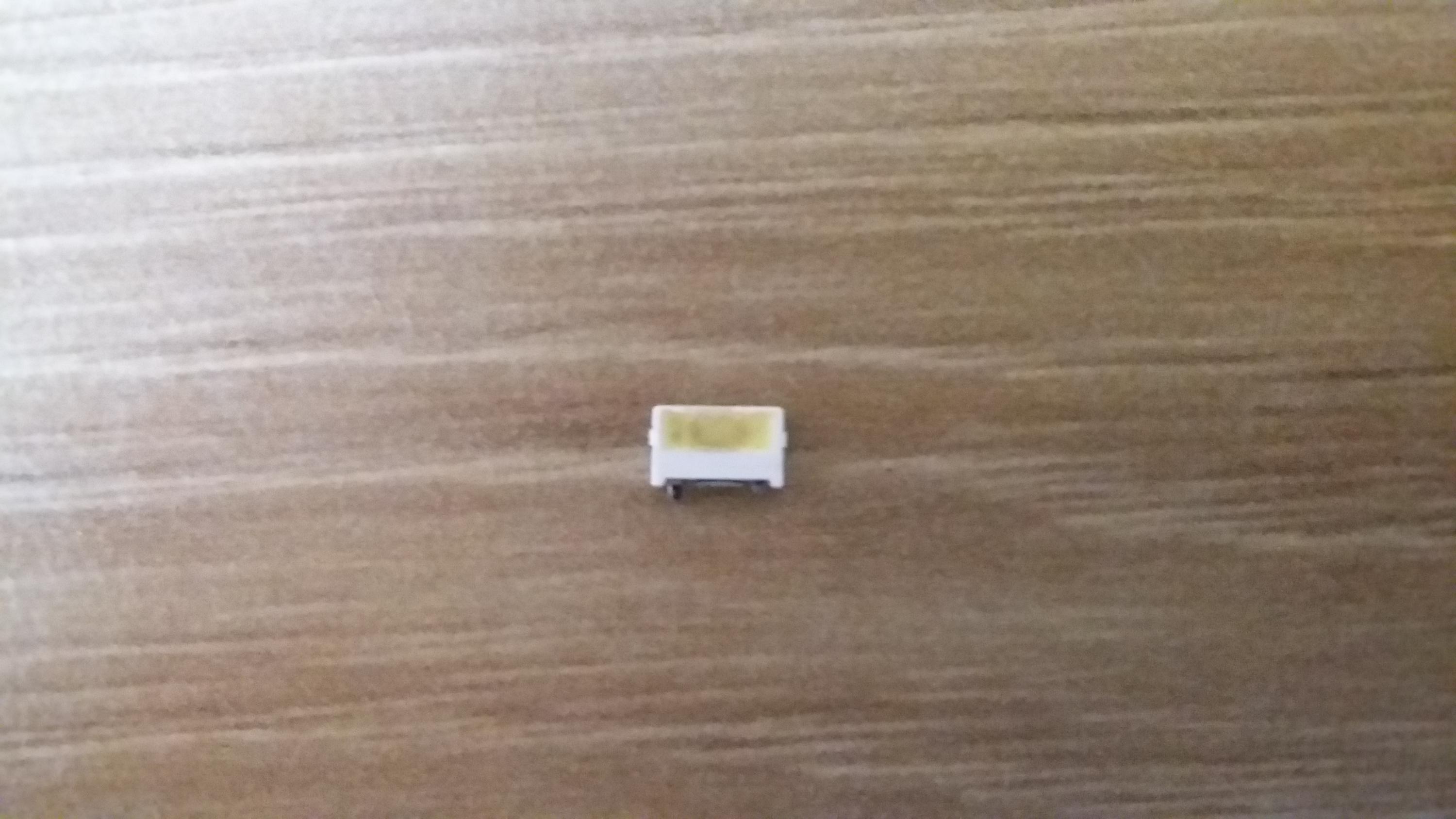

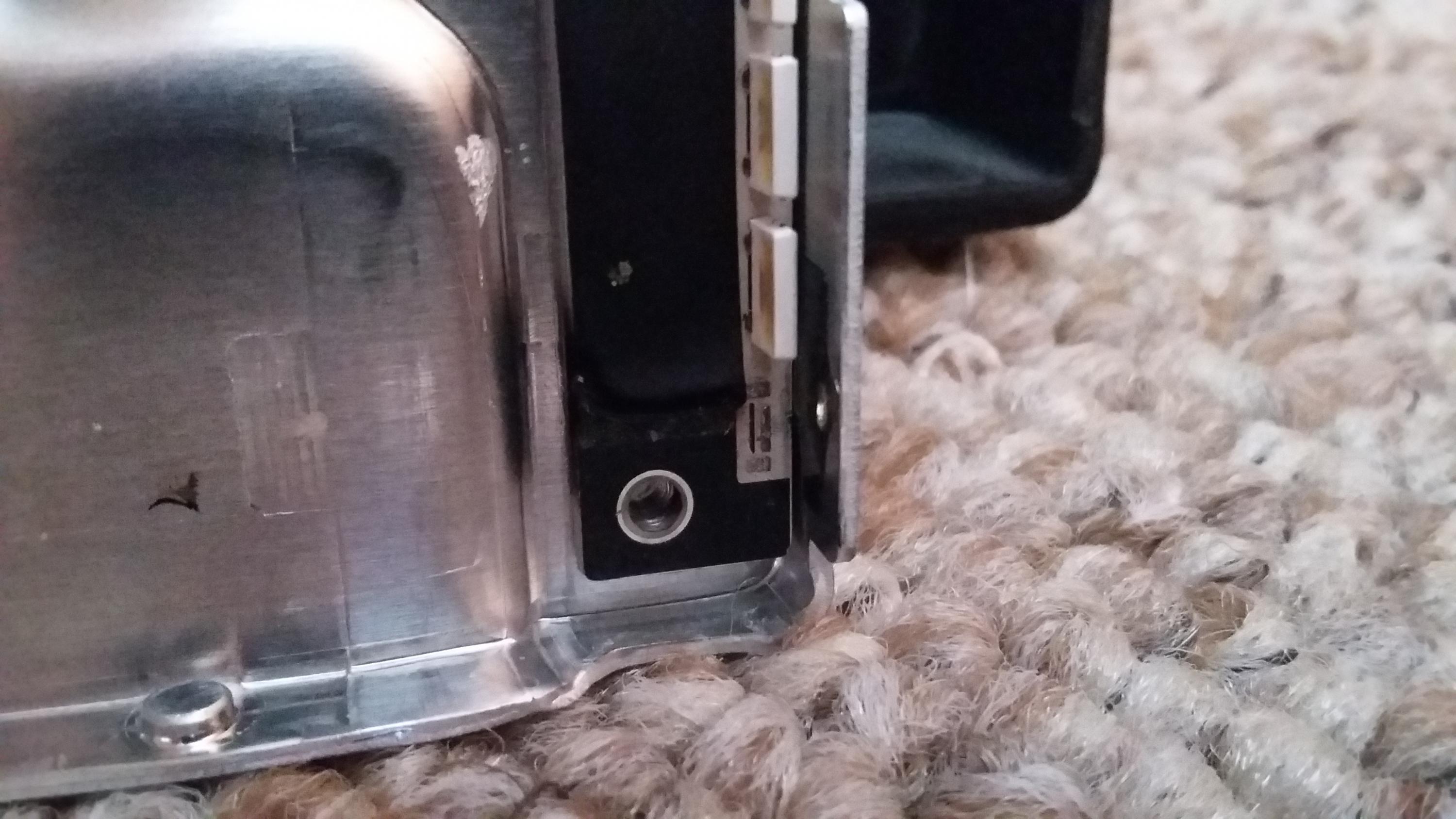

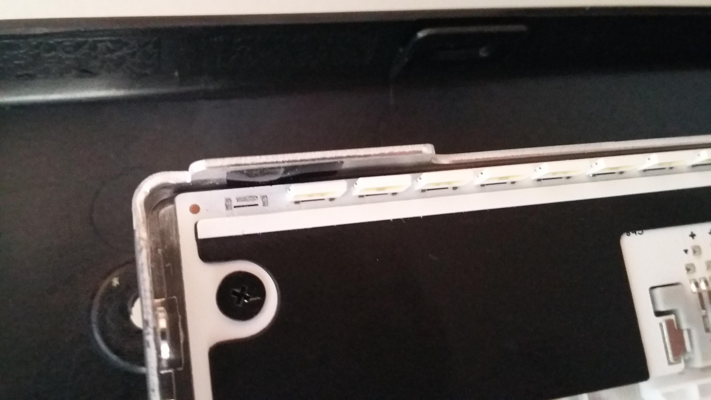

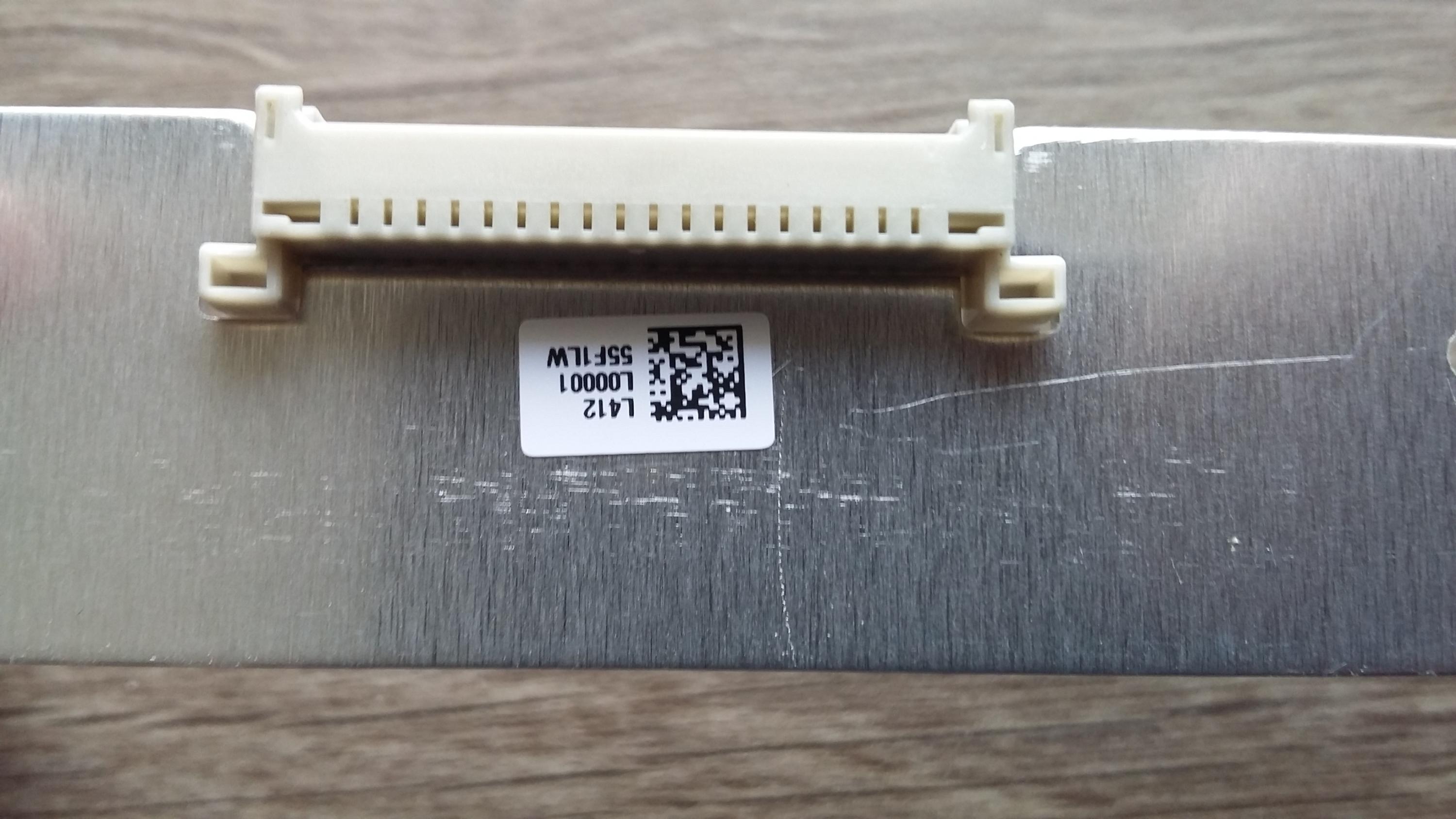

                                #55
                                Re: UE55D8000 Power Cycling On Off Issue
                                Update, I have looked at the led strips and when the cable is removed from power supply to main board there is indeed voltage present at the led strips. Could it be that the 2 broken off leds are causing a break in the loop?

                                  #56
                                  Yes, those missing LEDs will cause issues.

                                        #59
                                        Here is the images of the leds where two have broken off and the size etc. Thanks
                                        • diif
                                          • Feb 2014
                                          • 6978
                                          • England
                                          #60
                                          They look like 5030 package, so suitable sized replacements are available. They are 3v.
