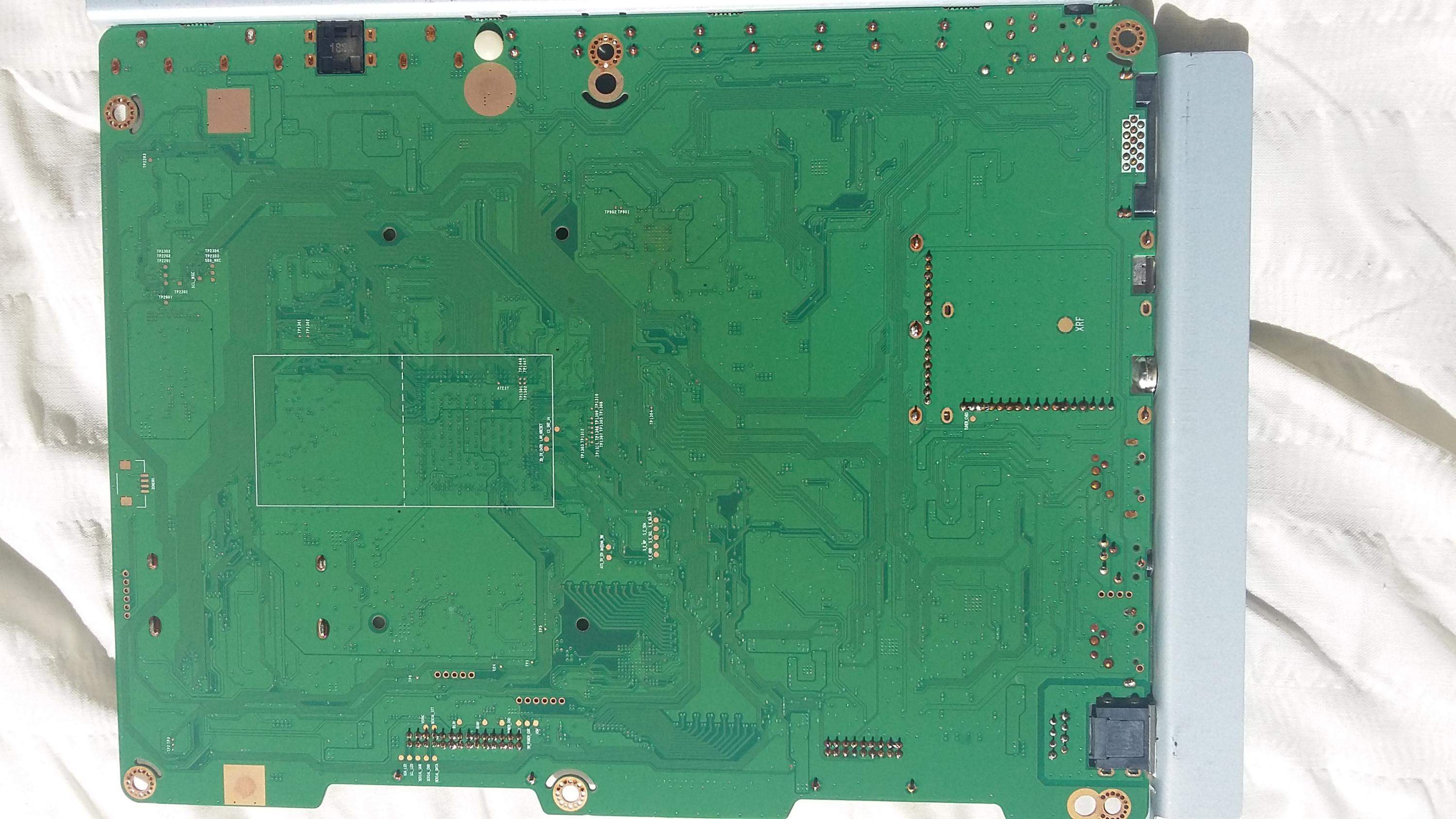

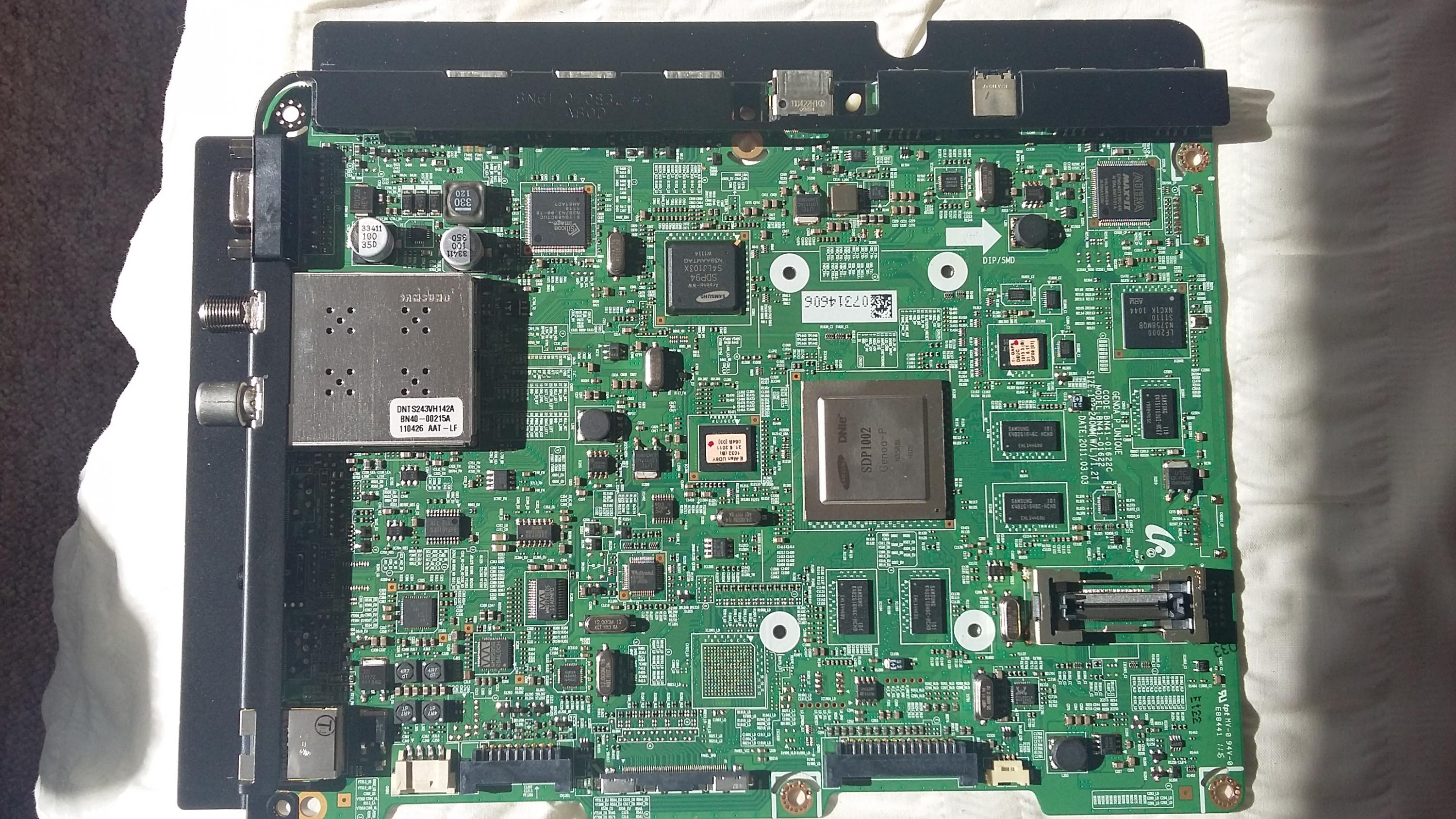

        Re: UE55D8000 Power Cycling On Off Issue

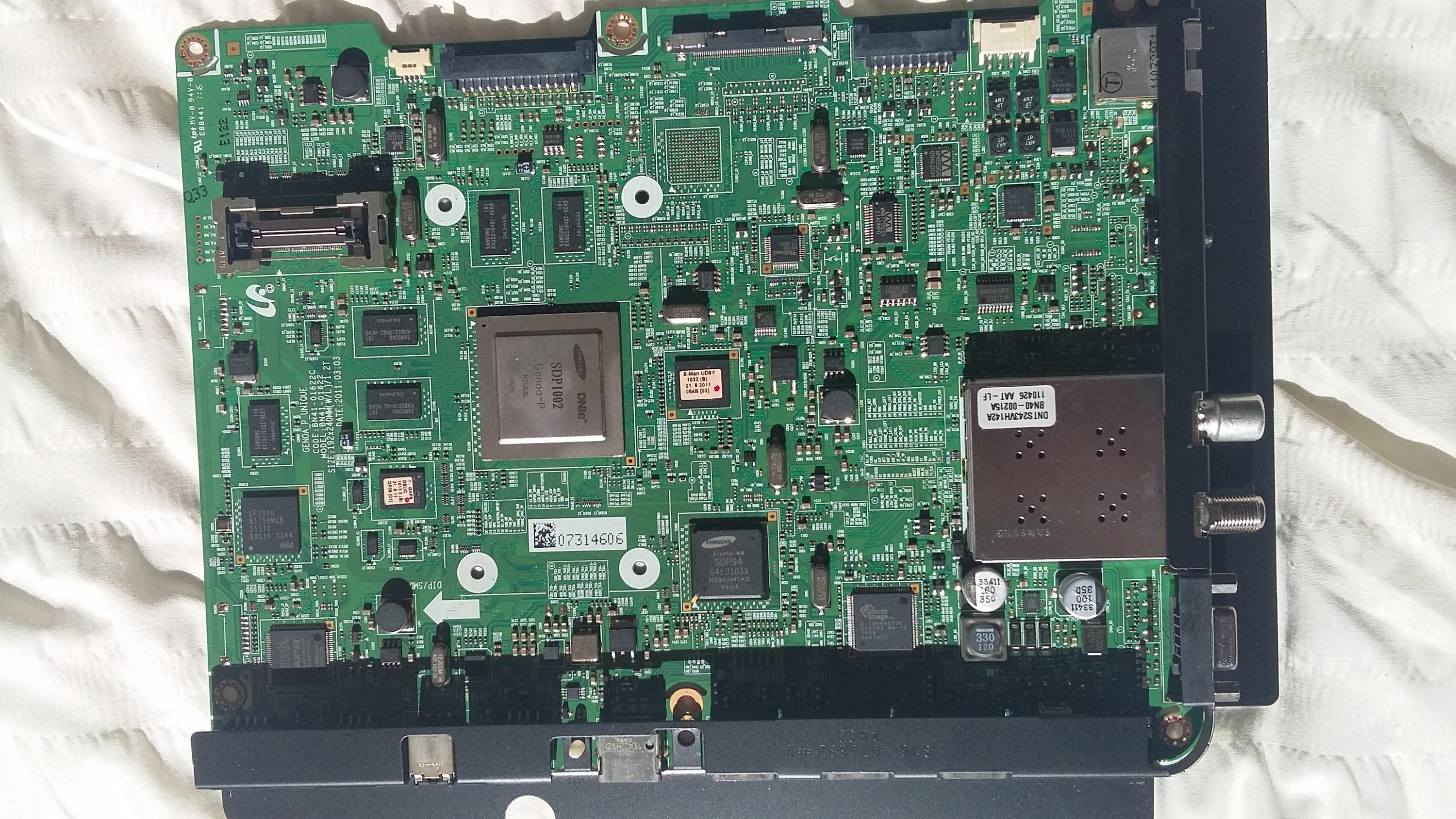

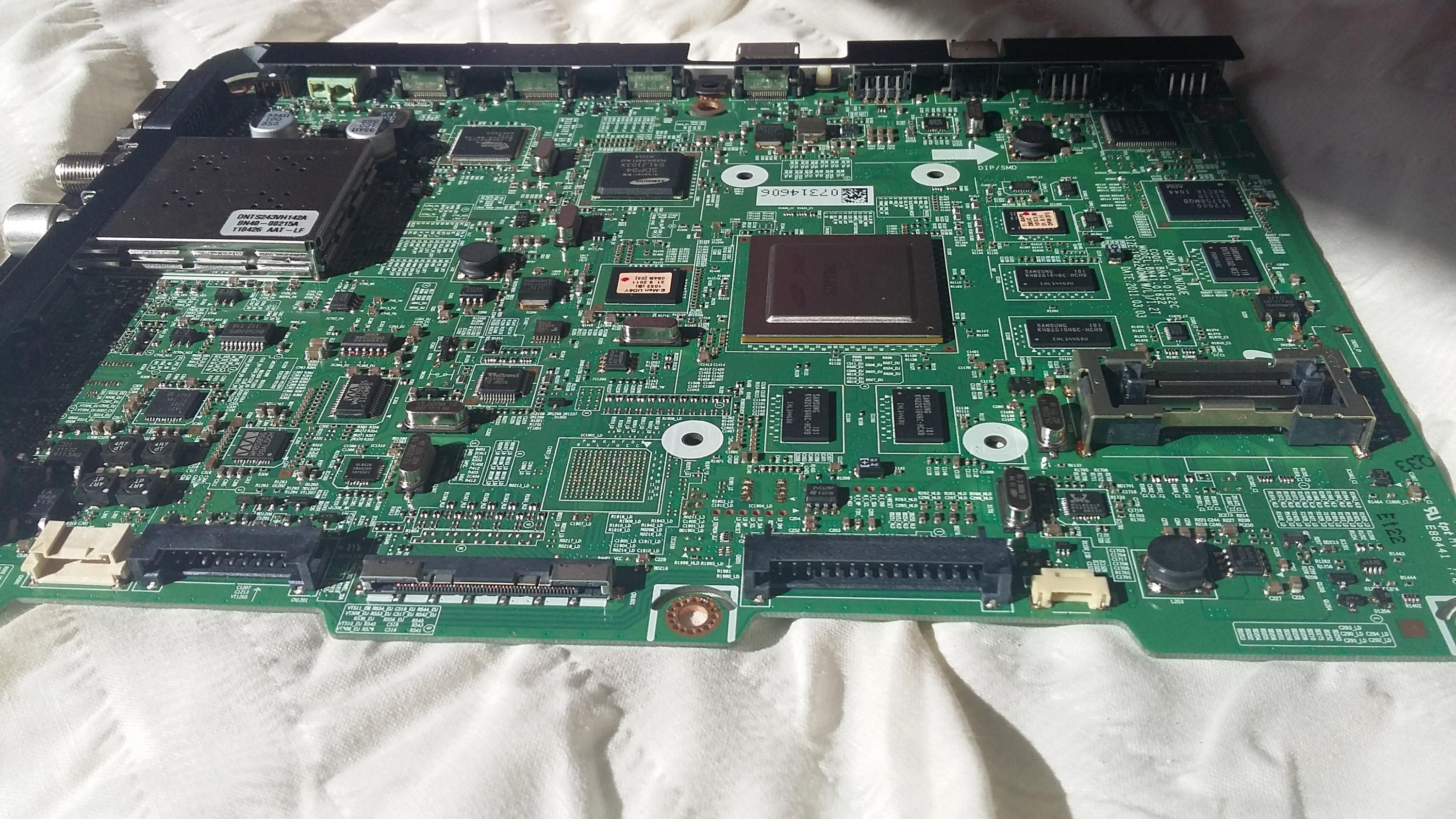

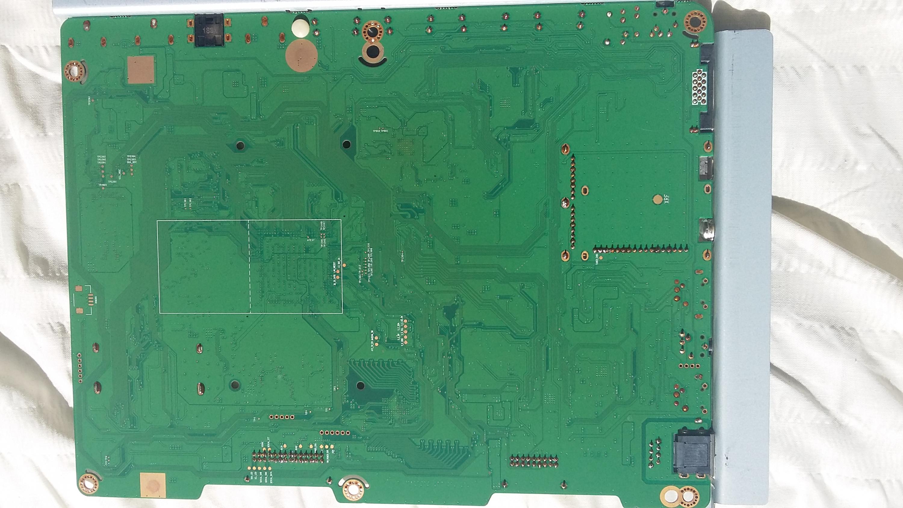

        Can you post really good detailed pictures of the top and back of the mainboard?

            • mrdiy88
              • Nov 2017
              • 59
              • United Kingdom
              Here is the images of the main board hopefully all clear enough

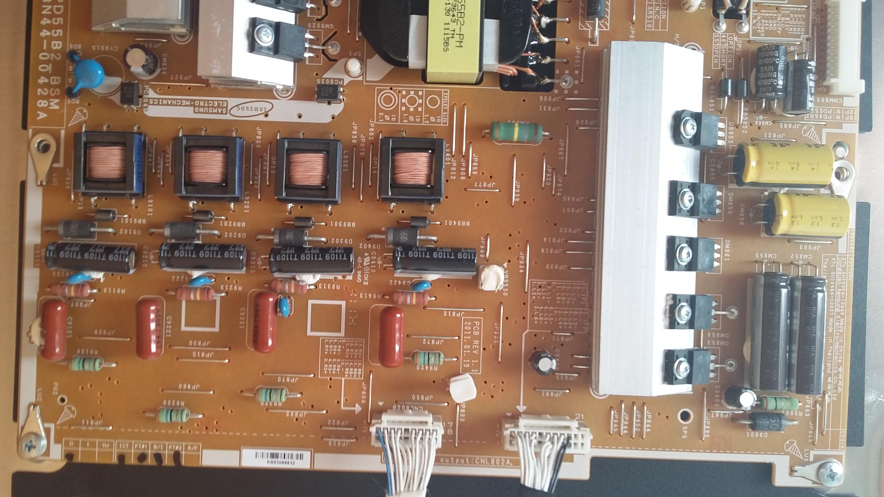

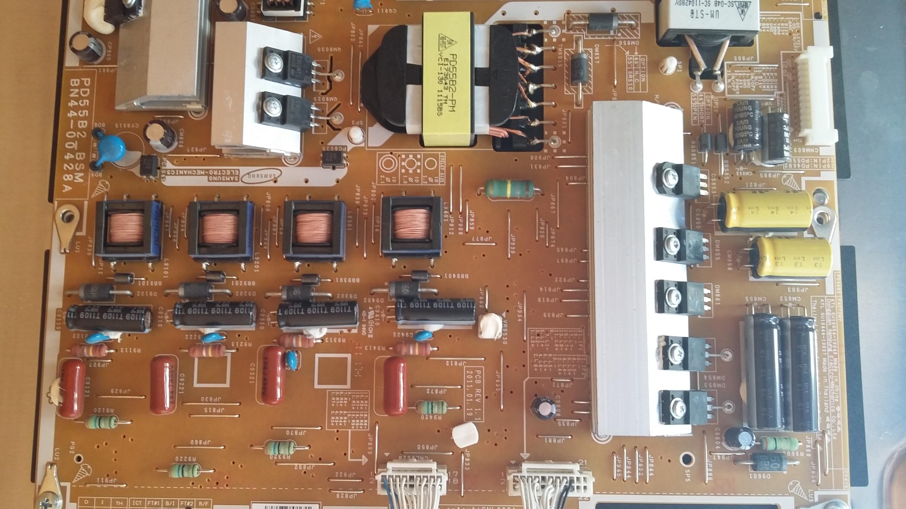

                How bout some good clear pics. of power supply board, just the top should be good for now, just for testing.

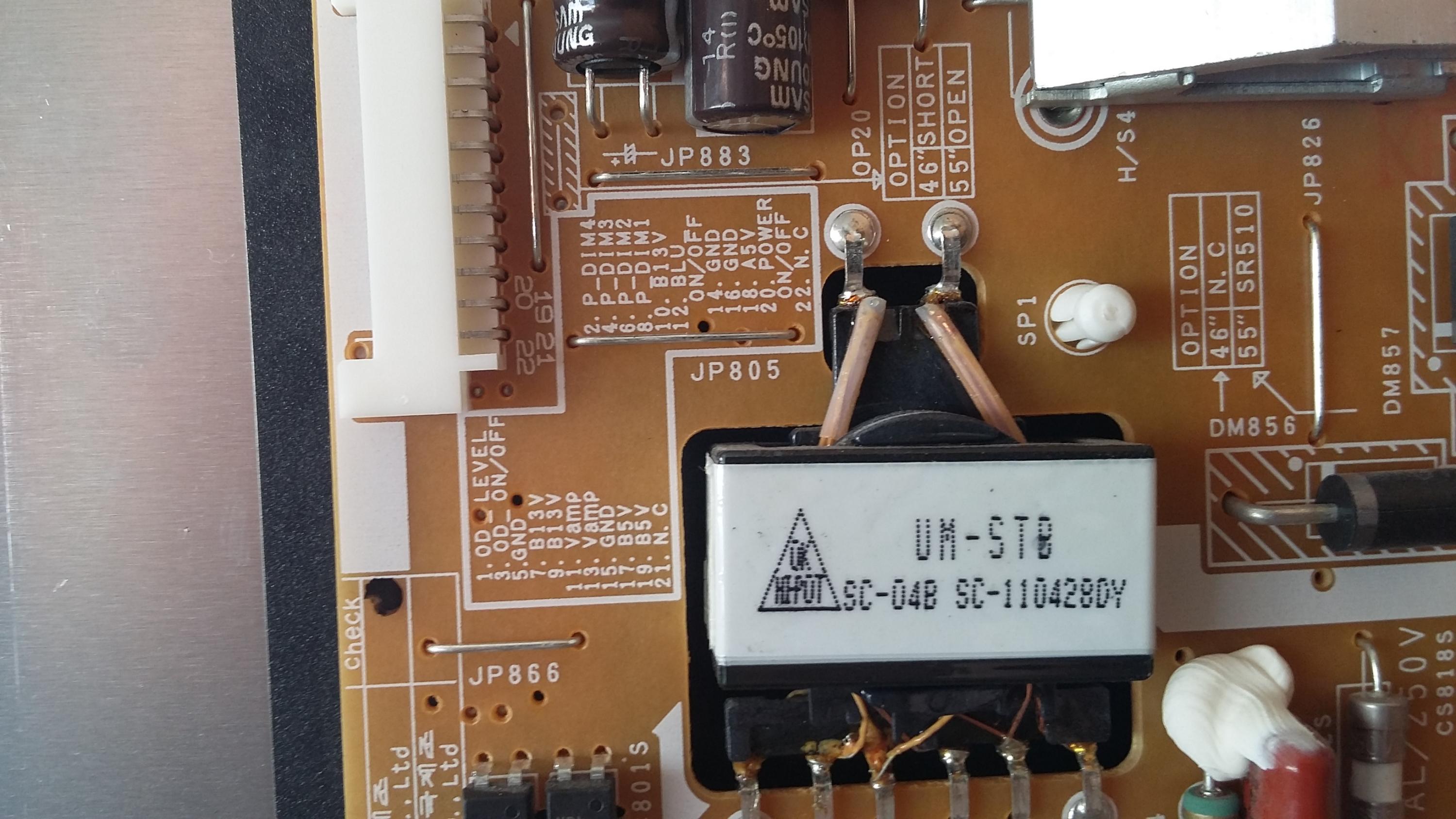

                  See if you can get a good picture of the little legend/map with the expected voltages also.

                    • mrdiy88
                      • Nov 2017
                      • 59
                      • United Kingdom
                      Here is the Power supply images and the legend. I do indeed have a multi meter. Thanks

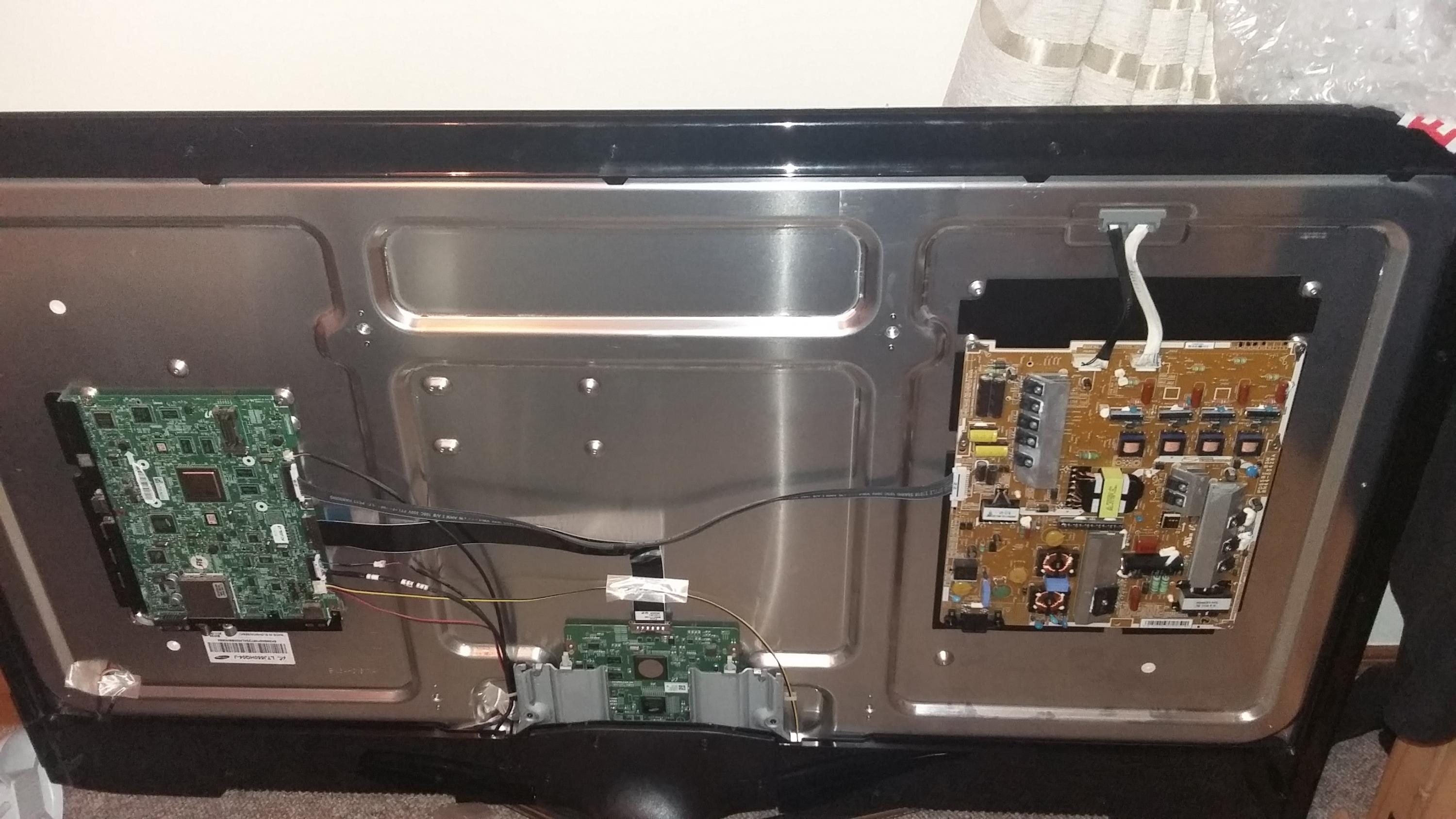

                            Can we at last see the pictures of the whole backside of the TV so we can see how all the boards are connected together?
                            • mrdiy88
                              • Nov 2017
                              • 59
                              • United Kingdom
                              No problem. Here is the image showing the back. Thanks

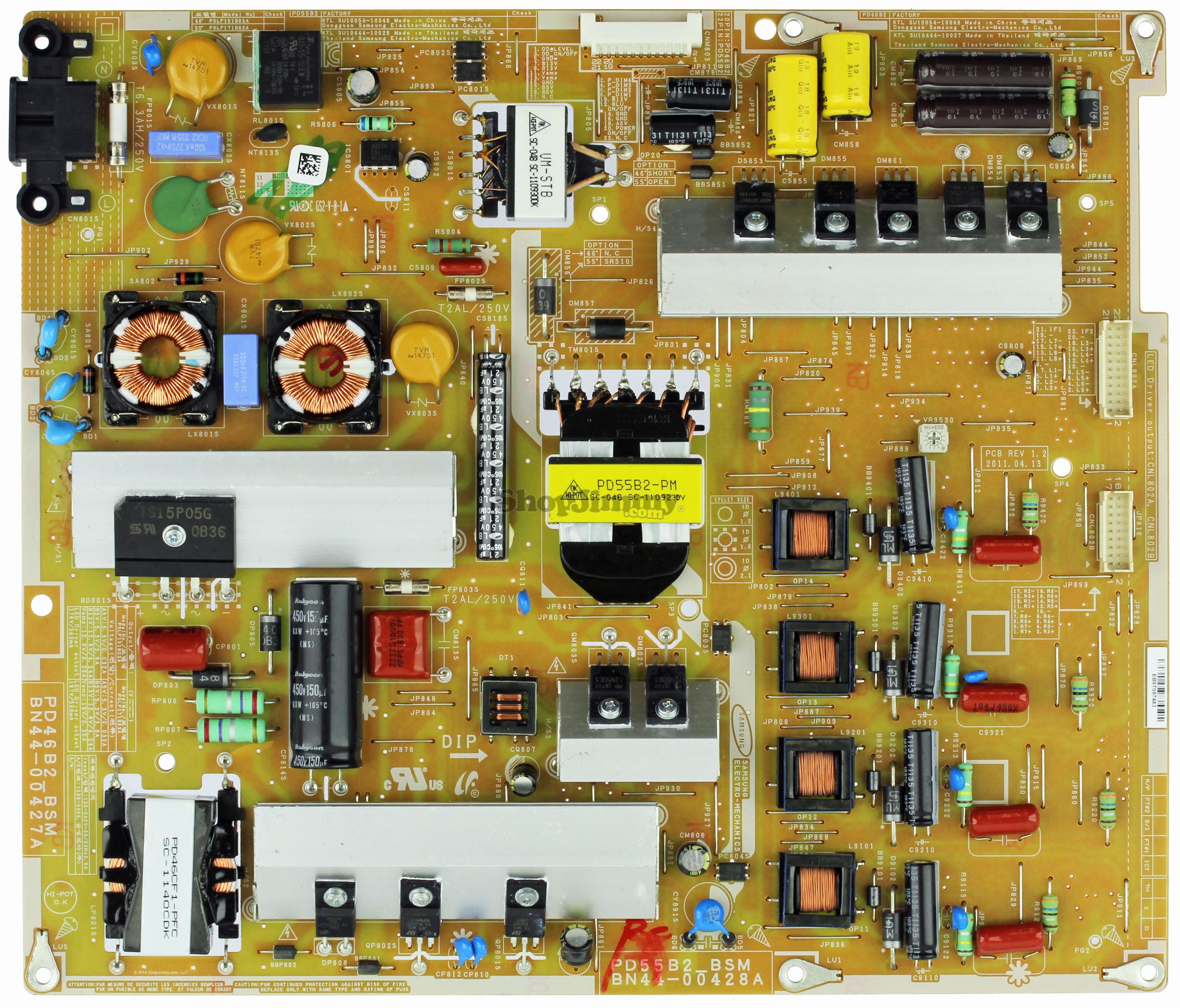

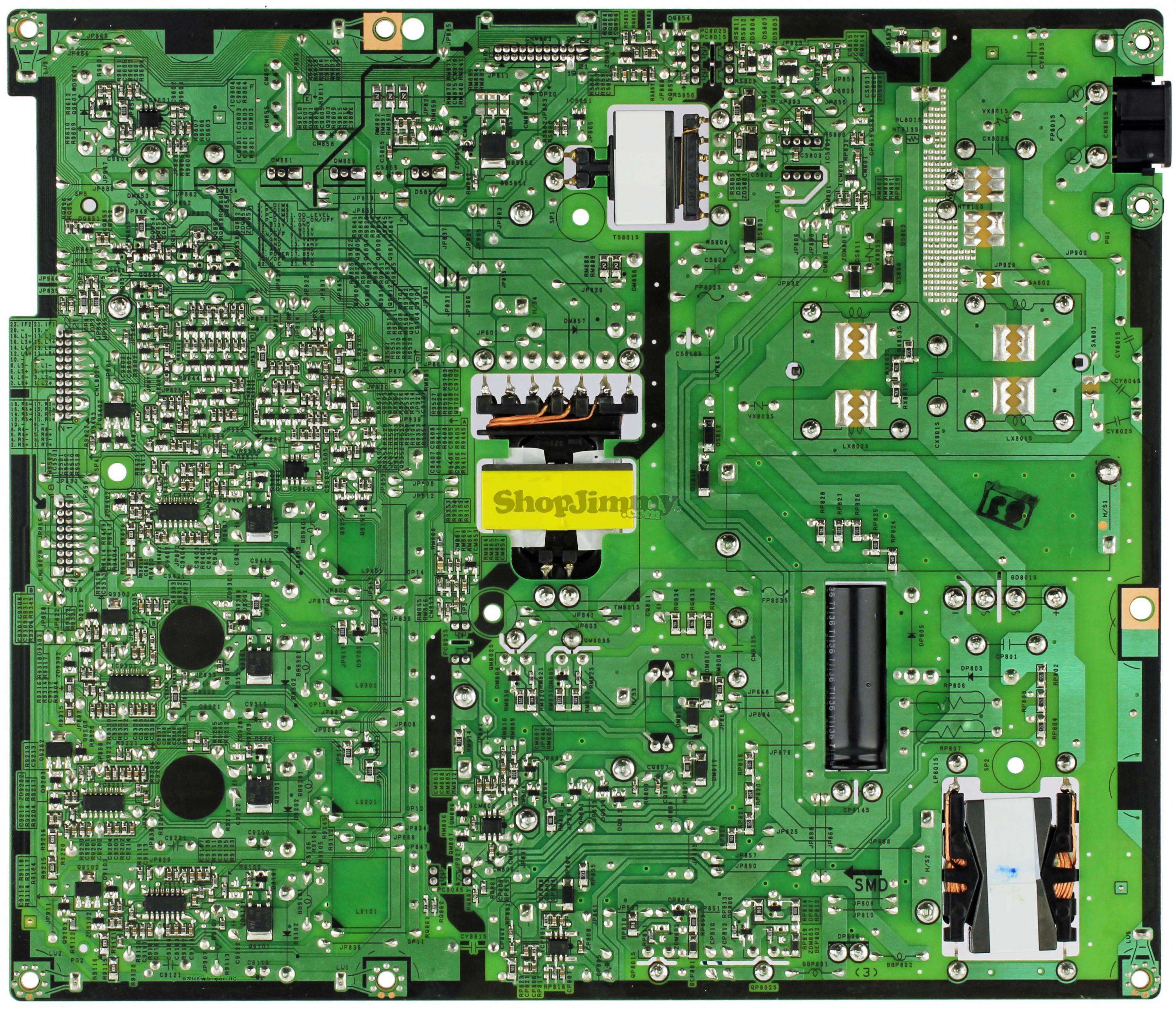

                                Power supply- LED driver board BN44-00428A, same as used in UN55D7000LFXZA.
                                Disconnect the cable between power supply and the main board then plug the AC plug into the outlet and see if the backlights will come on and stay on or flash on for seconds.
                                Pictures provided by shopjimmy.
