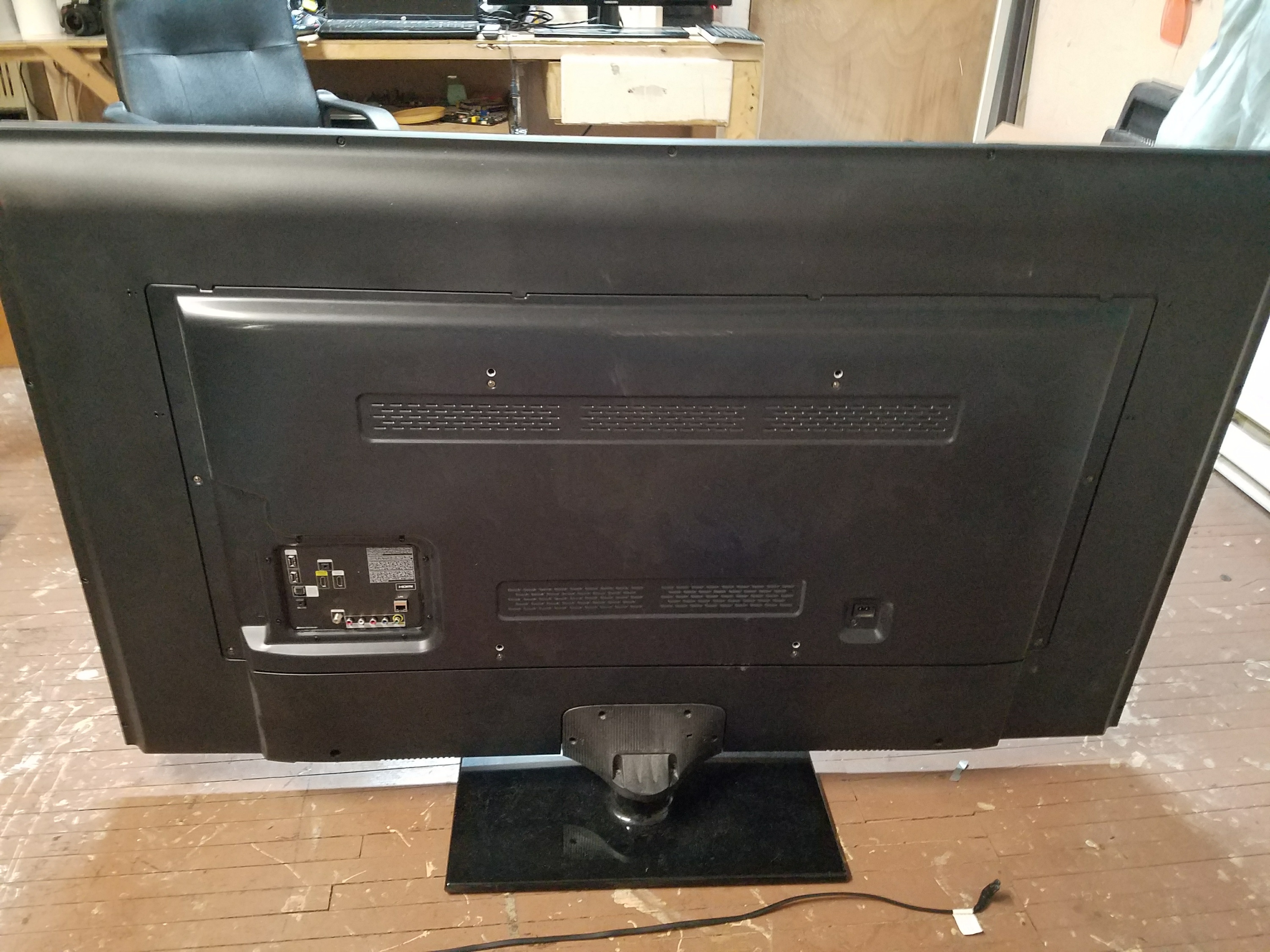

    I'm attempting to convert a Samsung UN65FH6001AF to a UN65H6203AF. They both use the same panel. I need a main board for the UN65H6203, but it's about $60. I can find one for the UN60H6203 for only $10. It has the same board numbers, and appears identical. I suspect its nothing more than firmware which differs on them. I can find firmware on the Samsung website for the 65" and I'm thinking I should be able to use a hex editor to change some value and make it think it's for the 60". I did something similar when upgrading firmware on a laptop once. Alternatively, it may be as simple as just entering the service menu and changing the model. I have programmers, but is it as simple as just flashing the downloaded file? Has anyone done something similar or have any suggestions?

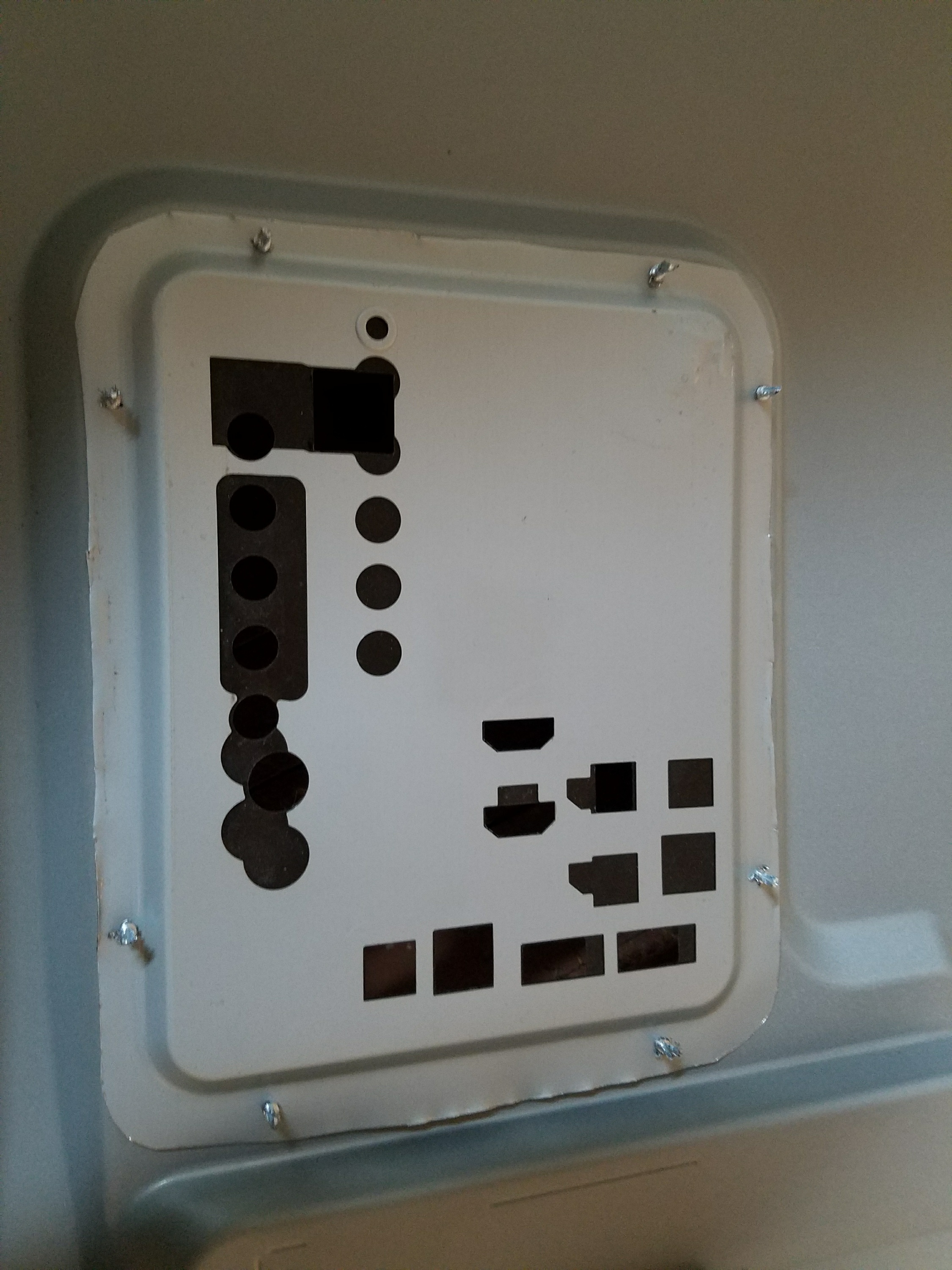

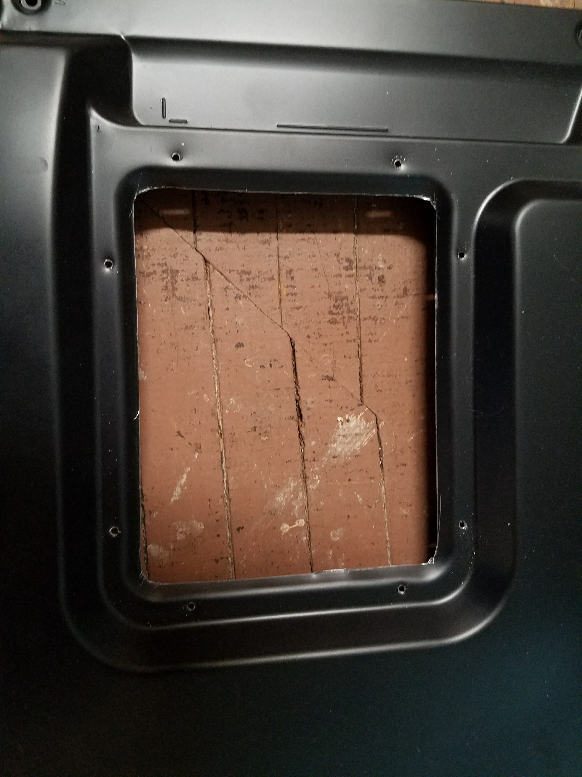

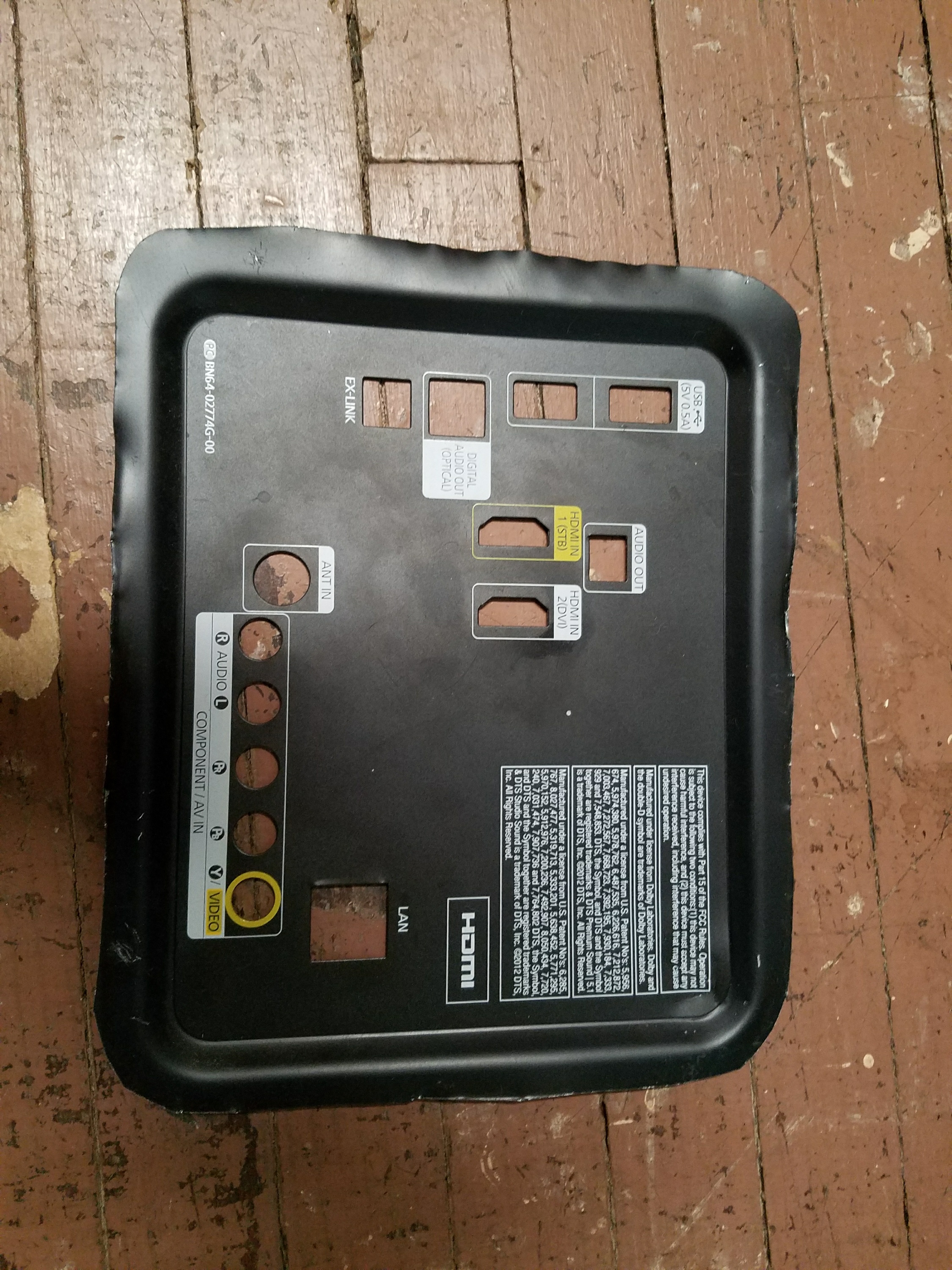

      I knew I couldn't be the only one with this idea. I may have to order the wire set since I don't have the wire for the WiFi module unless I can figure out the pinout. I have a back panel from a UN60H6203 and the input area appears to align perfectly in the 65", so my intent is to cut it out and rivit it in place on the 65" back panel. I think I can do it in such a way that it will look as if it came from the factory that way. I'll take and post pictures when I get all the parts and do the mod. I'm going to download the firmware from the 60" and 65" and compare the files, but I already think they are the same. Haven't done this to an LG yet, but I did swap nand chips a few times on the serial specific Sony's. Also did a nand swap on an old Maxim plasma when nobody had the board for the size pdp I was working with. But, that requires you to have a donor board, or a firmware dump and a programmer. If the firmware is downloadable from LG, I'm certain with a hex editor you could disable checking for the specific model, or somehow make it think it is for the model you are forcing it on. I came across a forum once for modded firmware for LG TVs when I was trying to see if a TV with DLNA could be turned into a wired smart TV. Some can, no luck with mine though. I dont remember where that forum was though.

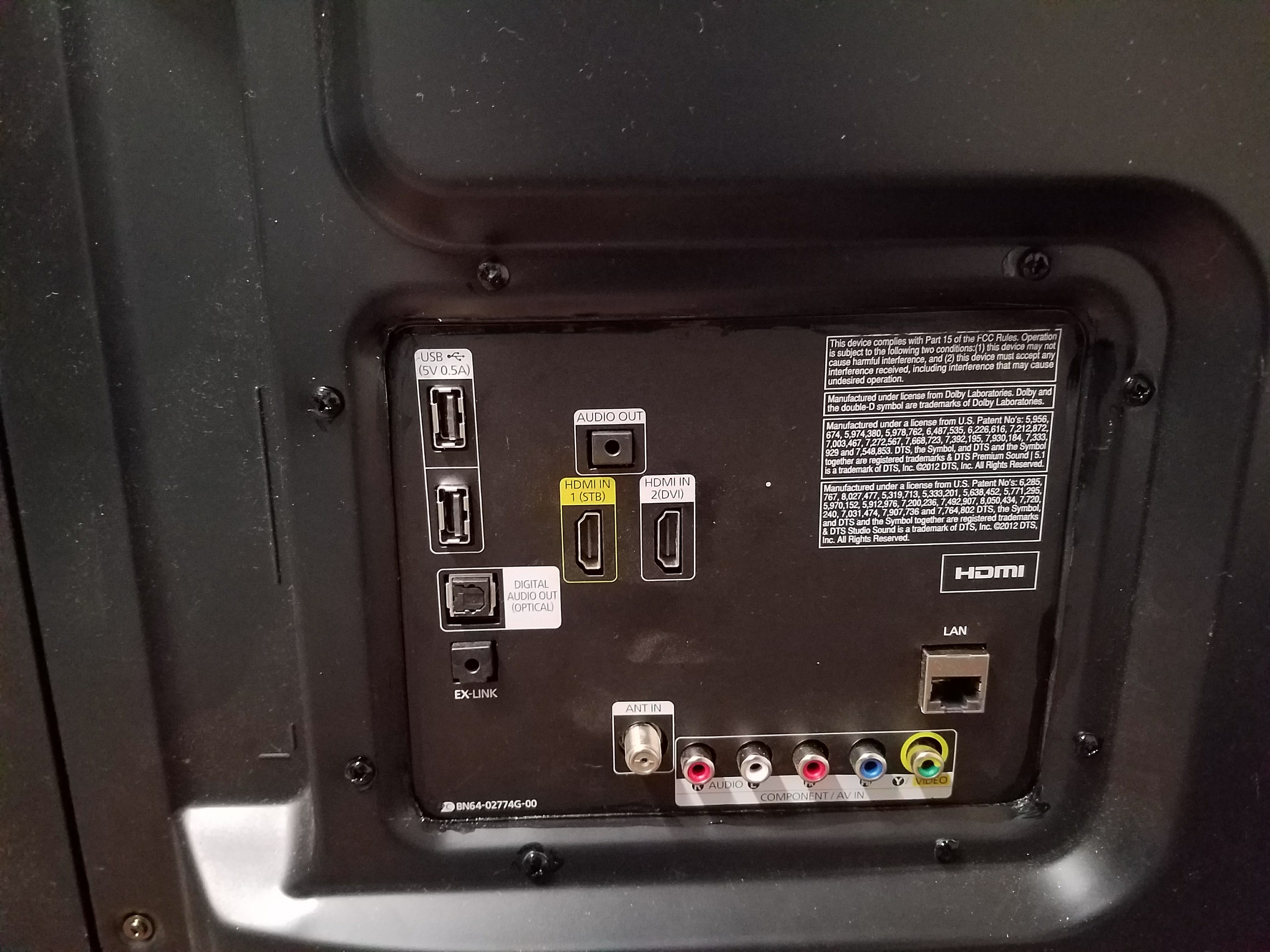

                          I haven't worked on this yet, still working on rearranging the shop so I'll have room to work on TVs this big. I figured I'd post an update with my findings though. The main board came in and fit right in place, there's screw holes to accommodate different boards. The LVDS cable fit perfectly (T-Cons are the same for smart and non-smart version). Power supply is different, as is the wire harness. Maybe I could have made it work if I could have figured out the pinout at the main board, but I found a power supply for the smart version and it included the wire harness. Cost me $60. Also ordered the harness for the WiFi/IR sensor for $10. So, I'm at $189 total, including $80 invested in upgrades, $9 for a remote, and the $100 I paid for the TV. The power supply from the non-smart version sells on eBay for $80-100, and the main board for $84. If I can sell them on eBay, maybe I can come out close to even. Also, I discovered that the back cover from the UN60H6203 is identical in size and shape to the cover from the UN60FH6100. The only difference is the holes for the inputs. Unfortunately for me, it was near the bottom of my scrap pile and it's not in good shape, so I'll still be doing some sheet metal work.

                            Finally got back to this. Main board ended up being from a UN60J6200 and worked without any problems. I did go into the service menu and change the panel from a 60" one to a 65" one, but it worked fine either way. Unfortunately, I'm going to have to open it up again because the bottom half is dimmer than the top. I replaced 39 bad LEDs and then all the strips lit, but I guess I should have checked to see that they were all drawing the same current. As far as modifying the back panel, I think it turned out pretty good. Of course, as luck would have it, I picked up a 55" yesterday which also has the exact same back panel. I'll just save that for the next one.
