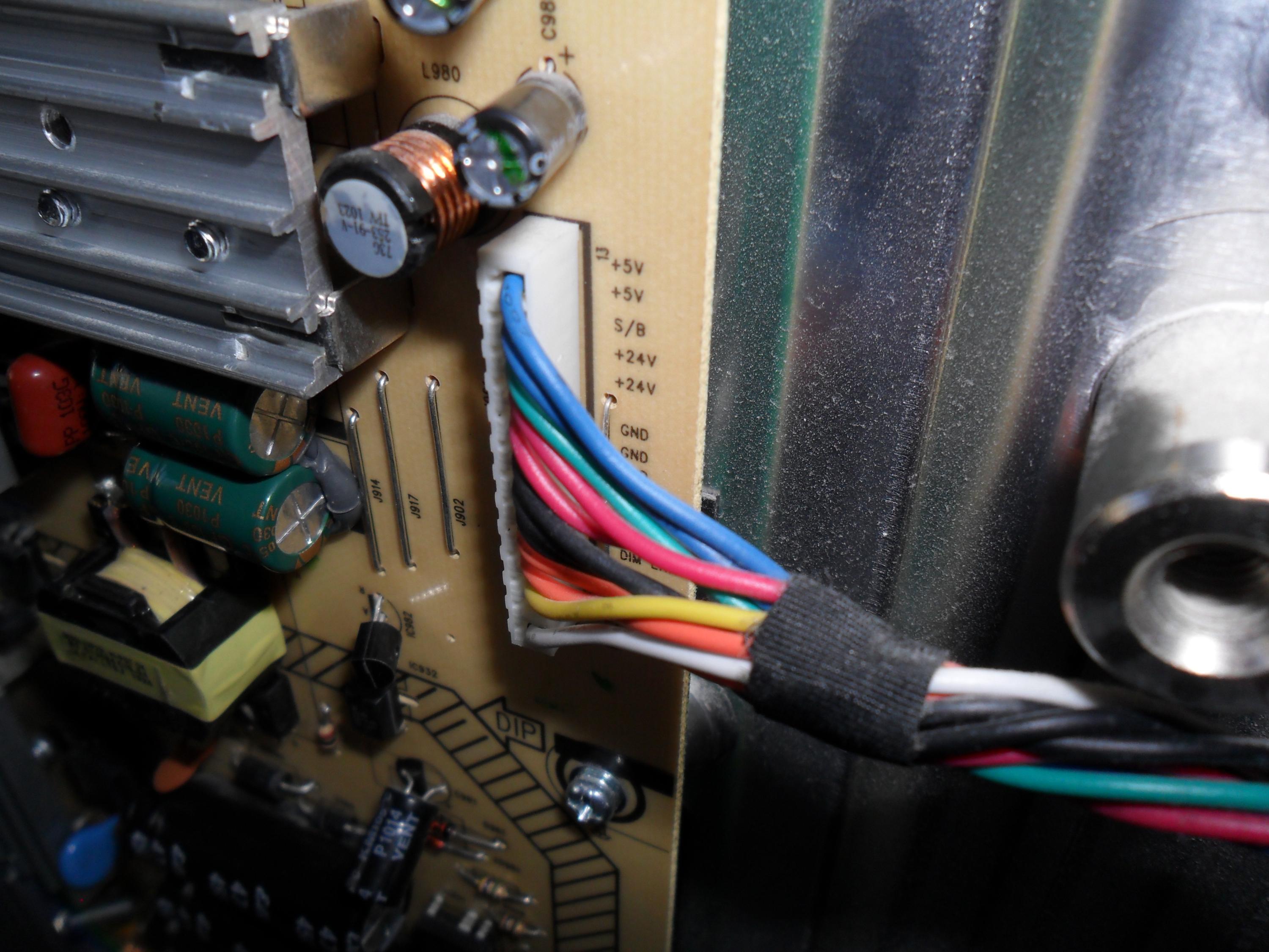

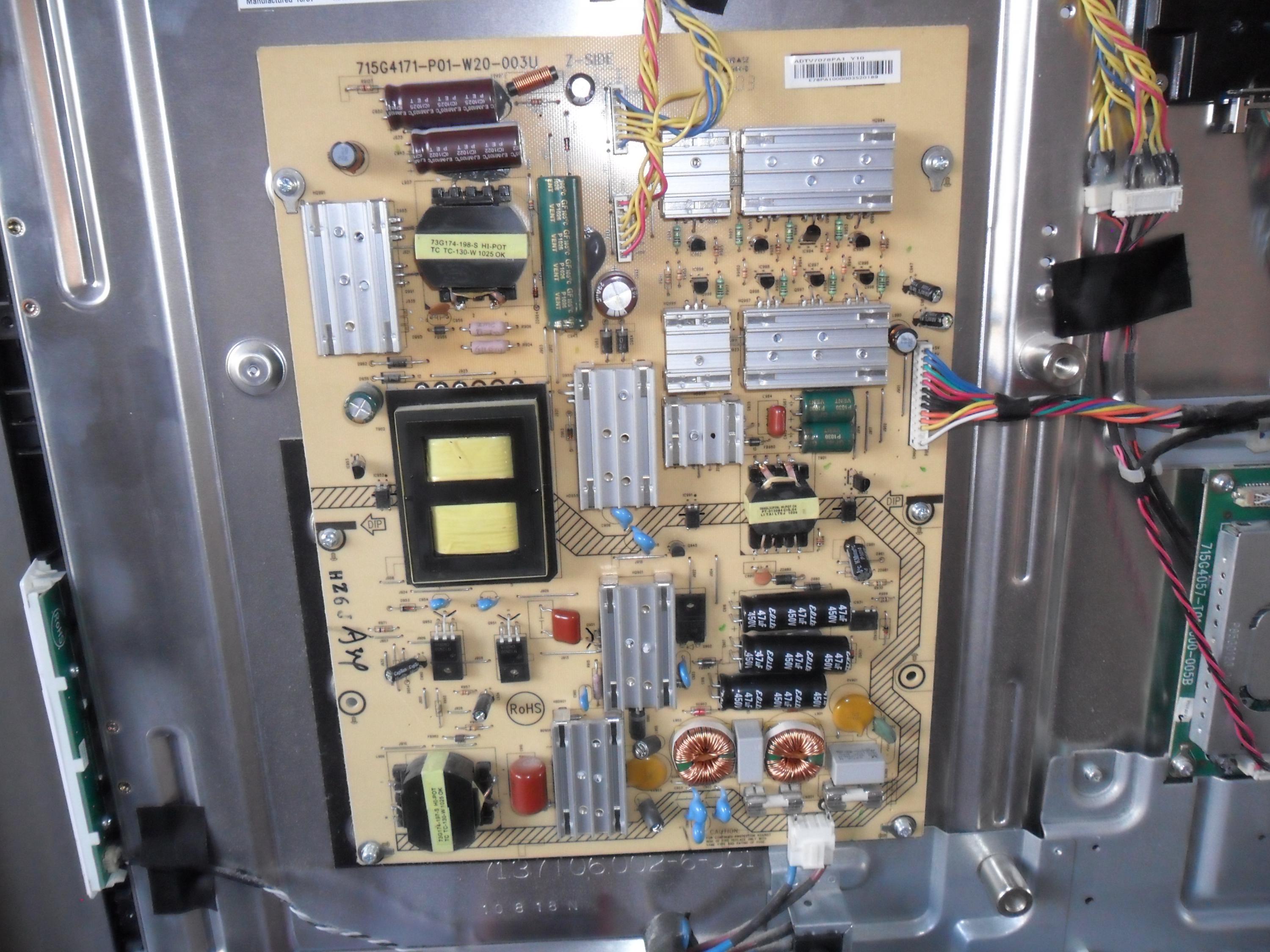

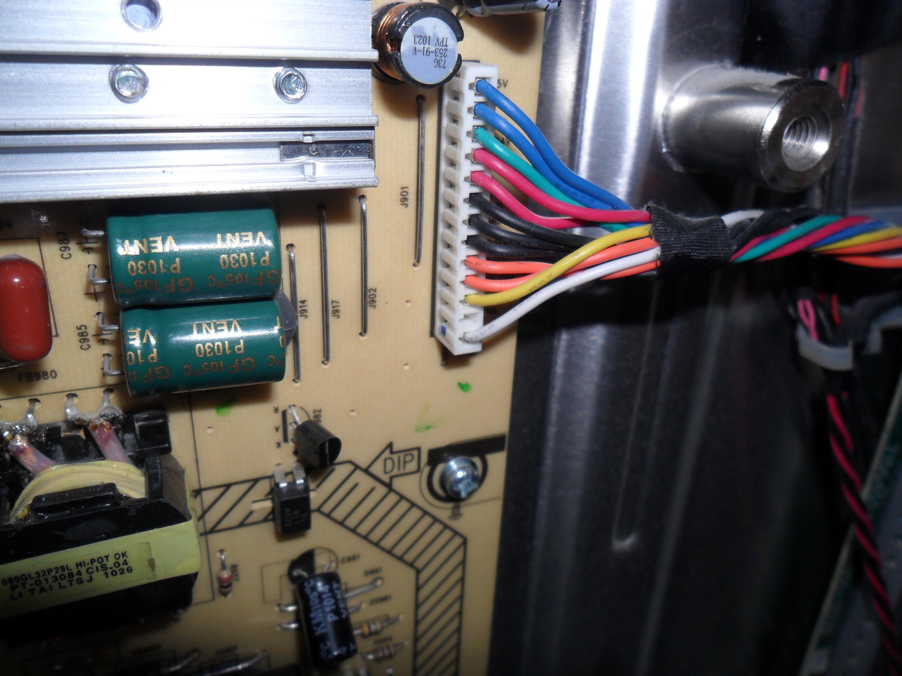

    symptos=plug tv in blue light comes on tv for 2 seconds then goes off tv wont power on.
    checked the voltages on the 5 voltages at the top its reading 7.1 theres nothing from the 24 voltage pins and there 0.38 from the yellow wire near the bottom.not sure where to go from here i was hoping to see a badcap and just replace it.

    You should post this in the TV section.
    https://www.badcaps.net/forum/attach...0&d=1521562008
    There are labels for the pin of that connector, please put down the pin name and follow by the Voltage reading so we can EASILY see what it has for each pin when TV is OFF and when power switch is activated.

      so update put new batterys in my remote and the tv turns on with the remote and all remote functions work but i cant turn the tv on from the side panel.
