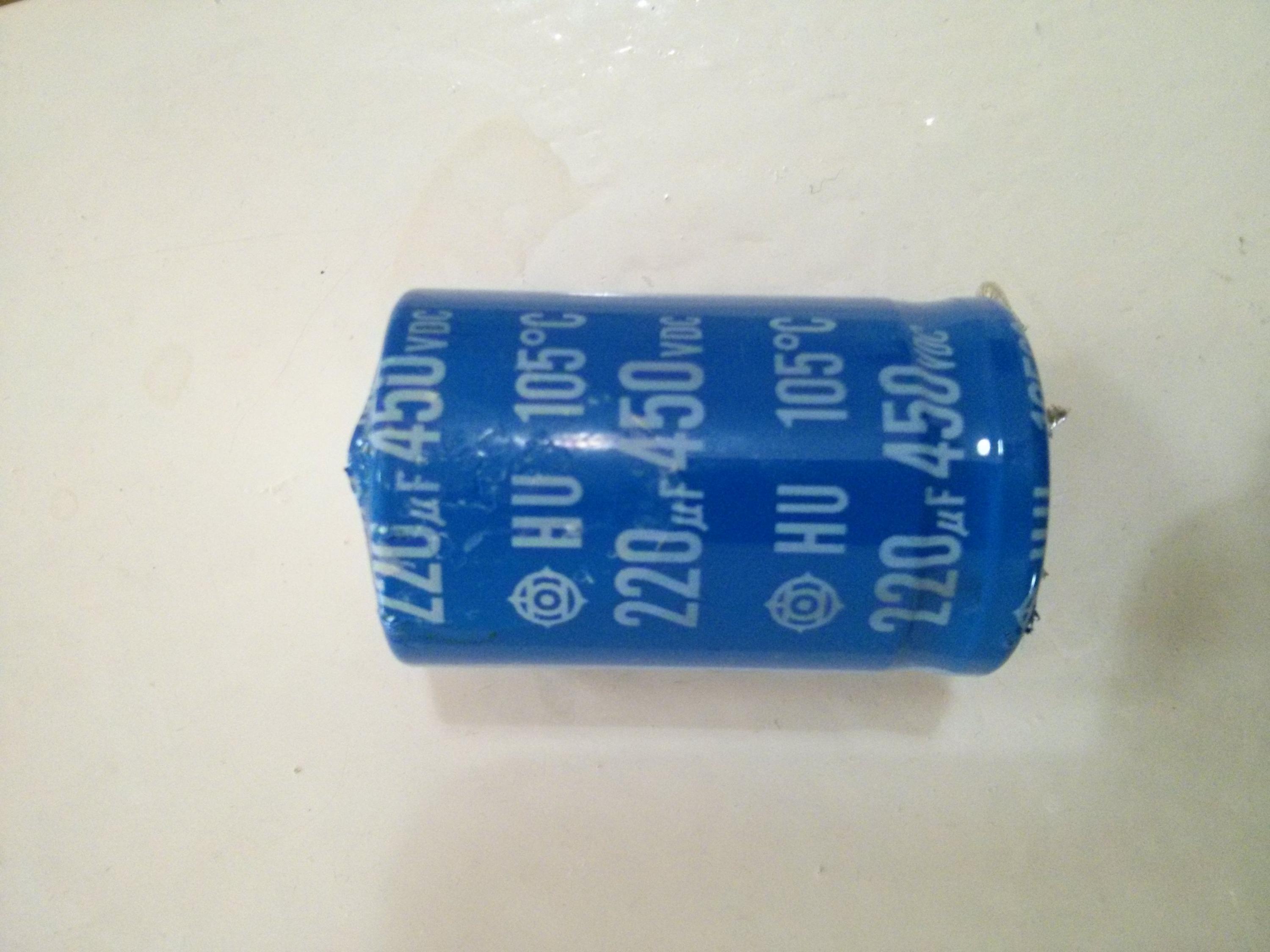

                Re: Capacitor Identification
                Originally posted by divy
                I have take it out 220uf 450vdc
                this cap

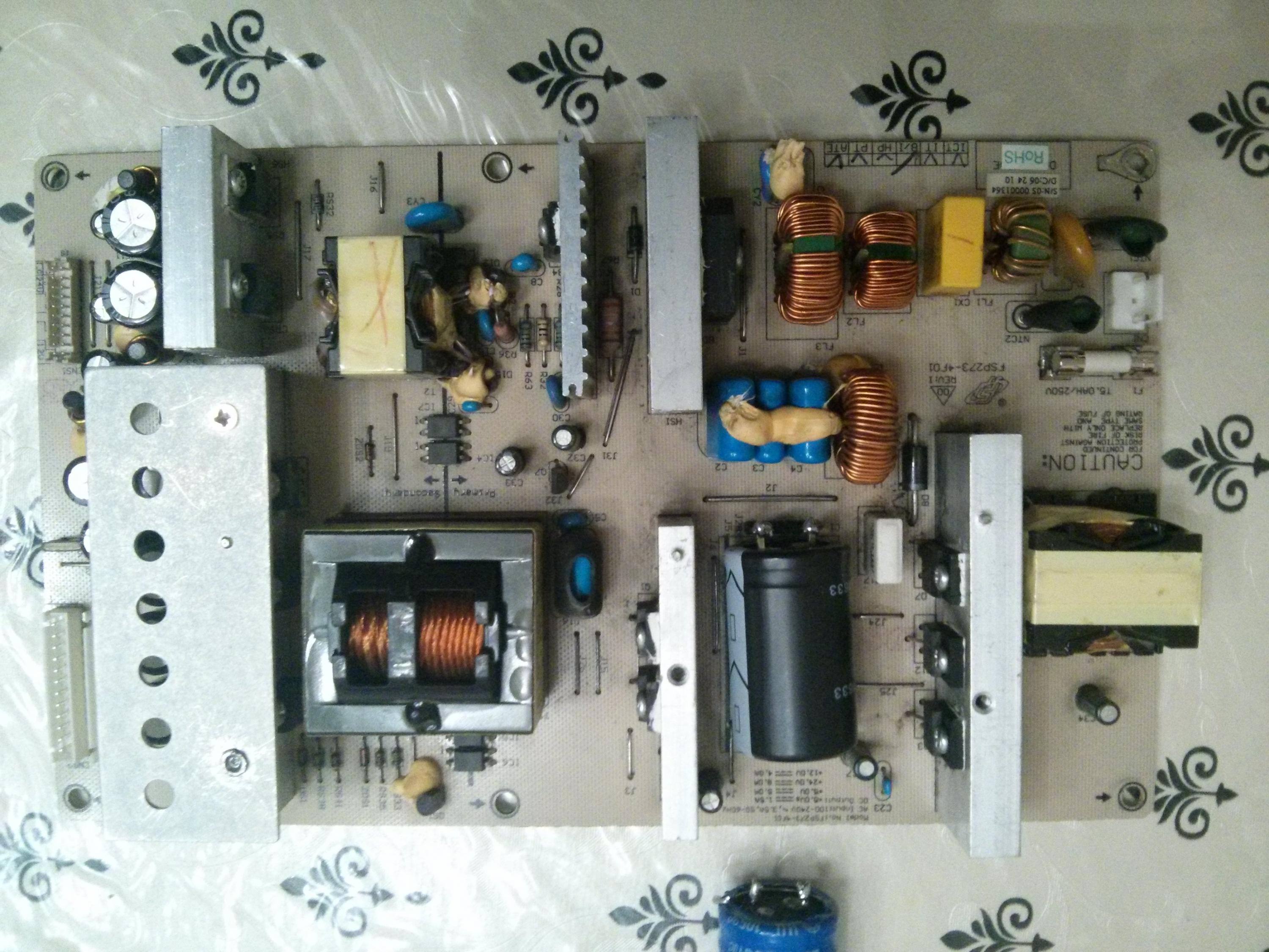

                  Re: Tevion LCD 4040 main capacitor failure
                  I'd agree with Vinceroger69 that you may well have had it in incorrectly. Are there any markings on the capacitor indicating polarity ie is there a "-" or a "+" on the casing? Can't tell from the picture.
                  Can you also post a photo of where it should be soldered in the power supply.

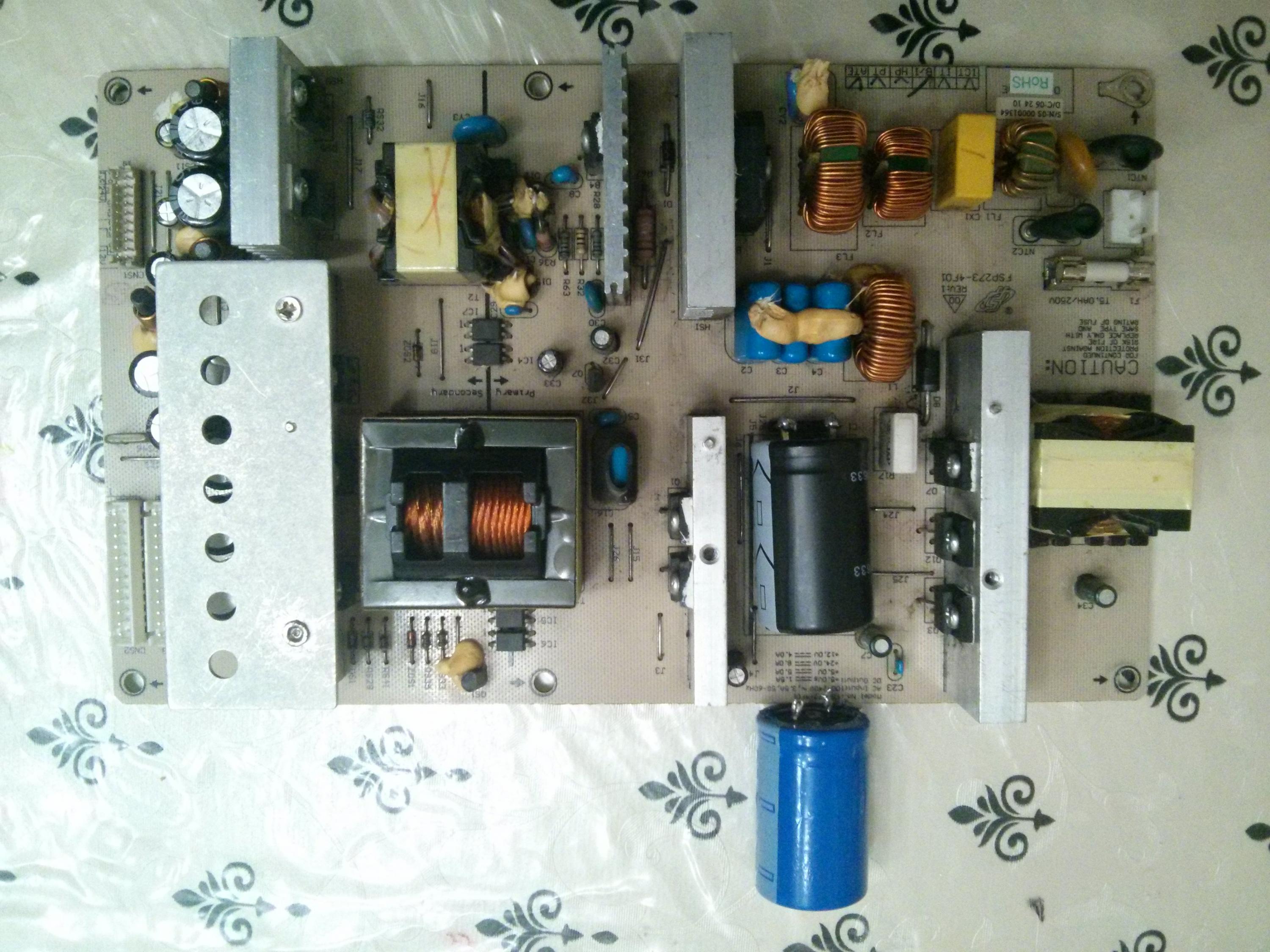

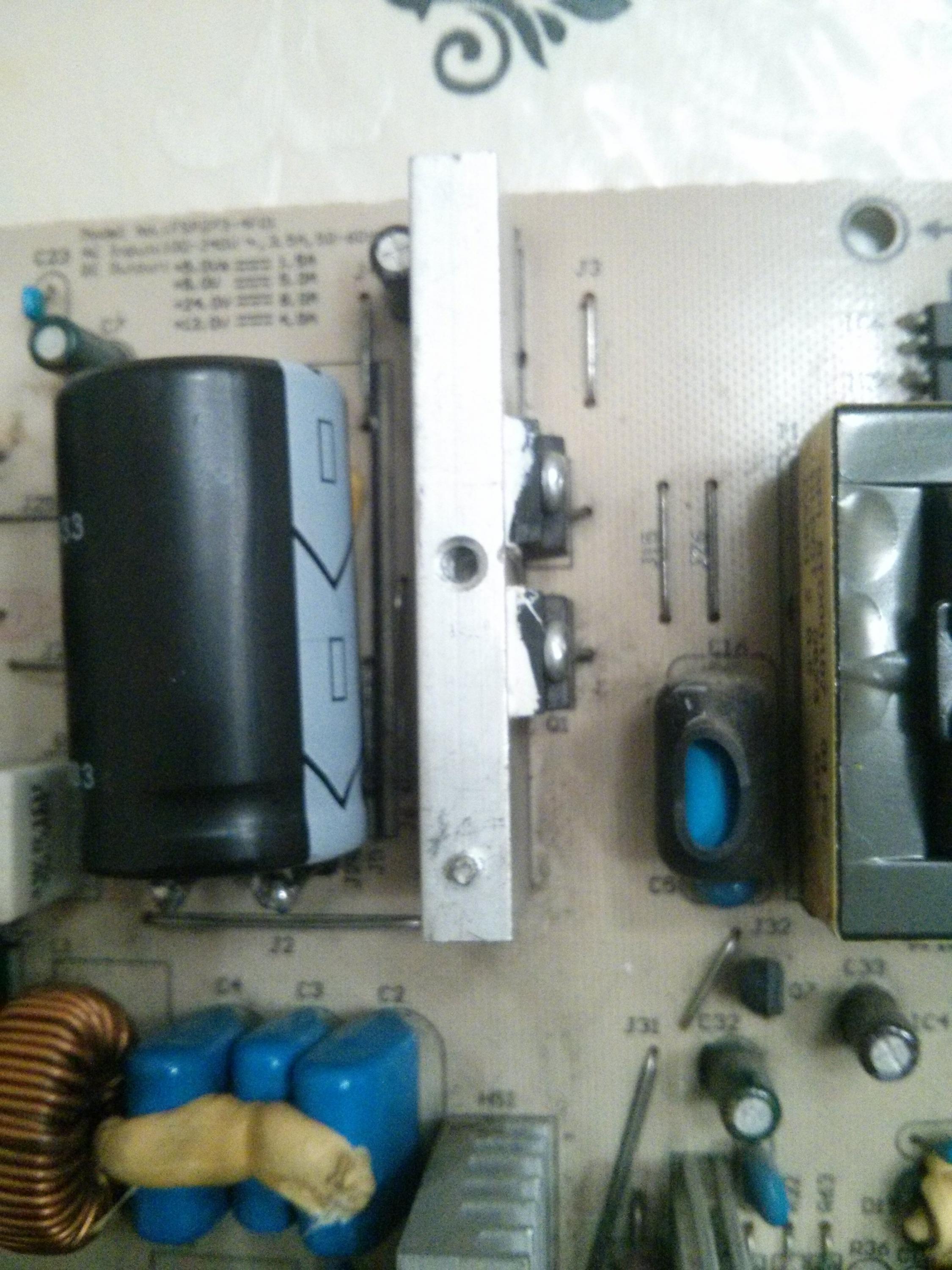

                    Some more pic power supply .I think cap it wrong I have install 220uf 450v
                    • vinceroger69
                      • Mar 2012
                      • 6714
                      • uk
                      in picture 2 if you have installed the capacitor as shown with the negative band on the left it should be ok what was the original fault with this psu? as i have repaired two and never had too change that capacitor start by testing the bridge rectifier then all the devices that are on the heat sinks for shorts.
