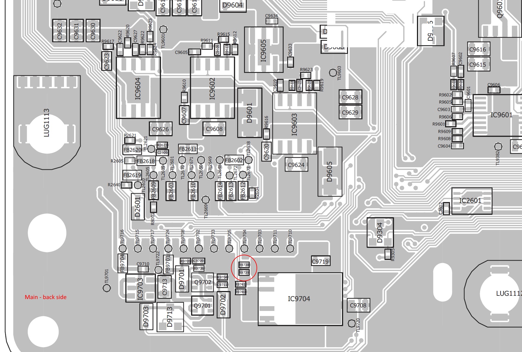

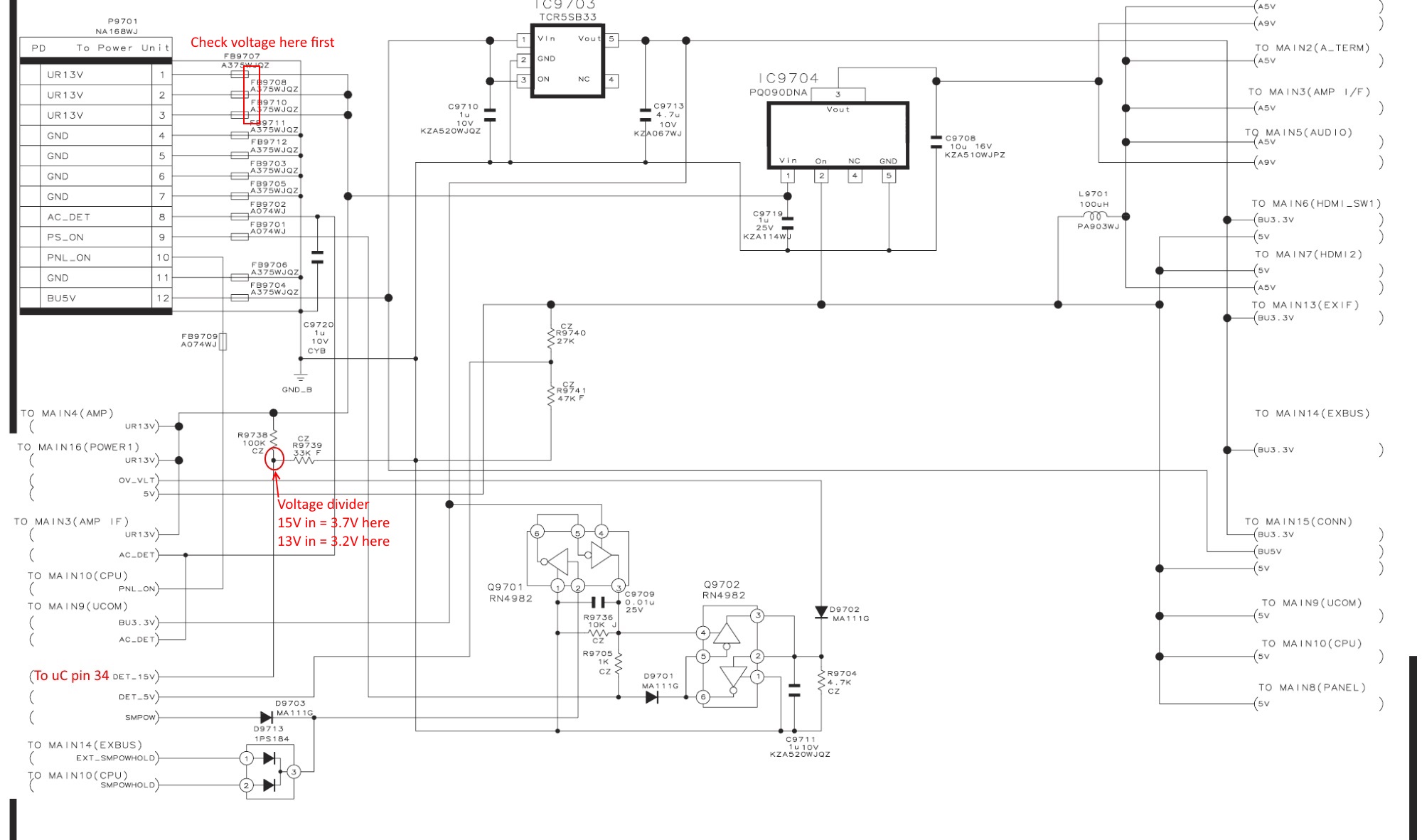

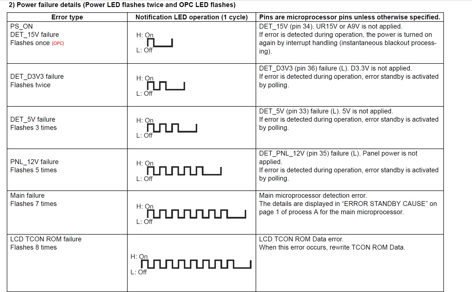

        Re: Sharp LC-46D65U Blinking - need code info
        Power twice, OPC once sounds like a "DET_15V" error. I attached some diagrams to help you check it.

          Hi Will62..
          the components circled in RED,,,did you do that based on past experience as being the problem for this error or was that hard coded in the documentation...just wasn't sure if you are also saying that those components are usually the problem..thanks
          • will62
            • Dec 2016
            • 229
            • usa
            Just circled where I would start checking to verify that the 15V detection signal is getting to the microcontroller.
