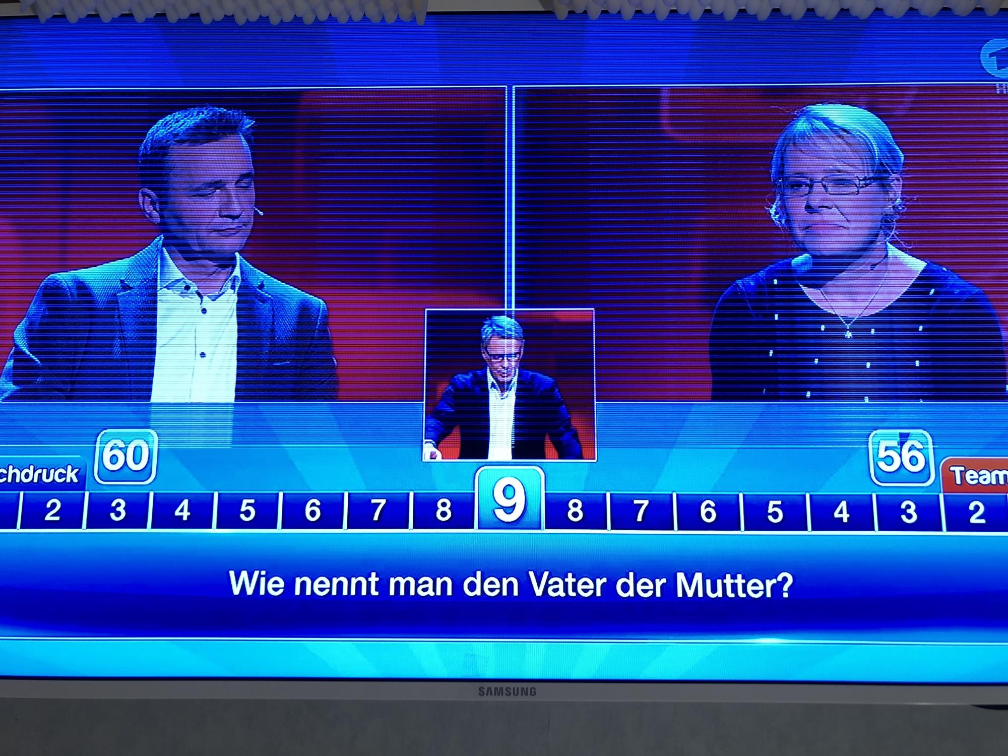

    Hey,
    I got this Samsung TV for free.
    It has some thin horizontal lines on the top 3/4 of the picture.
    I think the panel is bad, what do you think? Is it repairable? The T-Con board is ok.

    I have disconnected the left panel side from T-Con board.
    Now the right side of the picture is normal, clear picture without lines. The left side is black. Maybe it is a panel driver fault.

      Re: Samsung UE46D6510, Horizontal Lines
      Yes. The left side has a short in the gate driving section of the lcd panel itself. There's no real repair for this except possibly the scotch tape method where you cover up a few pins on the ribbon on the left until both sides look good. You will have to find out where you can place the tape to achieve this. It sounds silly but it actually works.
      turn off tv first. place tape over a few pins reseat cable and turn on if it doesn't look right turn off TV again before removing cable

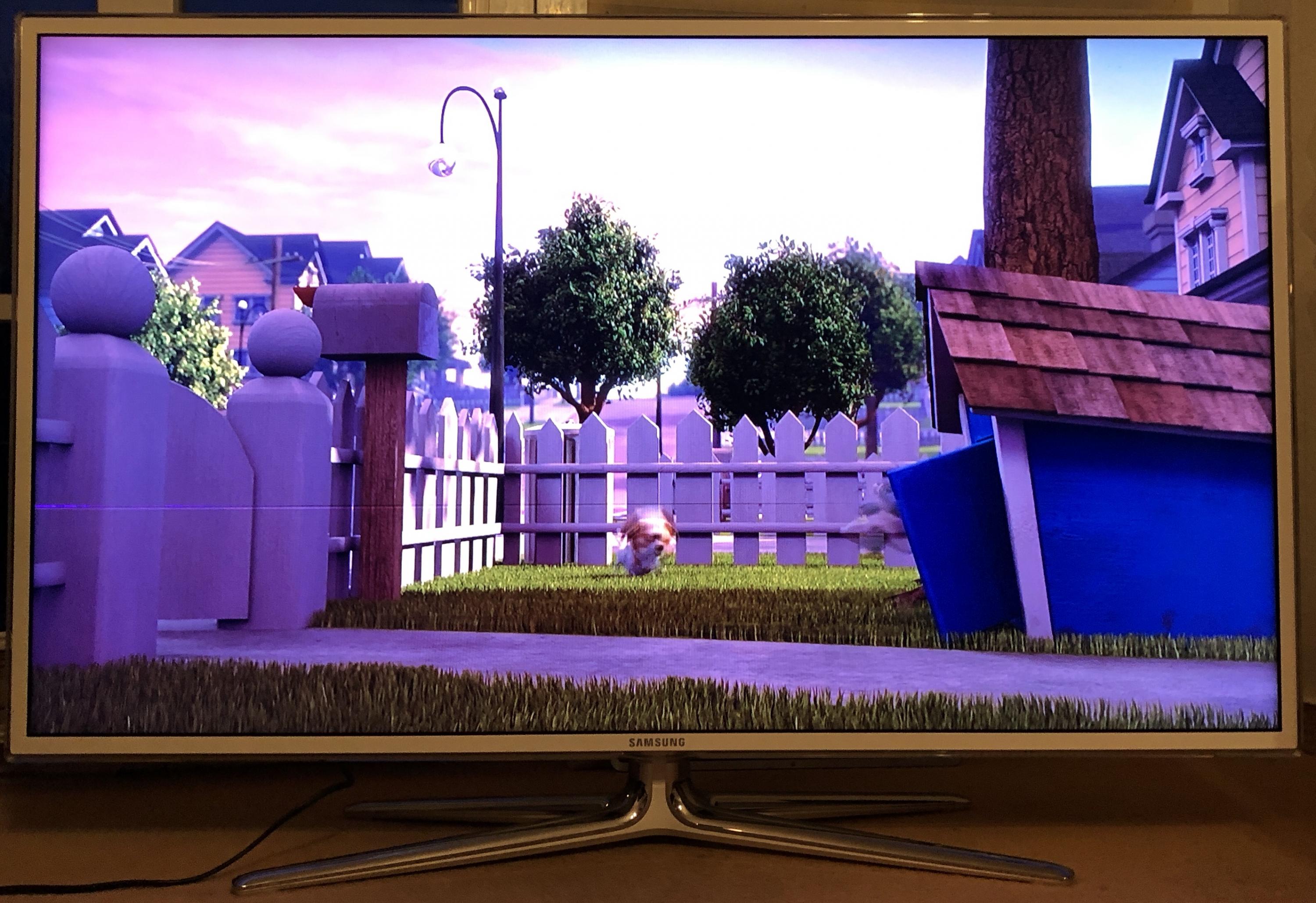

        Thanks. I found the gate signal pins on the tcon and covered them up.
        Now the whole screen works, but there is a thin colored line left.
        The line starts at the damaged side of the panel and fades down after about the half screen. At the opposite of the panel the colors are fine.
          What you're seeing is the original short that's causing the problem. If it's a vertical line, That cannot be cleared up unfortunately. That's a source COF failure. Maybe upload a picture of the line that you see?
            Here is a picture of the current state of the TV.
            The line is very annoying because I've come this far.
            The line also does not go through the whole picture.
              Yes that line is the original root of your problem the panel in the left hand gate driver side is manipulating that fault along every scan line Because it is a short circuit. What you did was allow the tcon to apply the voltage equally ignoring the short. You could try a little heat in that area to see of the line disappears. But you need to do this with the frame off the LCD screen and do not apply too much heat. Although this is not going to alleviate the problem it will alleviate the short in the panel temporarily. In the past I have taken a ryobi grinder slightly ground that section of the panel before you hit the actual liquid crystal. This is not advisable. in the past I have had success with doing that surprisingly
