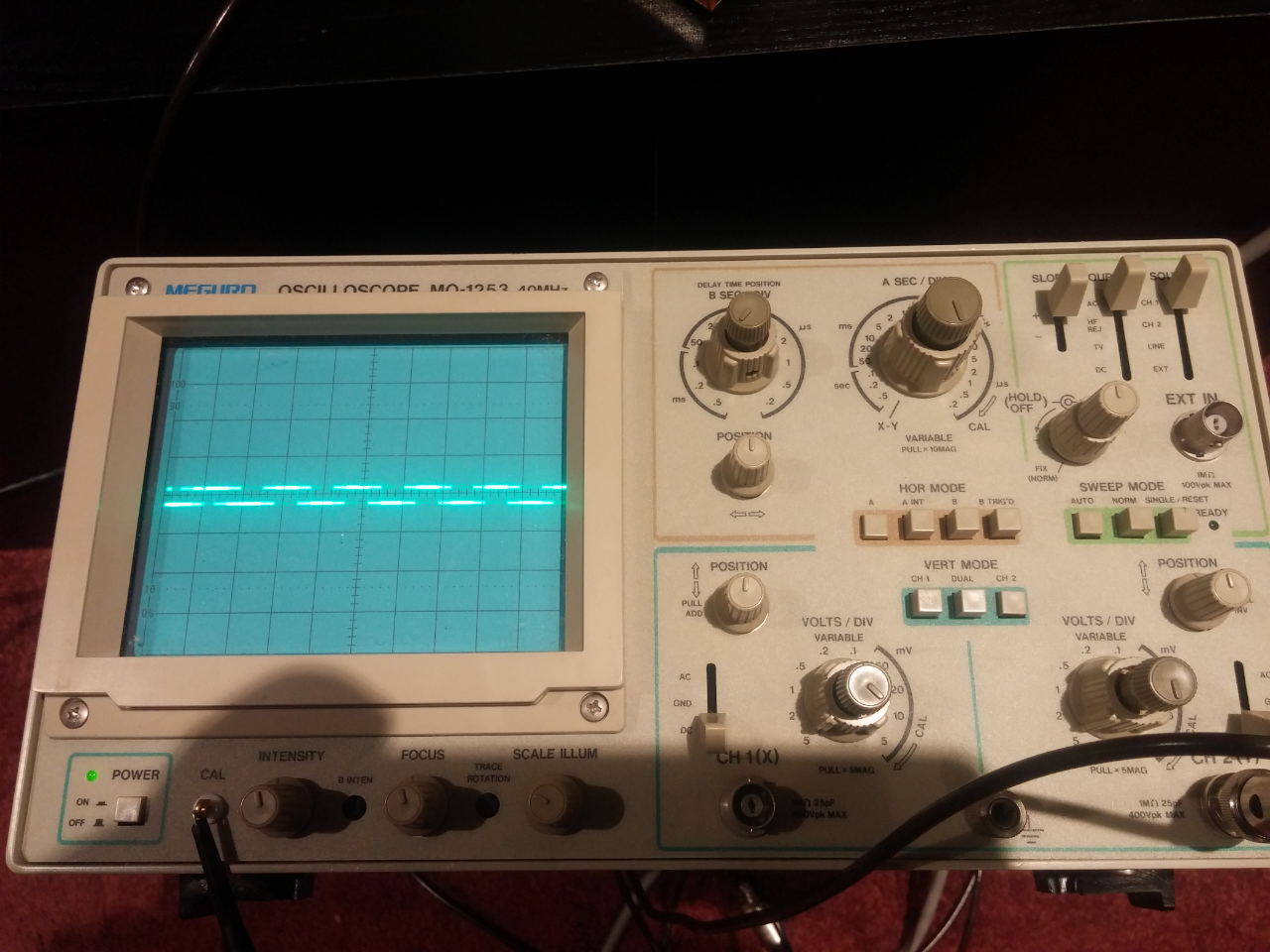

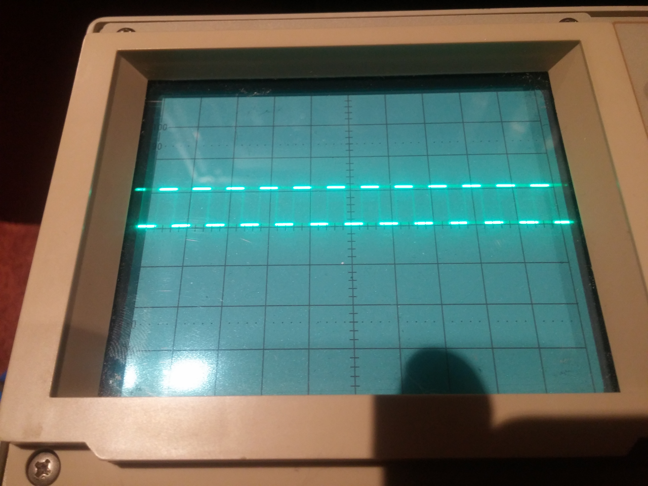

    I think so but Oscilloscopes are new to me. Yes the probe is on 10x and believe I have the Volts/div set to10. The dial is on 2 and the middle knob is pulled out for X5 mag ?? And yes both Cal are all the way clock wise until clicked off.
    Originally posted by tom66
    Are you sure your probe is set to 10X? As the waveform does not look correct for a 10V/div setting. It is way too large - should only be filling around four squares vertically on the display. Also, check the CAL dial for the respective channel is locked in the CAL position.
      #62

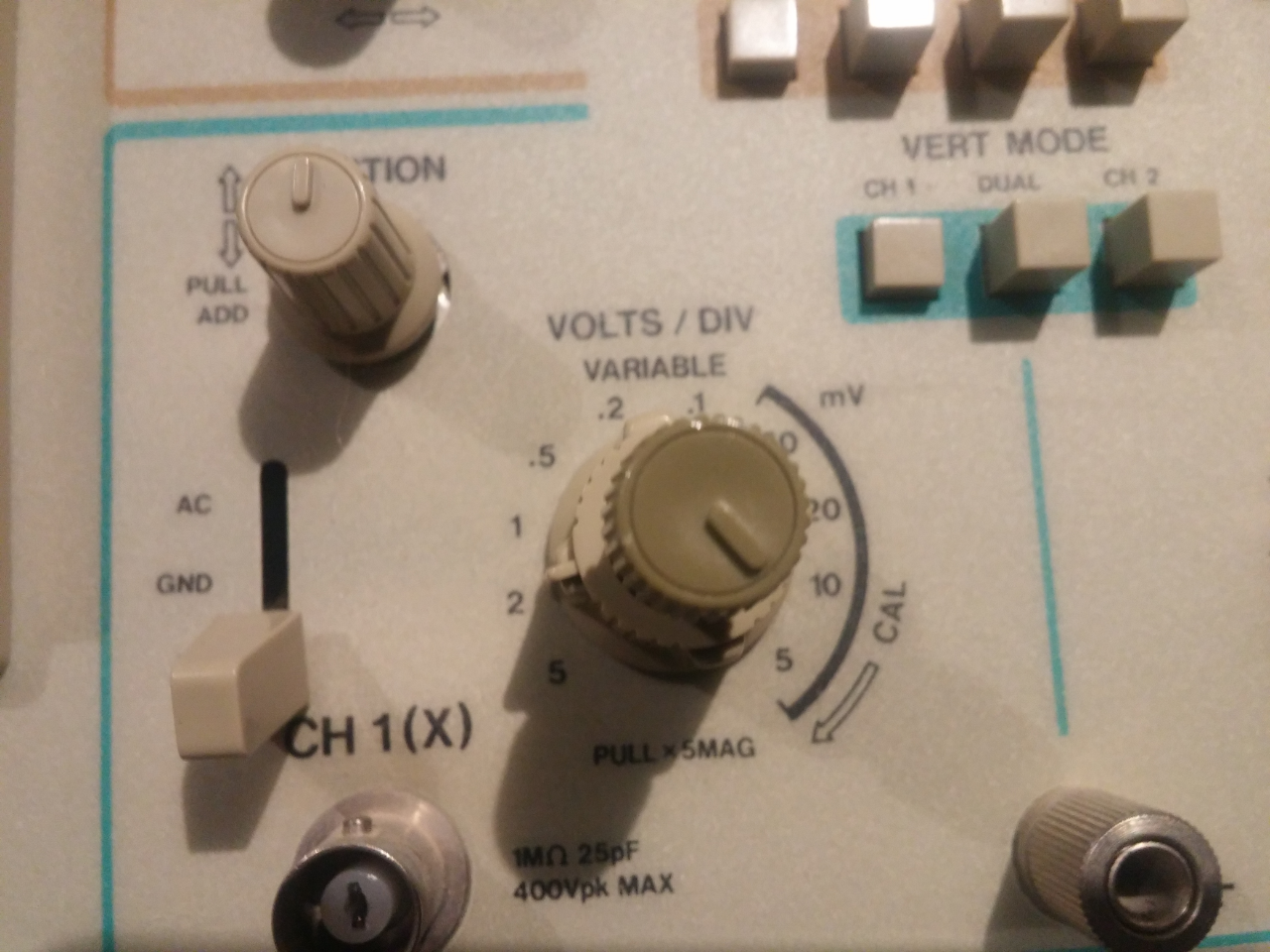

      Re: LG 50PS60 Sound but no picture Ysus board EBR6183001
      Ah, that's the issue.
      Put the x5 mag back in, disable it. Set to 5V/div.
      5V/div is still enough to see the waveform, but we might need to move it up and down.
      X5 mag on a scope is not the same as, e.g. 5X on a probe.
      It's confusing, but what 10X on a scope probe means is 10:1 ratio, so the signal is a tenth of what it would normally be.
      This means that if you have a 5V/div range on your scope, a 10X probe makes it 50V/div.

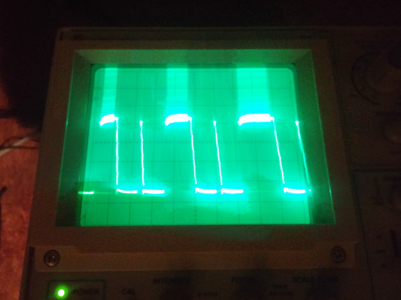

          #64

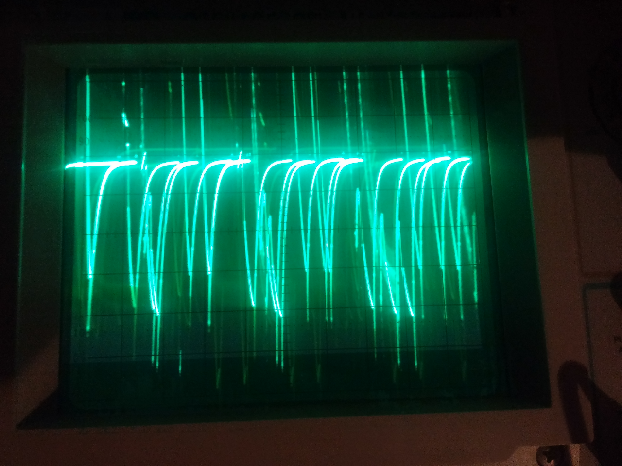

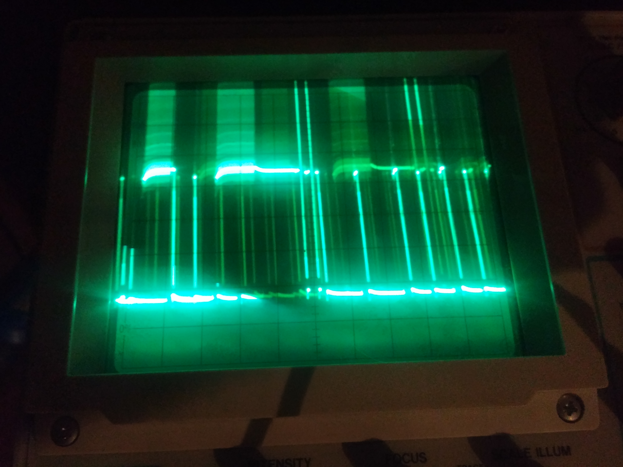

          Now I am getting this.
          • mmartell
            • Oct 2013
            • 3189
            #65
            Looks like Arabic. Maybe tom speaks that language.

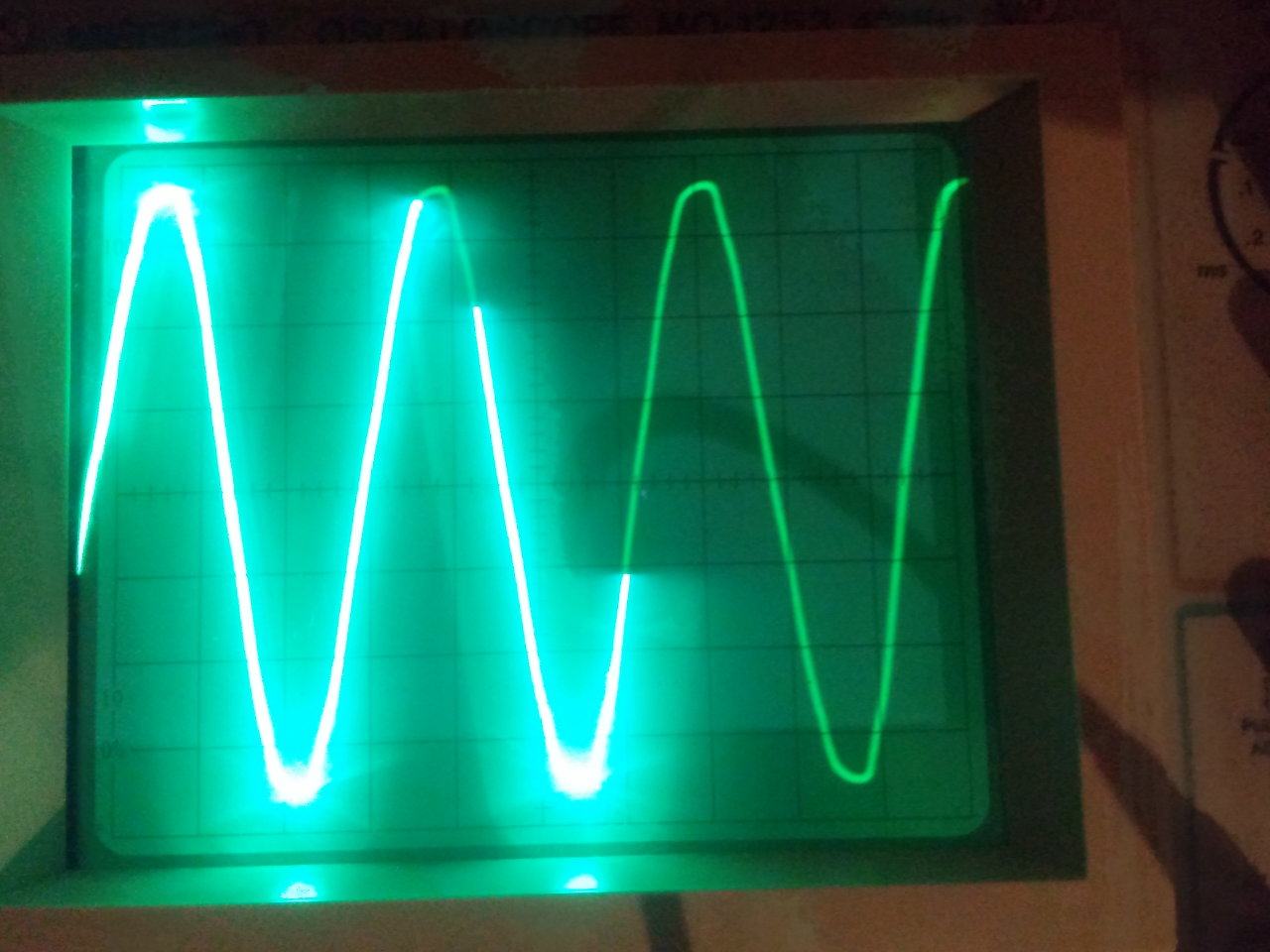

              #66
              I don't know what to make of pic above but second pic is ok. That is what I expect to see. What timebase is that at?
              This'll take some time as we're trying to do it remotely!

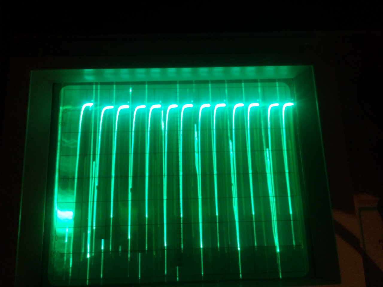

                #67
                1ms/div. Below is exactly how I have the scope setup and I have attached a picture of the reading.
                time/div 1ms
                slope +
                coupling AC
                source ch2
                sweep auto
                Level knobs in middle position
                Chanel 1 DC
                Chanel 1 volts/div 5
                vert mode ch1
                Chanel 2 DC
                Chanel 2 Volts/div 5

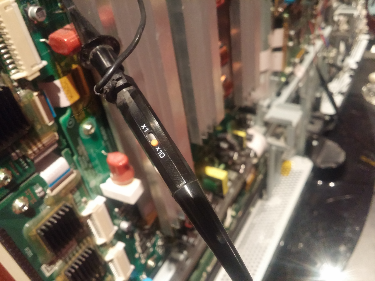

                  #68
                  Something still not right with that image. Is 5X mode off on the scope, and 10X on the probe enabled? That is a swing of over 500V!! Not correct at all, no way your board would be doing that.

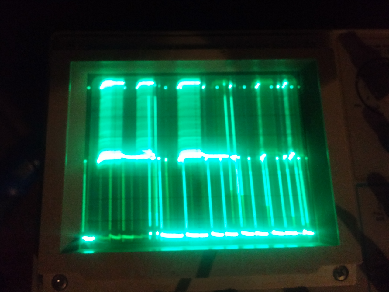

                        #71

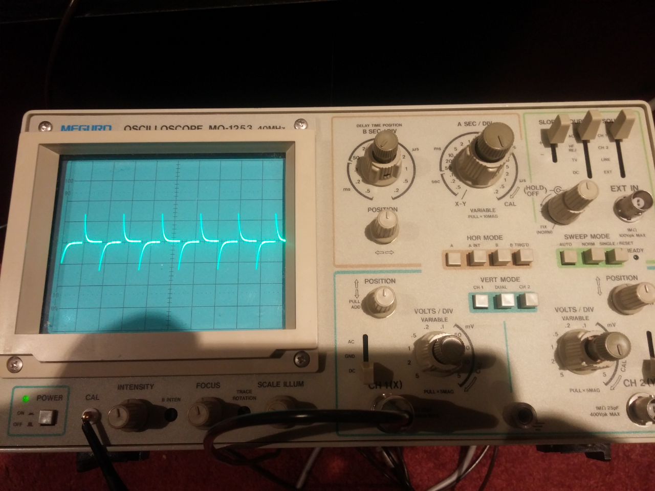

                        Channel 1 and 2 test, pic's below. The test pin is 2v and set at 5v/div
                        If you need to check the scope display, try using the calibration point on the front of the instrument. Generally it outputs a 1kHz waveform at 1V or 2Vp-p, will be written on the instrument or in the manual. It can be used to verify the scope is working.
                          #72
                          Something definitely wrong with CH1 there as that should look the same as CH2 (which appears correct)
                          I'd check the AC coupling switch is ok, might need a clean (consider using isopropyl or contact cleaner in small quantities)
                          Failing that, should be possible to do the tests for now using CH2, with CH1 as your VS_DA trigger.
                            Sprayed contact cleaner on the AC coupling switch contacts and both V/div switches and let sit for a couple hours to ensure all residue has evaporated.
                            I say this loosely....... it appears the scope is working correctly now.
                            I am getting good readings on the 2v test tab so when it is on 2v/div the scope moves up one division. I also tested the scope on 125v A/C with my probe on 10x and the scale on 5v/div but it it peaking at 3 1/2 divisions when I think it should only be peaking at 2 1/2 with my math. Is this normal with A/C current on a oscilloscope ? See pic's below.
