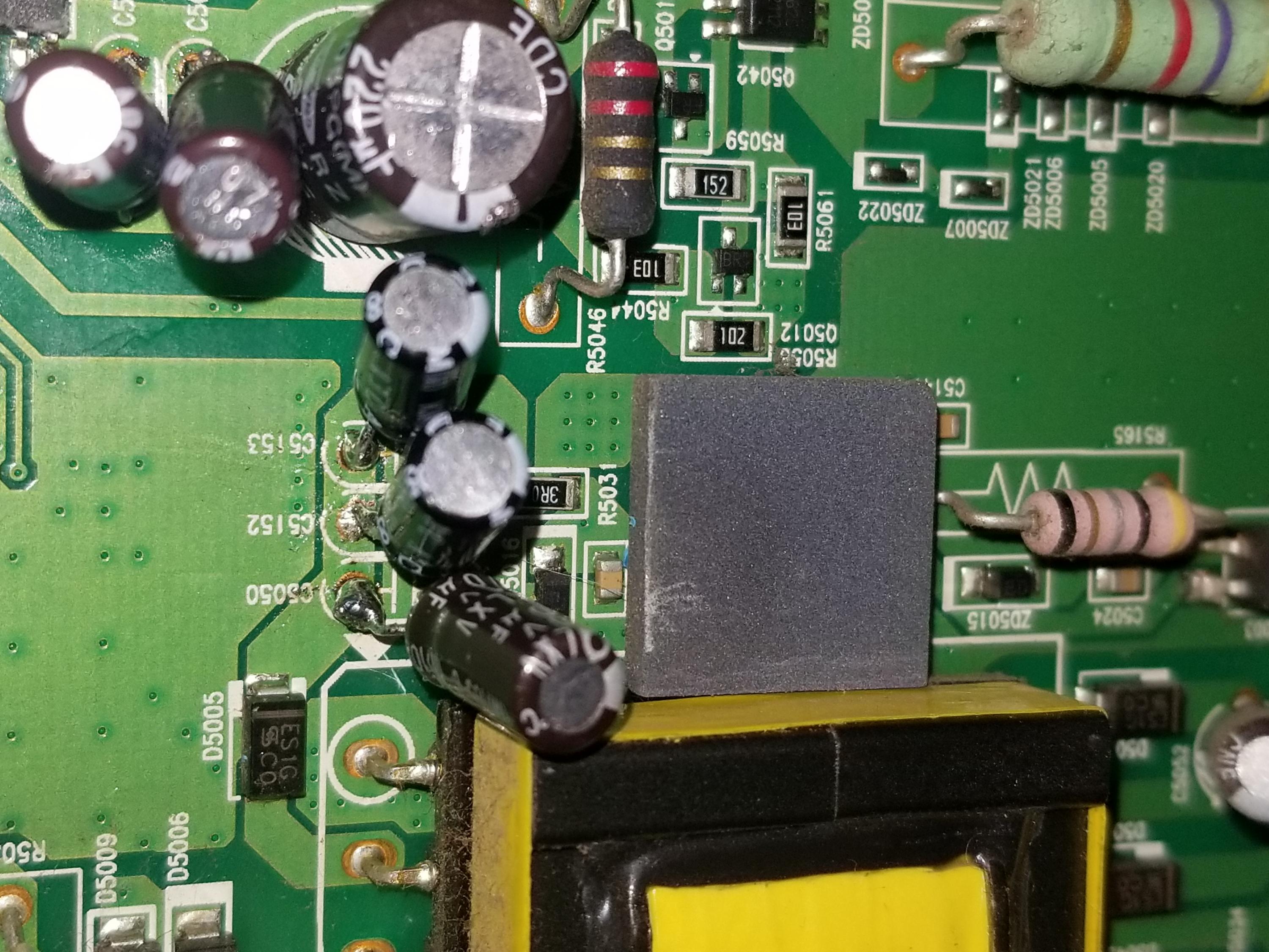

    Hey guys.
    So this one has VS but drops off right after I hear the Samsung chime. This one is not the infinion IC, but C5050 was the issue. I replaced all 5 around the area for good measure.
    They were originally ceramic, replaced with 50v 10uf electrolytics.
    Worked like a charm.

    Very cool, I didn't know you could swap those type caps

      Nice work What were the original Ceramic values. And yes you can replace non-polar caps with e-caps.

        Thanks guys. Original values were 106
        The trick is using it your DVM to locate which side is ground if you want to use polarized lytics. I have used these before in low power applications and found that they are just as reliable.

          I used radial caps myself on one of these. Works great! Time to find a buyer$$$$
