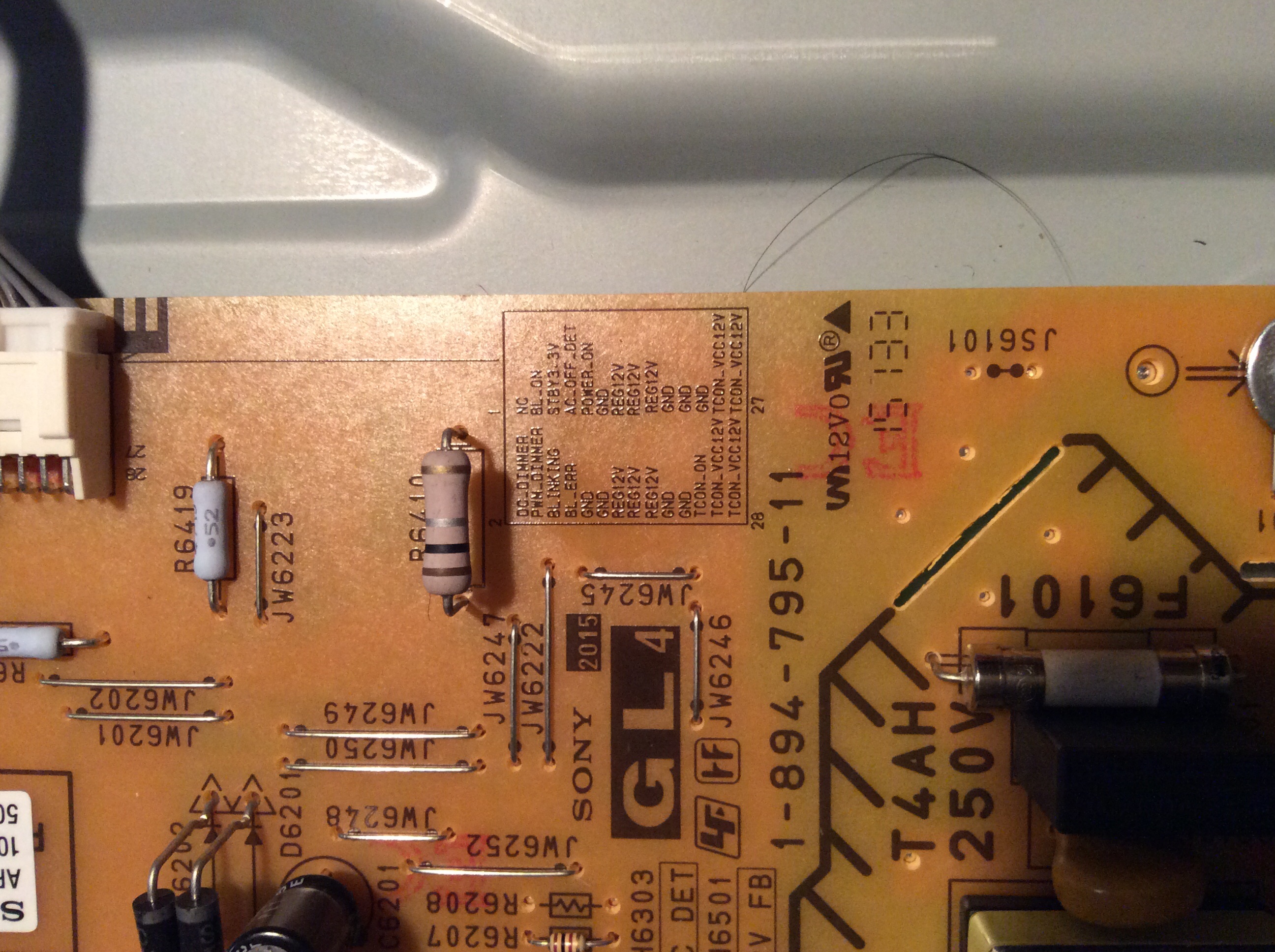

    I have this tv that is complete dead.. it shows no power at all. No stanby light.. i checked the power supply voltages with the harness connected to the main board and here are the only voltages i get... need help to find out the problem..
    Bl-err 2.38v
    Stby 3.47v
    Ac-off-det 3.47v

      You may want to check a little further before buying a new power supply. This set has a self diagnostic function. When the uC detects a problem, an LED flash code is produced. You said that you had no LED status light. If you have standby voltage, but don't have a status light, it could be a main board problem.
      Your BL_ERR is also slightly above the 1.9V cut-off, so you may have multiple problems. There are ways to force the power supply on, so that you can see if you have a board problem, or a backlight LED problem. That would require some resistors.
      That is a good plan, I just didn't know how long the board would be available at that price, could do that testing to be sure, board will take at least a couple days to arrive, nice to have a spare tho.
