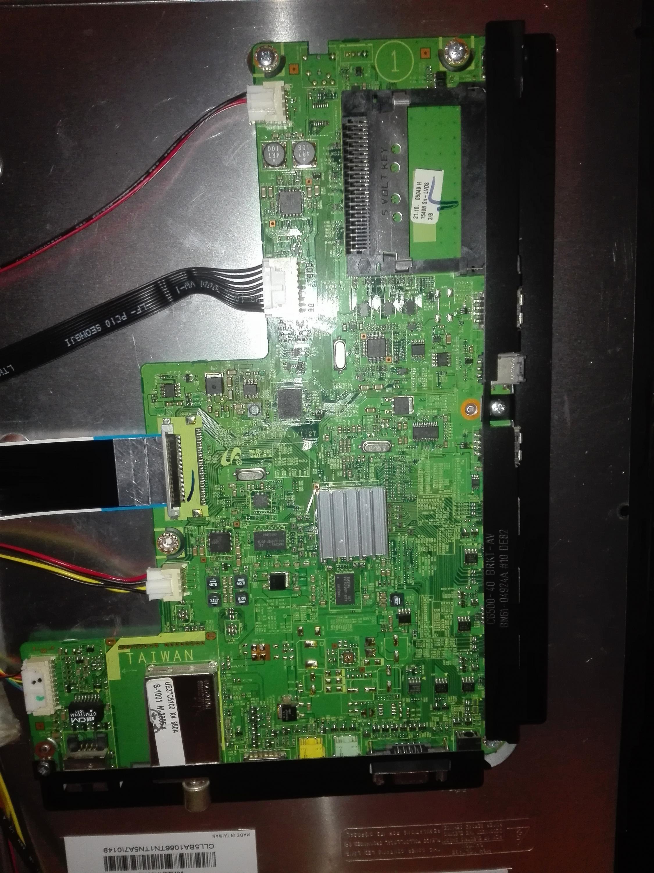

    Hello
    I've an Samsung LED UE3c5100
    The TV don't turn on, the standby led blink 6 times .
    I checked the power supply board is OK . All voltage
    I checked all the voltage on the main board ( with service manual) are OK.
    I think it's the EEPROM is corrupt. What is your idea?
    I didn't find the firmware for this TV.
    And with schematics i found there a lot of EEPROM's on this TV. Which the EEPROM for the powering ?
    Thx

      Re: UE37C5100 don't turn on: standby led blink 6 times
      The power suuply board bn44-00351B
      The power supply is good . All voltage are OK. I made a shunt for the backlight ON/OFF and the backlight is ok.
      I found the all voltage that write in service manual for checking in "no power" section.
        I extracted eeprom files:
        IC501 read at 24C256
        IC502 Read at 24C02
        IC901 - ATMLH038 (i tried to read at 24c01 and 24c02)
        Can you say me if my eeprom dump are ok without faulty.
        I tried to flash with dump from UE32c5100 , without changing only with IC502 with the new dump of ue32c5100 the when i plug the AC cable the standby led don't blink only after press on power button the led blink 6 times and no turning on.
            Before, when the television worked, after pressing the button puwer, the led flashes 6 times and we hear samsung jingle and telly turn on. Now after flashing 6 times the led remains off and no picture and no sound then we can not turn on or off any reaction
              That's a tough one, you might be on the right track, wonder if it could be a faulty led strip or led short keeping it from coming on.
              • lepak06
                • Feb 2017
                • 51
                • france
                The led strip was tested ok.
                I need eeprom dump to check this way
