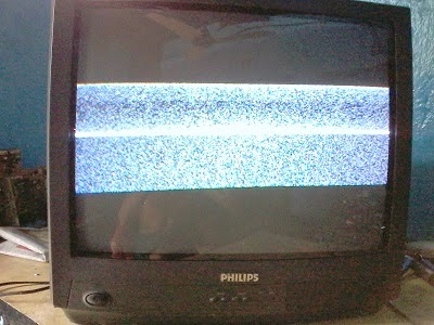

            Yes, the TV is a 28" JVC CRT TV. When you first switch it on, you get half the picture as a horizontal band and then after a few mins you just get single red/blue/green lines in the middle of the screen. After about 20 mins the picture come right and can stop on all night and run perfect. I have done some reading and I think it must be the vertical IC chip which is not working when cold. I have resoldered all the joints to the chip and have tried replacing a couple of capacitors anyway without any luck. I am a beginner at electronics repair but it makes sense. The IC chips are obsolete now from what I can see so I guess it is time for a new TV.

                more likely its the screen bypass cap. something like 10-22 uf at 250 volts, near the flyback, or bad cap in the vertical output section.

                  Replace ALL the e-caps in the Vertical section (16V, 25V, 50V, etc). Re-flow the Vertical output IC pins and any suspicious cold solder joints in the Vertical section (be careful not to short out any connections). Look for Hi-Voltage e-caps. i.e. 160V, 250V (Not the main filter cap, as that is OK) and replace them, as well. There would be a 10uF 250V e-cap either on the CRT neck board or near the F/back Transformer in the middle-rear in the Horizontal section that may stand out. BTW the 2200uF 35V e-cap will work.

                              Have you checked the voltages on the vertical ic, what are they (pin # - voltage)
                              I didn't quite understand the actual problem, I thought the rgb lines were the only problem.
                              You say the picture is compressed top and bottom when it is first turned on?
                              I must not have been using the correct schematic, the vert ic does'nt match in this one. must be a different chassis
                              I also made a typo. It should have read C601, not C801 but that would be to correct lines near the top of screen only.
                              Is there a chassis number somewhere? Is this circuit look right
                              You may have a low +50 volts to the ic, C620 may be badif that is the case.
                              If +14v_vert is low, C625 could be bad

                                Yes, the picture is compressed when you first turn the TV on and then it goes to just BGB lines and then comes normal. The 2 10uf 250v caps I changed were the only 2 in the TV. It looks like my set is a slightly different revision of the service manual as the vertical IC has a different number of TDA8359J (I hope I have located the right component).

                                  Now that you have done all that. I would replace the Vertical Output IC. As e-caps and cold solder joints have been replaced and fixed.
