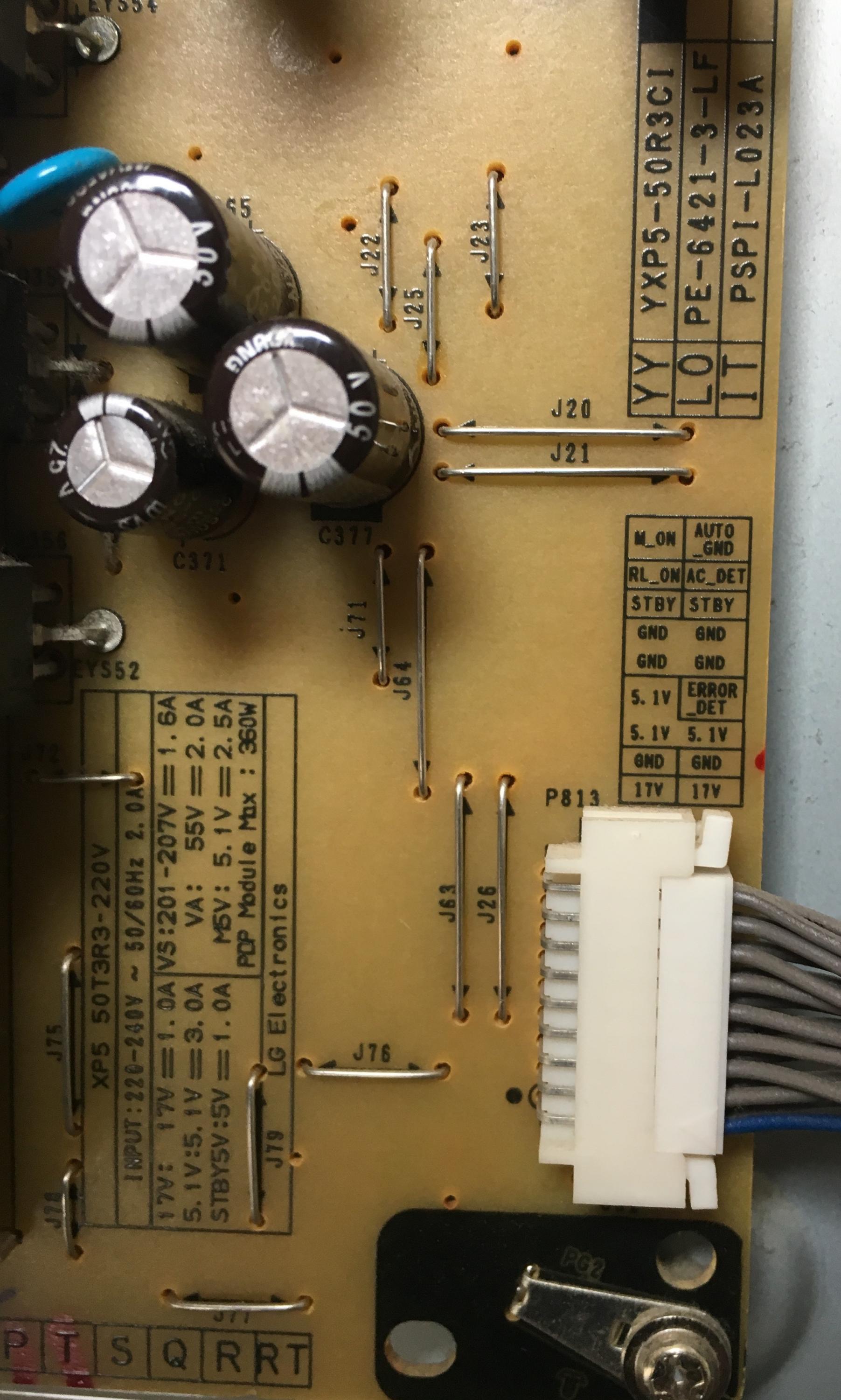

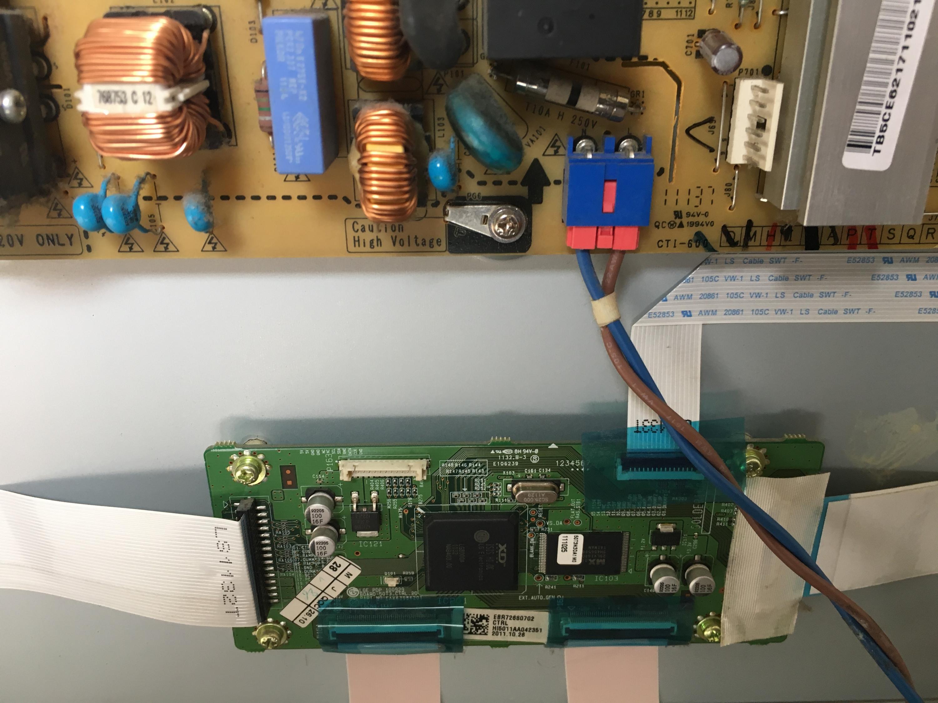

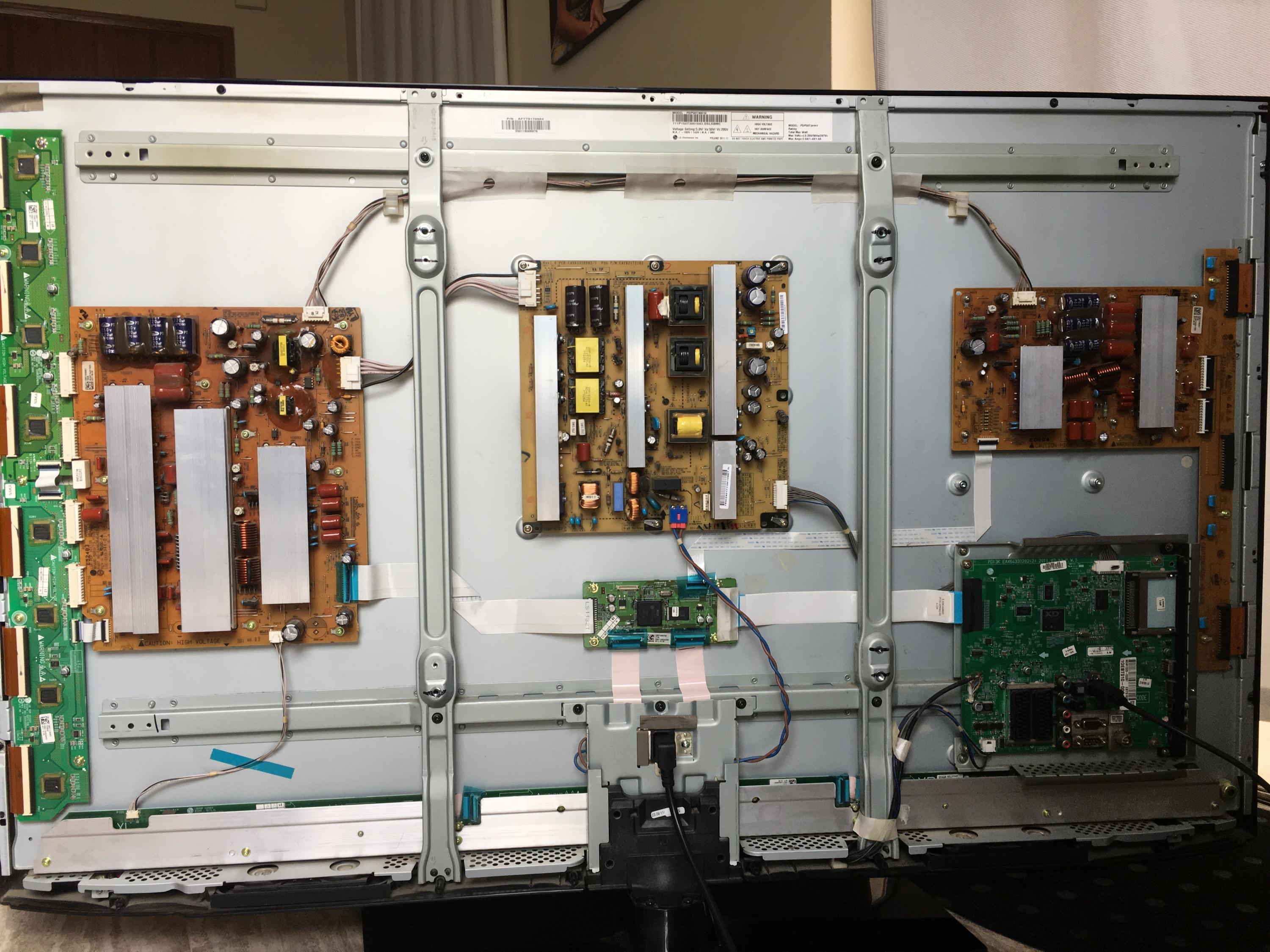

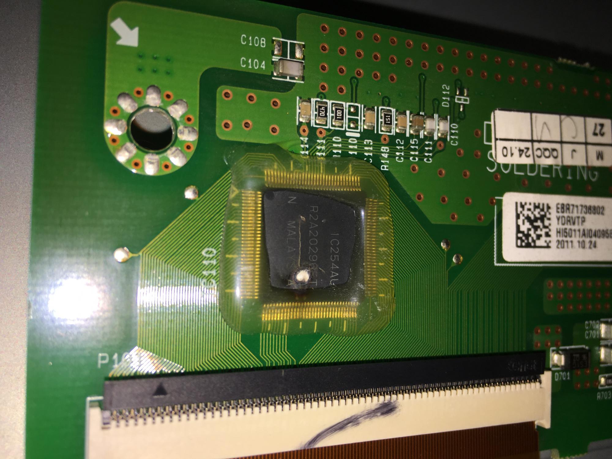

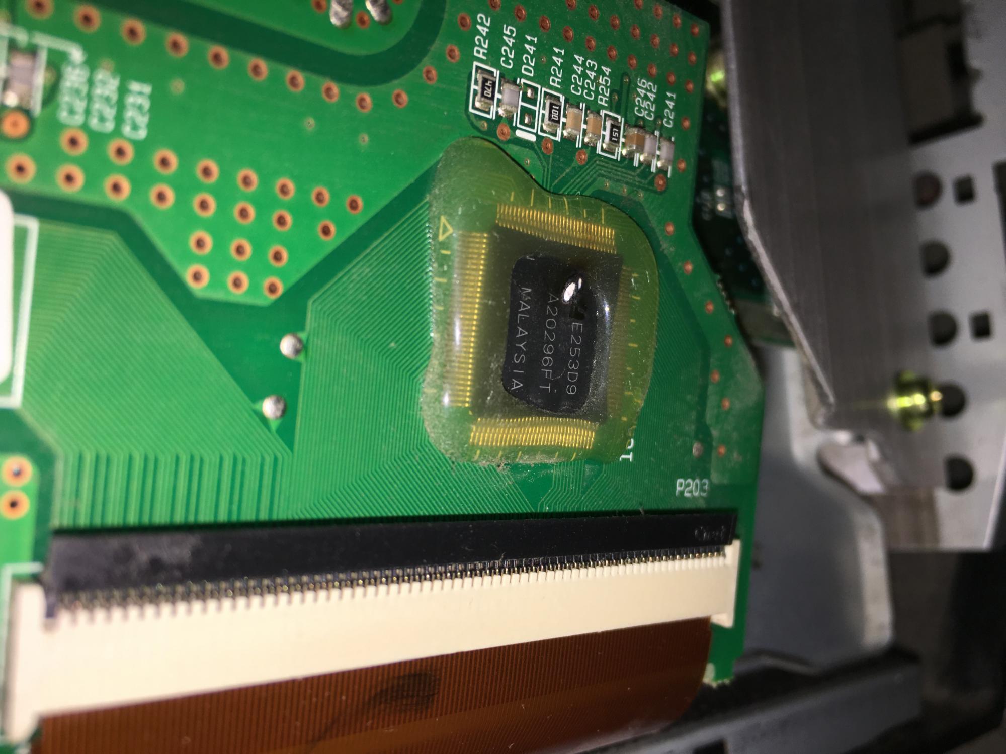

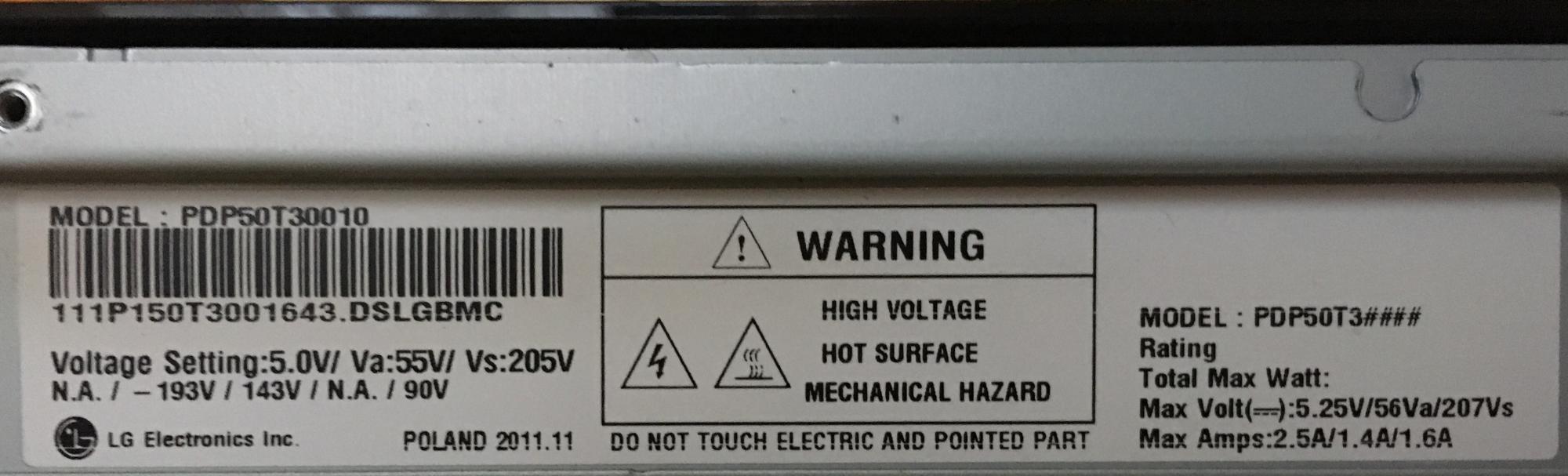

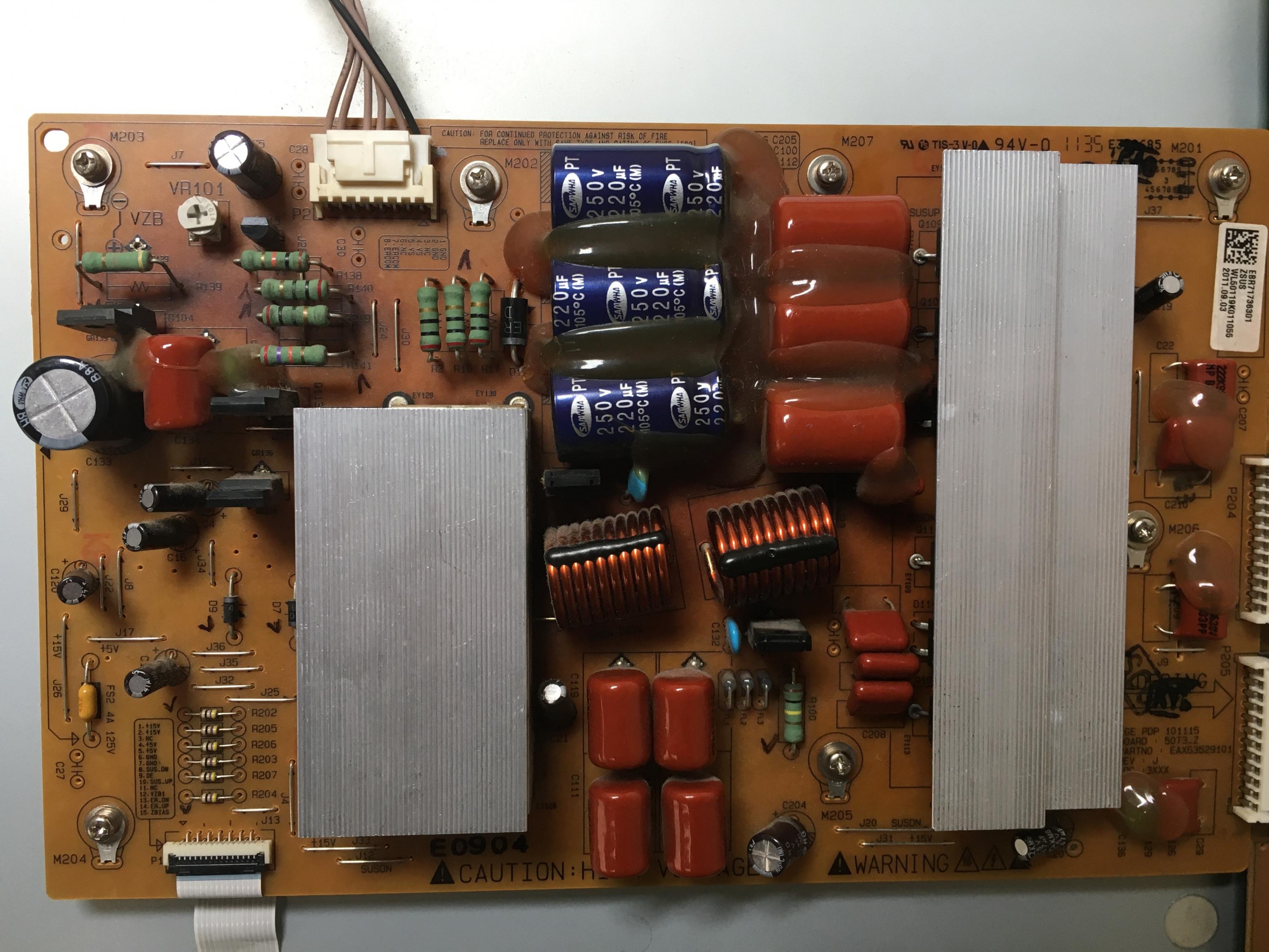

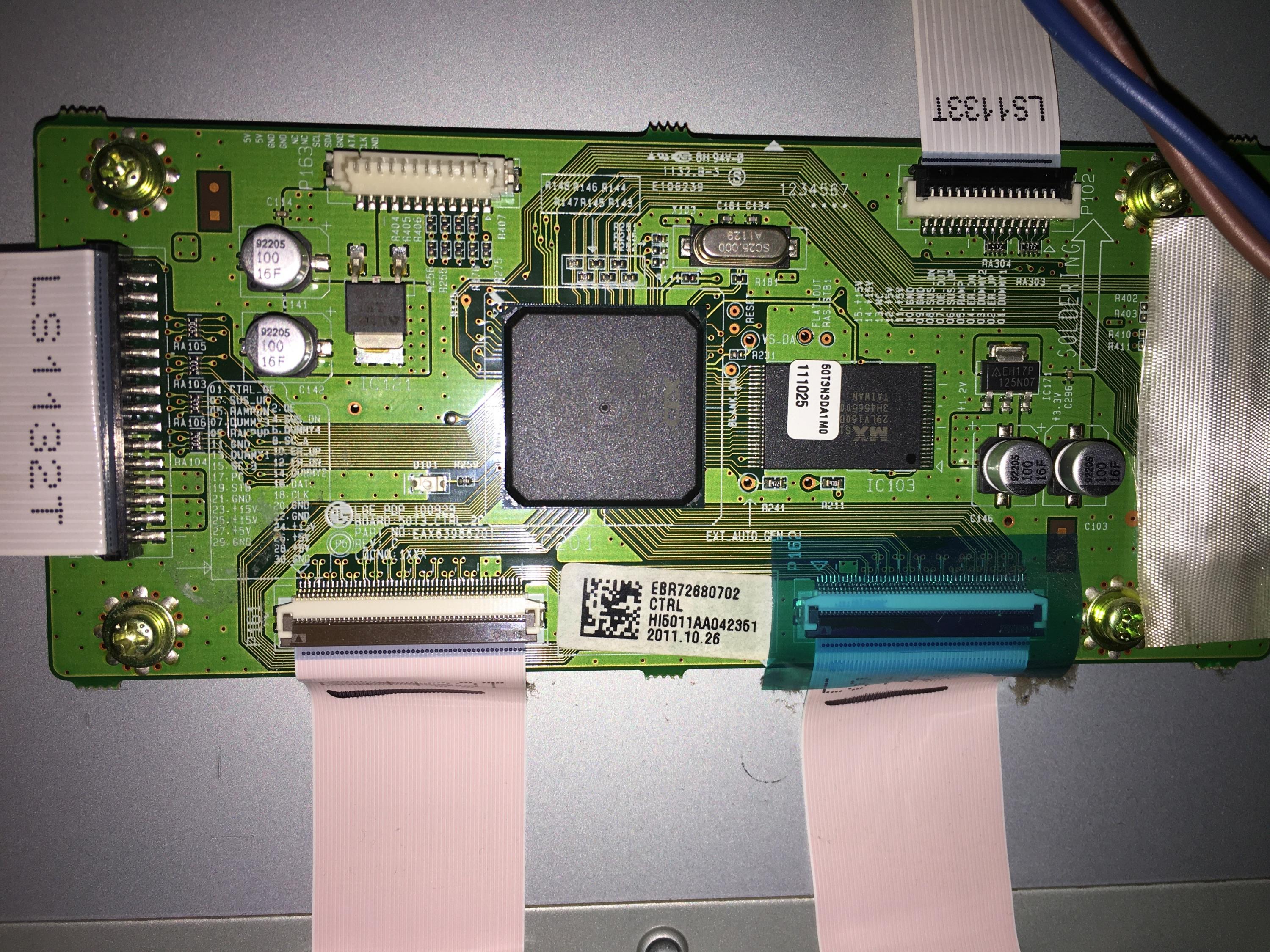

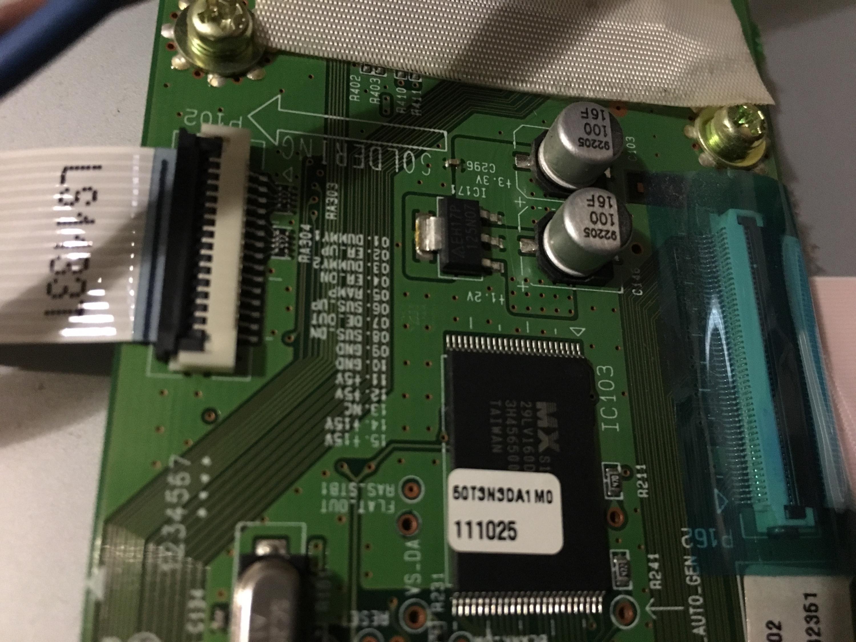

LG plasma PDP50T3, with sound, no picture
  • Sraros
    • Jan 2017
    • 223
    • Greece
    LG plasma PDP50T3, with sound, no picture
    Hello people, I have the am TV which was brought to me by a friend.
    How it came:
    When plugging the TV, the power board relay was clicking on and off not letting tv to get power. By pulling out the cables I found short at Z-SUS. I run through it and found a diode shorted, 2 out of 3 IGBTs shorted and an optocoupler on the back of the board damaged (most probably from the technician he gave it too...)
    Now after repairing these I did not find something else at least to my knowledge.
    Now I plug the TV, I get red light and the TV is on standby. Opening it with the remote, the TV turns on, I have sound but I get no picture at all. Another thing is if I come close to the boards I hear from the Y-SUS and the power board, a constant clicking sound like every 0,3 second which I can bearly hear. The T-CON board green LED flashes four times with a pattern of flashes:
    short, short, long, short and again.
    Voltages:
    TV on standby:
    STBY: 3,5V
    TV on:
    Vs: 205V (rated between 201-207)
    Va: 53V (rated 55V)
    M5V: 5,12V (rated 5,1)
    M_ON: 3,29V
    RL_ON: 2,53V
    STBY: 5,16V
    5,1V: 5,16V
    17V: 16,94V
    Any indication on what to check next, what to do and what it can be?
    Re: LG plasma PDP50T3, with sound, no picture
    Can you supply a picture of the panel sticker, which has Vs/Va and other voltages printed on it.
    The slight ticking would make me suspect a short on the Vsc supply that feeds the Y-buffer board.
    • Sraros
      • Jan 2017
      • 223
      • Greece
      Re: LG plasma PDP50T3, with sound, no picture
      Hello, thanks for having a look. Here are the photos. I forgot to upload them...
      I attached a photo of the whole back of TV. A few things that are weird are one cable from the Z-buffer to the panel is missing although it seems it was always like that, no welding or sth visible and from the T-con and PSU there are at each a cable socket but I didn't find any cables hanging. I'm thinking if the so-called repairman forgot sth :P
      • tw2005
        • Oct 2011
        • 6458
        Re: LG plasma PDP50T3, with sound, no picture
        The cabling is normal, missing ribbon normal and the logic control led , also nothing to worry.
        On the ZSUS, was the pico fuse ok, any burnt or open cct resistors like those low ohm green high wattage flameproofs?
        all I can add at this point
          Re: LG plasma PDP50T3, with sound, no picture
          We still need a pic of the panel sticker, top centre of the TV so we can tell you what -Vy and Vsc need to be
          • Sraros
            • Jan 2017
            • 223
            • Greece
            Re: LG plasma PDP50T3, with sound, no picture
            Here you go
              Re: LG plasma PDP50T3, with sound, no picture
              OK so
              -Vy is -193V
              Vsc is 143V
              Unfortunately I do not have an exact SM for your 50T3 panel, but 50R3 is from a similar generation but is 1080p Full HD vs 720p WXGA. See page 142
              • Sraros
                • Jan 2017
                • 223
                • Greece
                Re: LG plasma PDP50T3, with sound, no picture
                Tom you are spot on.
                Vsc is trembling between 0,5 and 5V and Vy is going between 85-96V
                  Re: LG plasma PDP50T3, with sound, no picture
                  You probably have a shorted buffer (scan driver) board then.
                  Disconnect the top buffer including the ribbon between bottom and top boards. You may leave the ribbons attached to the plasma panel.
                  Check Vsc and -Vy.
                  Repeat test with bottom buffer.
                  This will allow you to identify the failed driver board.
                  Whichever causes Vsc to come up when removed is the shorted board.
                  You may get half a picture or partial discharge on the screen when you do this.
                  Also -Vy should come back up when Vsc short is removed.
                  If it is still low when both boards are removed there is another issue, probably with the Y-sustain board.
                  Last edited by tom66; 02-10-2018, 03:55 AM.
                  • Sraros
                    • Jan 2017
                    • 223
                    • Greece
                    Re: LG plasma PDP50T3, with sound, no picture
                    Sorry but can you point out based on the first picture of the whole TV which to remove?
                    If I undrestood correct, remove the Y buffer boards one by one?
                    Last edited by Sraros; 02-10-2018, 04:05 AM.
                    • Sraros
                      • Jan 2017
                      • 223
                      • Greece
                      Re: LG plasma PDP50T3, with sound, no picture
                      I rushed so much to do the steps you pointed out, I missed to see in both Y buffer boards there is a chip burnt. I can confirm both are shorted by chexking some SMD caps. So with both buffer boards removed I get
                      Vy: 194,7
                      Vsc: 144,4
                      And I measured also on the X-SUS
                      Vzb: 90V (like sticker rated)
                      However I still got no sign at all of partial image with the Y-SUS board connected and only Y buffer boards removed... Does this mean even if I order new buffer boards I might have to go deeper like main board or is it in some TVs normal?
                      Edit: I will try to remove the burnt SMD chips to see if the shorts fix
                      Last edited by Sraros; 02-10-2018, 06:56 AM.
                        Re: LG plasma PDP50T3, with sound, no picture
                        The buffer boards / scan drivers are the boards on the left hand side of the TV when looking from the back, and they are connected to the Y-sustain board (the board that you measured -Vy and Vsc on). They are connected to the plasma panel via orange ribbons.
                        You need to remove their mounting screws, and the ribbon cable that links one to the other. Remove the top board, power the TV up, then check the -Vy and Vsc and see if something appears on the panel (may be random picture noise, may be half of a picture, it depends on the design). Power off TV, then re-connect the top board and disconnect the bottom board. Again check -Vy and Vsc and check to see if something appears on the panel.
                          Re: LG plasma PDP50T3, with sound, no picture
                          If the buffer ICs are both burnt on both boards that could be an issue with the Y-sustain. You will not get any discharge with both boards removed because the Y-sustain connection is vital to get any image. With Z-sustain removed you usually get discharge through panel capacitance, but it is very weak (dim, poor discharge)
                          • Sraros
                            • Jan 2017
                            • 223
                            • Greece
                            Re: LG plasma PDP50T3, with sound, no picture
                            It's one chip out of 3 for the top and 1 out of 4 for the bottom. Also the voltages of the Y-SUS are ok when I remove them. It can still be sth else that fries the chips?
                            If all three boards have to be replaced I think it will be very costly and I ll leave it. At this point of time I cannot find a good price for the bottom Y buffer already...
                              Re: LG plasma PDP50T3, with sound, no picture
                              I can't be sure. You'll want to check the panel is not cracked
                              • Sraros
                                • Jan 2017
                                • 223
                                • Greece
                                Re: LG plasma PDP50T3, with sound, no picture
                                Hello again. So I had ordered and received today the chips of the Y-buffer. I replaced the burnt chip successfully on the bottom buffer board and put it back in but still no picture.
                                Vsc: 144,5V and Vy: 194,5V stable.
                                Va: 54,7V at bottom buffer
                                Vzb: 88V
                                So I just found also..At the control board P102 connector (coming from Z-SUS) point 14 and 15 mark 15V but I measure 1,5V
                                  Re: LG plasma PDP50T3, with sound, no picture
                                  I can't remember for certain on these sets but I think the 15V for the Z-sustain comes from the Y-sustain, so it could be a problem with the Y-sustain not generating the 15V.
                                  • Sraros
                                    • Jan 2017
                                    • 223
                                    • Greece
                                    Re: LG plasma PDP50T3, with sound, no picture
                                    The 1,5V instead of 15V I am measuring at the control board are at both ends of the y-sus cable and the z-sus cable. Is it coming in from y-sus to control board and then go out to z-sus? How is this exactly working?
                                    I uploaded a close photo of the control board too
                                    Last edited by Sraros; 03-07-2018, 07:53 PM.
                                      Re: LG plasma PDP50T3, with sound, no picture
                                      I think the Y-sustain generates the 15V from the transformer on the Y-sustain board. It could be something wrong with that part of the circuit though I can't be certain.
                                      • Sraros
                                        • Jan 2017
                                        • 223
                                        • Greece
                                        Re: LG plasma PDP50T3, with sound, no picture
                                        Hello again, I replaced the Y-board and at first got nothing. It seems also the previous technician didn't connect somehow correctly the Z-buffer board, so after attaching the ribbons correct again the TV works fine now
                                        Thanks for your help Tom. I appreciate!
                                        • TR103
                                          by TR103
                                          - it keeps rebooting
                                          01-22-2025, 04:12 PM
                                        • Mgiffune
                                          by Mgiffune
                                          06-09-2024, 10:28 AM
                                        • Ierwin
                                          by Ierwin
                                          05-13-2025, 03:31 PM
                                        • jchang
                                          Samsung UN70NU6900F no picture and no sound
                                          by jchang
                                          Hi all
                                          I was just given a Samsung TV with the issue. I read various threads and videos and attempted the ribbon tape method to gain an image, but no luck.
                                          Symptom:
                                          No picture no sound.
                                          When I plug in the power cord, Backlight LED turns on for a half second and then turns off. The red LED next to the power button located center bottom flashes 2 or 3 times. When the power button is pressed after, it does the same thing.
                                          No sound at all.
                                          What I tried:
                                          1. I tried unplugging the left or right ribbon...
                                          01-09-2023, 06:28 PM
                                        • SluggerB
                                          LG Plasma (PDP50R10101) No picture No sound
                                          by SluggerB
                                          This is my first Craigslist freebie fix attempt. 50 inch LG Plasma TV Previous owner said over time it was struggling to turn on, it would take 4-5 times to turn on, the one day it just did entirely. I took it home and plugged it in, I her a click, then a second later another click, and nothing. Dead as a doorknob
                                          So I took the back off and check voltages. The power supply appears fine, I checked the VS, VA, and 5V voltages and they all measured correct, on the power supply board and on the display boards (Y and X boards). All the fuses are fine
                                          Following a YouTube videos...
                                          12-03-2022, 09:10 PM
