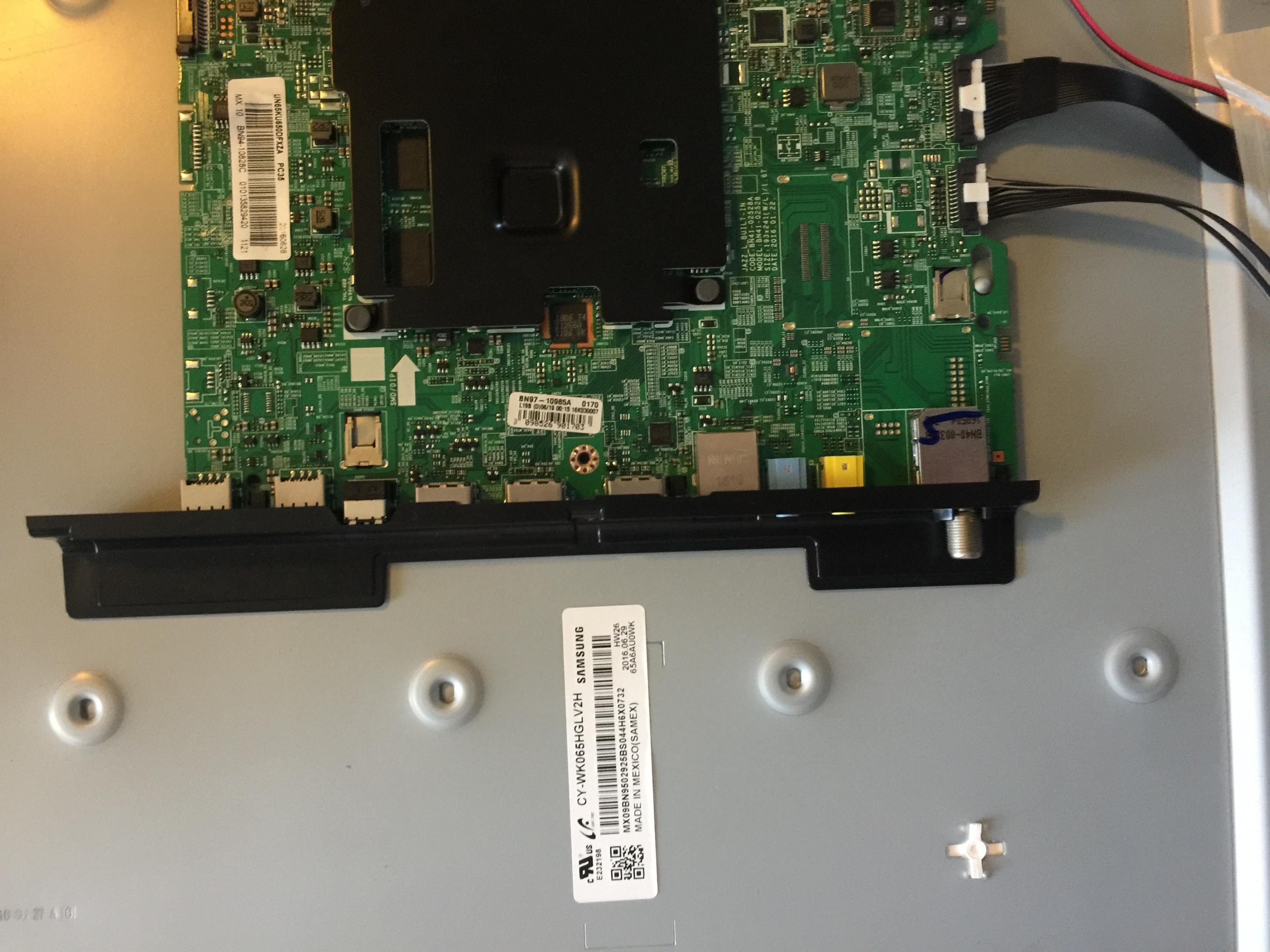

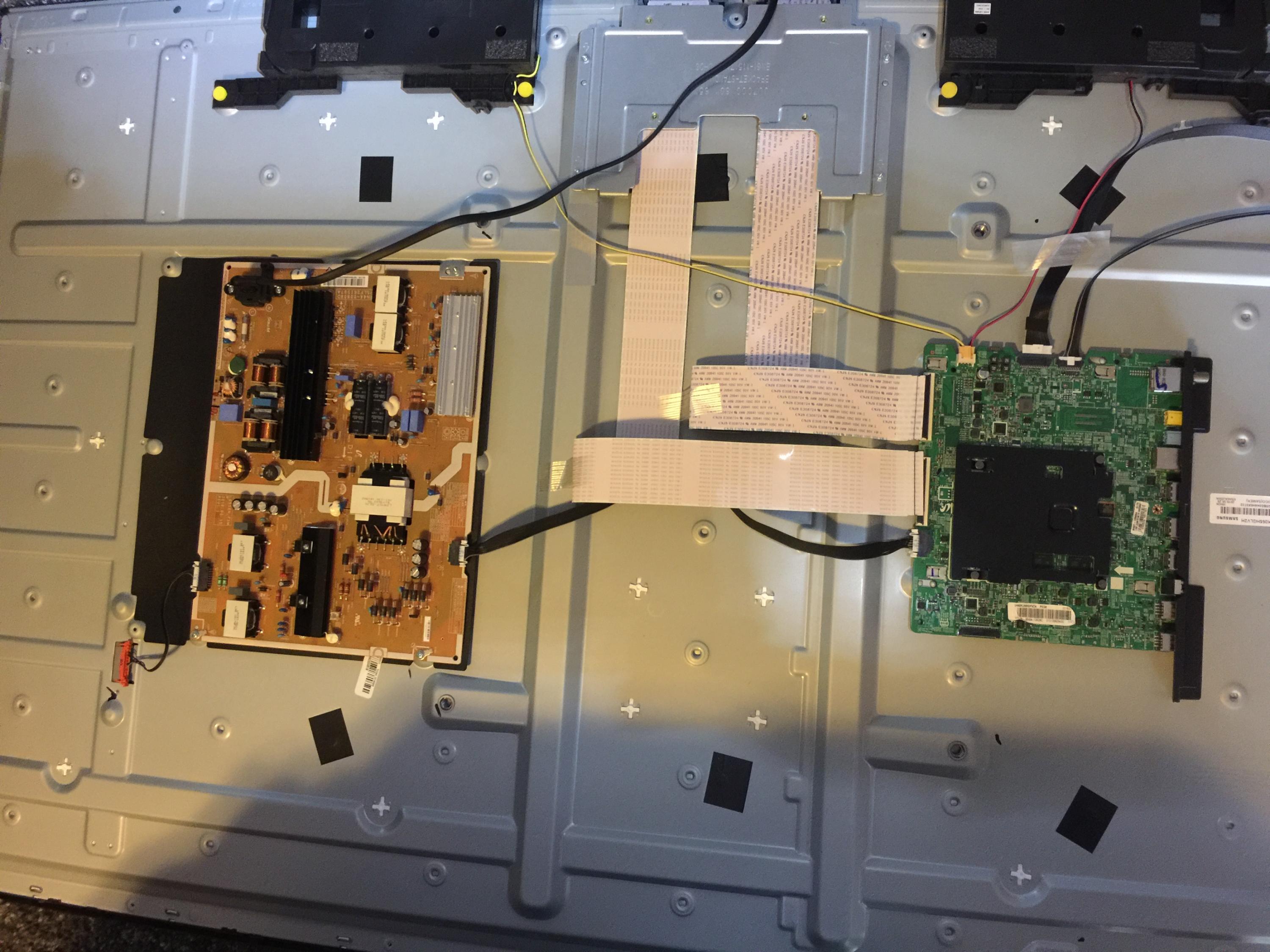

    The TV has no sound or picture, but the backlight and standby light blink on every few seconds, then off. Even the remote blinks red twice every second.
    The symptom was the same with T-Con ribbons disconnected, panel LED power disconnected, and remote interface disconnected.
    I've just tried a broken-screen main board from ebay, and the symptoms are exactly the same.
    Suggestions or links to a manual?

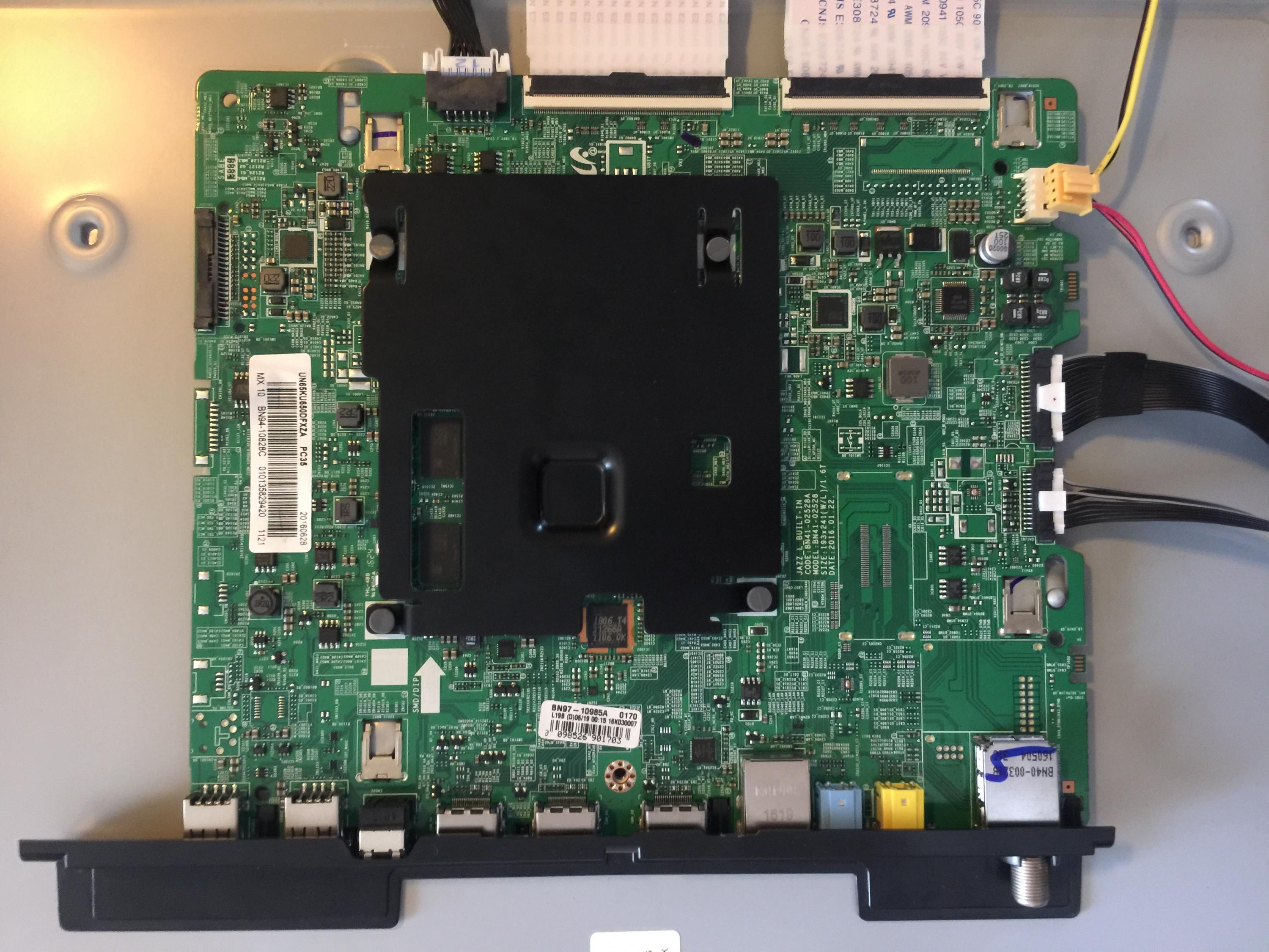

        PS-ON comes up, DC to the main board measures correct 13V, main board has 5V and 3.3V. When mainboard is disconnected from PS, the backlight comes on. Disconnecting the panel ribbons and remote sensor had no effect on the cycling. I doubt anything on the PS would cycle on/off/on this way, what do you think?
        Hamie, it's surprising that the panel could cause this. Both backlight and standby cycle on/off/on even with the ribbon cables disconnected from the panel. That said, based on the history you linked to, I'm going to return the replacement Main board. Thanks for the link!
        I've read some posts elsewhere that blame an unfinished wifi firmware update for the condition. But that would have to involve the main board. My replacement main board was said to come from a "ship-wrecked" set.

                The second main board made no difference.
                With LVDS ribbons disconnected at either end, it behaves the same, BL and standby LED flash on/off/repeat.
                I also notice a flashing red LED on the "few-button" remote when it's used.
                It's a mystery what is the mechanism causing a bad panel to do this.

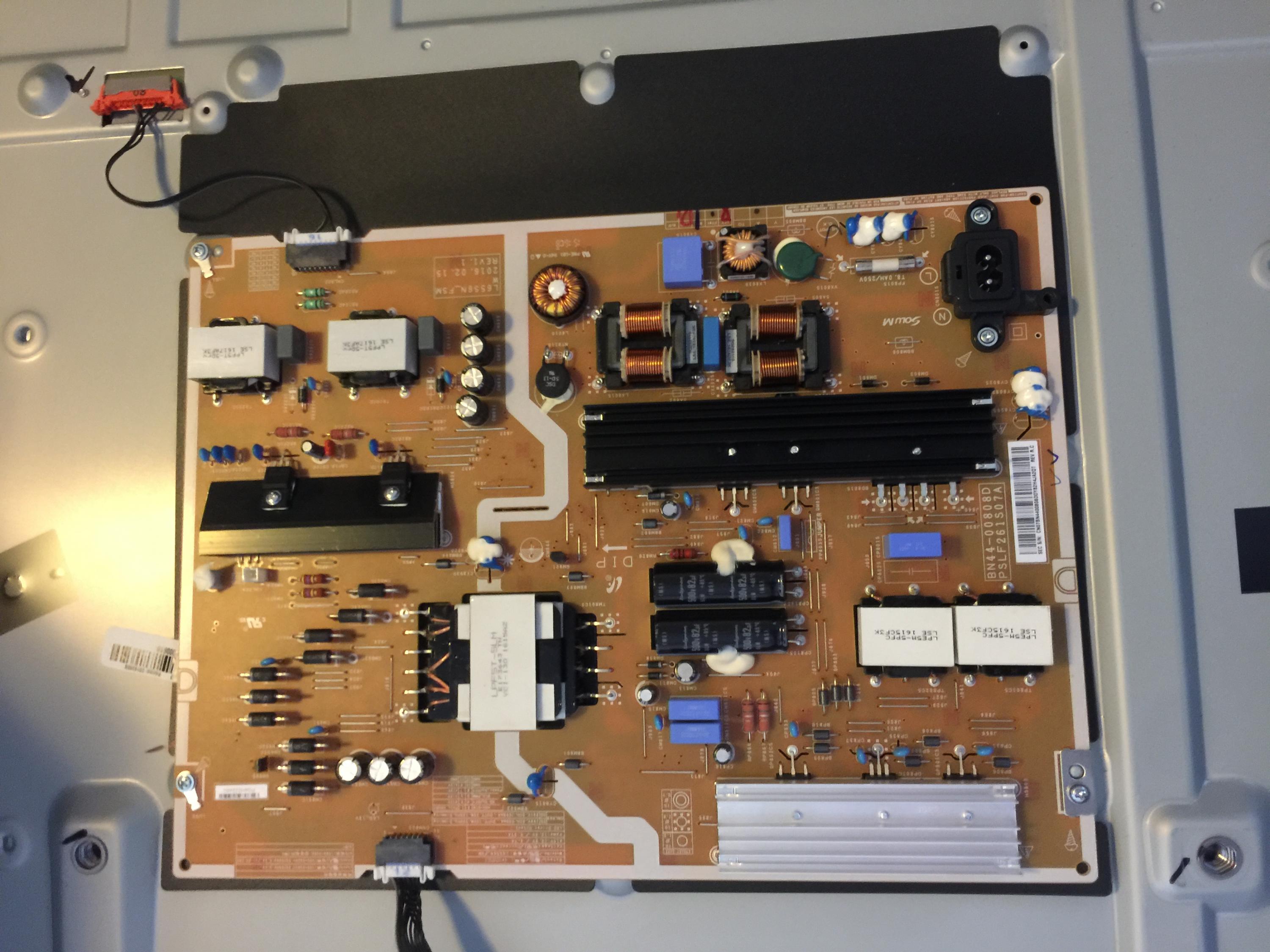

                    Re: Samsung curved UN65KU650DFXZA blinking backlight
                    Disconnect black cable going from power supply to mainboard. Plug tv in. Do the backlights stay on?
                    There are pull up resistors that turn on the backlights with the main board disconnected from the power supply. We're going to see if your backlights are causing this problem
                      Yes. When I disconnect the Main Board-Power Board harness the backlights stay on.
                        OK this rules out power supply and backlights.
                        Plug everything back in the way it was and only leave the LVDS cable that goes from the main board to tcon disconnected.
                        I ask you to do this before but I didn't get a response from this. It sounds like you left the tcon connected to panel but you disconnected that the ribbons at the panel.
                        I want you to eliminate the tcon from the main board.
                        If backlights turn on and you can hear audio this eliminates the main board as a fault.
                          He has a bad panel
                          There is no tcon in this set it's built into the mainboard.
                          You cannot disconnect the panel from the mainboard or the TV cycles.

                              My bad. Yes I agree. Bad panel. I guess since I saw the tcon cage I didn't look close enough
                                Great. I have this same tv in my bedroom. Just looked at the model number. Panel has tcon on driver board. Yuck.
