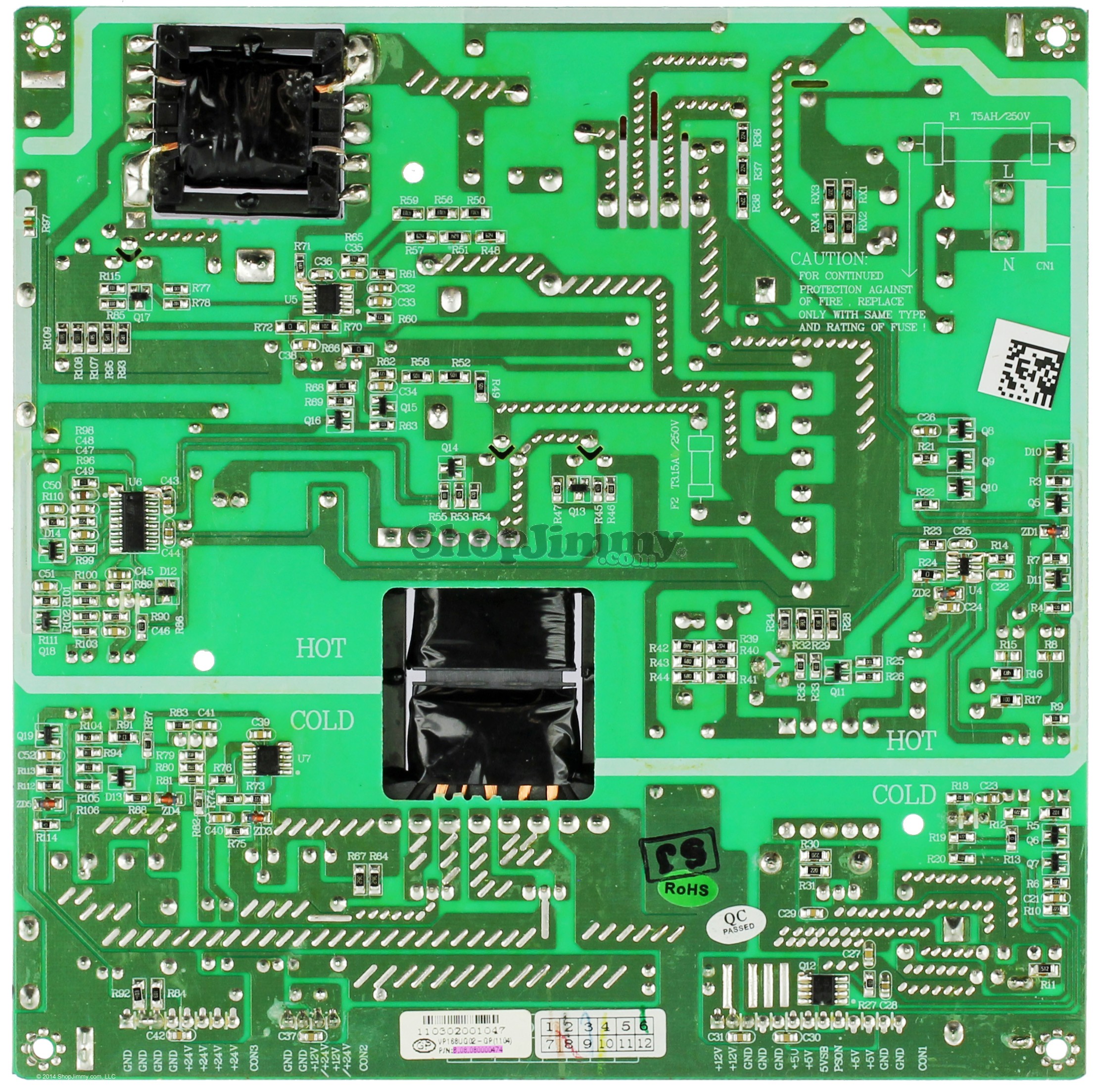

    on plugin get red sb light.
    pwr btn no response
    psu has 5vsb but doesnt respond to pwr on from mb
    can be tricked only with mb not connected, and shows a fluctuating ~12v but i hear an infinite loop of "clicking"
    but cant determine which component its coming from.
    i noticed a diode D4 which appears cracked in half, yet still
    reads some resistance (66.3 with meter set to 200k) one way and OL the other way (as a diode should?)
    when i use diode check mode i get ol one way and 0.481 the other way.
    12v output fluctuates between 11.6 and 11.9
    voltage on one side of the diode goes OL even on 600v setting
    endlessly fluctuating 19-31V on the other side (BANDED SIDE)
    pretty clearly have a bad PSU
    but could it be as simple as replacing that diode?

    On this shopjimmy board d4 has a ferrite bead on its + lead, it is not split. post pictures of your board. 11.6 - 11.9 is close enough to 12 volts, D4 is on the HOT side, so you can not use chassis ground to measure the voltage, (must use hot ground)
    What about the +24 volts, is it there when ps is forced on?
    If stby +5 is ok, I suspect a fault with the main board

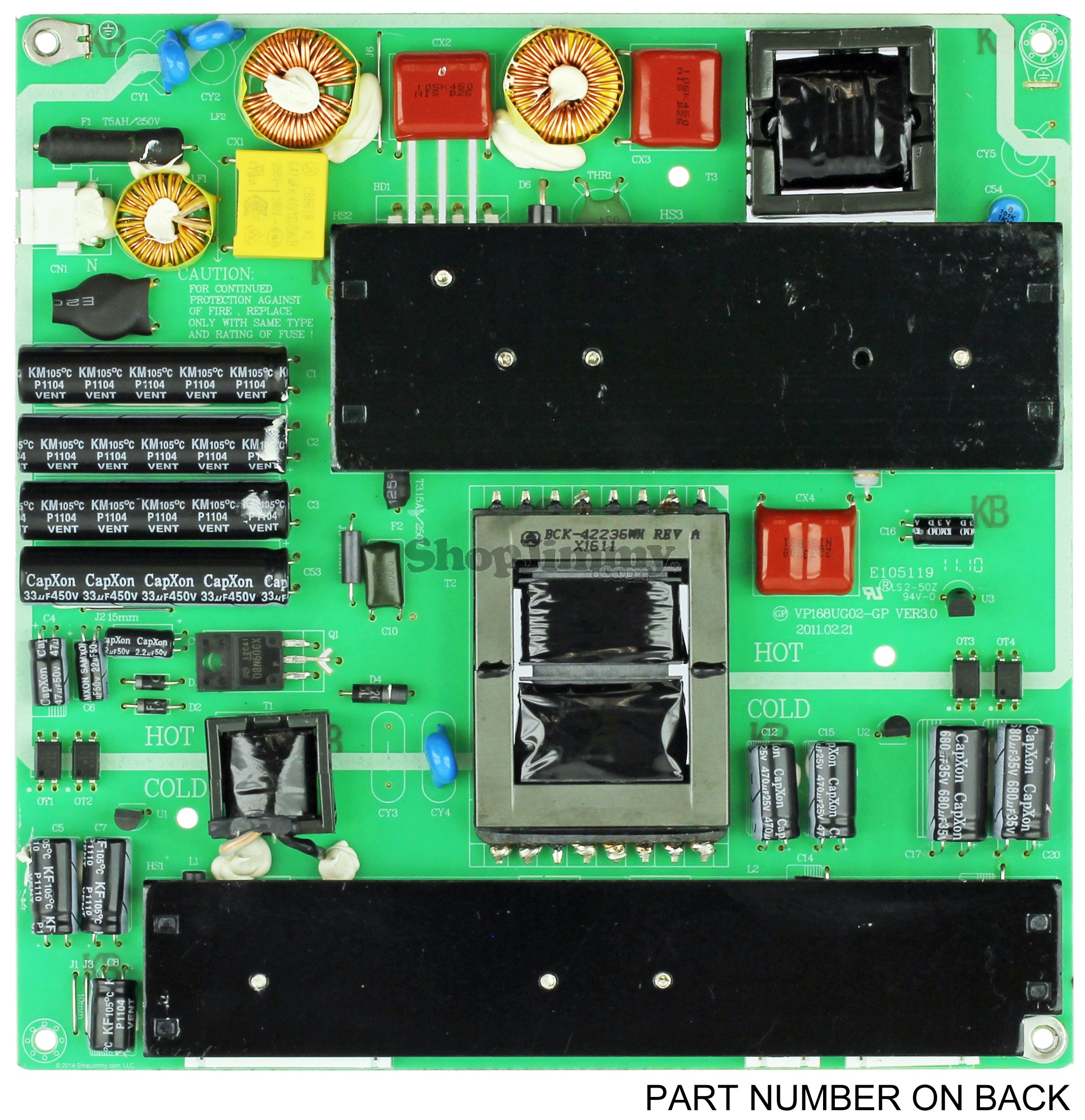

      finally got some time to look at this tv again...
      and you ar right R_J i was on the hot side so should have used the negative leg of one of the filter caps instead of chassis ground. i dont know what was thinking
      the diode is the same as in the picture on shopjimmy, ive just never seen a "beaded" diode before..whats that about?
      the correct reading with correct ground reference is:
      151VDC on the beaded side of D4
      OL on the other side, even on 600v mode (still totally confused by this)
      all four of the filter caps read 171v
      this is in standby.
      i checked the voltage at the button board connector and it is getting 3.5 which lowers depending on which button is pressed (so seems right?)
      any chance theres an actual service manual on this tv, or is that pretty much a thing of the past now?
      the fact that it clicks over and over again when "tricked" on without MB connected seems to suggest bad PSU, what makes you say MB suspect? can some PSU's not be tricked?

            "all my filter caps are reading 11v "
            If you only get 11 volts across ALL the caps, I guess you mean C1 or C2 or C3 or C53 your main fuse F1 is likely open
