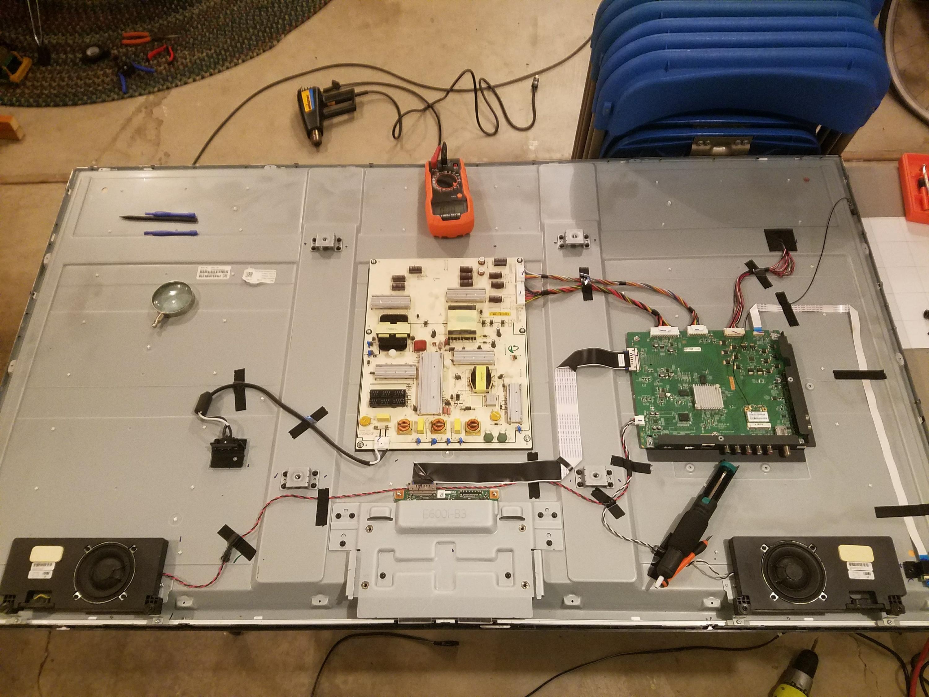

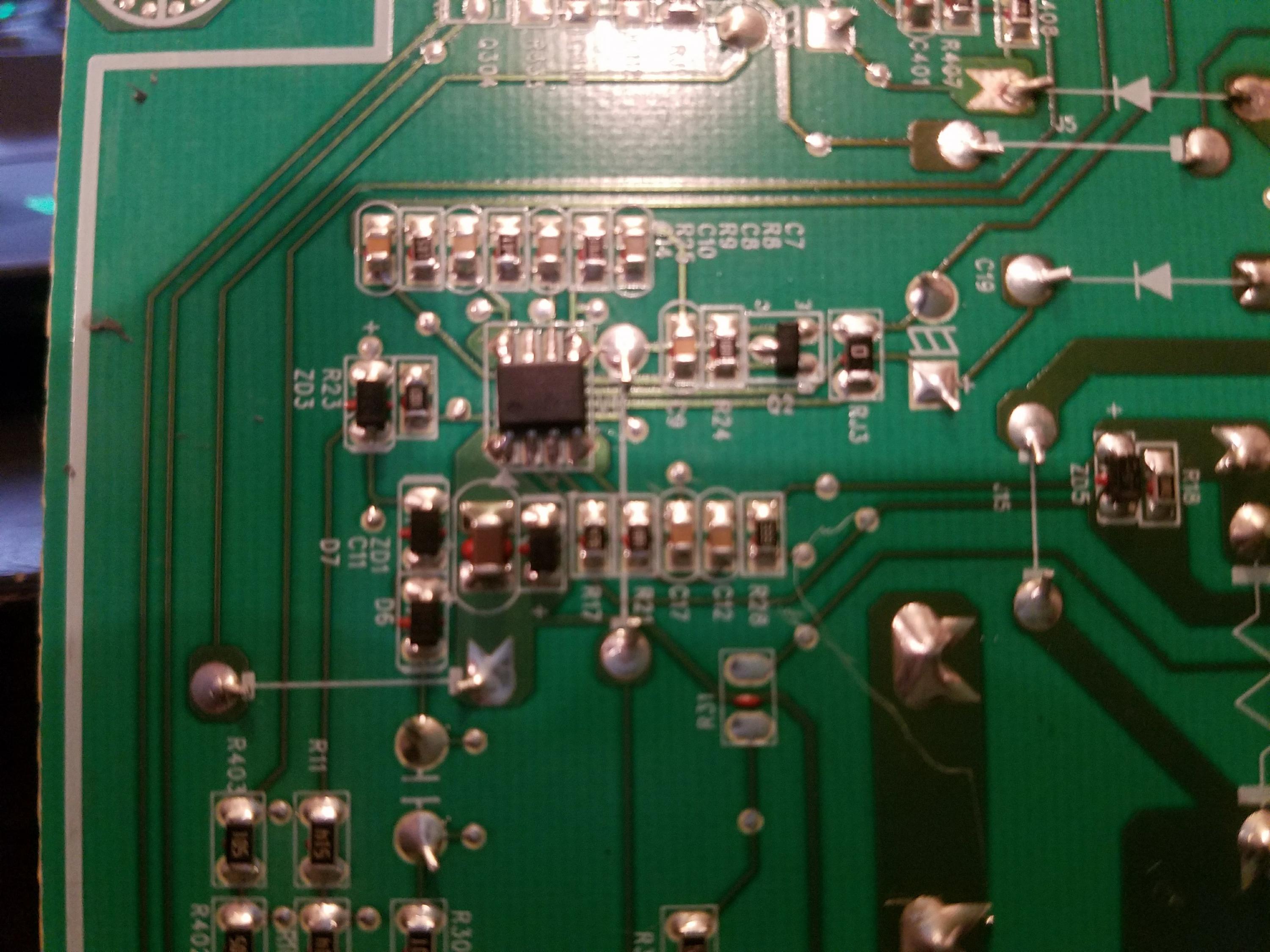

    Hi Badcaps community.
    I picked up a used Vizio e600i-b3 locally, hoping for a few dud LEDs only, but alas, it seems there is a problem with the power supply. I've attached pictures of the layout of the TV, the front and back of the power supply, and a few close-ups of some of the connectors. I saw this video on YouTube and determined that the PSU was likely at fault as my power supply gave nearly identical voltages to the video. In the video he just replaced the PSU, but I'm wondering if there is an easy way to diagnose if one of the ICs he mentions under the glue are likely at fault.

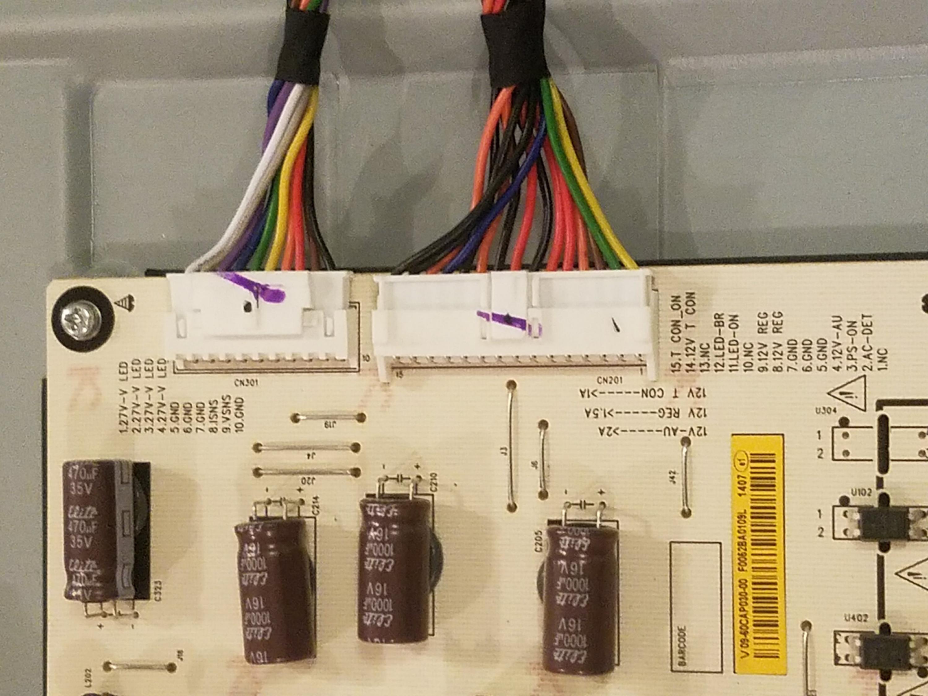

    Here are my voltages:
    CN301:
    Pin Label Actual
    1 27V 0
    2 27V 0
    3 27V 0
    4 27V 0
    5 GND 0
    6 GND 0
    7 GND 0
    8 ISNS 0
    9 VSNS 0
    10 GBD 0
    CN201
    Pin Label Actual
    1 NC 0
    2 AC-Det 0.31V
    3 PS-ON 3.39V
    4 12v-AU 12.36V
    5 GND 0
    6 GND 0
    7 GND 0
    8 12V Reg 12.36V
    9 12V Reg 12.36V
    10 NC 0
    11 LED-ON 0
    12 LED-BR 0
    13 NC 0
    14 12V T Con 0
    15 T Con_On 0
    These voltages do not change when I attempted to power the set on, and interestingly, the PS-ON voltage is at 3.3V immediately after plugging in the set.

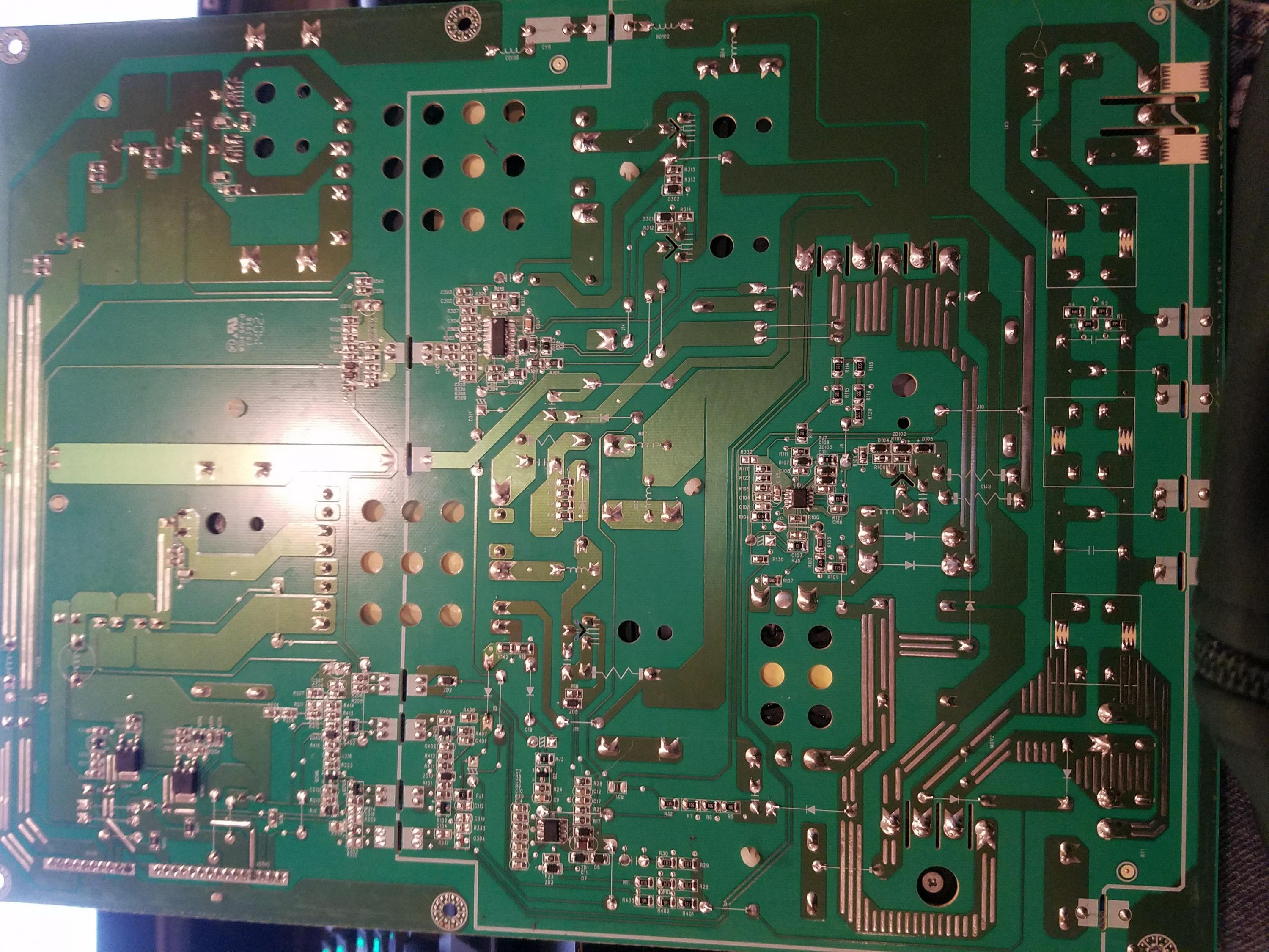

    I'm not reading any shorted diodes or fets or seeing any bulged caps. Fuse also checked out. I carefully used a plastic spudger to clean all of the glue away from the 3 ICs on the back of the board.

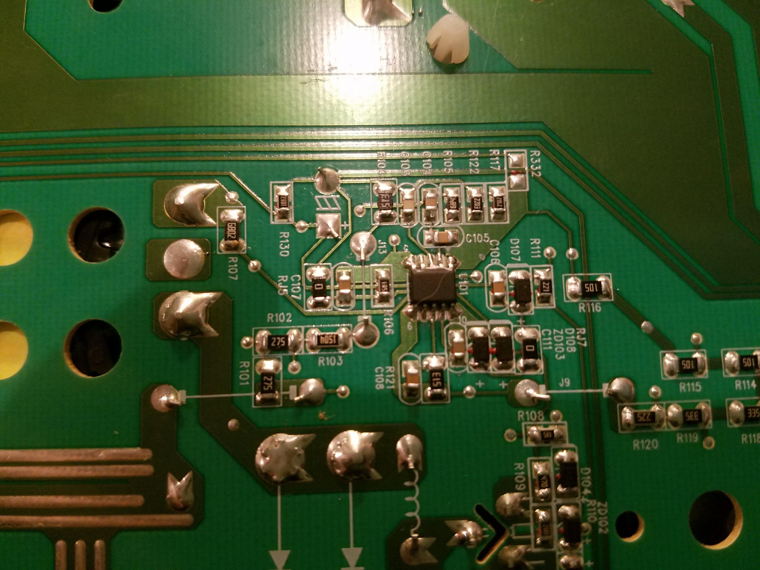

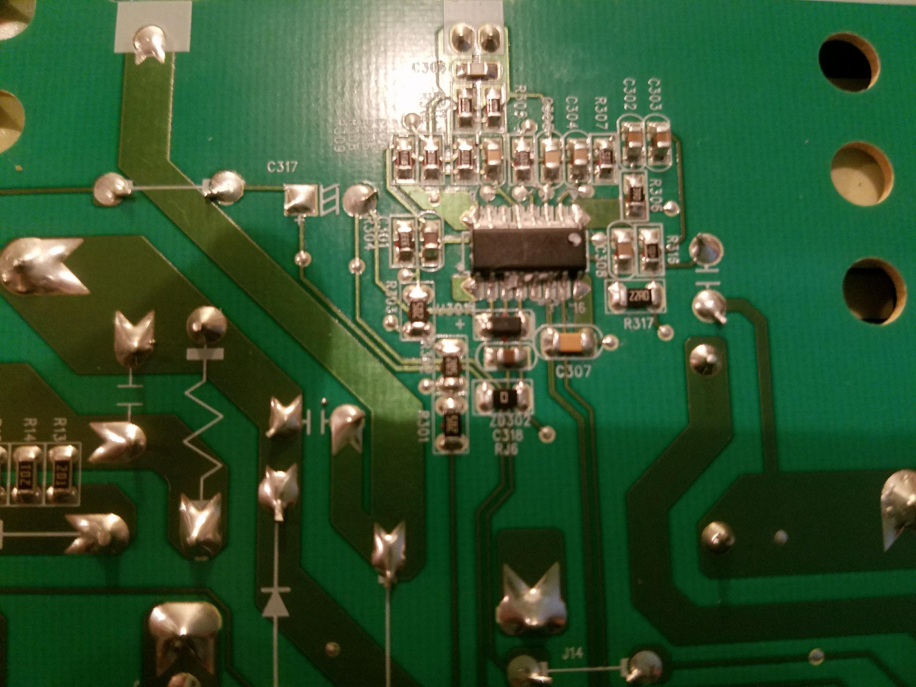

    Here are the 3 labels on the parts that were underneath the glue on the back
    L6699D is at U307 near the middle of the back of the power board
    TEA1733 is at U1 on the left side of the board near the middle vertically
    L6564D is at U101 near the middle horizontally and the bottom 3rd vertically
    So to my main question:
    Is there an easy way to test these components, or would it make the most sense to just go ahead and replace all 3 for about $10 on Mouser? Thanks for any help you can provide.

    Re: Vizio e600i-b3 Power Supply Repair
    Pin Label Actual
    3 PS-ON 3.39V
    11 LED-ON 0
    15 T Con_On 0
    Looks like the mainboard is not sending out the control signal to turn on the Leds and Tcon.
      Try jumping ps-on yo led-on see if leds come up

              If I jump these connections with the mainboard still connected, both the PS_ON and the LED_ON voltages change to 1.9V and the 27V LED pins remain at 0V.
              If I disconnect the the mainboard, PS_ON drops to 0V. Which connections to I need to jumper to fire the Power supply on without the mainboard connected?
                Ps-on to STB pin. You don't have a stand by voltage pin?

                    I don't think I would gamble that. 12v to ps-on is way to high. And without the mainboard connected testing would be pointless anyway with the LED current drivers on the mainboard.
                    Imho if led-on to ps-on doesn't work, then you have shorted leds.
                    Also curious about ac-det. I believe that should go high. What happens to ps-on when turned off in standby mode?
                      There is no standby voltage as far as I can tell on the set, and no standby LED comes on when the set is plugged in. None of the voltages change when you press power on the set. I decided to just go ahead and search the strips for LED issues and every single strip fired on fine with my bench power supply. I think at this point I may just go ahead and start looking around for Power/Main boards, unless those ICs would make more sense to change.

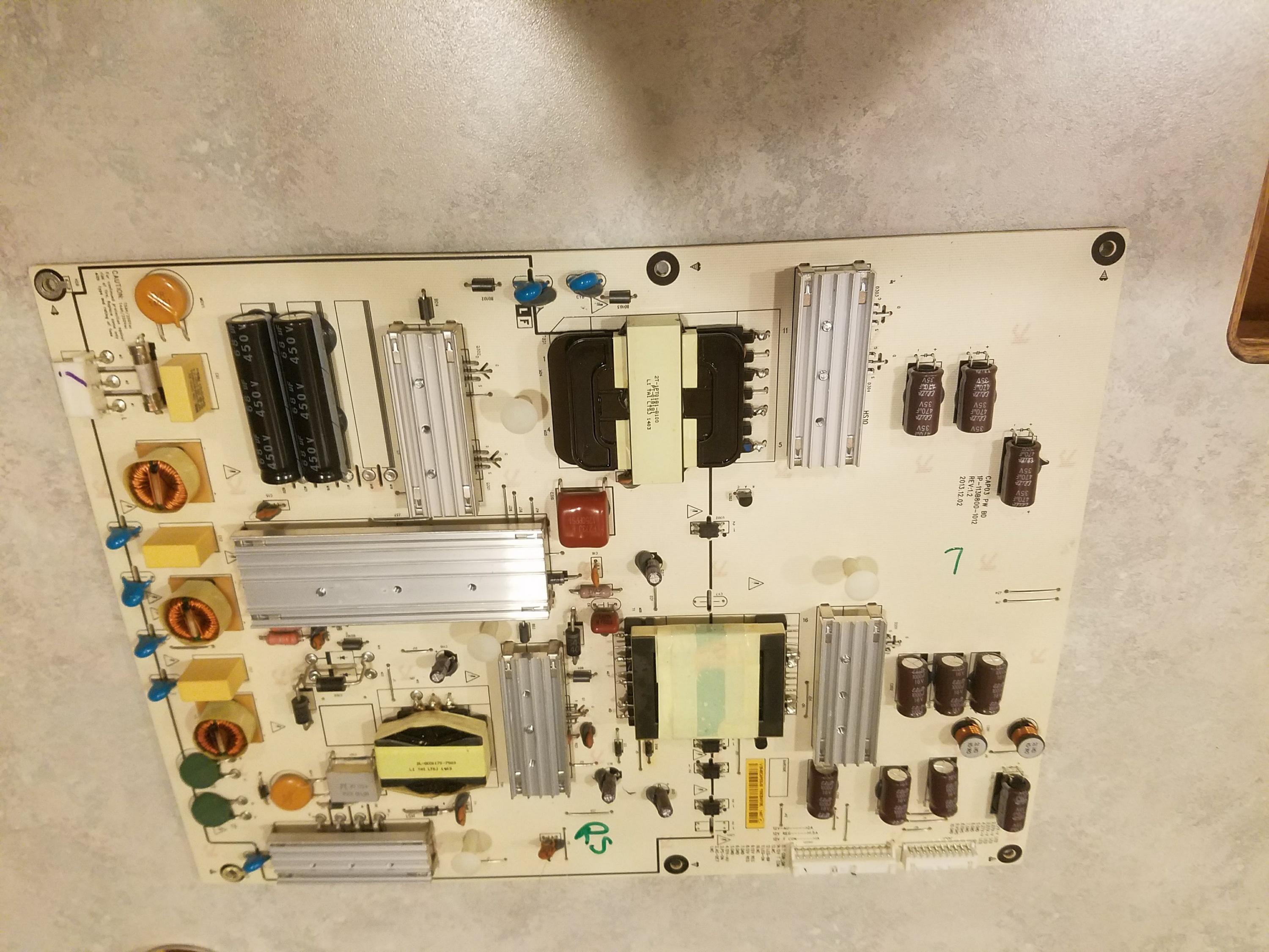

                        Comparing the cost of components to the cost of the board, and based on testing the backlight as good, I'm just going to go ahead and order the power board on ebay and go from there. I'll check back in after that arrives
                        • david.aaron.long
                          • Nov 2008
                          • 38
                          Power board arrived today and the set is working flawlessly. Now to decide wether or not to try to fix the old power board. Thanks!
