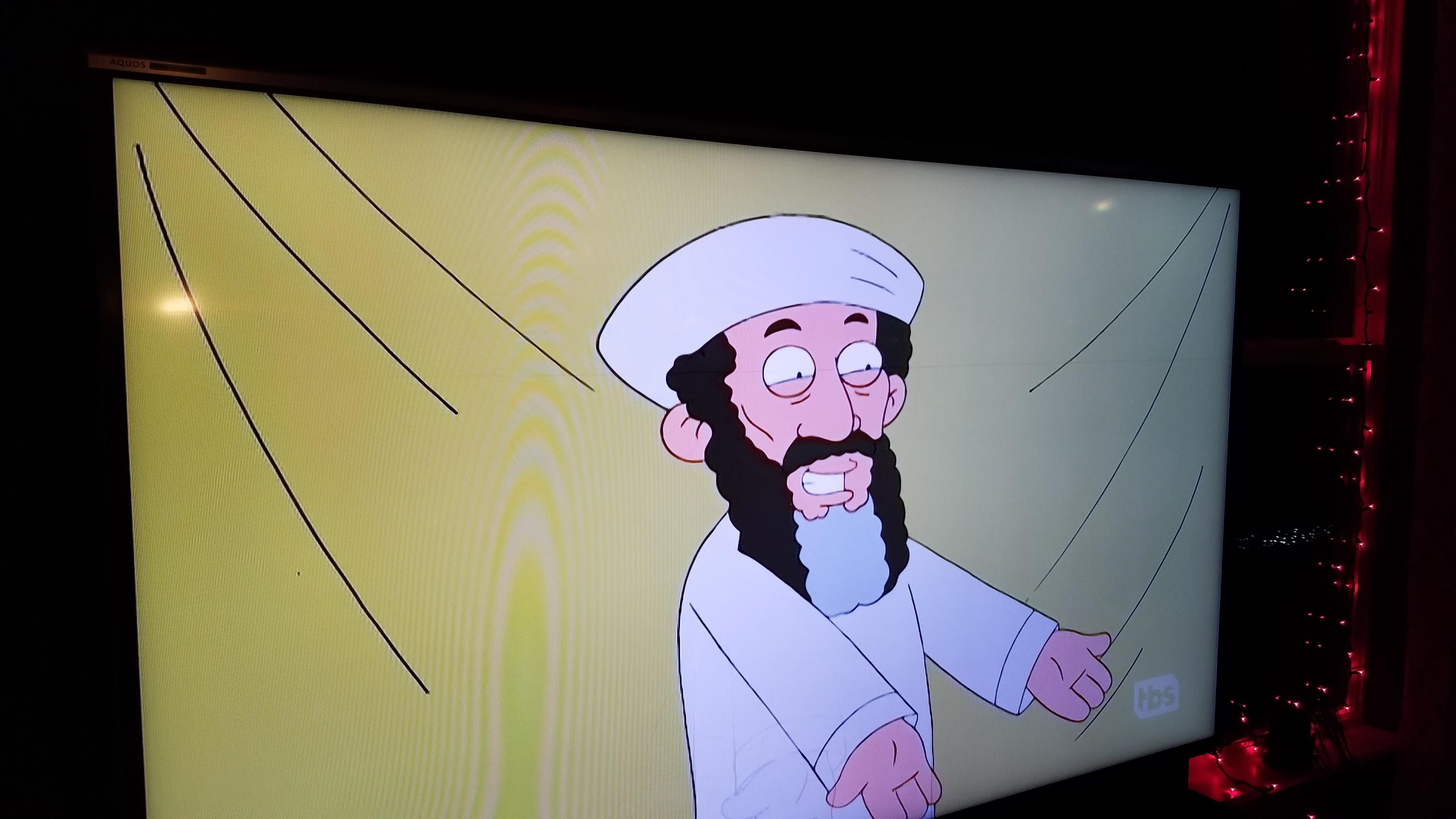

    Have a 70 inch Q+ Sharp, about 4yrs old.
    Over the weekend the screen started flickering. A simple power off and on of the tv fixed it. But yesterday it did it two more times, now i have a very thin black bar from right fading to left. A power cycle doesn't make this bar go away. Tried unplugging tv and holding power button to drain power as well.
    Is this a panel issue?

    Re: Sharp TV Bad tab drivers?
    Yes. Unfortunately your right side gate tab driver is failing
            Thermal stress, design, Possibly overcurrent to a sub par IC is my philosophy.
            These take the information from the source drivers which are located on the bottom of the panel and span the data horizontally across the screen where needed a. Without them you would have vertical bars flashing across the screen. The LCD panel needs these to span the data across each segment of the panel from left to right.
            This LCD panel has drivers on each side. One acts is a send buffer in the other I believe access a receive and then a send back. Without 1 side doesn't seem to make a huge difference except now The remaining side is left to do a dual duty cycle of sending and receiving. The remaining side will be work however with hundreds of people doing this by now I have not heard of too many bad results but I have seen a failure 1st hand myself of only one side operating so it does shorten the lifespan of the LCD panel however the lifespan of the LCD panel now Is compromised anyway because the bad driver
            So you can judge for yourself if you want to leave it this way as long as you can before you get imminent shutdown to the point where you need to do this or throw the TV away

                  Just to be clear, you have to pull off all the tabs on the bad side? Not just the "bad" tab?
                  Also, the side with the bad tabs will not display a white screen when white ribbon unplugged but still try to show image of screen?
                  Just want to make sure im getting it right from your article.
                  Also currently, i only have a thin black line, with intermediate screen flicker. Is that black line part of a bad tab driver too?
                    Yes that one line is part of an array on one tab.
                    Whatever side is disconnected will normally show a white screen.
                    The side that has the darker patch is the side that has gone bad.
                    All the tabs on the bad side need to be removed not just the failed one or you will have A disproportionate picture with light and dark areas.

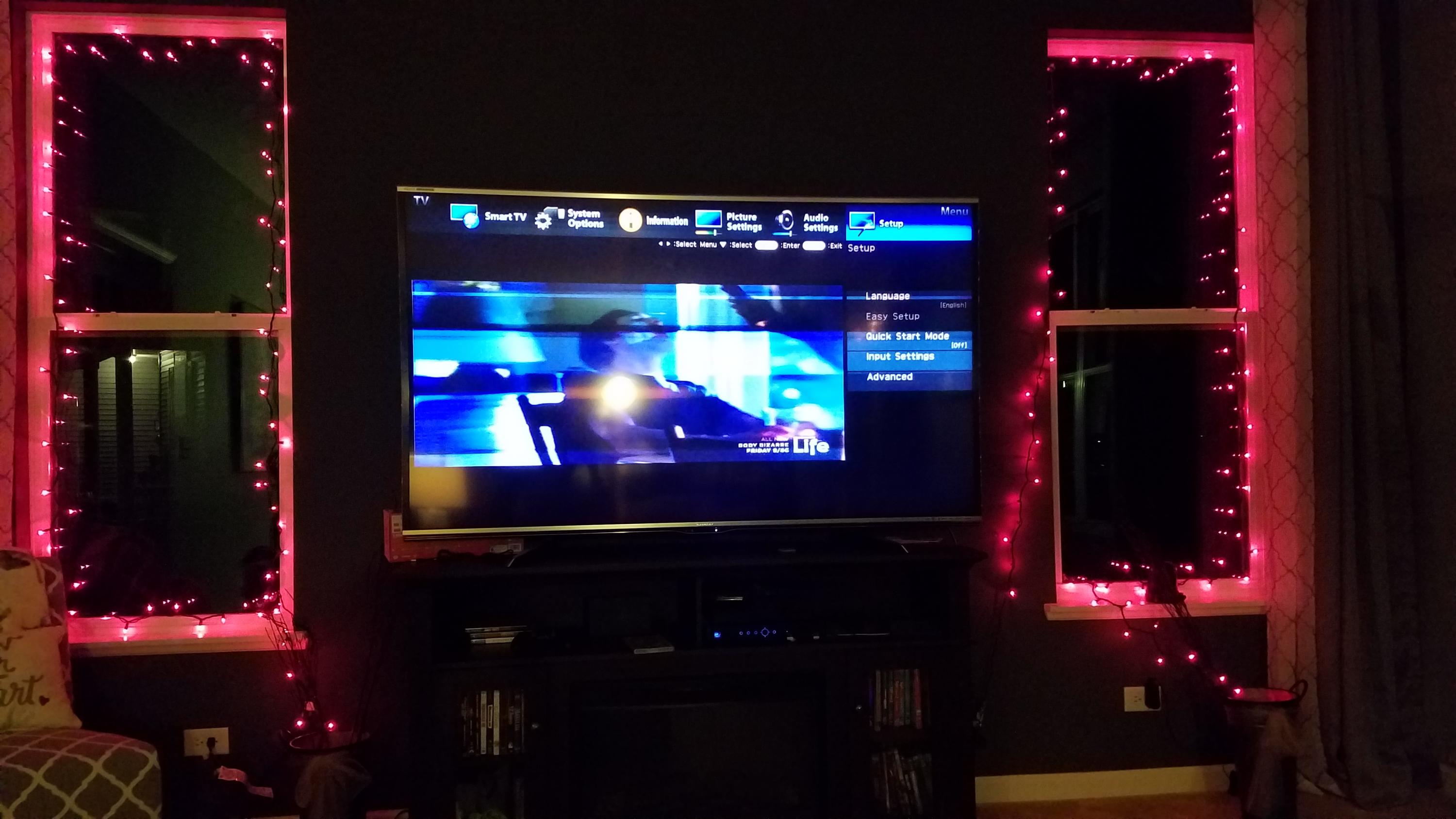

                                So, I ended up just mounting the old tv in the basement to use while on the treadmill. I hadn't turned it on in almost 8 months until about 3 weeks ago. It came on fine except the horizontal line was much thicker and there was a second thicker line toward the bottom.
                                This was fine with me as i could still watch Netflix without much distraction.
                                We had some ice storms last week that knocked out power. The power went out a few times, and when it went out it would kind of flicker. This tv was off but plugged into a surge protector. My other two tv's same setup. Those work fine.
                                This one i came downstairs and saw the white light flashing. So idk if it came on by itself when it got power and then the next wave of power flicker killed it or what, but the white light has 1 quick flash, and 3 slow.
                                I tried the resets listed all over, none worked. I hardly have help lifting these tvs on and off their mount, usually my wife can help but she is pregnant. So i am trying to figure out if I need to order a board, or if this is somehow related to the bad driver tabs; and fix it in one shot with whoever I can get to help me unmount and mount it back up.
                                Any ideas given what I mentioned? Funny how this tv is the only one effected, my other 75 inch sharp (hisense), and 65 inch curved Samsung still work fine.
                                  the set already had an issue, the power "outage" just added on top. Likely cause is that the panel issue is pushing the limits of the power board such that any difference in the powering caused the system to detect an error.
                                  not sure why you haven't removed the tabs from the faulty side (at least I don't read that you did)... the tv would likely be as good as new. Lots of posts and threads on this type operation and its success in saving sets.
                                  further, the more that you operate the set in its current state, the higher the likelihood that the fault (ie. gate driver) will cause issues in other portions of the set that are not readily addressable resulting in the set heading to the "curb".
