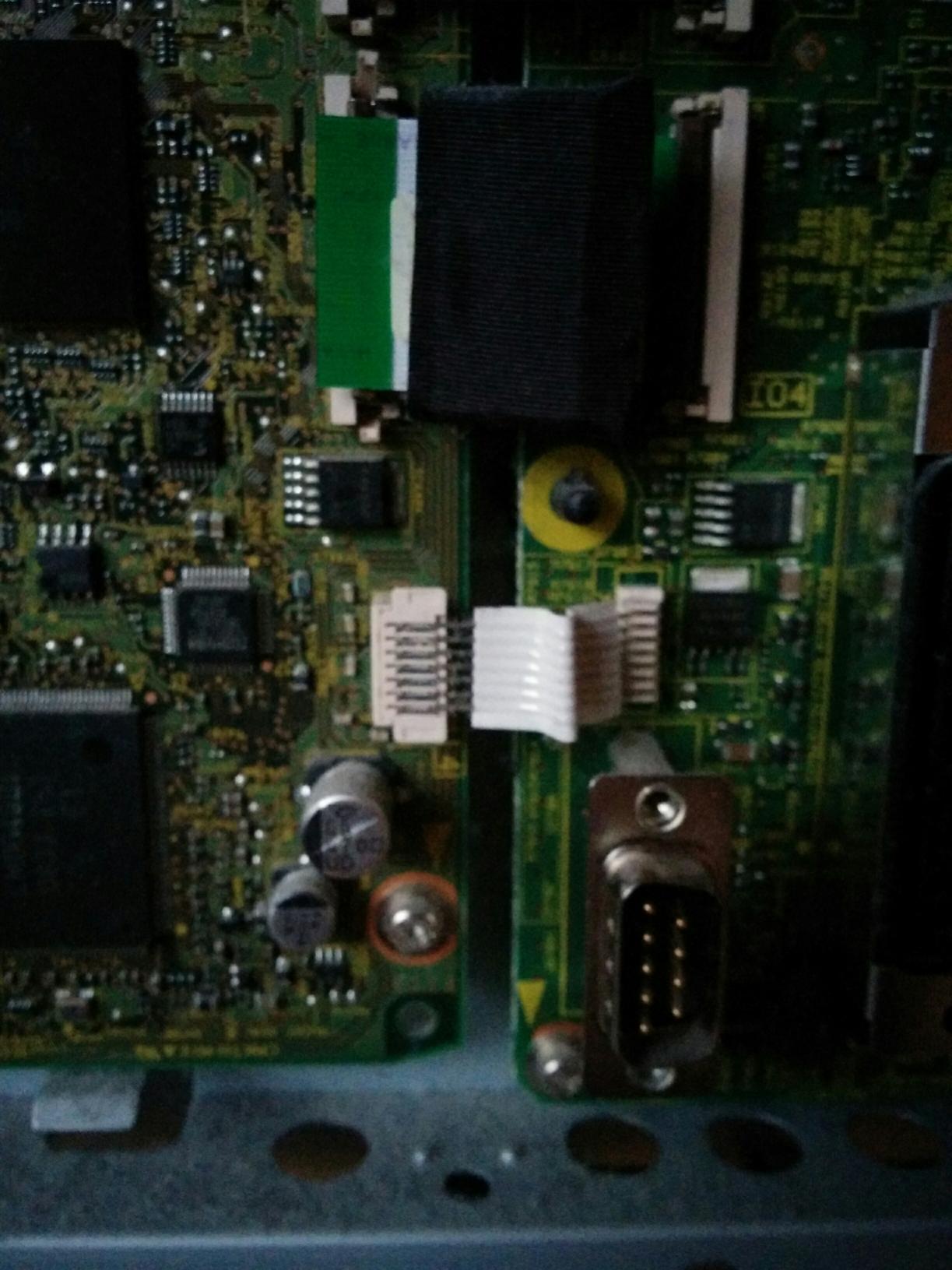

              Started to take of some of the back today, but do you know if I need to remove other boards to get to the input board ? (is there any description anywhere on what needs to be taken away ?.
              I guess one might have to loosen some ribbon cables/connectors etc to get it out ?.
                Re: Does the Pioneer LX-5090H have a "trap switch"?
                Yes, you have to remove ribbon cables, connectors and the screws holding it in. It's fairly obvious once you get to it.
                  Almost there now, but before I use any force on this connector, any info on how it's supposed to be removed ? (is it ust to pull it out or is it "locked" somehow). (the white connector/ribbon)
                    That one is a little annoying. Just have to ease it out. It does take a bit of force but it comes. I broke one of the plastic side tabs off on one I removed as they are a bit flimsy but it doesn't affect function if that happens.

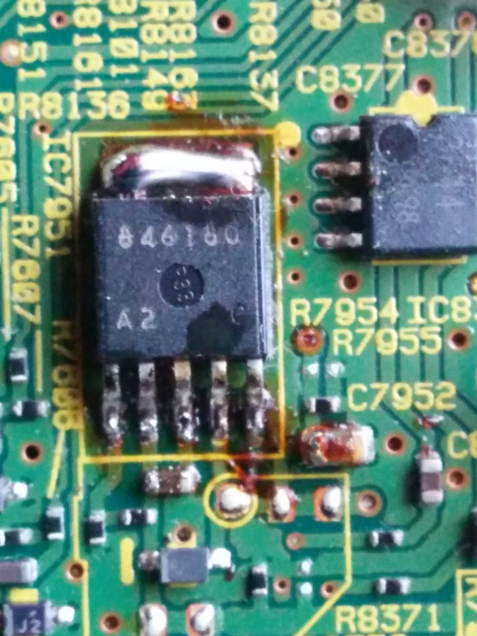

                      yea, was able to get it off, so worked out fine
                      Now I guess it's this one that will turn out as the "culprit" - but is there anything else that should be replaced when doing this ? (I'v heard they had some kind of a "kit" which had some other components as well, or is it enough to change out the voltage reg ?).
                      I guess I can use these ?: https://www.digikey.com/product-deta...E1CT-ND/718327
                      EDIT: I see one can choose between NJM2846DL3-18-TE1CT-ND and NJM2846DL3-18-TE1 (anyone know what the difference is, and which one I should order ?)
                        Usually just one reg. Measure the output of it at switch on to be sure or often they can be persuaded to work temporarily with a blast of freeze spray.
                          Wasn't able to measure it (was unsure if it would be ok to power it up without the other board that sits in front of this, so just have to take a chance), the symptoms where that the tv would maybe fire up, and work, but if shutdown, and try to power it up again it gave these 8 blink, it might be able to be powered on again after a while, but guess that's due to temperature then maybe).
                          • mawrick
                            • 12
                            • Norway
                            Then this LX-5090H seem to be "back from the dead" - haven't done extensive testing yet, but seem to be working fine (although the blinking light was a bit "intermittant" (ie didn't happen every time it was switched on).......the chip was def faulty though so hoping this now is sorted
