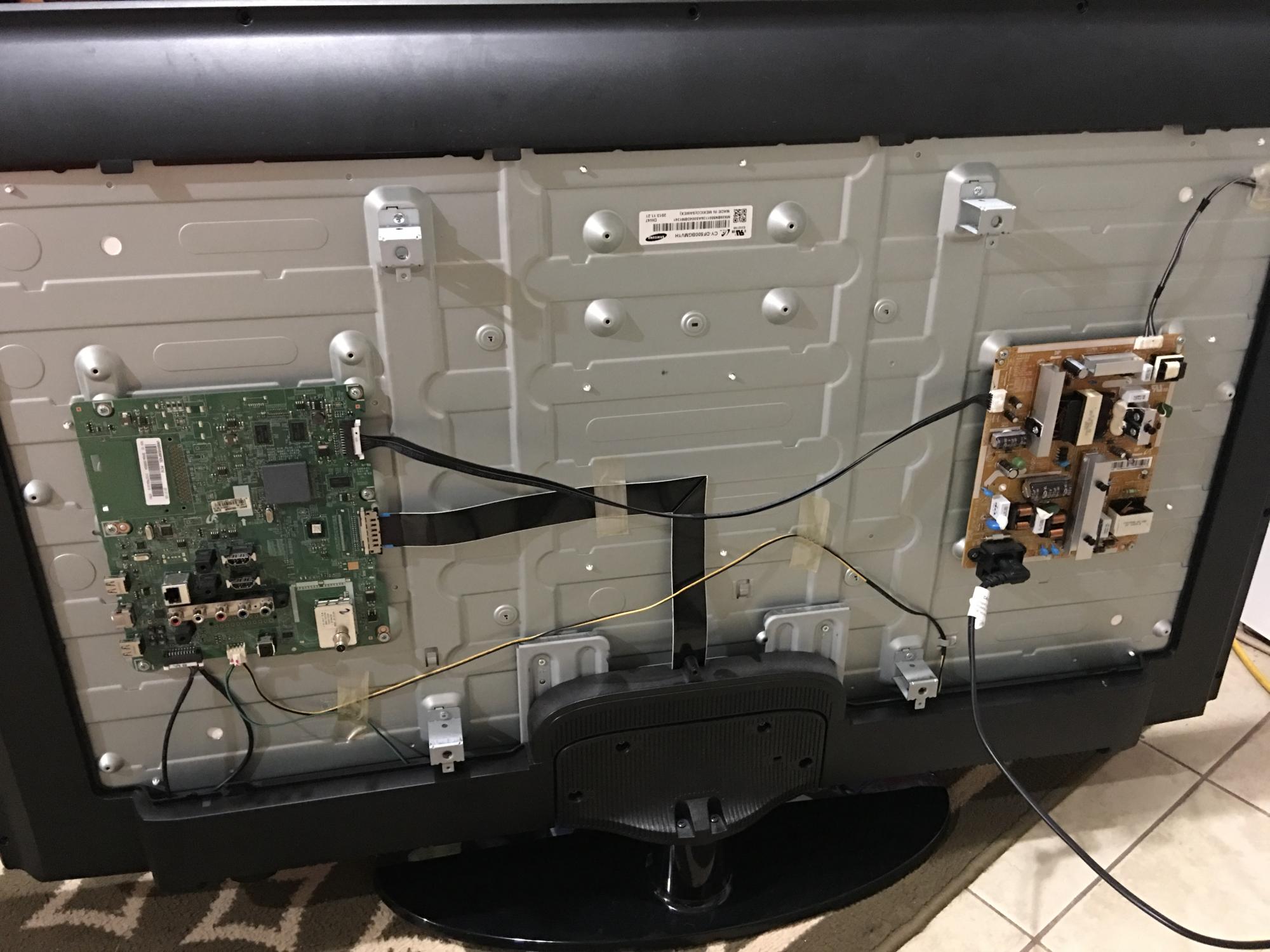

    Newbie here, just wondering if someone can help me out
    I have Samsung UN50EH5300FXZC Ver. PJ05
    Black Screen with standby Light on and sometimes blinking
    I have read some treads for troubleshooting but still confuse

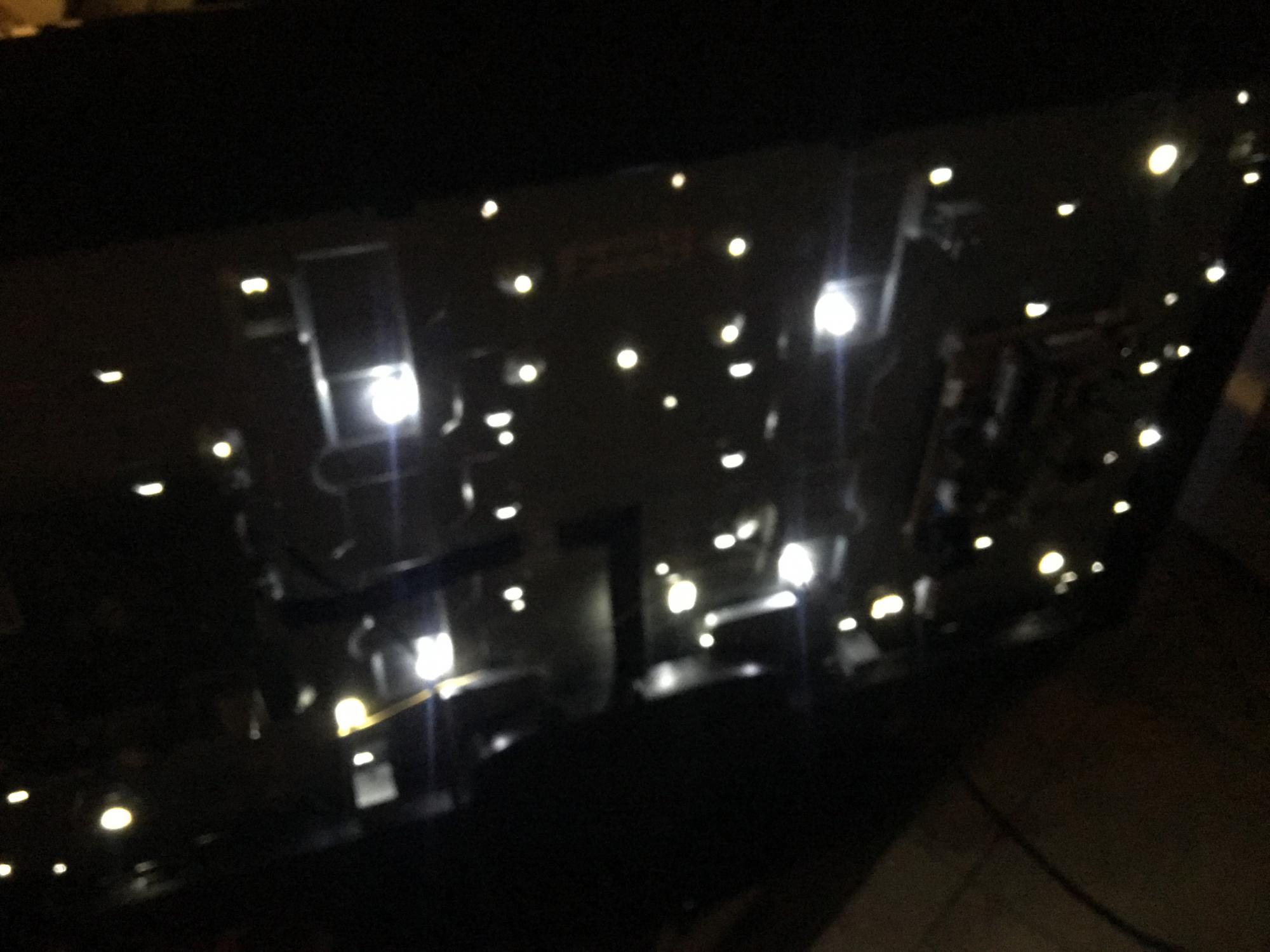

    I have done plugging it on with the main board disconnected and backlight
    Is showing on, some say it was the main board some say it's T Con.
    Is it worth fixing this TV to by the parts or no.
    What parts I need to replace and where to get them
    Thanks in Advance
  • kc8adu
    • Nov 2003
    • 8832
    • U.S.A!
    Re: Black Screen
    moved for you.
    with main disconnected are all voltages present on power supply?
    what about with everything connected?
    will it come on with lvds disconnected?
    at least its not the led strips!
