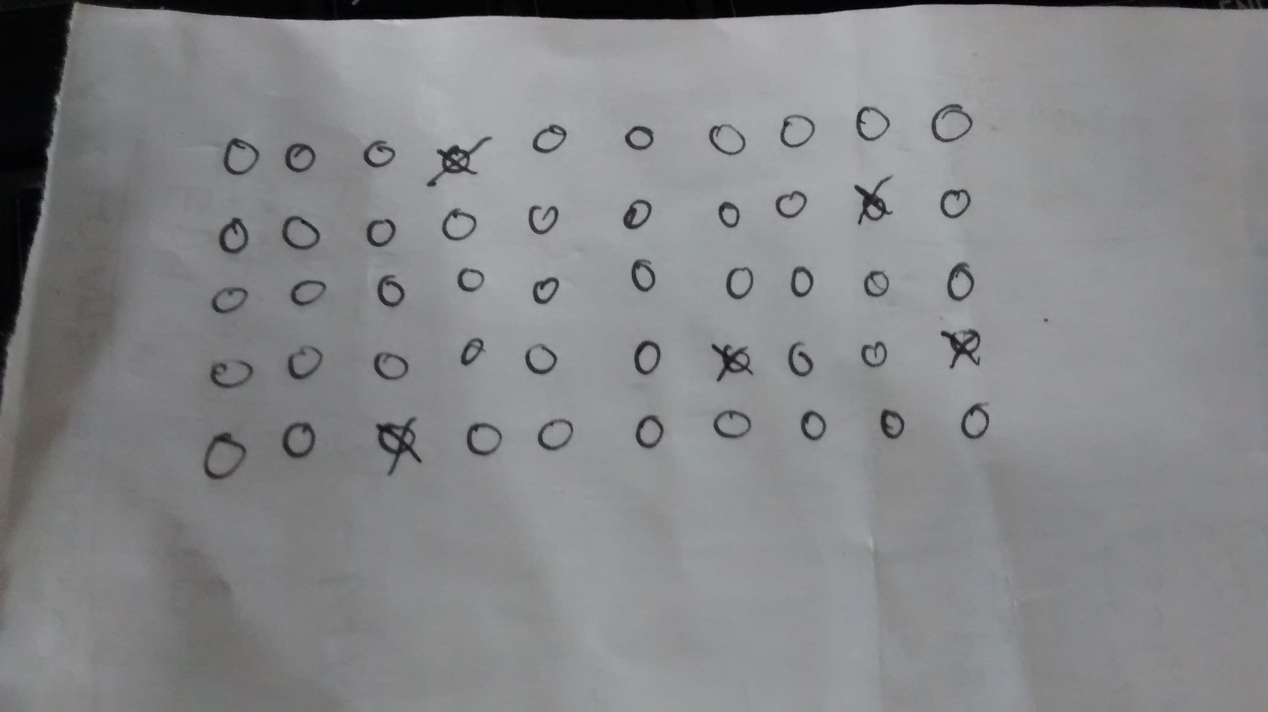

              ok i took the panel apart and i did find 5 bad LEDS. there are 5 strips of ten lights each in this panel. LED1 and VOUT1 power the top and bottom strips, and LED2 and vout2 power the middle 3.
              here is a picture i drew to show which LED's failed.
              so i guess ill just...repair these LED's and see what happens?
              i've been getting pretty good at repairing LED strips.
              fixed 3 LG panels recently. first one took me hours. 3rd one took me minutes
              Don't fear the repair...

                You said bad LEDs, in which kind of bad? shorted or flickering, etc. when test with your tester individually.
                I am beginning to see the weakness of the LED tester due to its low drive current capability, you can use it and it will show the LED string to light up but it will not show if the LED has shorted LED/s or not. The bad LED (not shorted out) may also light up at 30mA but when it is driven by much higher current it will fail.

                    Right I need to find out as to what you have found bad on those bad LEDs, they fail to light up, or what?
                    • triplefour
                      • May 2014
                      • 1747
                      Re: VIZIO E420i-A0 has bad PSU, bad MB, and bad LED's (i think)
                      yes the 5 bad LED completely fail to light up even when i apply power directly to just the single LED. somehow when lighting the strings with the tester though, the bad LED's are just skipped over, allowing the rest of the LEDs to light up. they glow soft at first but then climb in voltage to 2.8 and then stop at what looks to me to be "full brightness" are you saying that in actual operation of the tv they will be even brighter? as it is they are hard to even look at !
                        They will be really bright when driven by the TV LED driver circuit.

                            ok i replaced all 5 bad LED's which were shorted closed. and now with my LED tester, the strings light up just fine, and the voltage no longer fluctuates as much. barely at all
                            and when it does its just by .1
                            55.5~55.6v for string 1 but after a while it just stays solid at 55.5
                            83.6~83.7v for string 2 but after a while it just stays solid at 83.7
                            readings from the LED connector of the PSU havent changed much from previous posts.
                            tests are done with PSU tricked on via PSON and BLUON
