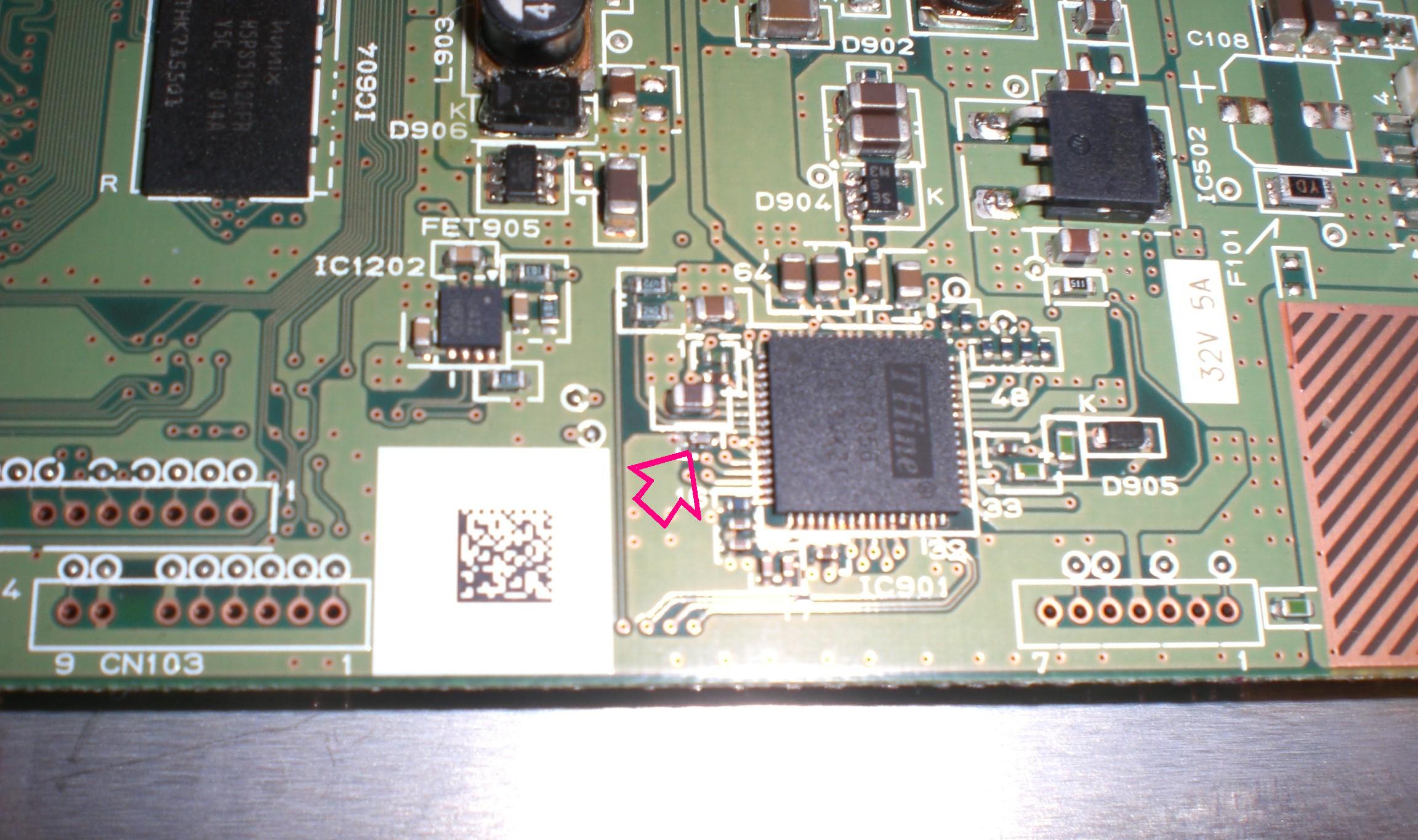

      Well, you think that i have solved? NOT! I'm not the usual moral low tech that put a drop of tin on the cap to short it and sells the tv "without warranties"..
      i have to find why tcon doesn't boot ok and then test it again and again..
      the cap is this:
      PS: it's possible that faulty side side tab will begin again to do the "stupid"...

              There's no Alternated Current here.. The cap function as a timer, when UVP or OVP or thermal problem are detected the chip starts charging this cap, if the warning situation still persist until this cap reaches 1,2v then all the supplies stops. I have tested that cap with 2 meters, with one i get Over Limit (!!) and with another (that tests bigger caps) i get no measure, i'm starting to wonder if this is bad, but why and how can i replace it, on the D.sheet i see the formula to size it, it's a sin that i don't know the "time" variable that the chip is right to count, here is where a good scope comes handy.. i can only get some by old boards, test them and try them at turn..

                  "Not DC" AND "Not AC"=zero volt, you mean "DC pulsed signal" for me...
                  It was too much easy to replace the SCP cap and good night at the singers, in fact i've done it , the original measured 10nF that means for me 0,12sec (120msec) for the UVP 0,24sec for OVP/thermal, the example near the formula in the d.s. for me is wrong, it says 1,2x10^6xCap(F?), 1,2x10000000=12000000x0,00000001F(10nF)=0,12=120msec.
                  I changed with a 95nF (the less i have) but tv doesn't switch on.

                    Little UPDATE: i've tried to enter the service mode after switching tv on with the short and then switching off with remote, i have used the wrong combination for error and tv switched on normally without the short, i have tried many times to switch on and off and succesfully done, after i have entered the right way the SM ([DISPLAY] is the key with "i+" not other i used) then i have done the sequence to reset to defaults, don't know if suceeded, then i have tried to enter the diagnostic screen and tv no more starts, have tried with the short and nothing, then i have noticed the new capcitor have detached by the pcb!!..
                    Will update soon after new cap replacement.

                      Update: soldered new capacitor same capacity 10nF, tv doesn't power on regularily, need short, tried succesfully SW upgrade, not fixed, done reset by Srv menu, nothing new, since there is a serial flash on the tcon, maybe there is a processor and a firmware and on the eeprom it stores a fault flag that must be erased in some way, well i don't have read all the Service manual but this is also a few possible chance.

                                      I think i have solved and i hope. It seems that the internal current generator that charges the SCP cap flowes more current than the expected, first i have put a trimmer in series with the 10nF cap but it dont worked, then i've tried a bigger cap to draw the excess current that enters the internal comparator and makes the threshold level to arrive too soon, a final 100nF worked ok and the faults protection still works because i have put a resistor in parallel to the voltage divider of the invertin input for the Avdd feedback , the image freezes and after som sec. tv shuts off. Then i can turn on again without flaw. This repair anyway is wrapped of mistery...

                                          Can you post picture of your modifications?
