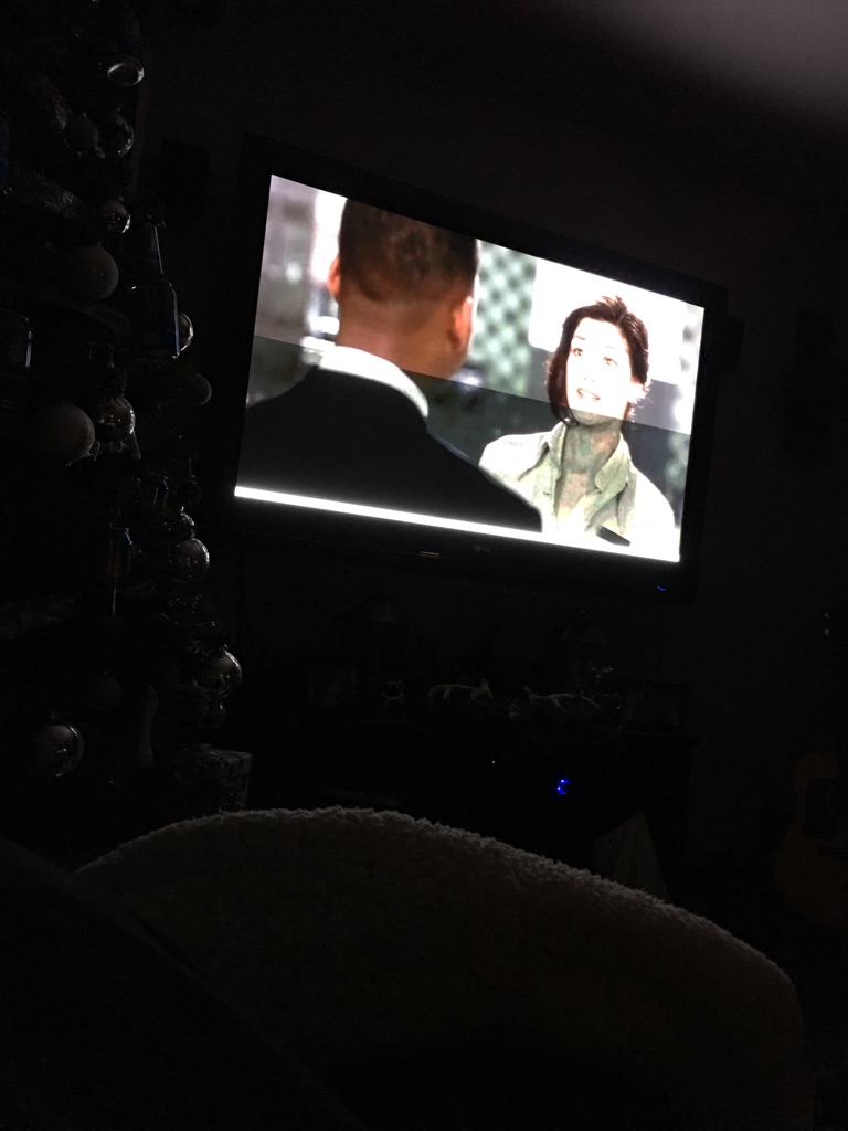

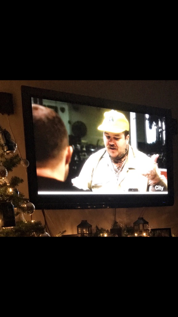

    I have a lg 60pg30 has a white bar across bottom which goes black sometimes. Then sometimes bottom half panel goes darker as shown in pictures. Is panel shot or buffer board problem?

    1st look at a buffer board issue or and bad connection on the buffer board.
    We try removing the buffer board completely and reconnecting it making sure all the connections We try removing the buffer board completely and reconnecting it making sure all the connections are clean.

      The white stripe makes me think bad lower buffer board.
